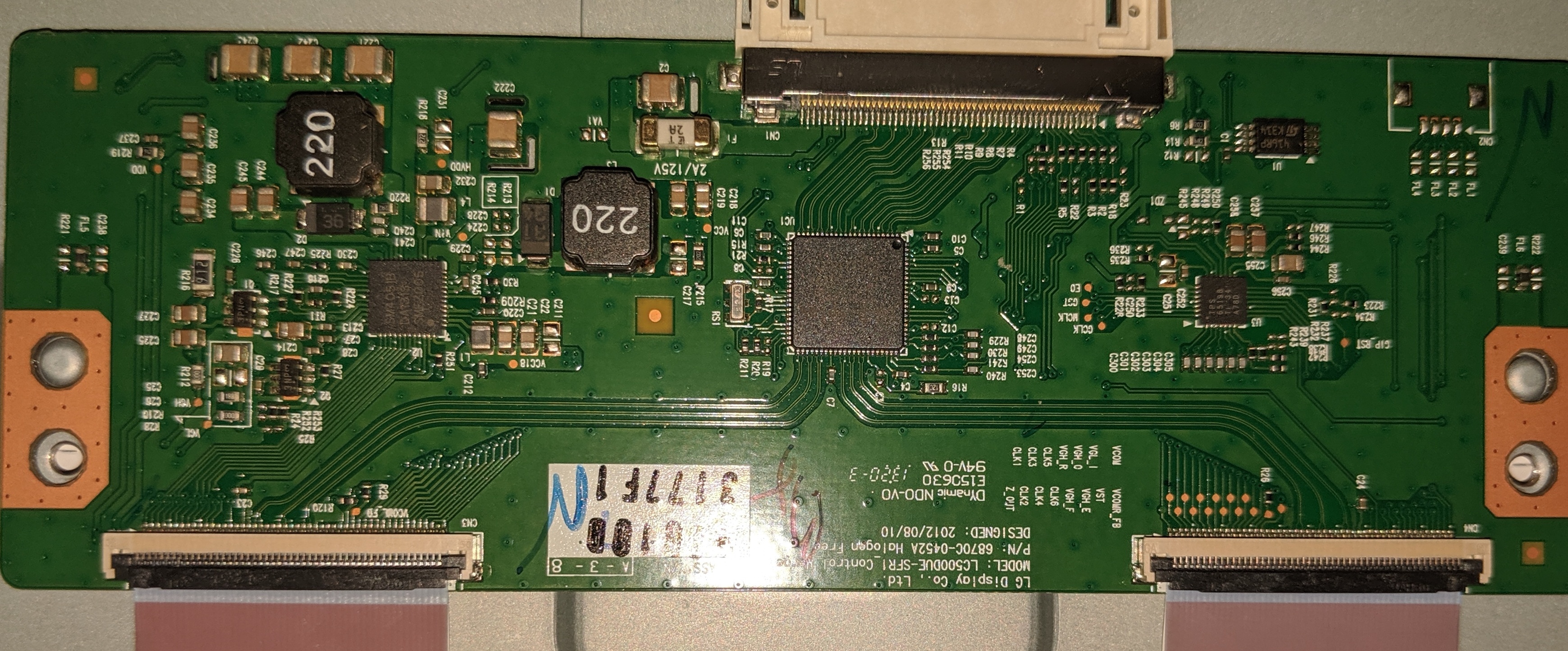

    Please LG TV no picture but sound slight buzzing
    As shown on picture there is a buzzing from the small board I'm not sure what it is and there is sound when plugging in hdmi but just no picture any opinions will be helpful as I don't know. The red standby light etc all seem to work as intended and the sound
    TV is LG-42ln578v

    Make sure tv is unplugged from power, leave the cable from tcon to mainboard plugged in, disconnect both ribbon cables from tcon to panel, the little black clips just flip up with a finger nail, never force anything, then plug tv in, turn on, see if buzzing is gone.

              So did you did disconnect the cables between the panel and the T-CON to see if the buzz goes away? It may have shorted circuit in the tab bonding board, I would not try to test the new T-CON if the panel has shorted circuit.

                If the T-con is the one circled
                Yes when i take one of the sides of the ribbon cables bottom right one the buzzing goes, leaving the bottom left cable in.
                If i swap and put the botton right in it buzzes again.
                So does it look like t-con or backights maybe do you guess?
                Or from what i said the panel may have shorted and may not be fixable as i don't have experience in this

                  It means you have problem in the panel that is loading down the LCD bias SMPS power supplies when the ribbon cables are not connected between the panel and the LCD panel.

                          You need to provide good close up of the T-CON board so we can start checking the Test points resistance.

                              May be or mat be not but the Buzz is coming from the T-CON, not from the speakers. If power supply is badly loaded, the buzz should appear on the speakers also. Will find out more when he start checking the DC resistance on the T-CON board with all cables in place.

                                https://imgur.com/a/7CffJoK
                                  Re: Please LG TV no picture but sound slight buzzing
                                  Put all the cables back in place then start checking the resistance between chassis and those test points (VDD, VCC18, VIN, VGH, VGL, HVDD) I marked in the picture.
                                  Make sure to report if the resistance are shown as in Ohms, K Ohms, or M Ohms. No power to the TV of course when testing resistance.
                                  I cannot read the P/N as printed on top of IC U2 (LCD bias power supplies), please provide the numbers.
                                        Managed to get better one with side angle
                                        All displayed as k measurement on my UT118A auto select
                                        VDD 2.295
                                        VGH 8.79
                                        VCC18 1.080
                                        VGL 1.498
                                        VIN 8.13
                                        HVDD 1.135
