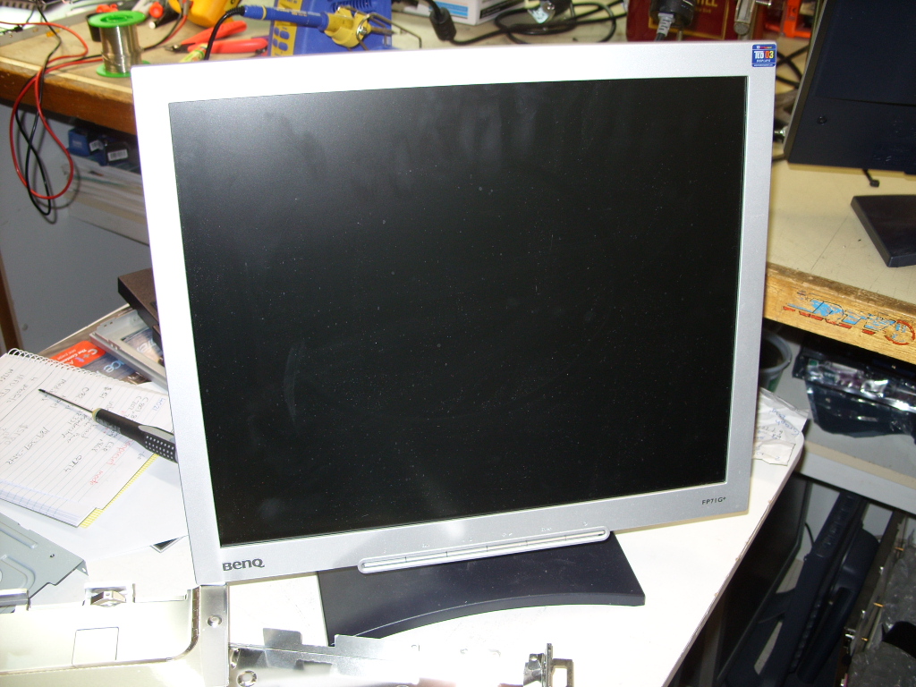

    Hi All,
    I have 5 of the above LCD's with all the same problem (and three OK). Lucky to have so many hey?
    On turn on the LED goes green and the BENQ logo is displayed, then the desktop is displayed and 'nonpreset mode' is flashed up before the screen goes blank. The power led then goes amber (stanby). Changing the resolution on the PC (I hooked two LCD's up on a dual video card to do this) will briefly get the BENQ to display and then die again, but the 'nonpreset mode' does not always flash up. No resolution mode will make the BENQ stay on.
    I can tell you it is not the Inverter Power Board but it is the Interface Board (M170EP01 V2). I have swapped the IP Board and it works on a known good screen.
    Any ideas would be appreciated.
    Jamie
  • PlainBill
    • Feb 2009
    • 7034
    Re: Benq Q7t4 / Fp71g+
    Originally posted by scb10
    Hi All,
    Jamie
    Good job of troubleshooting.
    Just the usual suggestions. Post a picture of the logic board (AKA interface board; control board). Look for bad caps with an ESR meter. Hope it's bad caps; if the main control chip is bad you are probably SOL.
    PlainBill

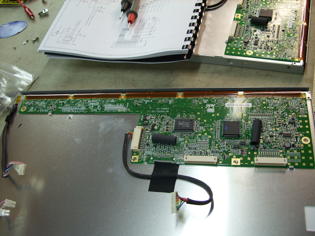

    • scb10
      • Aug 2009
      • 9
      Thanks PlainBill,
      Well as you can see it is all Surface mount components. I was hoping that the fact that I have 5 of these all with the same fault that there maybe somone out thier that has had the same fault and fixed it! I know I will be pushing it up hill to get BENQ to give me an answer.
      The black heatshrink on the board is my attempt to change the crystal from a known good board. Unfortunatly the tracks went well under the crystal and resulted in the ripping of tracks to get it out. Even with a good lead-free soldering iron. There is one fuse that is OK. I have checked diodes and transistors and a few caps and all seem OK. I am getting to the stage where it may be one of the control IC's but it also seems like a crowbar circuit is operating as it will stay on for at least 2-3 seconds!
      Cheers
      Jamie

        • PlainBill
          • Feb 2009
          • 7034
          Thanks PlainBill,
          Cheers
          Jamie
          A picture of what you refer to as the inverter / power board would be appreciated. The circuit board you are showing in the picture is what I usually refer to as the panel circuit board.
          So far every LCD monitor I have worked on consists of two or three boards. The power supply, the inverter, (these are often combined onto one board) and the logic board. The logic board has the VGA and DVI connectors, the video conversion controller, and the connectors to the buttons and to the LCD panel.
          I can't think of any reason why the logic board couldn't be integrated with either the power supply / inverter or the panel circuit; it's just that I have never seen one - yet.
          PlainBill

              • scb10
                • Aug 2009
                • 9
                I will get a photo of the board up for you. Oh and it is an Australian model, not that I would think that that would make any difference!
                Cheers
                Jamie

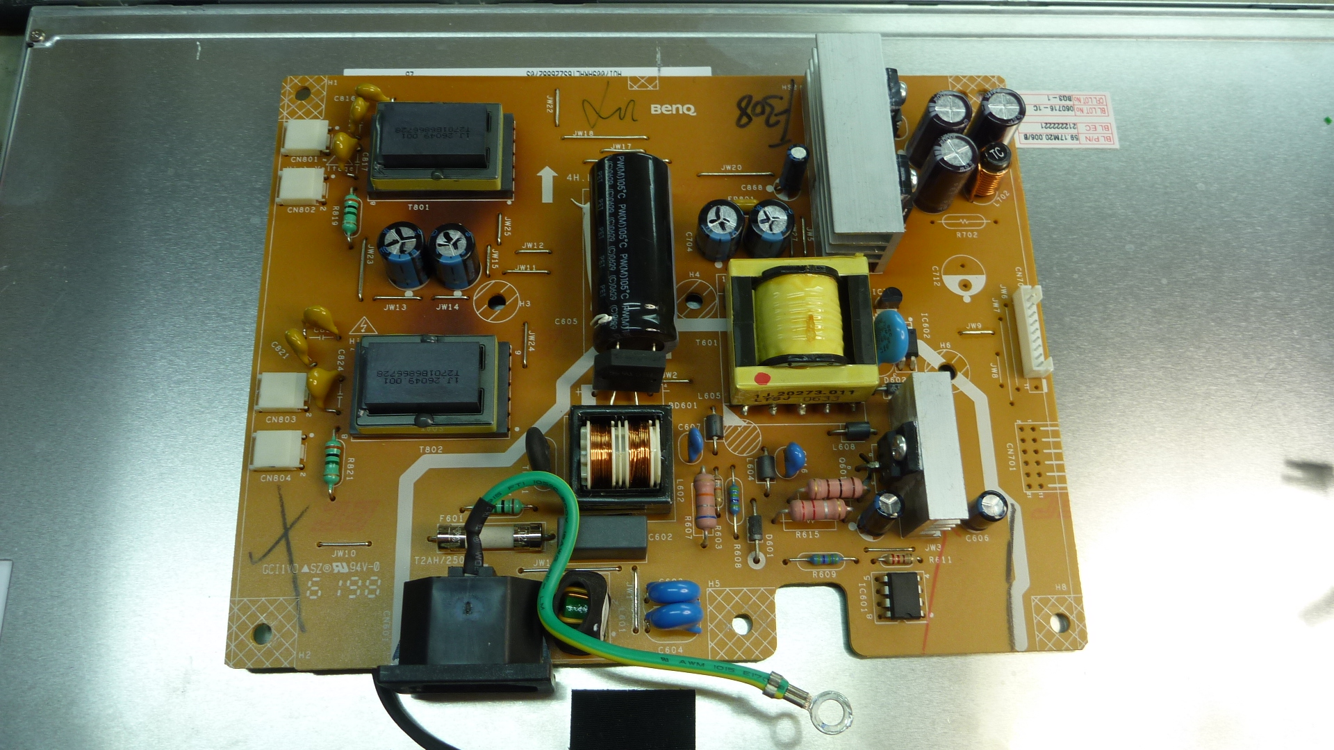

                • scb10
                  • Aug 2009
                  • 9
                  Here is a photo of the power board.
                  • PlainBill
                    • Feb 2009
                    • 7034
                    Well, they have definitely combined the logic board with the lcd panel board. That makes it much more interesting. The only thing that seems strange is that while I can see what appears to be voltage regulators on the logic / panel board, I don't see any capacitors.
                    PlainBill
                    • tmwalsh
                      • Jan 2009
                      • 119
                      Mr Plain,
                      I don't get it. What is showing on my screen is the power board. I didn't understand why it was being looked at, as the problem was determined to be in the QUOTE:
                      "logic board has the VGA and DVI connectors, the video conversion controller, and the connectors to the buttons and to the LCD panel." Yes this is the board I have a fault with PlainBill."
                      IMHO, what is needed is a picture of the logic board, not the power board.
                      tom
                      • PlainBill
                        • Feb 2009
                        • 7034
                        Originally posted by tmwalsh
                        Mr Plain,
                        tom
                        This fooled me too. Look at the pictures of the 'panel board'. Look at the connectors and the ICs on that board. Notice anything strange?
                        Benq has combined the logic board and the panel board into a single board. The two connectors are for the DVI input (which can handle both digital and analog signals) and the front panel switches.
                        PlainBill
                        p.s. It's PlainBill. No Mr Plain, definitely not Mr. Bill, and salutations such as Sir, or Your Highness are undeserved.
                        pb.
                        • scb10
                          • Aug 2009
                          • 9
                          Thanks Your Highness & tmwalsh
                          There are no more boards in this LCD, just two, and that the fault is on the Interface Board or could it be the fluro's?
                          Just thought someone may have come across it.
                          Cheers
                          Jamie

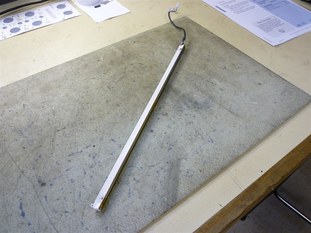

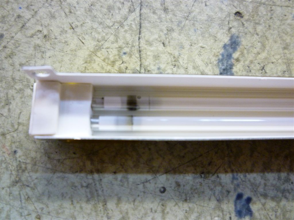

                                  • scb10
                                    • Aug 2009
                                    • 9
                                    FIXED!
                                    One of the techs here found a posting in another forum that led him to belive that the fluro's were the issue.
                                    BINGO.... The ends short with the chasie and cause the LCD to shut down. We got replacement fluro's from the USA on eBay.
                                    SO PLAINBILL you were barking up the correct tree. It was the CCFLs.
                                    Thanks all for your inputs. We now have 6 of these so I would imagine this to now be a common fault.
                                    Cheers
                                    Jaden

                                      • scb10
                                        • Aug 2009
                                        • 9
                                        Just a bit more. It is a big job to replace them. Look for blackend ends of the CCFLs (PHOTO'S ATTACHED). They must break through the glass. When they were replaced they are extreamly easy to break.
                                        Sorry for posting in wrong forum. Did not realise there were others! But more the merrier.
                                        Jamie
