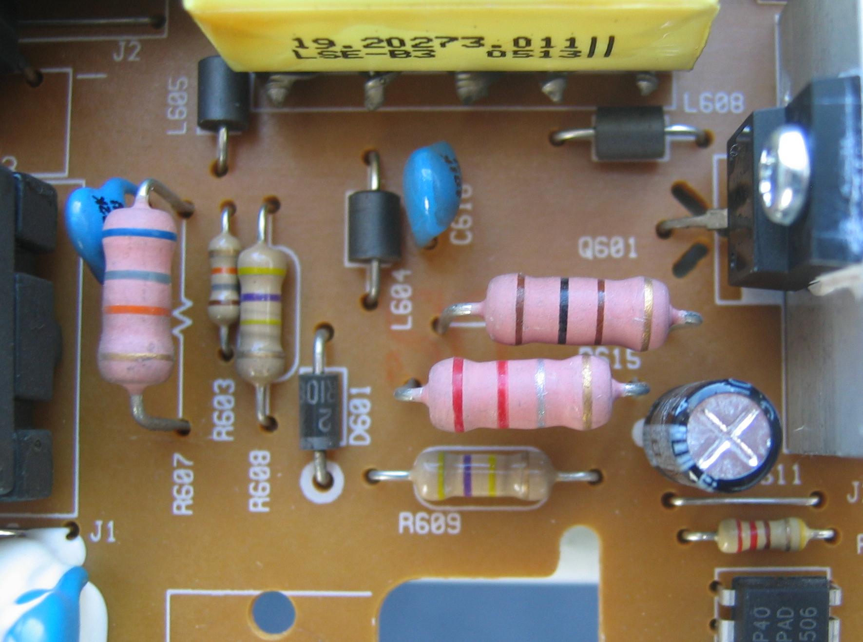

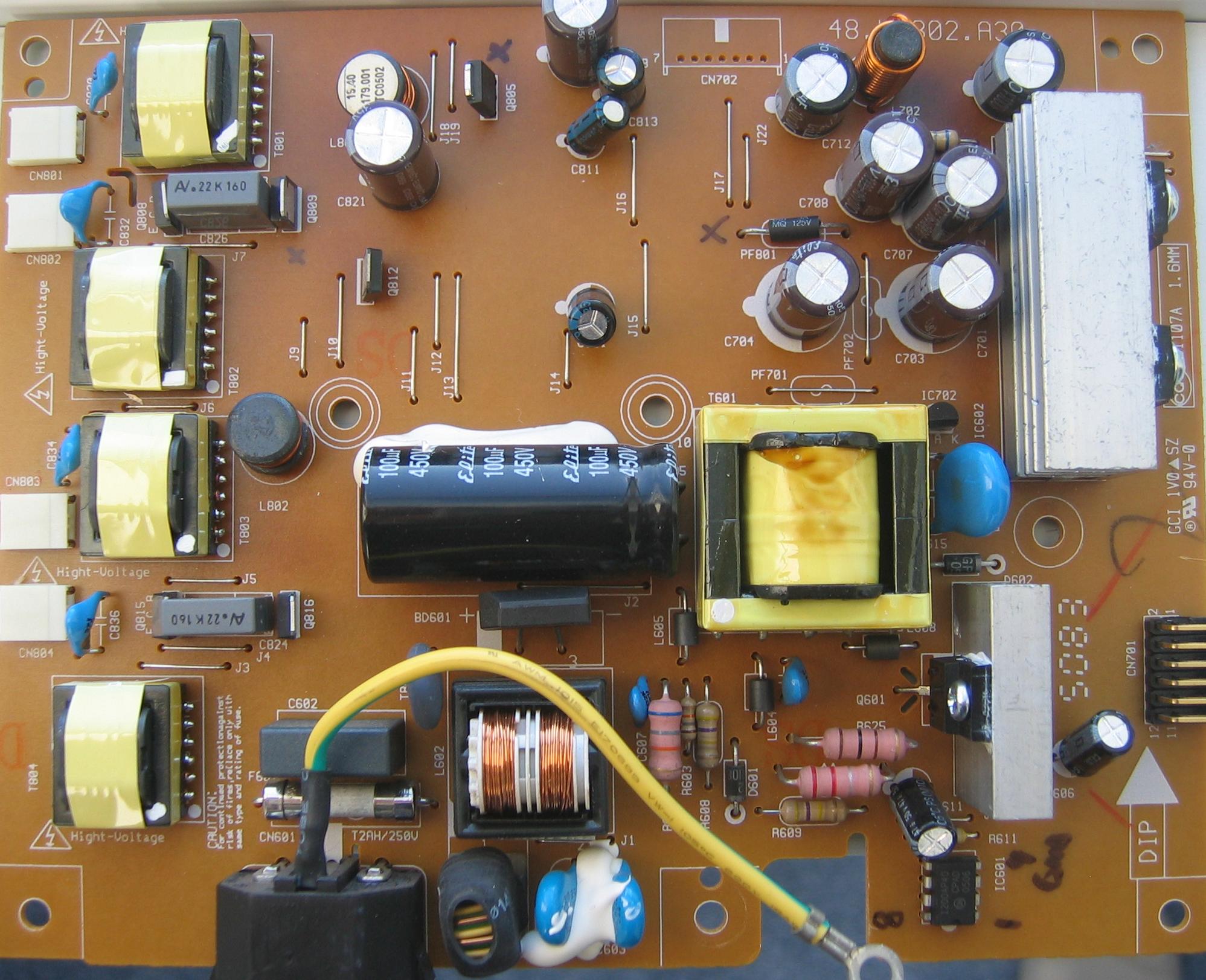

      I have this LCD moniter with few resitance burned out to black in the Power supply board. Is it possible for any one to post the circuit diagram or a picture of the power supply board.

        Lucky for you this FP71G+ is sitting right on my desk and it is a sunny day out today.
