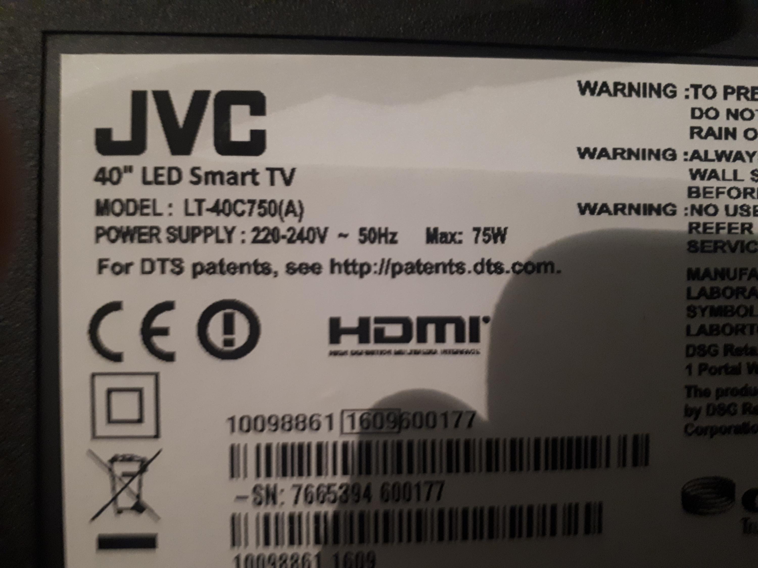

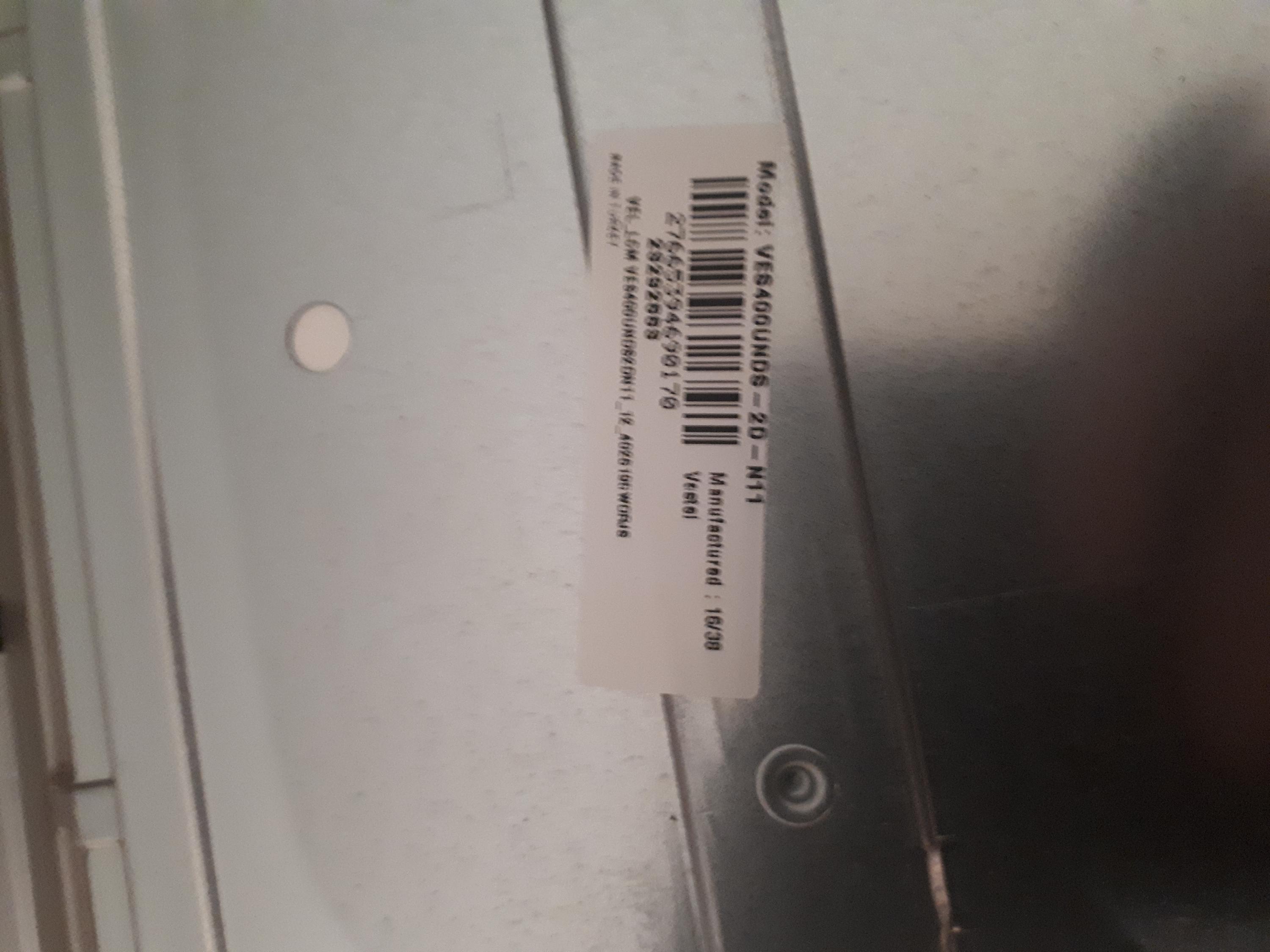

            What is the LCD panel model number?

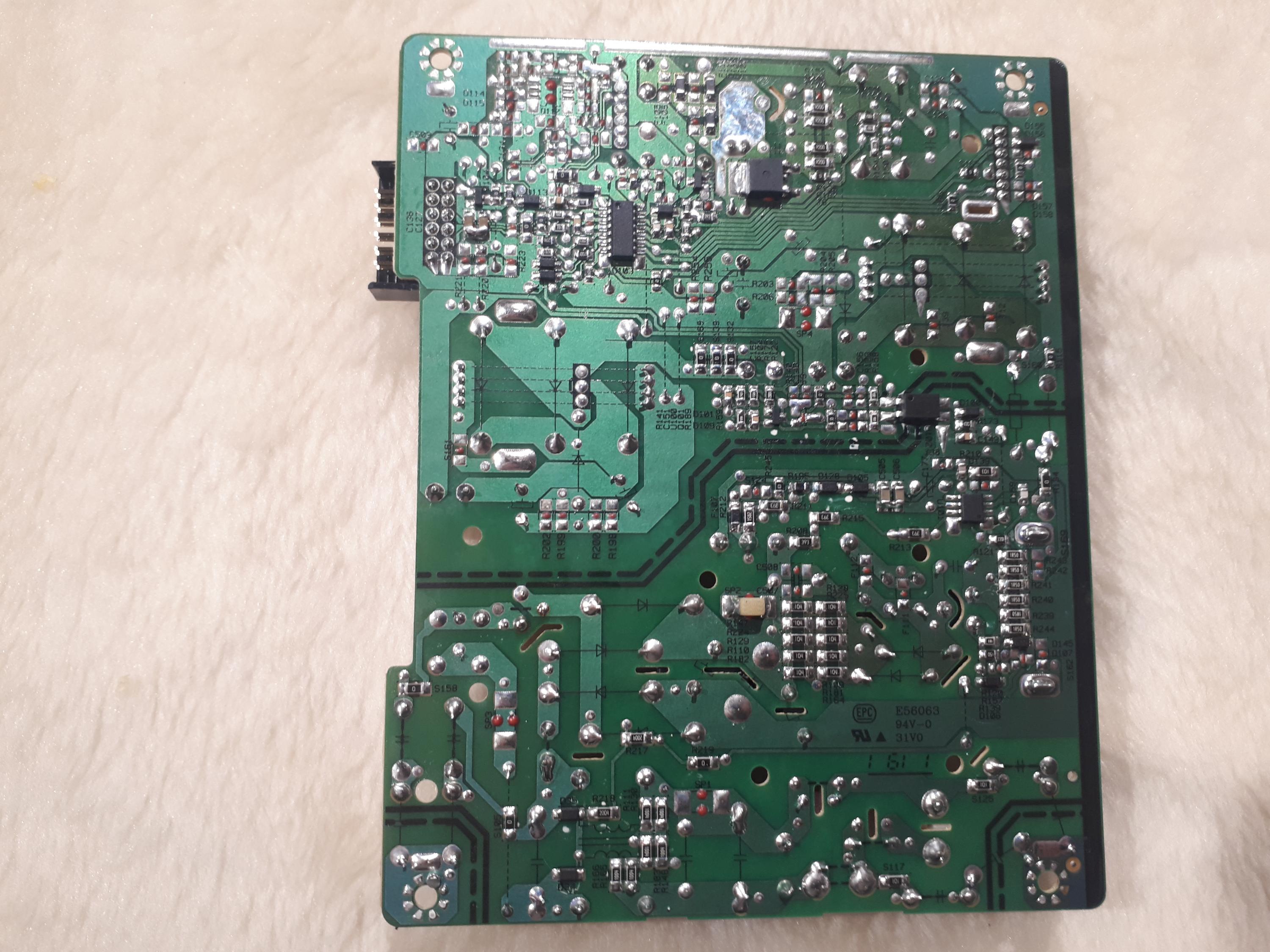

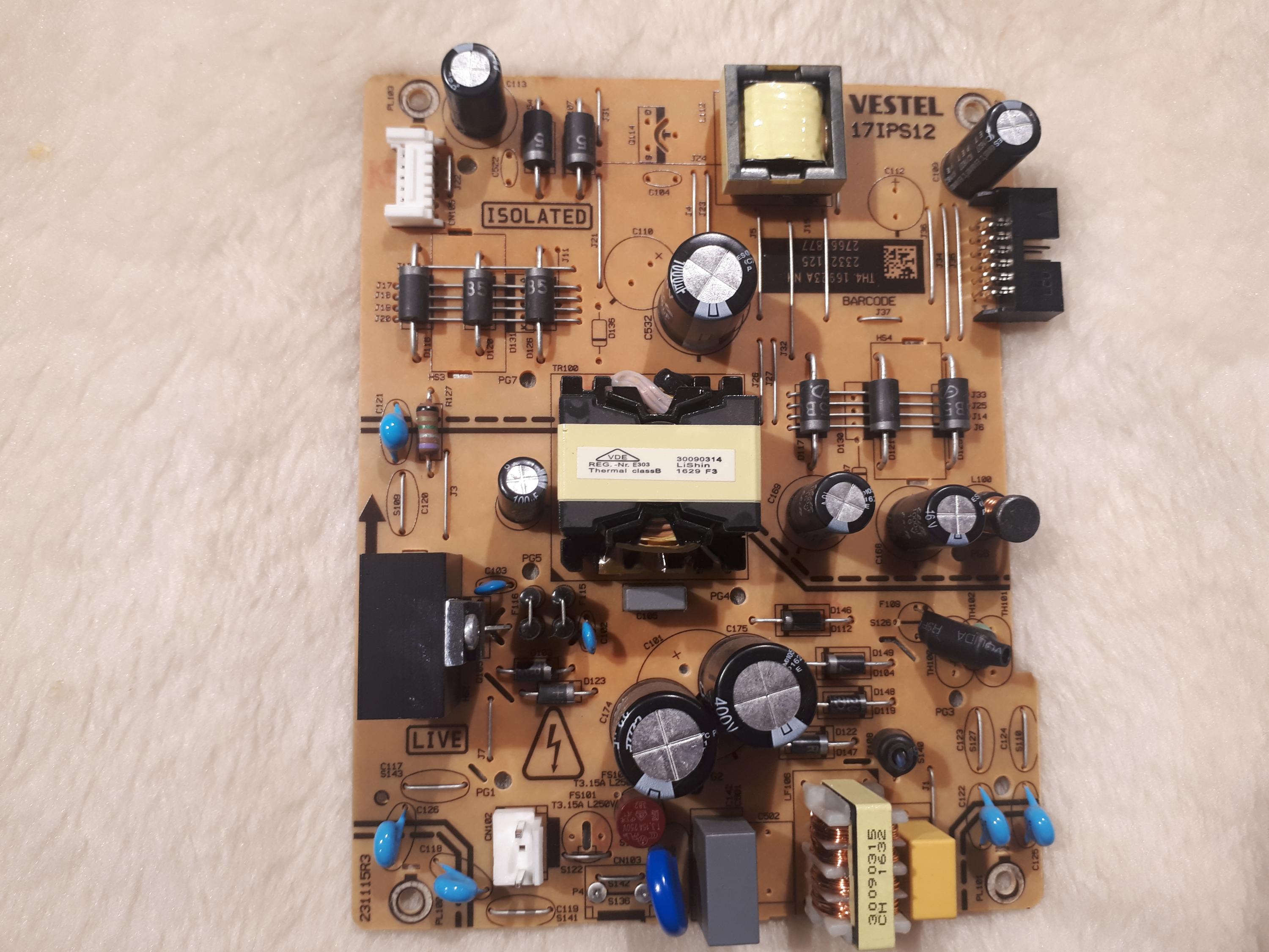

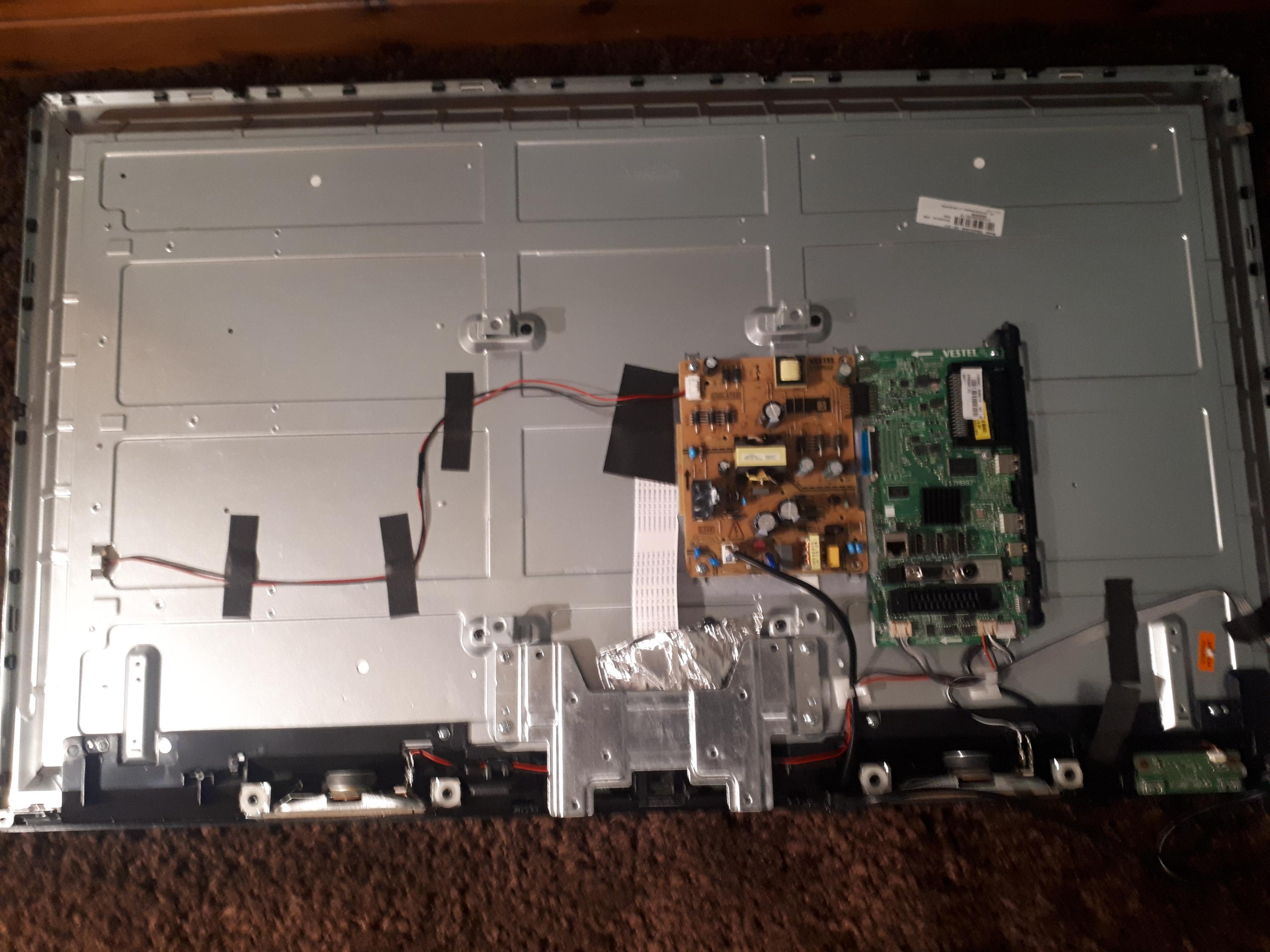

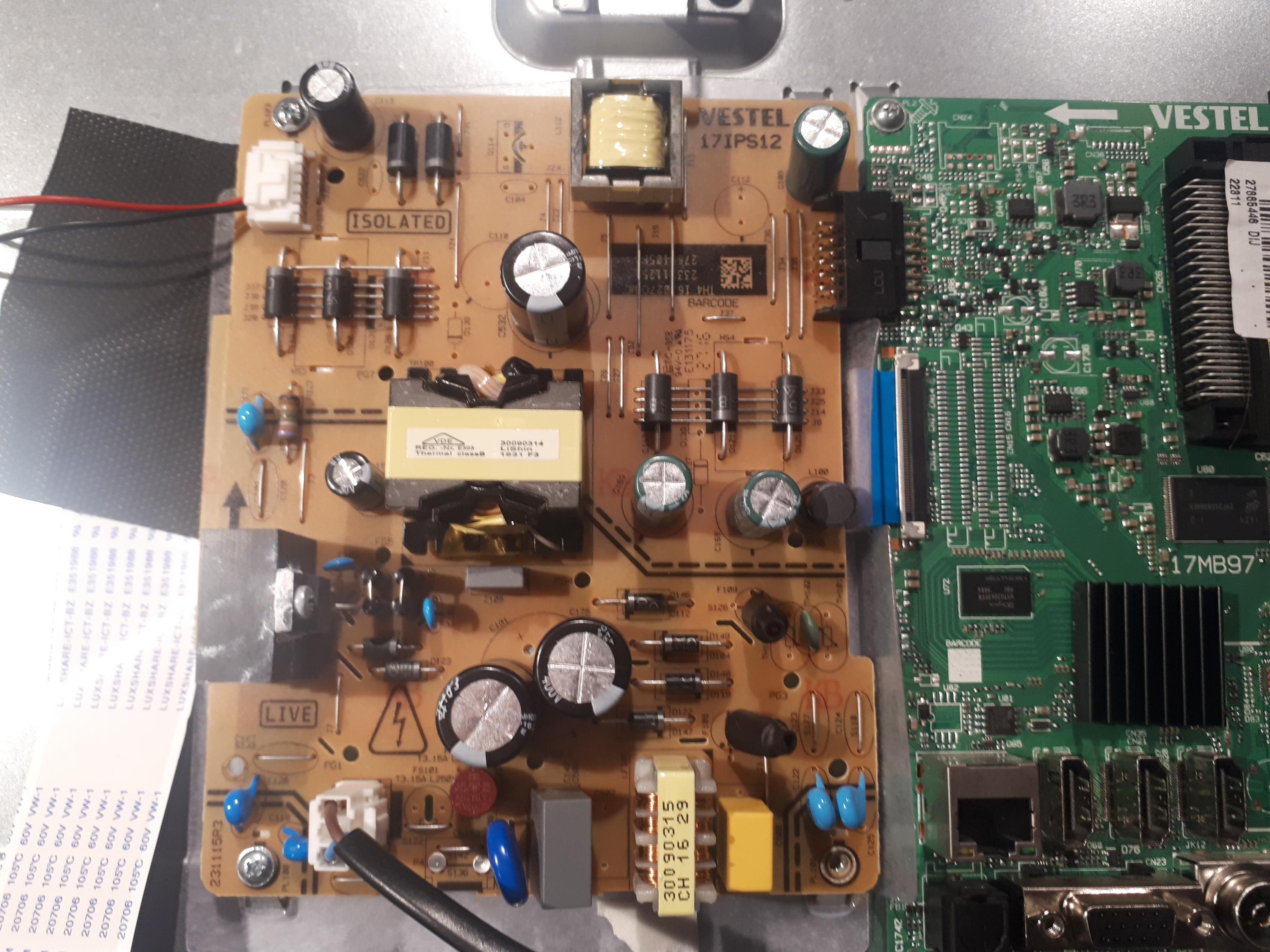

            Can we see the hwole top and bottom side of the power supply board and the whole back side of the TV showing all the boards?
              Re: Jvc led tv
              Pics attached of back of tv, psu and lcd panel number.
