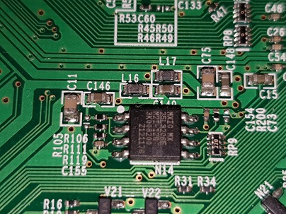

    i disassembled the Flash IC, HDMI IC and sound IC and check all smd capacitors for any short then connected tv same 5 v always on

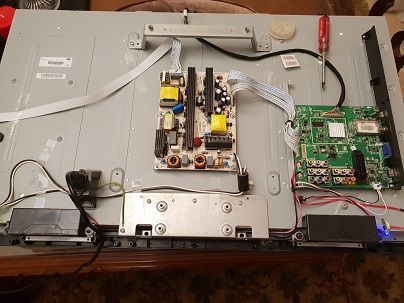

    Re: Hisense LCD39V77PK Blue led directly no sound no picture
    start to upload photos on whole back of the TV show how they are connected. also photo on the main board and remrk which IC you are talking on and the NO. and which regulator you replaced. also show us clear photo of the PWB especially the socket which feed MB
    so we can start trouble shooting..

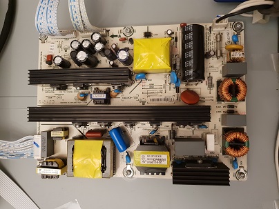

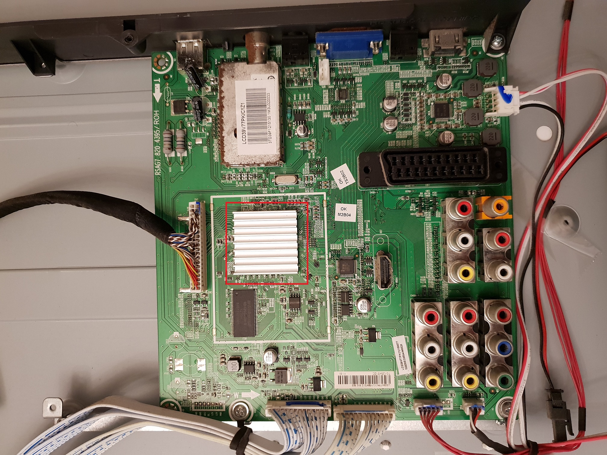

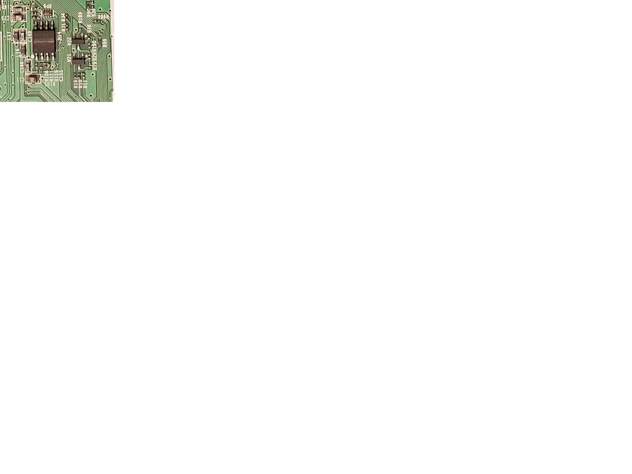

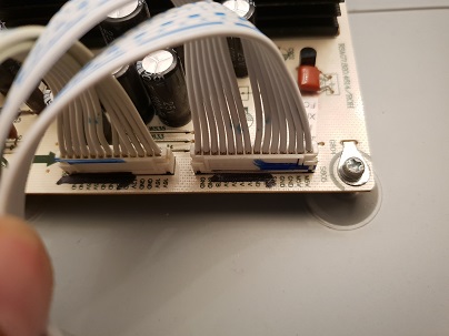

      This is the whole back

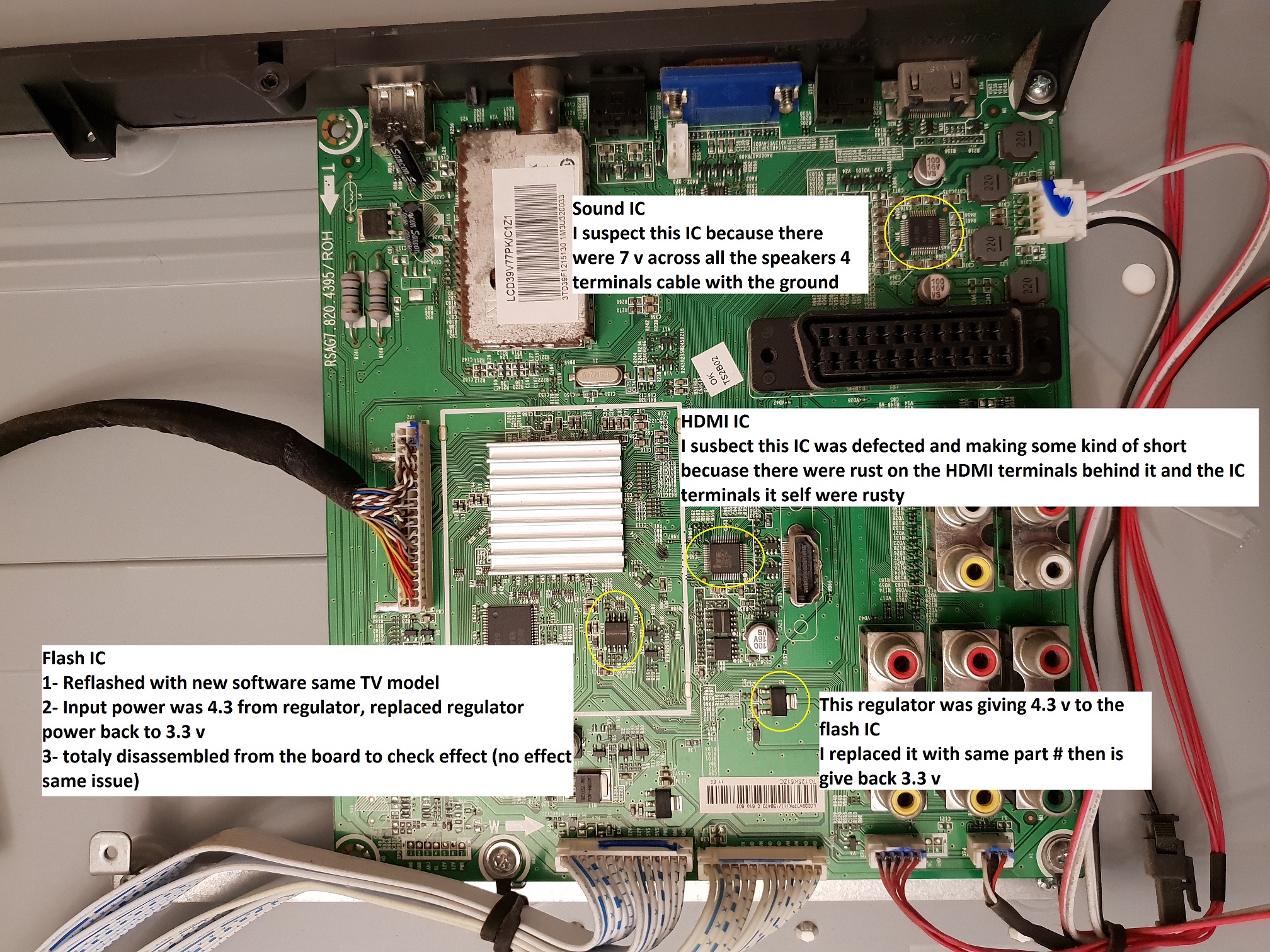

      This is the main board
      This is the power board
      power board voltage distribution

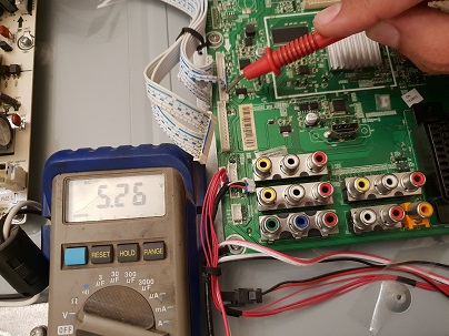

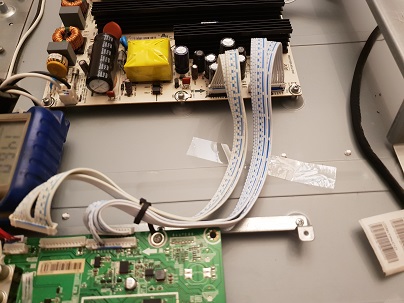

      connecting only 5 v (standby voltage) to main board

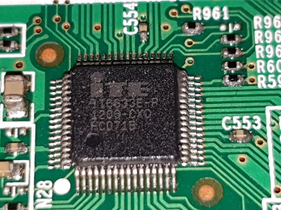

      measuring pwr switch (pwr signal) pin from main board to power board
      IC which have been replaced and disassembled

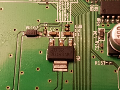

      Voltage regulator
      Flash IC
      HDMI IC

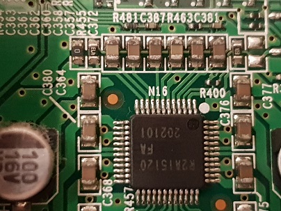

      Sound IC
        okay, the Regulator you changed brought back the 3.3 V to the SPI eeprom. you had just re flashed firmware and no change. mean your SPI Flash in bad condition because of the over load Volts
        also i cant tell you take out the SPI out from board to flash it again... flash bin file on eeprom should be done out side the circuit after format the SPI and blank check.. if this didn't bring the set back then change the SPI
        could you write the SPI Flash No.?
          Thank you for your support
          SPI flash no MX25L3206E 4 MB flash
          But actually i am not suspecting the Flash IC because if it is removed it must bring back the LCD to Standby status with the Red LED lit not the blue led and then the LCD will not respond to remote or fixed buttons.
          However the condition also after removing the flash SPI out of the board same issue blue led with power board on for all voltage as if i opened the TV from power button.
          N.B.
          I have removed the SPI flash and flashed it with the RT809F programmer with same firmware found it from other forums.
            check out of circuit the 2 transistor bridge on the right side near to SPI. they are responsible to switch On PW ON and and Stand by Led signal too.. they should be PNP & NPN type as i call back.

              one things more, the SPI flash MX25L3206E 32Mb not as you mentioned 4Mb. and its operation bus Sock between 2.6 -3V regard Macronix specification
              so if your programmer read it just 4Mb mean its diffidently bad

                  Yes already checked both are same type PNP (H1A code).
                  Yes as you said they are both connected directly to the PWR signal for the PWR board but from where they take the 5 v signal to pass for the power board?
                  Does it comes from the main IC?

                      yes exactly took the order from main CPU. but if you read the specification of the SPI. the STB are not really deep power off. it mean it remain On but as sleep mode.
                      this can quids us for point. take the set out from wall socket.. leave it for view minutes off then.. press the power on tv side panel and keep it press for 1 minute.. then press with it menu on the tv and keep press then plug it on.. hope the screen will come back

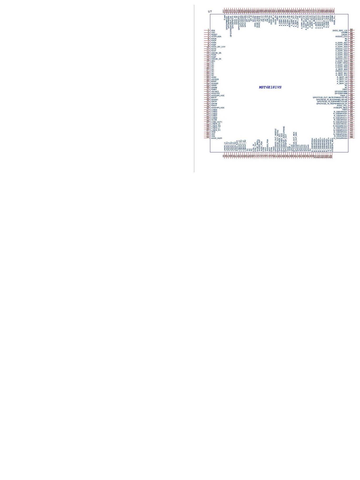

                                • revenger132
                                  • May 2019
                                  • 13
                                  • Egypt
                                  This is the IC schematic

                                    • revenger132
                                      • May 2019
                                      • 13
                                      • Egypt
                                      MST6E181VS-LF-Z1
                                      Do the TV will directly operate the power board if i took up the SPI flash out of the board?
                                      I think if the SPI flash is the concern it should keep on the standby mode no 5 v power signal go to the power board with all same symptoms (no picture, no sound, no response to buttons or remote control).
