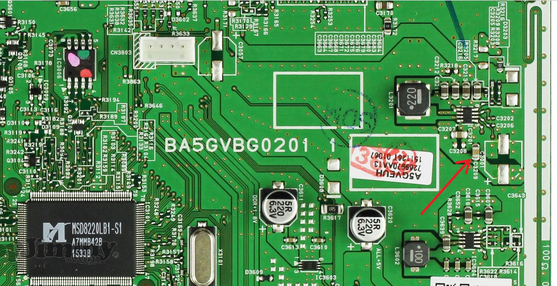

    Sanyo FW43D25F main board short
    Found a shorted capacitor (C3209). Is there any way to determine what the value is or close to it?
  • R_J
    • Jun 2012
    • 9588
    Re: Sanyo FW43D25F main board short
    It should be around 4.7µf 35v
      Originally posted by r_j
      it should be around 4.7µf 35v
      +1
      • kevinm34232
        • May 2012
        • 1884
        Thx got it working..
