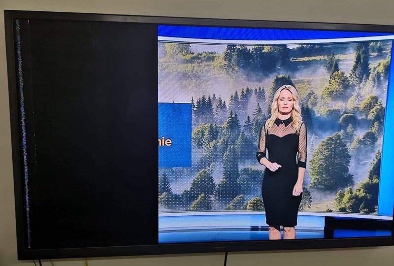

    2nd tv is Samsung F8500 64inch:
    TV have a issue where third of screen is black,while the rest of the screen looks normal.

            power supply is doubtful as its working now, the samsung has three buffers at the bottom of the screen I found a picture of a pn64f8500 with the back off. they are e,f,g, buffers it will be the one directly under the black part of the screen. I don't have the same tv to tell how they come apart. but they do in three sections. now back to noisy ps I assume you mean static and snow in the picture? if so its probably dragging down by the bad boards. still you may need to adjust va and vs voltages due to a different board. I have replaced some that were spot on and some way out of spec. there is a sticker on the back of the screen saying the voltages.pick up a decent digital meter in case you get a lot of sparkles or mal-discharge

              Re: Plasma TVs repair:Panasonic 50"ST50,Samsung 64"F8500
              https://www.tvserviceparts.com/Parts...8500AFXZA.html
              here is a link to the Samsung parts down the page you will find e buffer,f buffer and g buffer. you didn't give the full model number so I used what you gave and this is the one I found. you would need to check the board numbers as well to make sure they are right. you only need the one directly under the black part of the screen.

                Excellent
                I'll try that Samsung first,it looks like the best solution and it should really work.
                I even contacted decent repairman for tvs,he should help me with those SS/SC boards.
                Thank you very much for your help.
