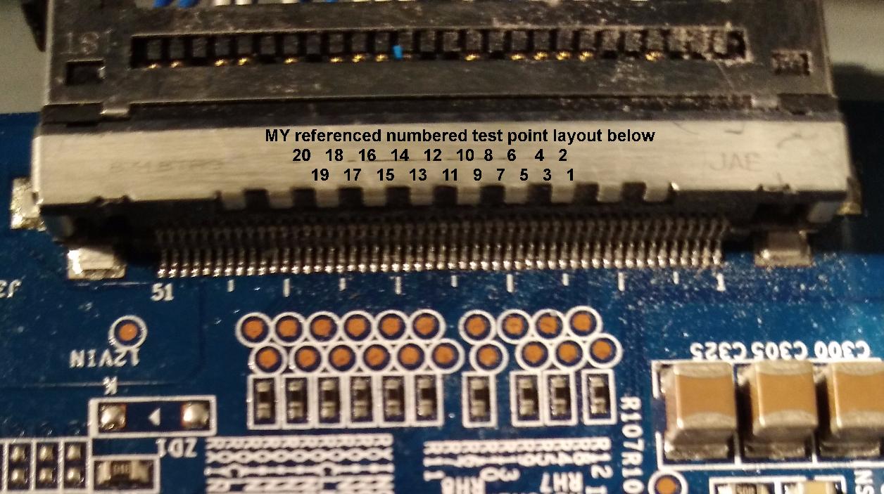

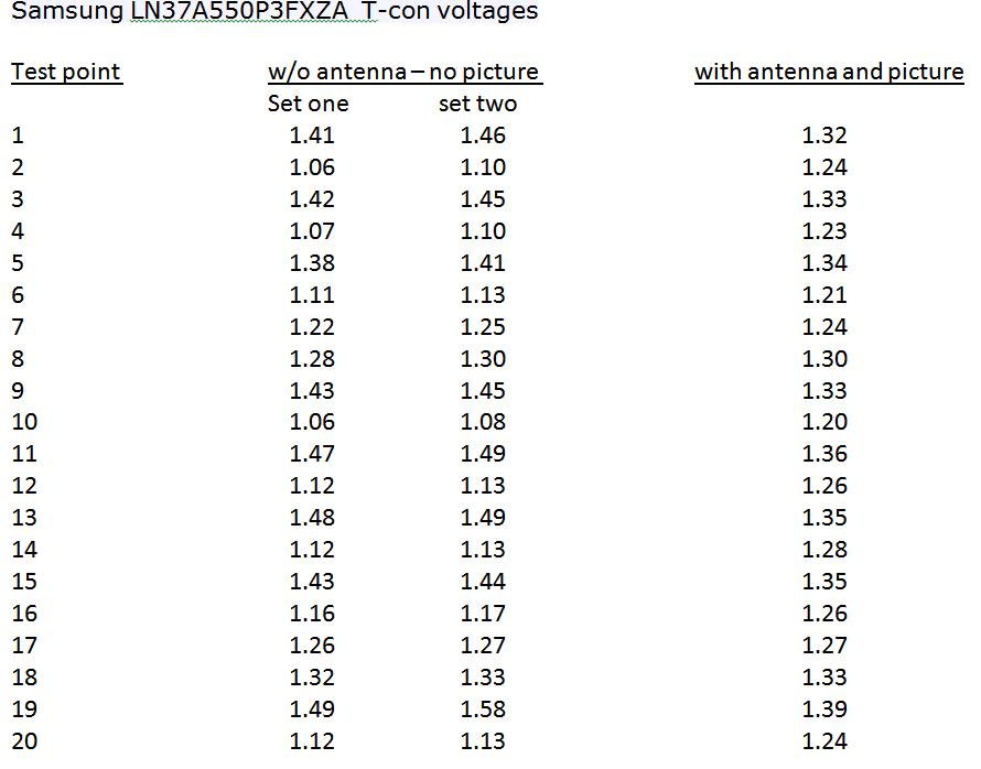

    I seem to have the washed out pictures on my Samsung LN37A550P3FXZA. And have tested my T-con board voltages. My problem is that the board does not give the numbered sequence so I can easily tell if they are increasing/decreasing in order. So I number them myself as in my attached pictures and the voltages are:
    Samsung LN37A550P3FXZA T-con voltages:
    (text formatting this forum not good for tables - see attached picture)
    |Test | no antenna | with antenna
    |point | no picture | and picture
    | # | two sets| | one set
    col |Set | Set |
    num | 1 | 2 |
    1 1.41 1.46 1.32
    2 1.06 1.10 1.24
    3 1.42 1.45 1.33
    4 1.07 1.10 1.23
    5 1.38 1.41 1.34
    6 1.11 1.13 1.21
    7 1.22 1.25 1.24
    8 1.28 1.30 1.30
    9 1.43 1.45 1.33
    10 1.06 1.08 1.20
    11 1.47 1.49 1.36
    12 1.12 1.13 1.26
    13 1.48 1.49 1.35
    14 1.12 1.13 1.28
    15 1.43 1.44 1.35
    16 1.16 1.17 1.26
    17 1.26 1.27 1.27
    18 1.32 1.33 1.33
    19 1.49 1.58 1.39
    20 1.12 1.13 1.24
    From this forum, I guess my T-con is bad. Why are the numbers so different with and without the picture? Should they be different? Can it be anything other than the T-con board? If I choose to replace the gamma chip, is that most likely the ONLY thing that can be wrong with the T-con board? Otherwise, the TV works as normal, and the MENU is aligned straight, no jagged edges, but has unusual colors too. Has anyone had success buying from the many available Samsung T-con boards available directly from china? Please advise.......

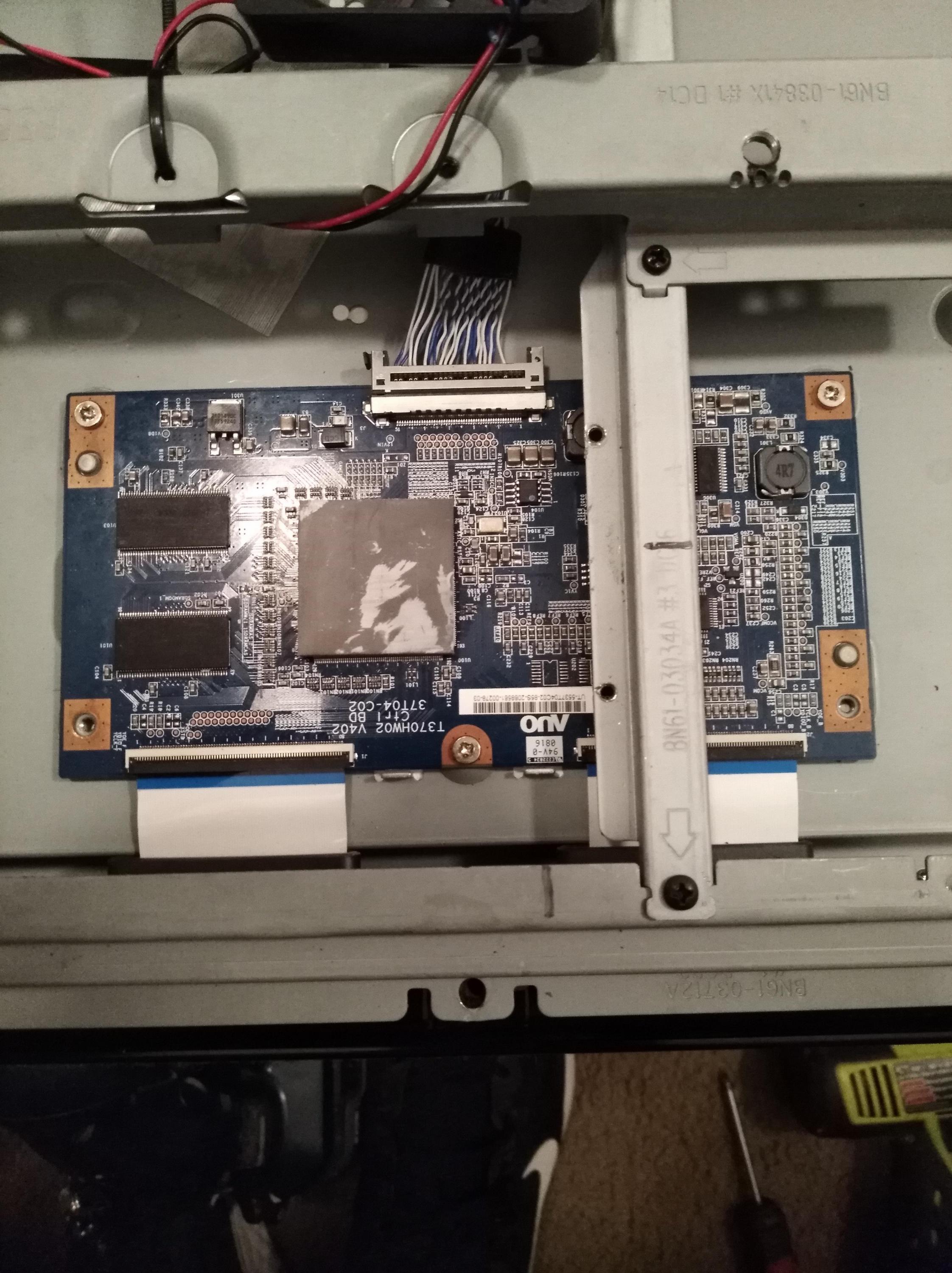

    Those aren't gamma voltages you've measured. A photo of the tcon will help.
    I've found a photo of your TV. There are no gamma test points. Just replace the gamma IC.
    I've replaced loads and it's those every time.
      Re: Samsung LN37A550P3FXZA - washed out colors
      https://www.badcaps.net/forum/attach...3&d=1558713584
      VGMAxx are the GAMMA Voltage test points, they are close to the connectors that go to the LCD panel.

          Yeah, source from Aliexpress or ebay if you can't wait, they aren't very expensive. They have a ground pad underneath so hot air to remove. Don't forget to replace the silicone heatsink if it has one.
