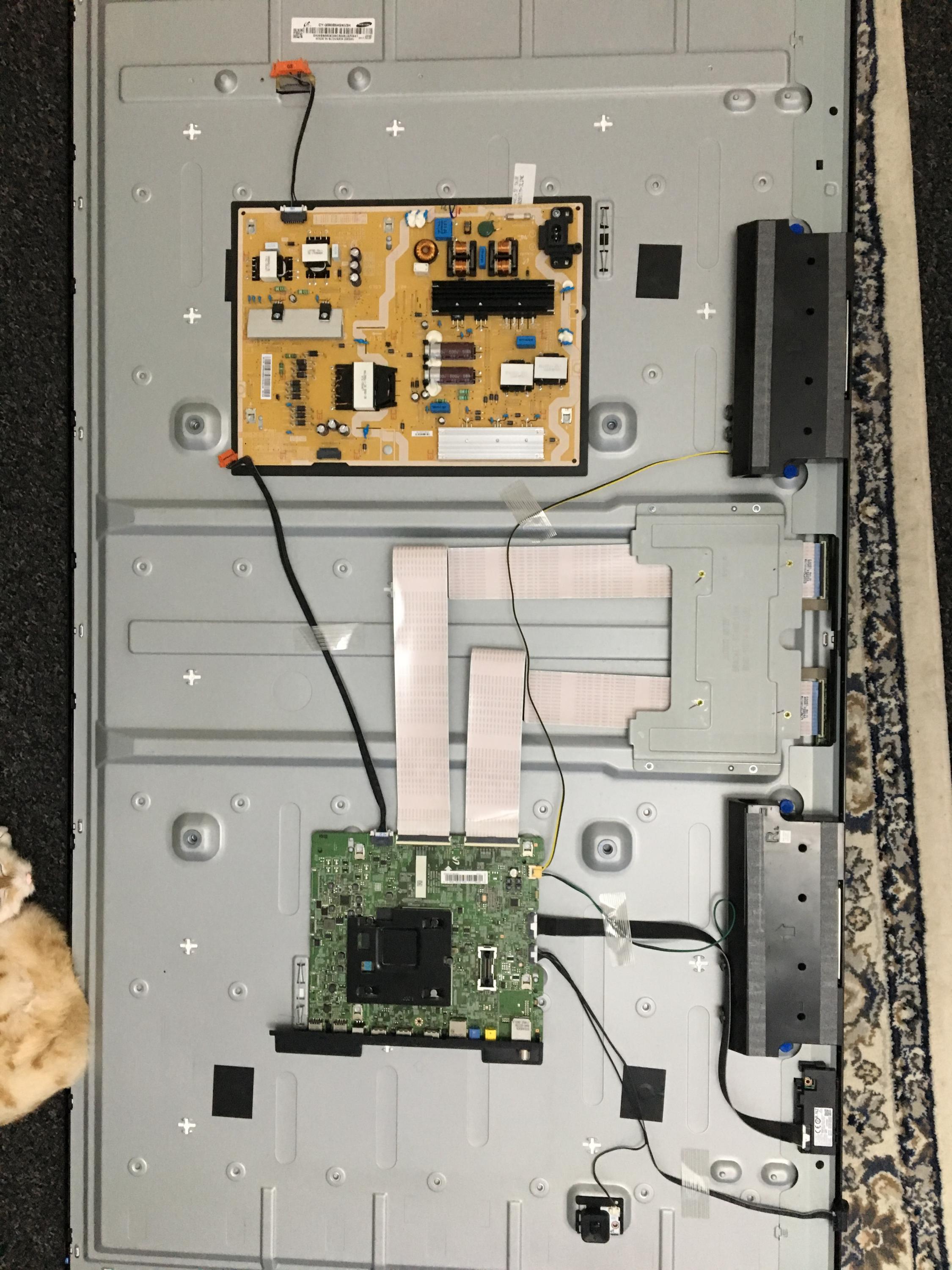

    Just picked this tv up very very very inexpensive and just over one year old, I will keep it for myself once working
    Been told switched on one morning and it was dead only the red standby led flashing when remote buttons pressed
    Got it home, removed back cover, that was interesting with no screws holding it.
    First check was output to leds when powering on, good but tv not powering up.
    Removed cable from power board to mainboard, screen panel lit up, so I assume led's are ok

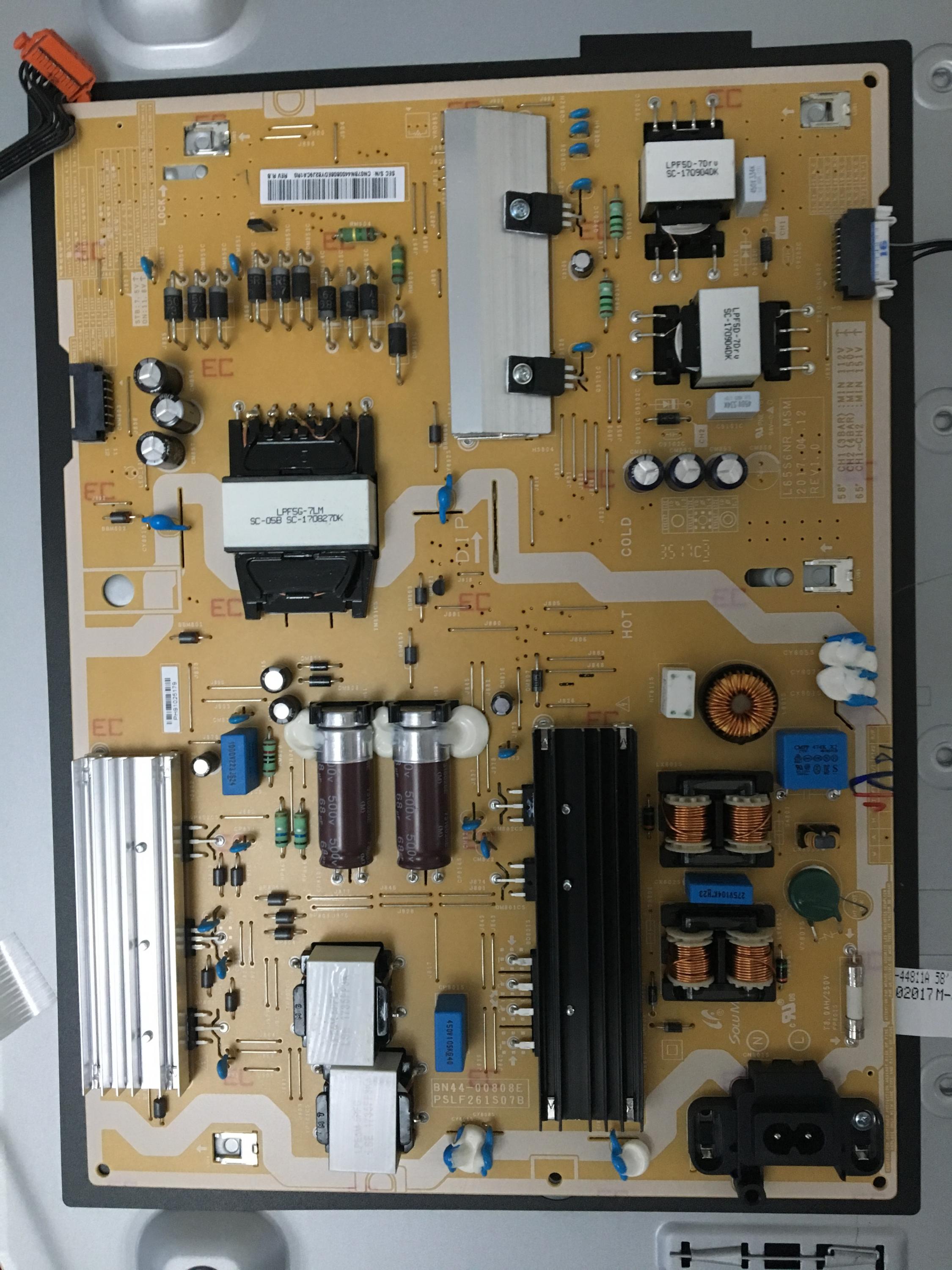

    Checked all voltages on powerboard and all seem to be ok, maybe I am wrong.
    1/ 2.65v
    2/ 2.76v
    3/ 12.95v
    4/ 3.62v
    5/ 12.95v
    6/ 3.14v
    7/ 12.95v
    8/ 3.95v
    9/ 12.95
    10/11/12 all 0v
    powerboard BN44-00808E
    Mainboard BN94-12640G
    If these power board readings are ok will I be correct in assuming this is a mainboard problem
    Any help with this appreciated, thanks
    Will post pics in a few minutes

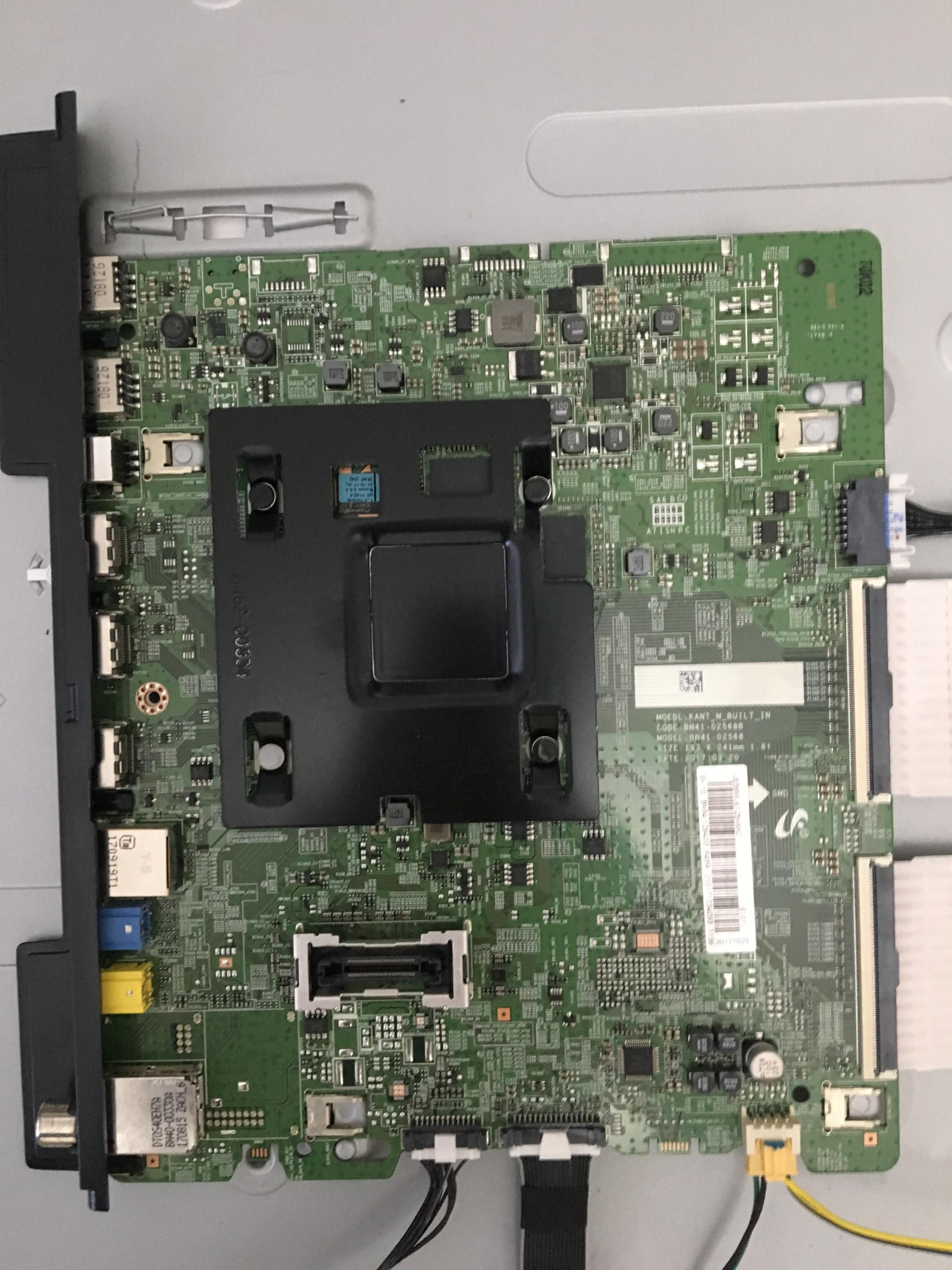

    Pics of boards

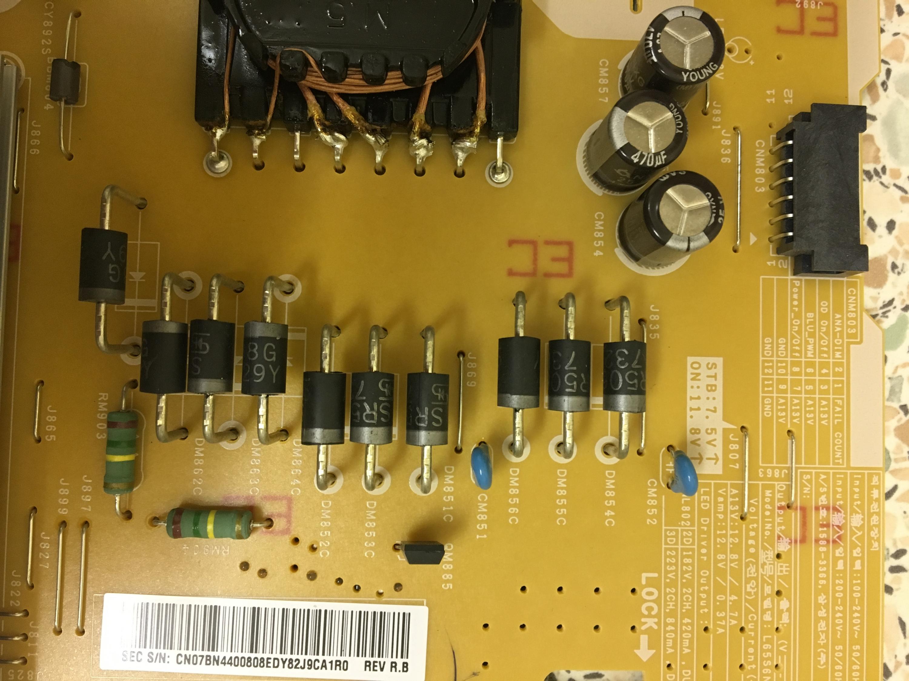

      put it in stand by. and check PSU J807 how much V you have, as listed it should 7.5

        Hi thanks for that just checked j807 getting 12.9v, pressing power button does not seem to make any difference to this 12.9, can not get 7.5v

            Yes I think the set is in standby the red led is on and not flashing, I have 12.9v
            if I press power button led flashes a couple of times then goes back to stable on, the 12.9v does not seem to change whilst the led flashes, it seems to be at 12.9v all the time there is power to the powerboard, If that makes sense

                Hi budm pin 8 @ 3.95v does drop to zero volts when power button pressed but back to 3.95 when power button is released. J807 never gets the 7.5v

                  just tried J807 again, 12.9v if I press and hold the power button, just for a split second J807 drops to 9.9v and then immediately goes back to 12.9v with the power button still pressed

                          1- put the TV in stand by mode, plug any DVD or blue ray device with HDMI at ARC function input then turn on the device you connected to the TV. check how the TV response
                          2- take out the black cover of the cpu, and freeze the eeprom and all component around then plug it in wall socket.

                            Hi As per Diah Froze eeprom and surrounding area, still no power up
                            No change when HDMI input made
                            • london-freddie
                              • May 2015
                              • 472
                              Re: Samsung UE58MU6125K flashing standby led only
                              CPU on mainboard does get warm, so getting some power there

                                inspect the MB all inputs pin if there are short

                                  Hope I am not wasting money but have just taken the plunge and ordered a replacement mainboard, listed as brand new from a seller in Spain, only one that I could find same as that currently fitted to the set, Now a long wait for the postman
