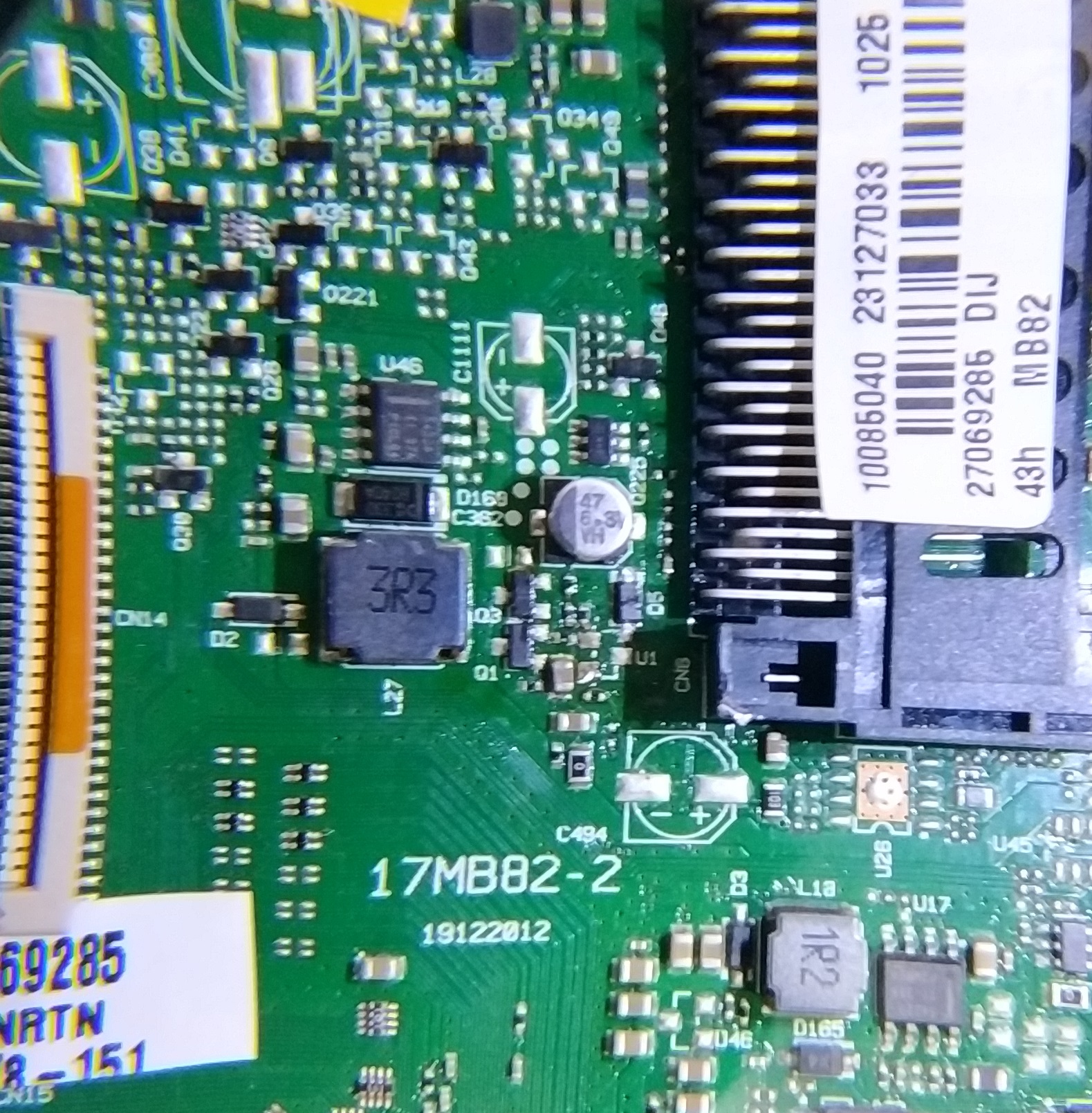

    Hi everyone, I have this TV that turns off after a while that is on.
    I changed the diode D107, and I was trying.
    Unfortunately while I was measuring the voltages I jumpered + 5_Standby with 12Vcc (for distraction). and obviously everything went out.
    Everything was mounted, power board 17IPS11-R4 and the 17MB82-2.
    I tried the 17IPS11 power card alone, but there are no 5.2V stand-by voltages, the 2.4V ST_By.
    The 12V and 24V are there.
    In the card the following components are not mounted which should have given me 5.2V:
    R103, R174, D113, Q104, C127 and C136.
    Does this mean that the standby supplies me the motherboard?
    Thank you
    PS. do you have the main 17MB82-2 card?

    Re: Telefunken TE32182B29C10
    This power supply uses 12 volts for the standby, the lower voltages (+5v)are developed on the main board
    24 volts is usually switched by q106 (if mounted) it is controlled by ST_BY from the main board.
    Jumping +5V_STBY to +12VCC, likley did no harm to the power supply but may have damaged something on the main board, check where the +5V_STBY line connects on the main and check any components
    Did the whole tv turn off or did you just loose the backlight and still have sound?
    Your original problem is could becaused by a bad led in the panel.

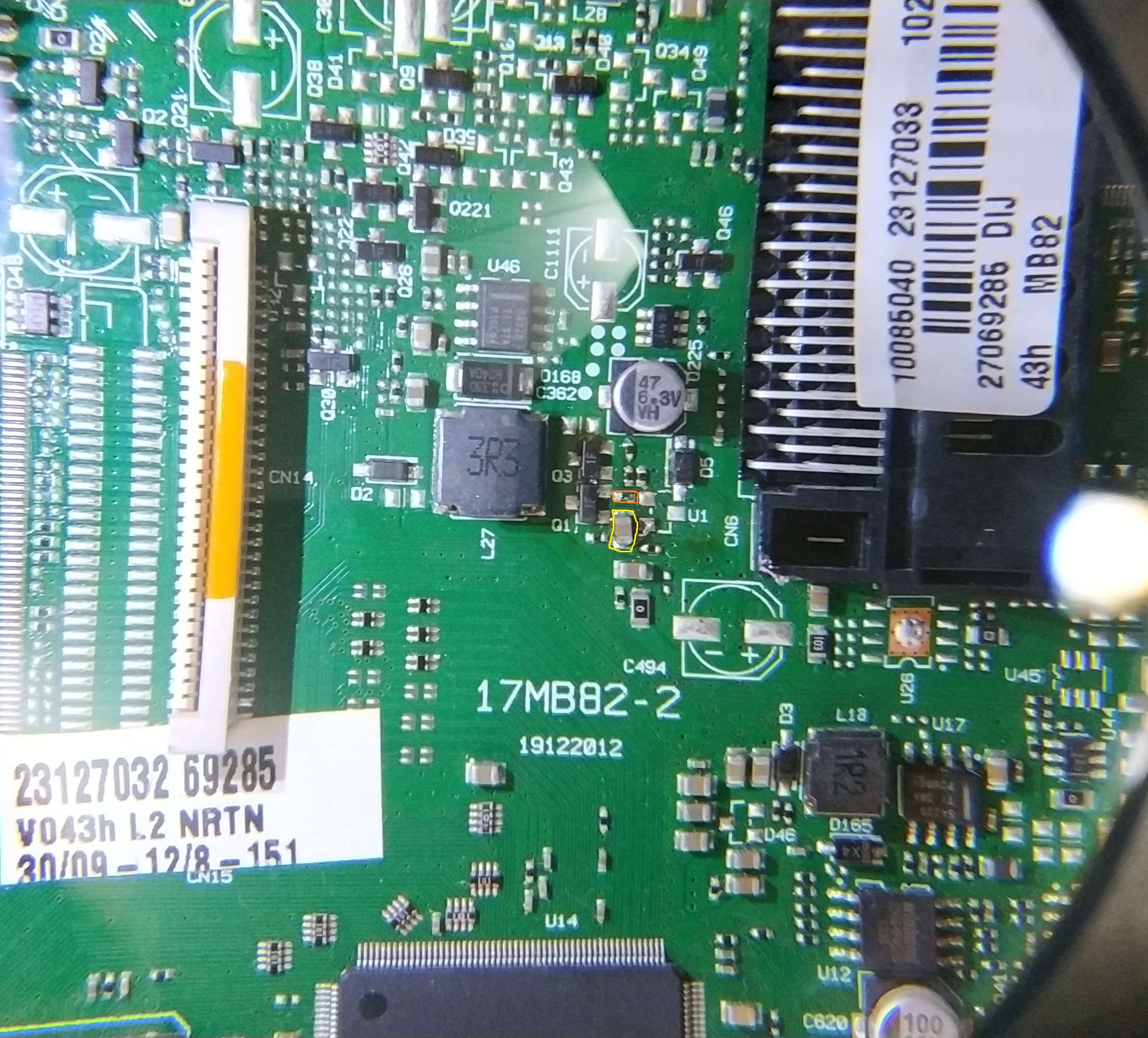

                          I did some tests.
                          The D5 marked me as a fault, because I had a continuity in it, you have your clothes.
                          On the other hand it was not like this.
                          I disconnected both the resistance marked in orange and the condenser marked in Yellow. I have removed U1, but I have broken it off. (TL431SAMF2).
                          Returning to the D5 because it seemed to be short-circuited.
                          I noticed that you have leaders of the yellow capacitor, the tester shows me about 1.5 ohms, that is a very low resistance. it sounded to me believing in a short circuit.
                          it's normal? Both with the condenser attached and detached.
                          comuqnue this part of the circuit should give the 3.3Volt starting from 5 volts.
                          I know that I must, in addition to replacing the U1, look for another part of curcuit.
                          In your opinion, can I power the U46 with DC 12V and see if I have 5 volts at the output?
                          what do you say?
                          I enclose two photos.
                          Thank you
                            You should be able to power the ic with 12 volts, but if there is a short on the output you will not get 5 volts out. I can not tell wher the [yellow] capacitor is connected, The 17mb82 schematic should be close for that circuit.

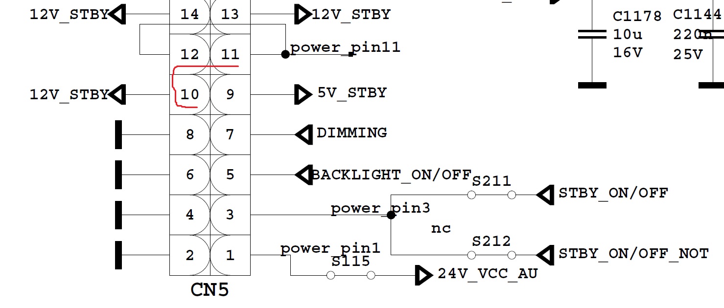

                                CN30 pin11 is 5V stby NOT 12 volts! CN30 pin12 is 12v stby. I see the test point on page 58
                                  Excuse me, my connector is Like the CN5 with 12 pins in total. And I have 3 pins at 12volt stby.
                                  Pin10, 11,12.

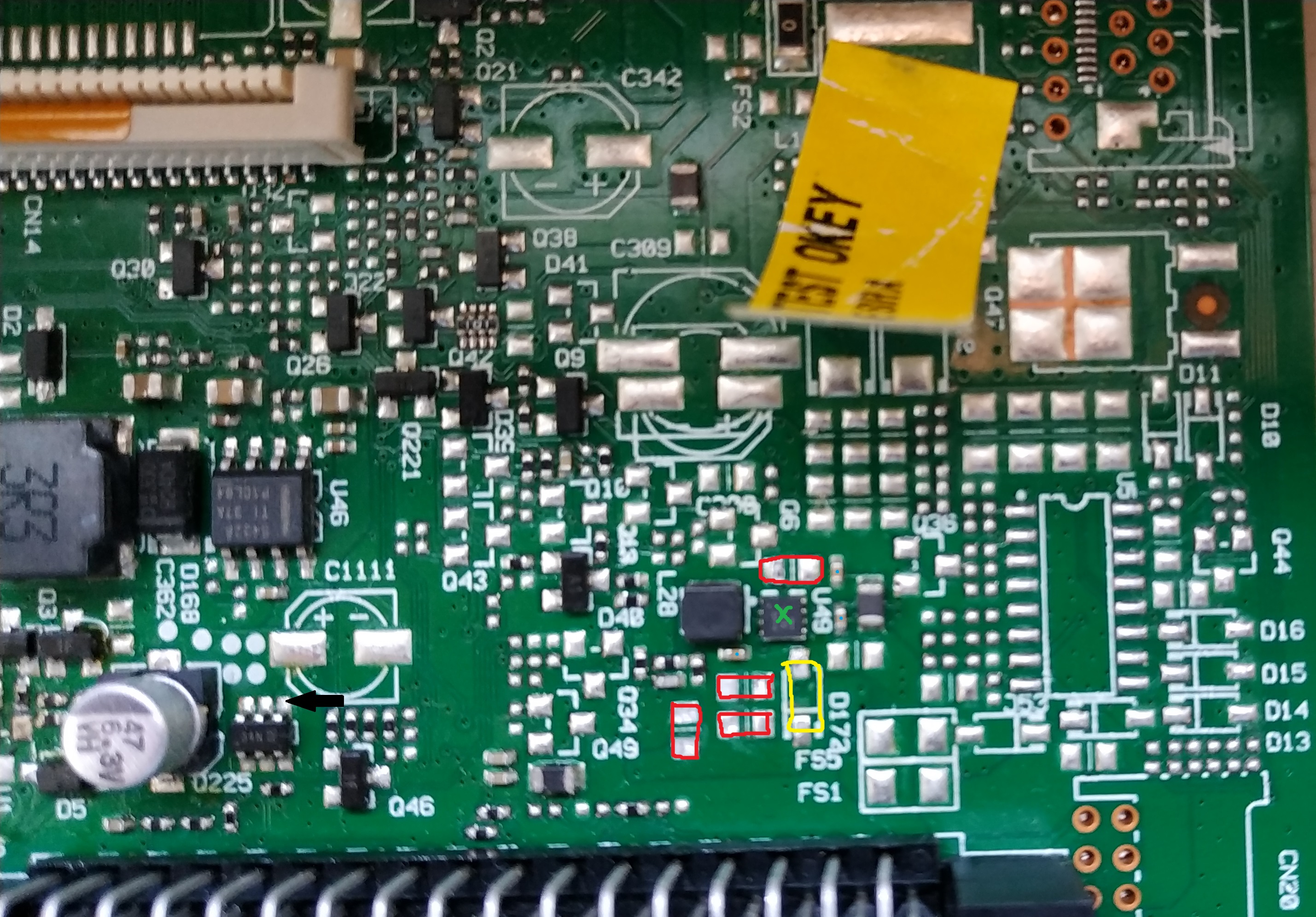

                                      Then,
                                      I told the diode D172, which was in short circuit (marked in yellow).
                                      D172 removed from the PCB results in an open circuit.
                                      I think something broke or happened in that area.
                                      However here points are still in short circuit.
                                      I took away all of them capacitors marked in red. But still in those garments there is a short circuit towards GND.
                                      short circuits are also short circuits even the small capacitors marked a light blue dot. I would like to remove them, but I know that it is better to remove the U49. what do you suggest?
                                      Pin 4 of Q225 (therefore 5Vdc) is also in short circuit with GND.
                                      The two C342 capacitor pins are both shorted with ground.
                                      I know U49 is very small,
                                      Thank you
                                        U49 convert 5V to 3V3. remove u49 and check SC again.
