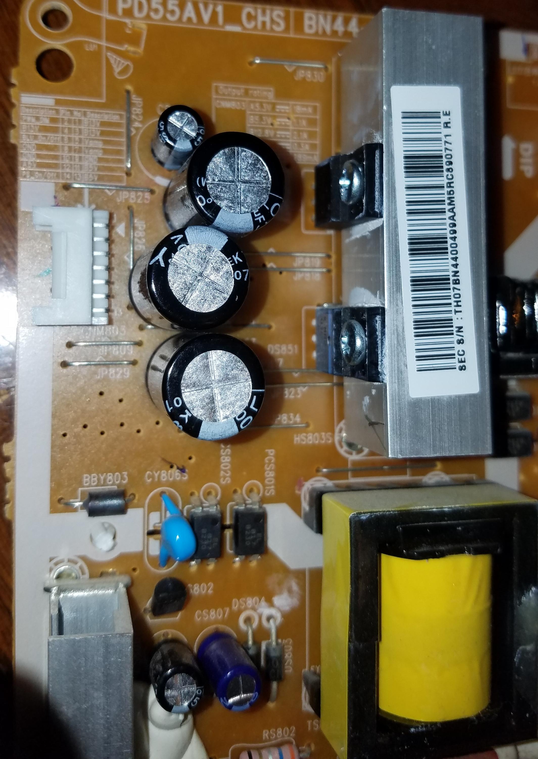

    I just picked up this 55" Samsung (UN55EH6001F) and the symptoms are described as "Shuts off on its own and can be restarted by unplugging from wall and waiting a few minutes"

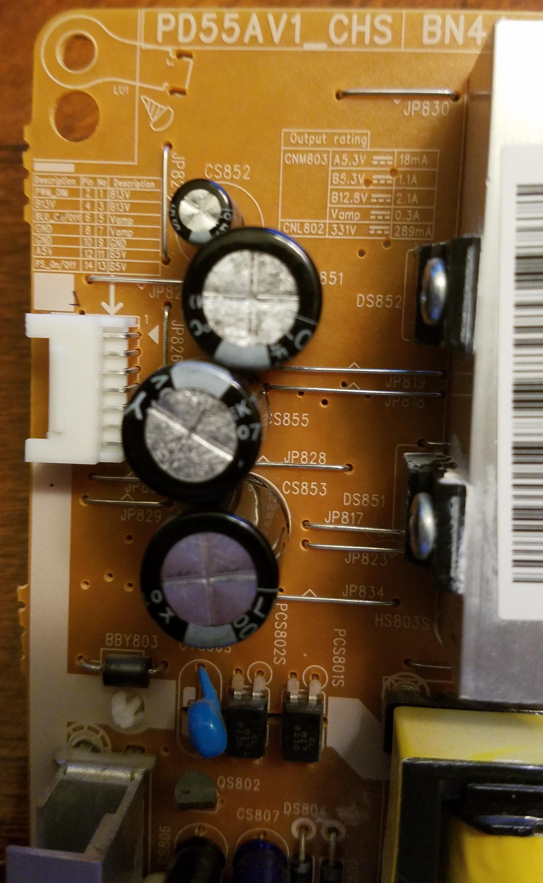

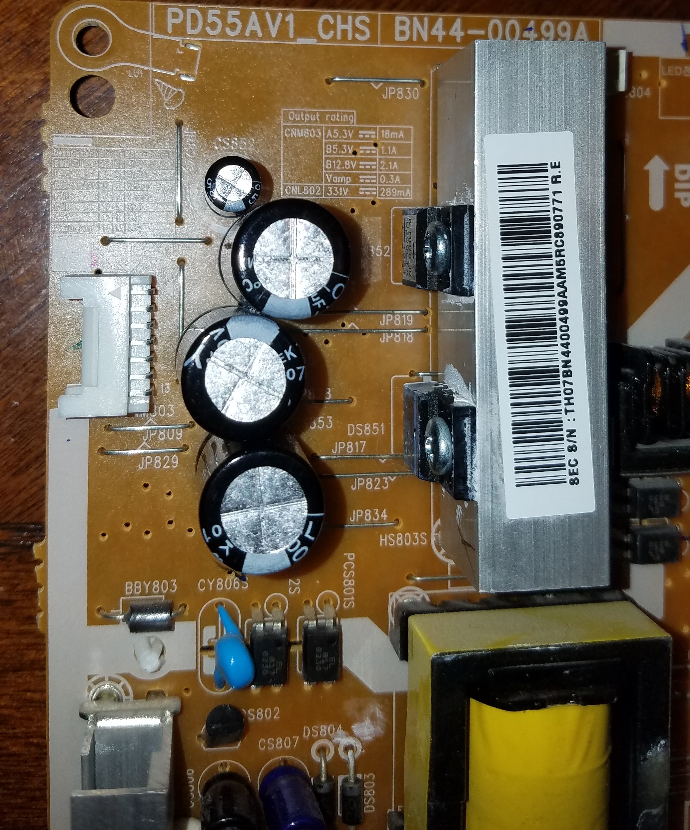

    It ran when I got it for a while without a glitch, but I decided to open it up anyway. Looks like the power supply board has had few repairs, and the obvious one is the capacitors around the connector that goes the main board look like they've been replaced. I'm trying to find the original / correct capacitance and voltage ratings for those.
    See photos below. CS852, 851, 855, and 853
    Thank you

    I don't have a schematic but based on a picture I found,
    CS853 = 2200µf/10v
    CS855 = 470µf/10v
    CS851 = 1000µf/25v
    CS852 = 47µf/50v

      Re: BN44-00499A Capacitor values / Ratings
      Thank you.. this board has the right values with higher voltage ratings.. should be ok!?!?

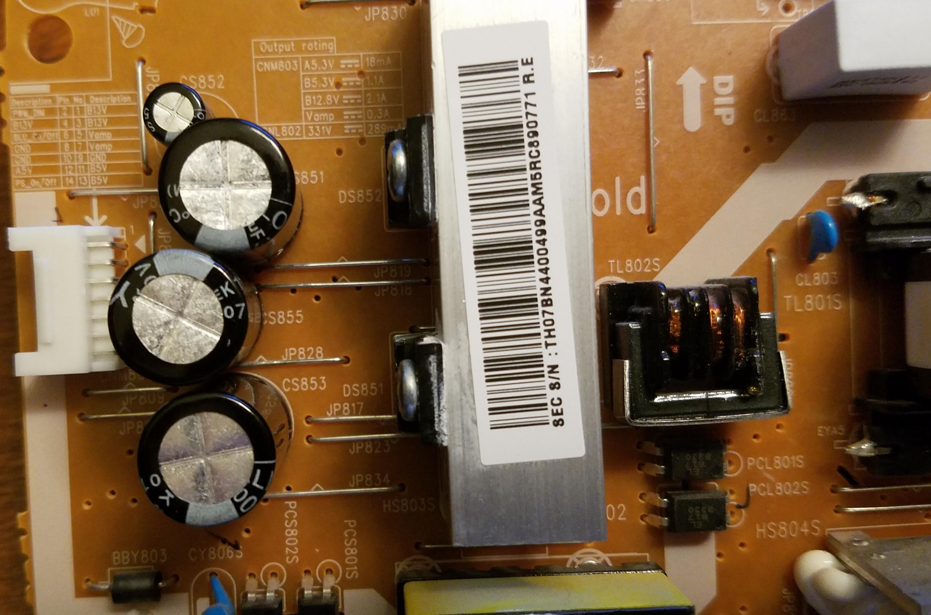

              Ok, it does shut down with the main board disconnected. Power supply issue.
              Only thing I noticed is the large cap voltage goes from 389 V when good and on to 405 V while it's in the reboot cycle. Means anything? I'd love to fix the power board. Any thoughts where to begin?

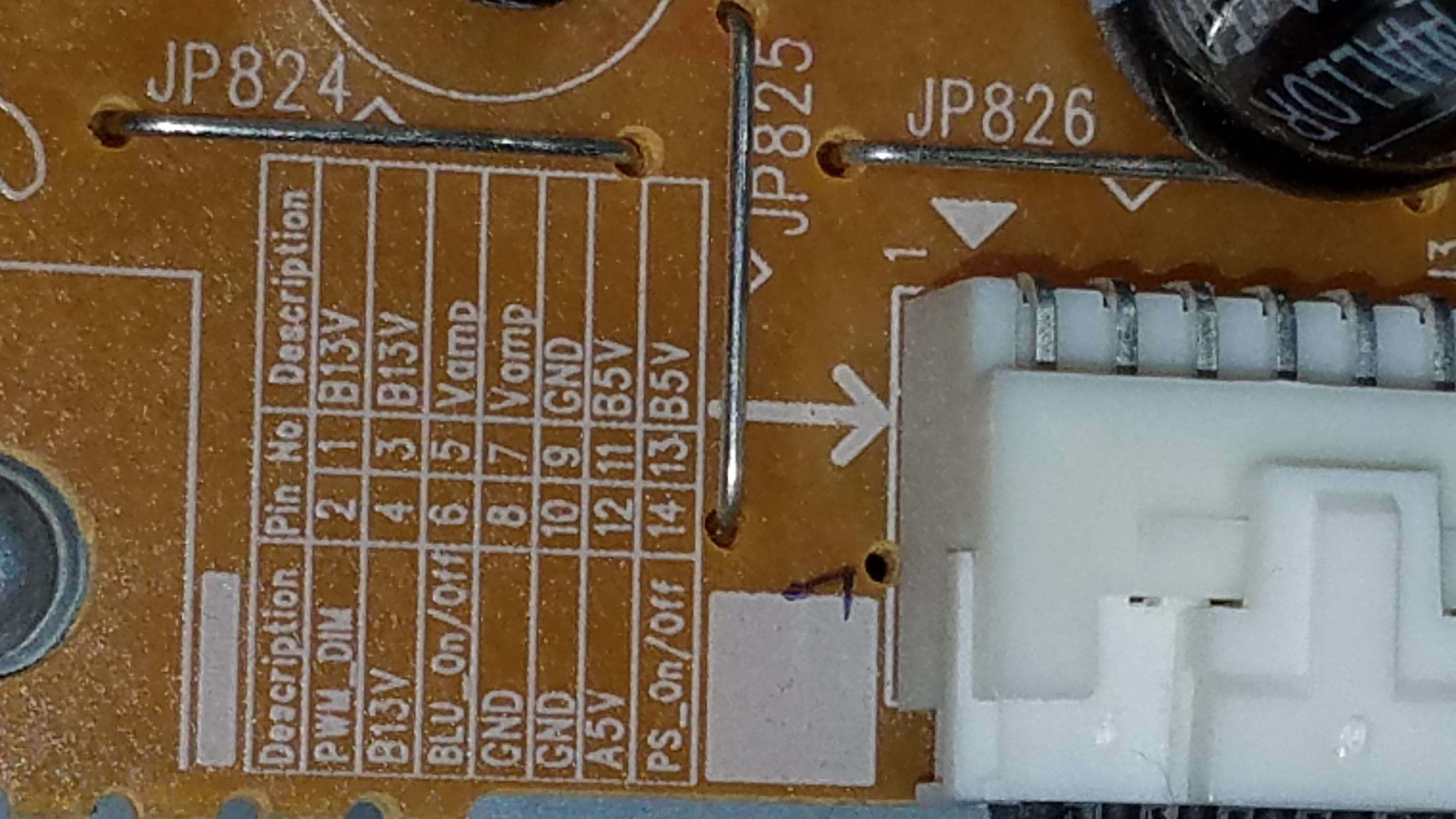

                Also, the 13 V (12.7V nominal on the connector that goes to the main board) drops to 0V when it's rebooting with the main board disconnected. The A5V stays solid at 5.29V, but B5V drops to 0 during the reboot cycle (maybe this is normal as it goes to 0 naturally when the set is off - Backlight is off)

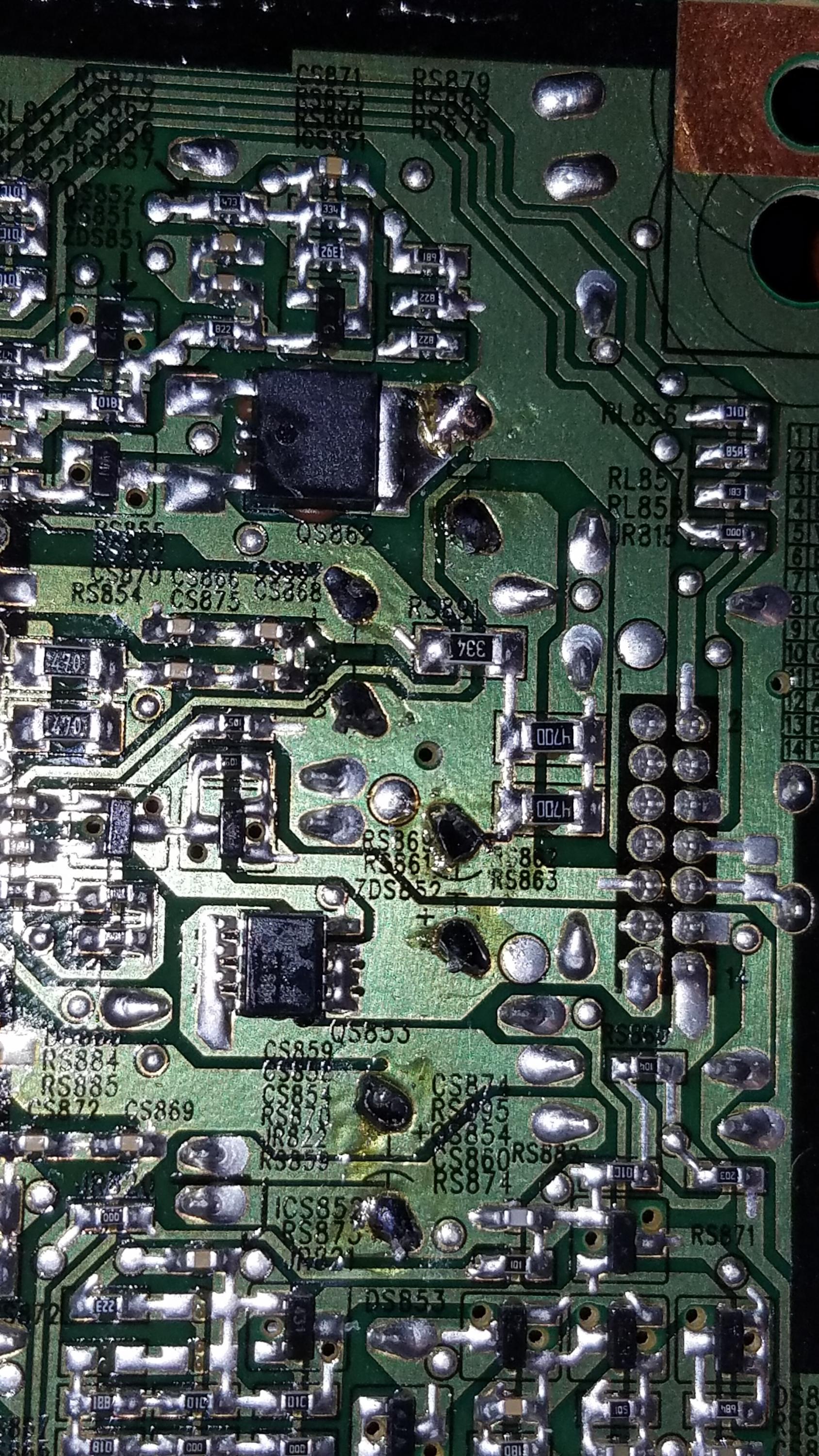

                      Anyone by any chance has or know where I can get the schematic for this power supply board? seems that there is a solder joint or broken trace as when I apply pressure on the board it seems to work fine. I inspected under a microscope and touched up suspect nodes, but I can't seem to pinpoint it. Thanks
                        I would start by resoldering any of the transformer rivits/connections, and also all prts mounted to the heatsinks, don't just look at them, resolder them. they usually are the first to fail.
                        check the voltages to see which ones quit when you press the board IE: is the standby voltage still there? when it quits.
