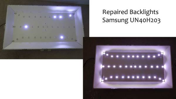

    I have a bunch of Samsung TVs with bad backlights. They all have over 50-90% bad LEDs and need full replacements. Unlike LG models, the backlight does not shut down when a problem is detected and it appears the shorts may damage the power supply.
    I got strips from Aliexpress Rzconne brand strips for one UN46H203AF, did the replacement and 2 strips failed after 3 days even with backlight level reduced. The seller shipped me replacements and when I installed them, the backlights were flickering powered with the power supply (main cable disconnected, tested fine with LED tester). I got hold of another TV the same model with bad backlights as well and tried that power supply on the original TV and the backlights failed to come on at all. I ordered a used power supply on ebay and that power supply appears to work properly.

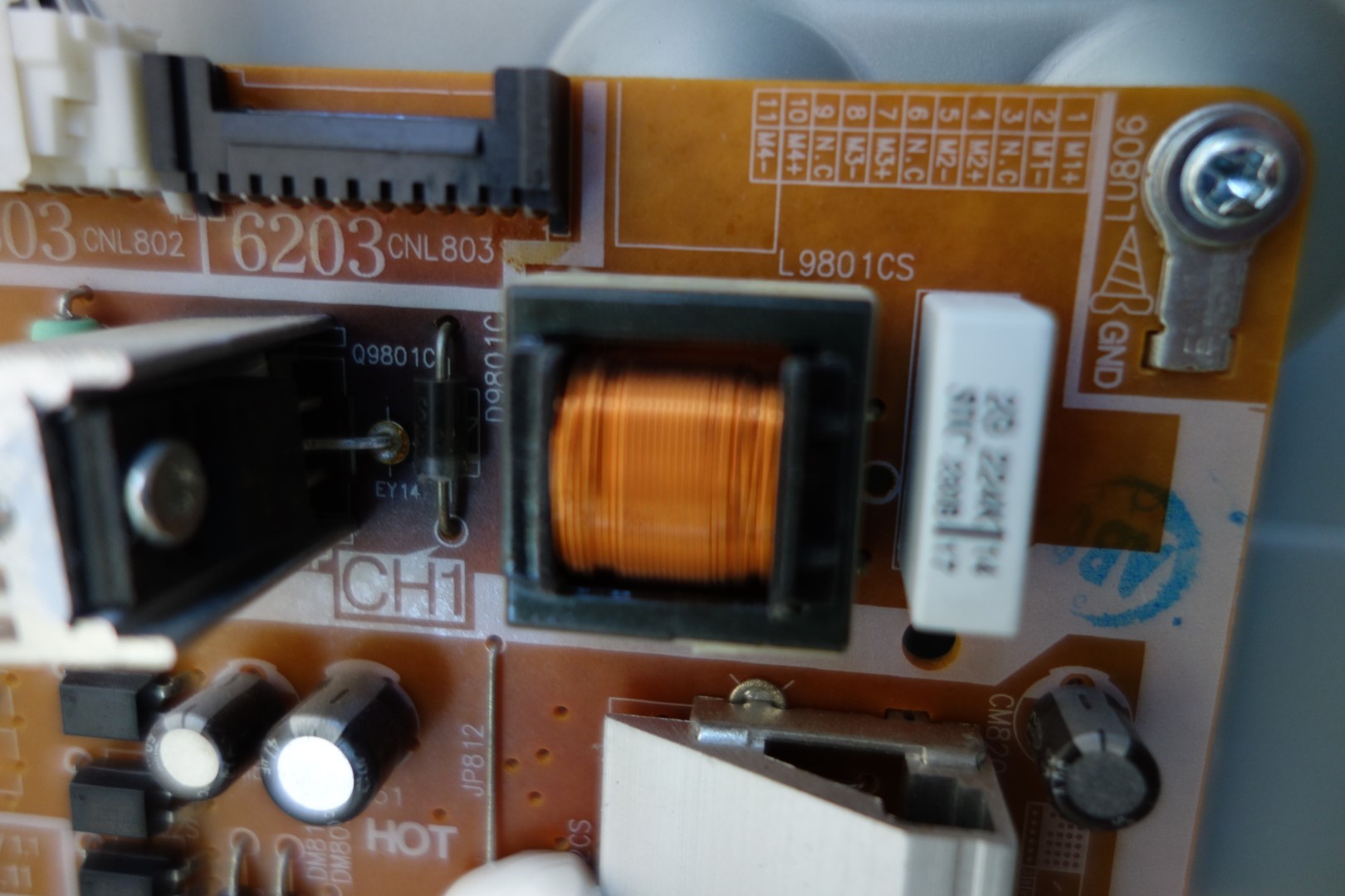

    On the flickering power supply and the no backlight power supply, the area around D9801 and Q9801 are noticeable darkened by heat. Part number is BN44-00771A. Checking D9801 in circuit, the no backlight PS measures 1V in reverse direction vs OL on the working PS. Diodes on all 3 show about 0.5V drop the forward direction.
    Will investigate a bit further but a schematic would help.

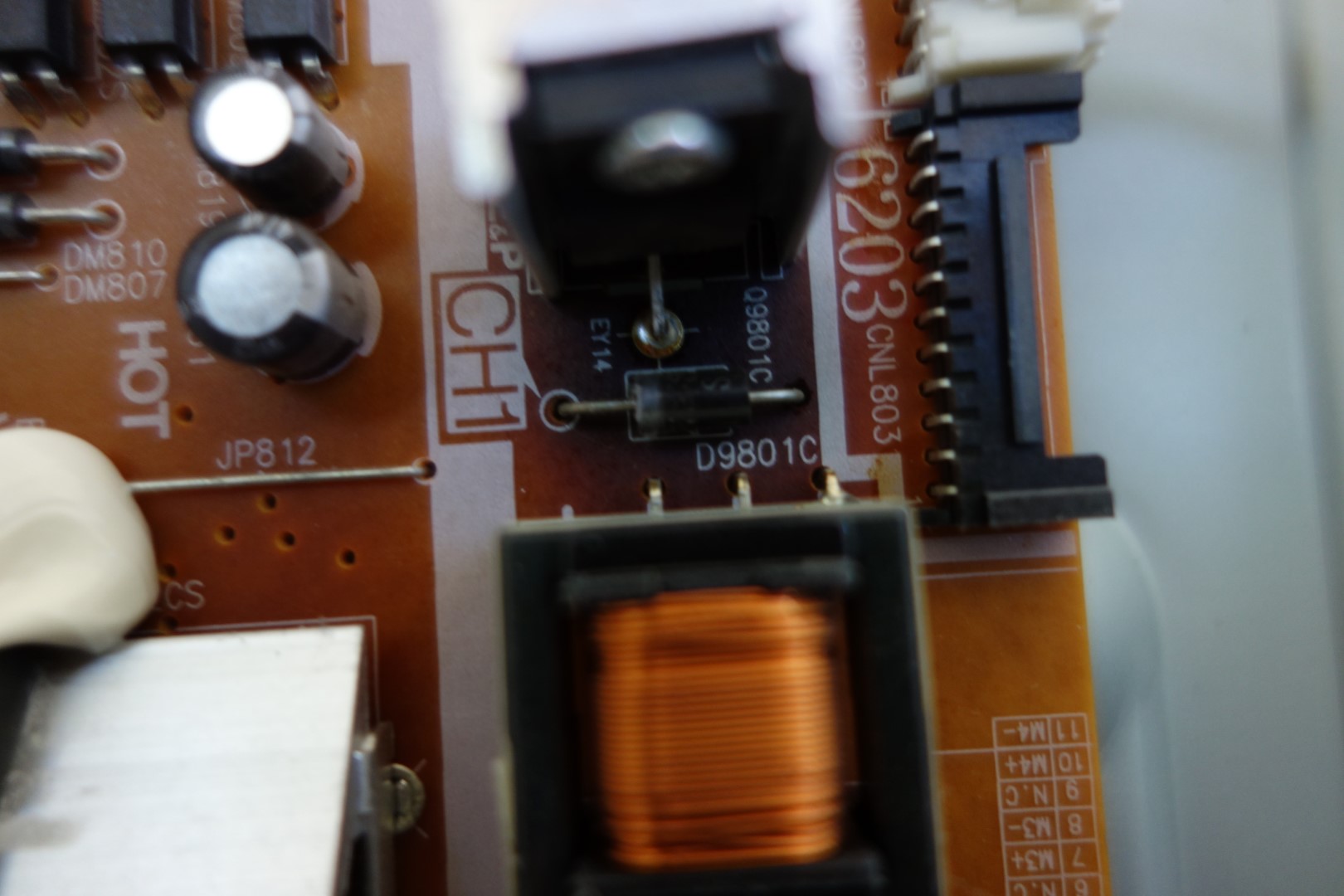

    D9801 D9801C measured the same (1V reverse) when I removed it so I replaced it (original SF28G 600V/2A) temporarily with a MUR640 (600V/4A) and the backlights come on so now I have 2 working boards. Need to debug the flickering board.

      I would check IC9805 on bottom side of board near connector CNL802. This may be an LED voltage/current controller and may be failed.
      You can try swapping this IC from your working board to the flickering one to see if it makes any change.
      Also, you said D9801 and D9801C measured 1V both ways, which diode was actually the problem? They are different diodes (different parts) so did you only replace one of them? or did you replace both? and which one?

          Actual designator for the diode is D9801C.

                On Samsung models, there is no protection shutdown of shorted LEDs so they will burn out until one goes open, the tv is too dim or there is power supply damage. The two original TVs I installed Rzconne LED strips came back a few months later even with the backlight turned down. Luckily, these strips have multiple suppliers on ebay and Aliexpress.

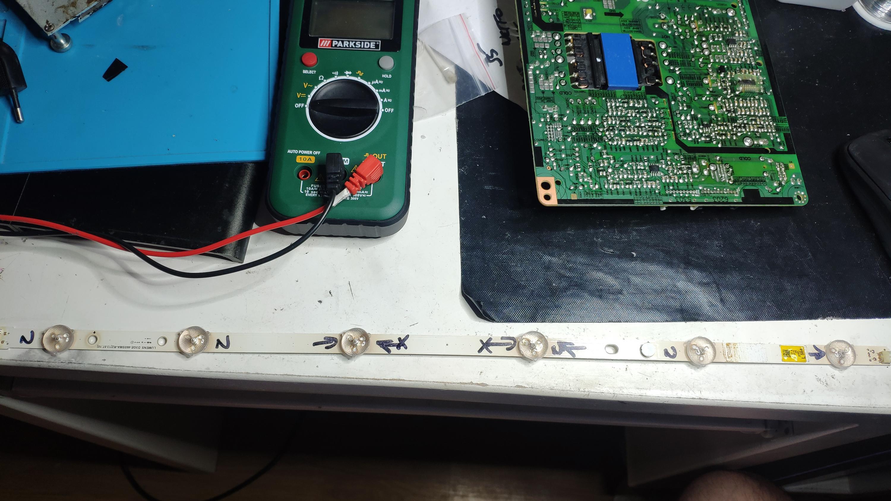

                      You cannot test LED strings by measuring resistance though you can test individually for shorts. You need to put in diode mode and test each one individually or use a LED tester. With this model, you will likely have 80 to 90% of them shorted. Lots of suppliers for these strips currently. At the time of the original post, they were very few.

                        Wouldn't testing the strip as a whole tell if a single LED was open? That's what I was trying to determine, and that's what I interpret the data to suggest. From what you say, however, failing closed ("shorted") is the more common mode?

                          I tried this test: plugging in the power board to teh LEDs but not to the mainboard. LEDs do not light. I tried measuring VDC on the pins supplying power to the LED strips. It was not easy to make good contact but best as I could tell there was only half a volt between the + and - pins. Meanwhile, the singed diode showed 280vdc, and the oversized blue 450v/100uf cap showed 380vdc. so it seems like it's not delivering power to the LEDs.

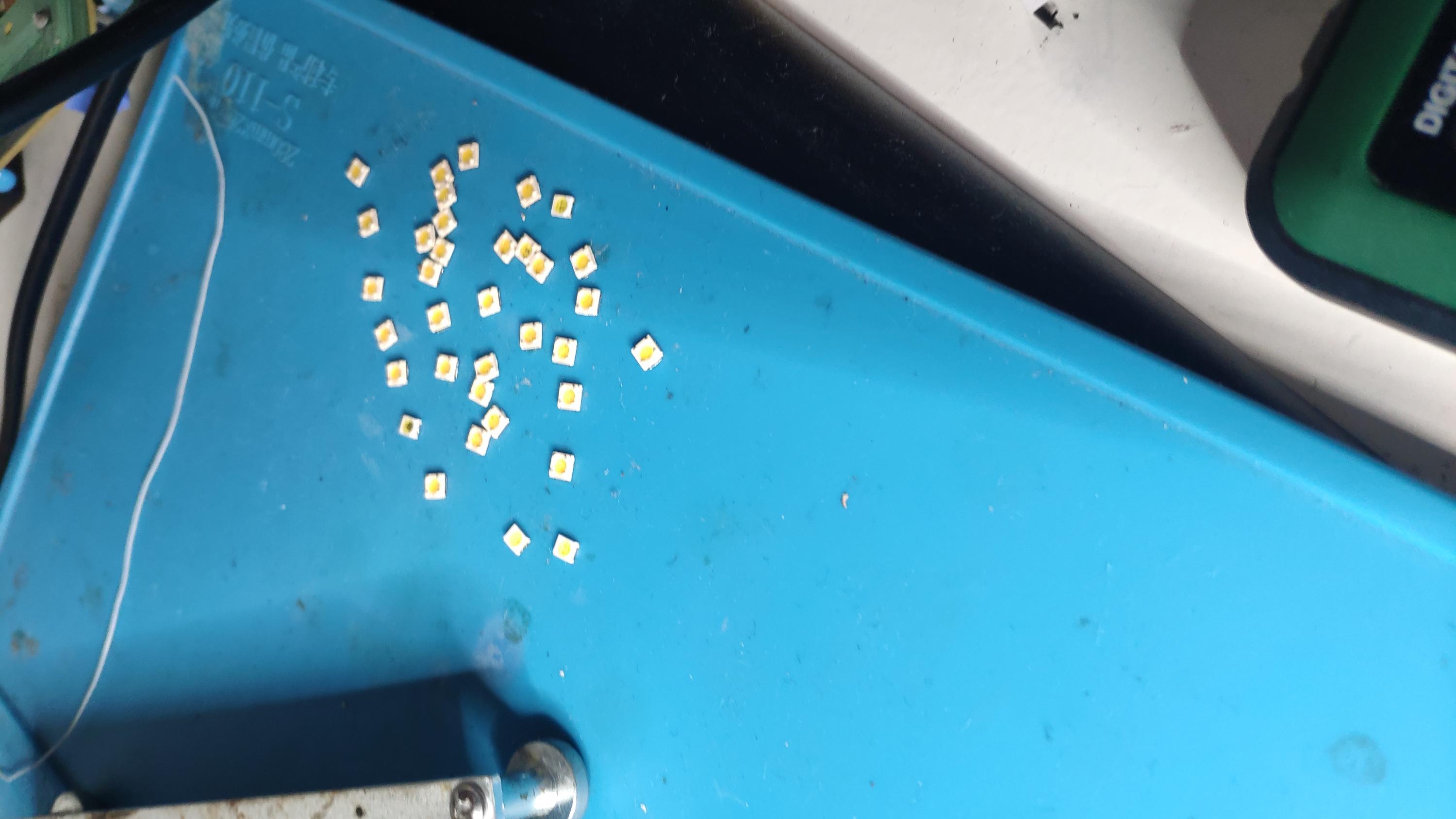

                            i have EU40H5300 with same power supply BN44-00771A. TV came with not back light. I removed LED strips, replaces 10 diodes, placed back. Tried if everything works (of course before i tested all 4 leds with cca 32V (11x3V) ) and BAANG in 3 seconds again maybe 12 LEDs were dead. Again replaced broken one, tested and BAAAANG. Now only 6 LED strip is broken. So i start measuring and from PSU comes nice 272 V!!! Acc. label it should be only 172V and by calc 4 strips by 11 LEDs is 44 by 3V should be round 132V. So my PSU is giving twice more voltage that why my LED blown. I check and replaced diod D9801C but now change.
                            PS: Nothing is burned, 5V and 13V for mainboard are present.

                              You need to replace all your LEDs with new strips and not do individual replacements. You still have an open circuit LED. LED driver circuits are current sources and the voltage is the drop against all the LEDs in series. An open circuit will cause the voltage reading to max out. LED failures are not random. They wear, burn out and have limited life like batteries and light bulbs.

                                Thanks for quick response. So 280v is ok ? I know it is current source and the volrage drops down. but form 280v to 130v ?
                                Why i should not to do individual replacement ? I did it many times without any issues. This first time, where i saw so many dead leds. Usually when they are in serie connected are broken 2-5. Here it was 10.
                                After two attemt. It is cheaper and much faster to replace them individual (checked with 2.6V which is dead), like ordering complete set of strips.

                                  Unlike every other manufacturer, Samsungs don't have protection shutdown in their LED driver circuit. LEDs will burn out until the screen gets too dim, there is damage to the power supply, or one LED goes open circuit acting like a fuse. Strip prices are relatively inexpensive ordering from Aliexpress.
