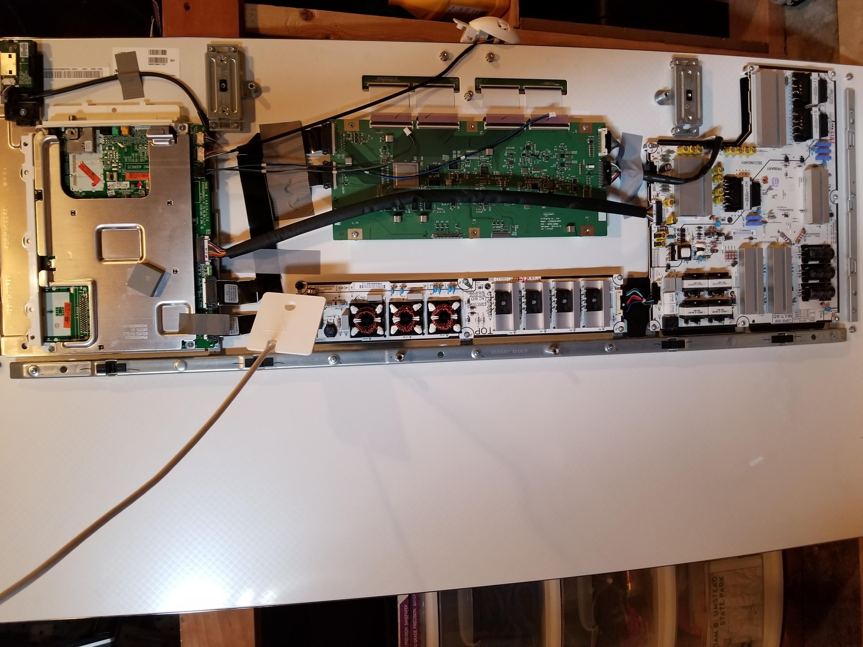

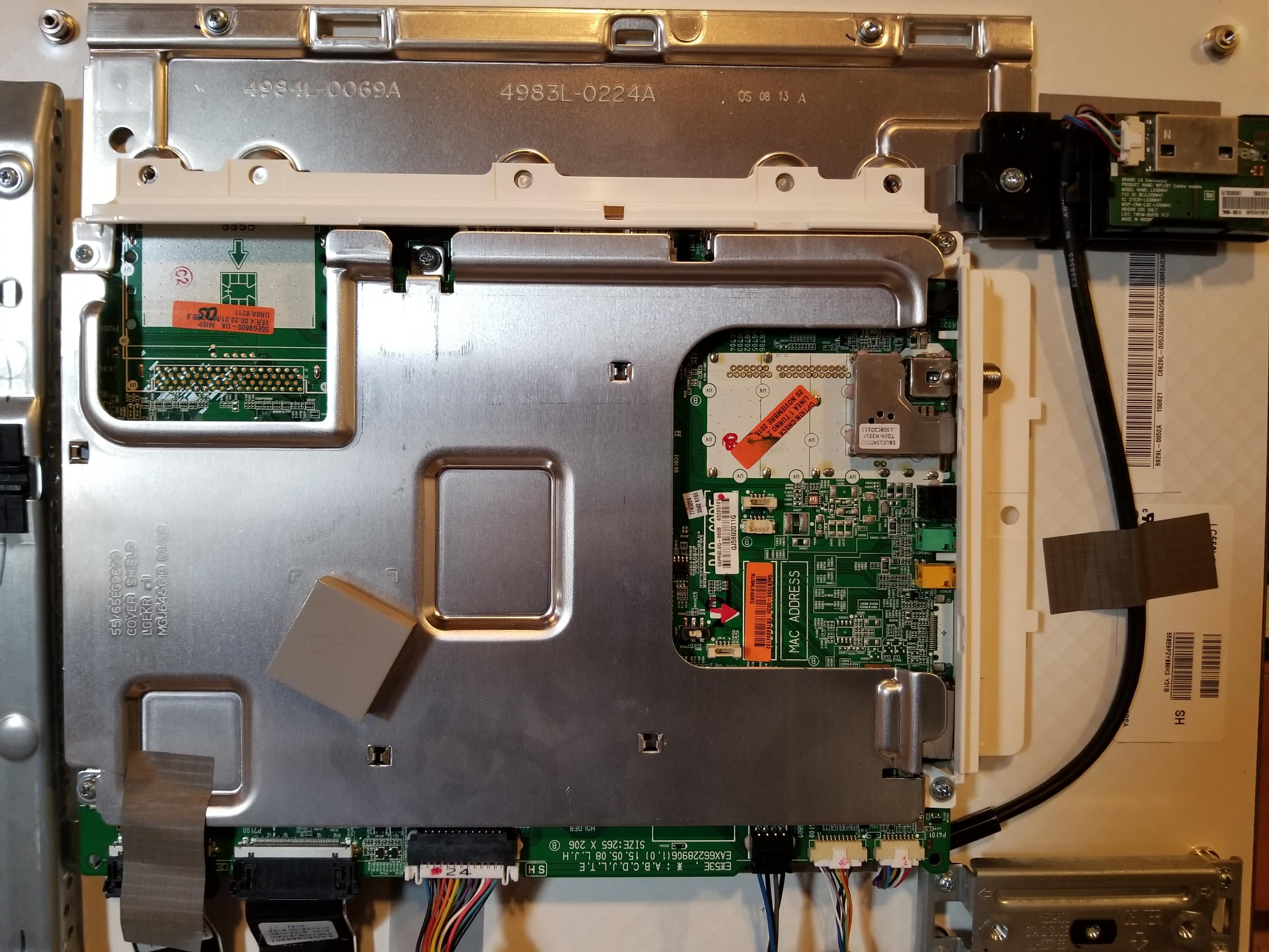

    Hello. Recently rescued an LG 55EG9600 from the electronics recycling bin which is 9ne of my finest finds yet (assuming I can get it working). Brought the TV home and plugged it in - immediately powered up and the LG symbol bounced around the screen for a bit, no issues with the picture or anything. About 10 minutes after this, tv started rebooting. Powered it down and back up a few times and eventually got to a point where pressing the power button results in the bottom IR board lighting up and blinking slowly three times before fading to nothing. Have done some research and have tried the power only command (building an ir blaster and playing a .wav file through your phone). The only thing is that the Power_Only command isnt resulting in any panel activity. IR board is still receiving signals (universal remote cycles power). When power is turned on, LG Light on IR board lights up and flashes 3 times, then nothing. No panel glow or anything. The optical port on the main board is lit and theres power to the USB ports. Am also getting 3.5v all over the main board. There is a slight hum comming from the TCON board. There are two power rails leading into the TCon, one provides 12v which is receiving correct voltage and the other is a 24vd supply that is receiving 0.75v from the power supply. There is also no panel activiry when I jump the pwr-on to 3.5v and Drv-on to 12v-on on the power supply pins that would receive these commands from the main board. The panel looks like its in good condition and i dont see any burn marks or any swollen caps on any of the boards. Wondering what any potential next steps would be?

    some high resolution pictures of your boards, please.

      Re: LG 55EG9600-UA No Picture or Sound

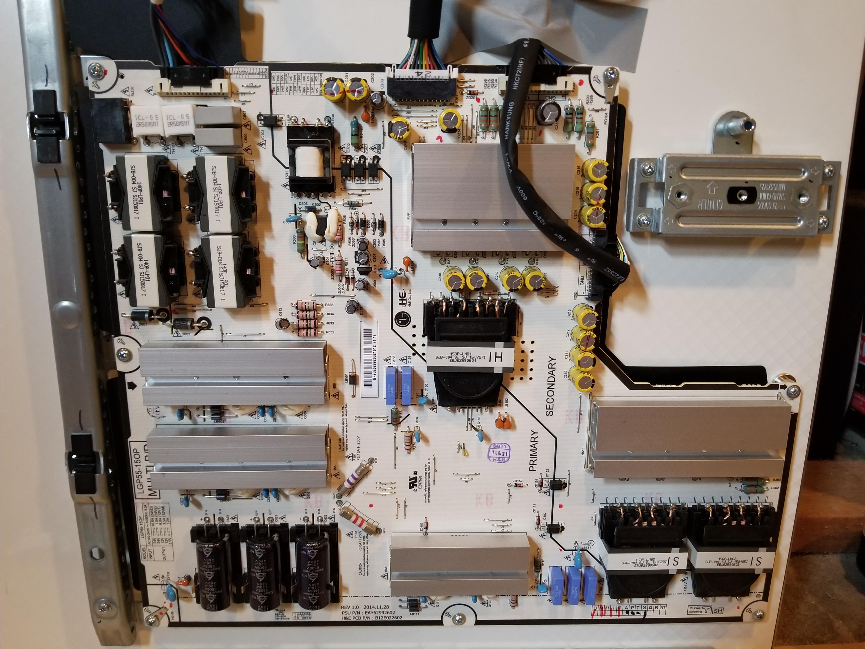

      Sure thing! A few pictures of the boards are attached.

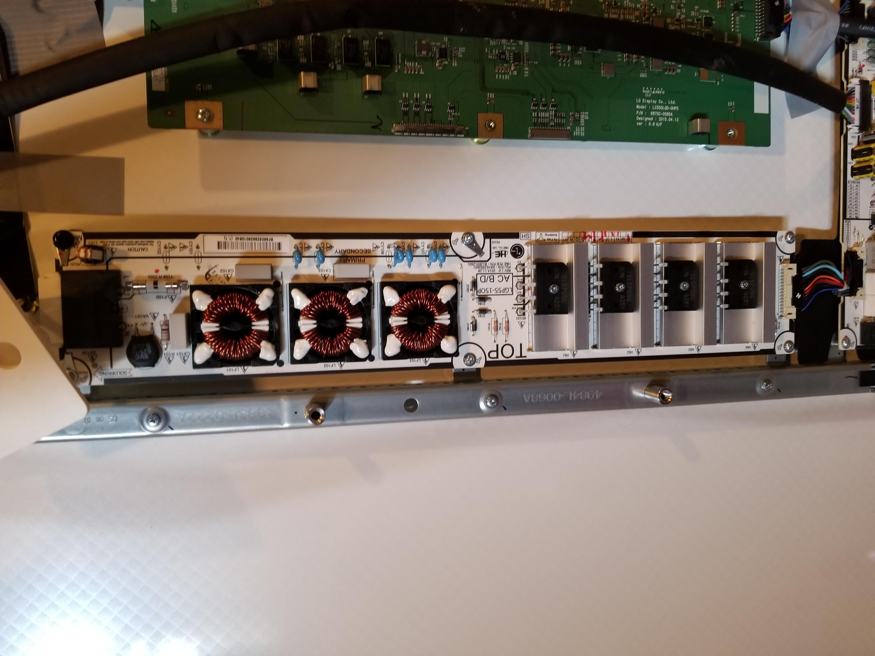

        You may not have turned all of the PSU on. There is a third, something like 1zvt-on for some reason. The LED's won't work until the 24V rail is on. You may also need the Dim control.

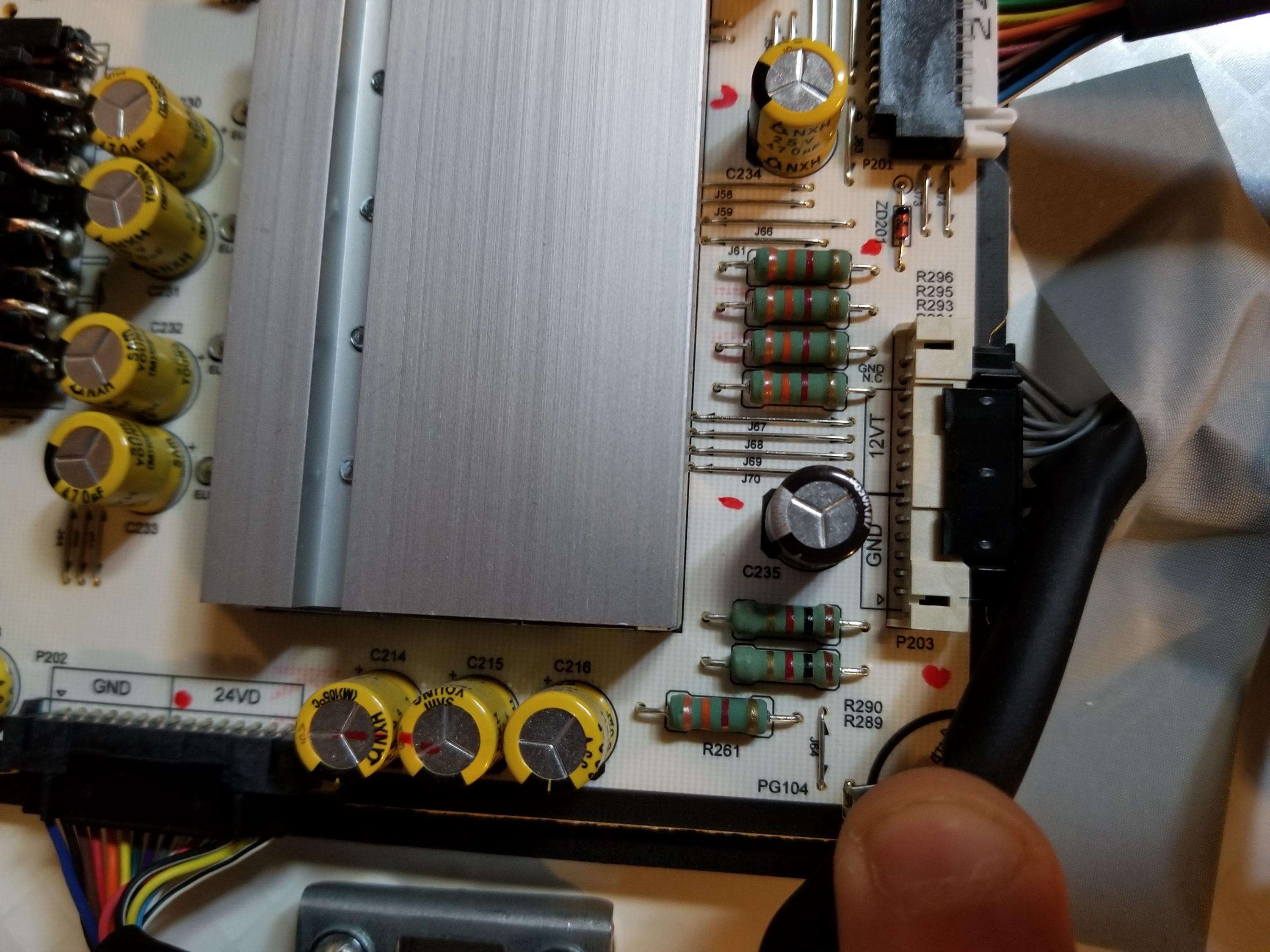

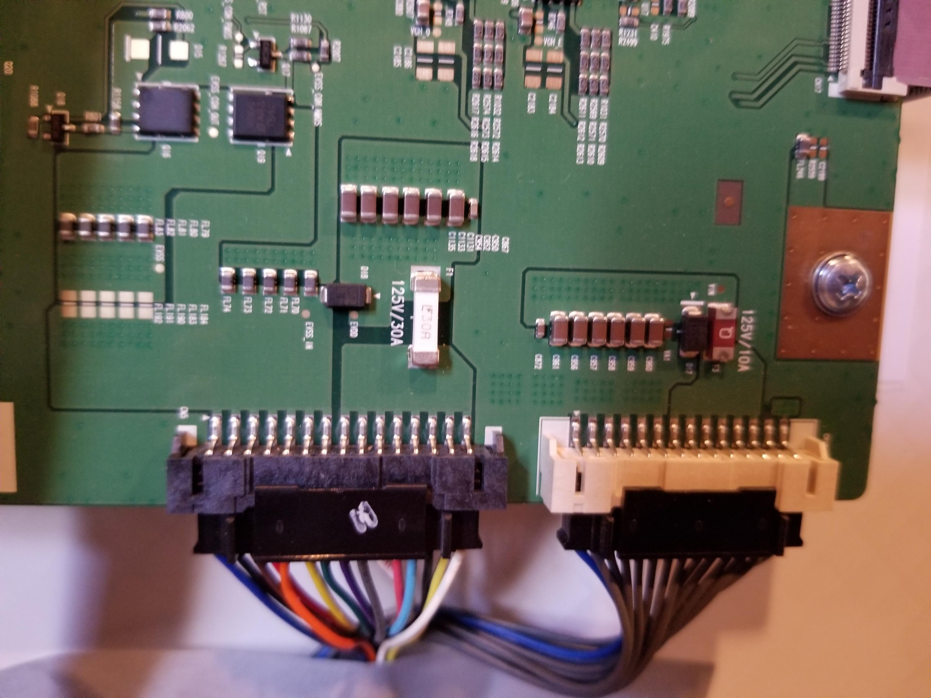

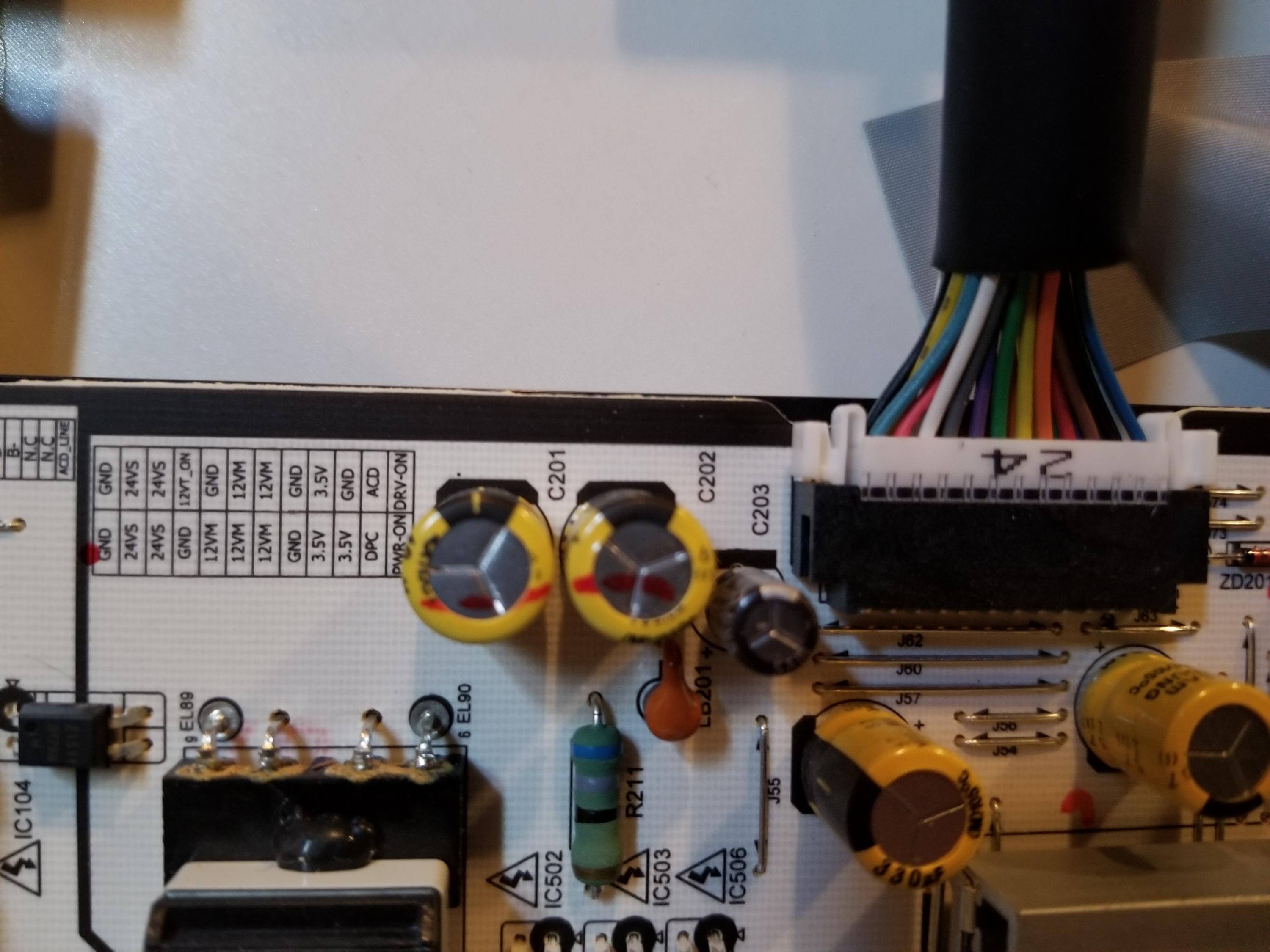

          Heres a closeup of the pinouts for the main board connection. I think that third one is 12vt-on. Do you think I would need to jump all "ons" (12vt-on, Drv-on, and Pwr-on) to a 3.5v supply to get everything powered on? In the past i jumped Pwr-on to 3.5v, and Drv-on to 12vt-on, which didnt do anything except switch a relay on. I also uploaded a picture of the 12 volt and 24vd power ouuts from the PSU and how theyre connected to the TCon. The 12 volt works fine and is showing the correct voltage, just not the 24vd.
          Do you have any idea where or how i could manipulate the Dim?

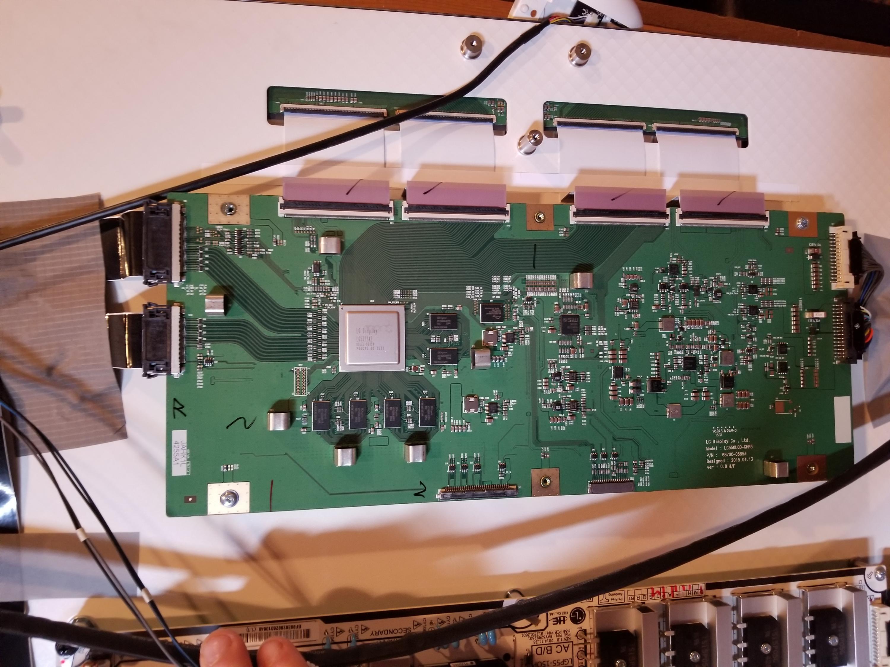

            Apparently the tcon side of things didnt get attached. Its included here.
                also on your photo secondary PSU to my eyes as i see on the pfoto the red line broken on C201 C202 check them or warm them up with hair dryer then plug it on

                    For caps C201 and C202, I checked them last night and they are testing OK - tested them in the circuit though and didnt remove them from the board. In the photo, they do look swollen, but when checking visually, they dont appear to be damaged or anything - it may just be the way the picture turned out. I also used a hot-air gun to heat them up a bit before powering it on and there was no change - still the LG Light flashing three times then nothing.

                      you need to connect on PSU 3.5V to DRV-On and 3.5V to the other Pin labeled also at end with -ON , both doing them via resistor 1K Ohm or less till 0.5 K then plug it on and measure the 12 and 24 V if you have them on PSU.
