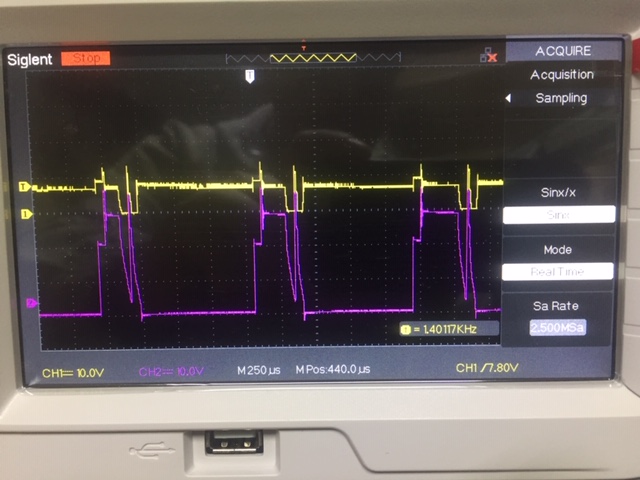

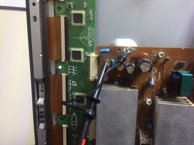

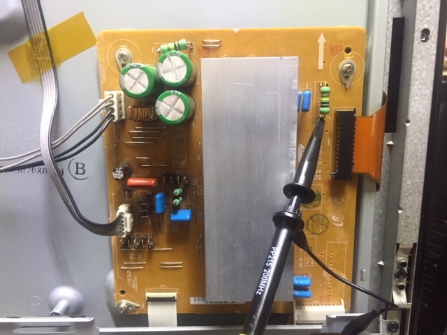

      Attached Panel label, scope output, Chn 1 on Z Board, Chn 2 on Y sus.

        Both scope probes are on x10.
