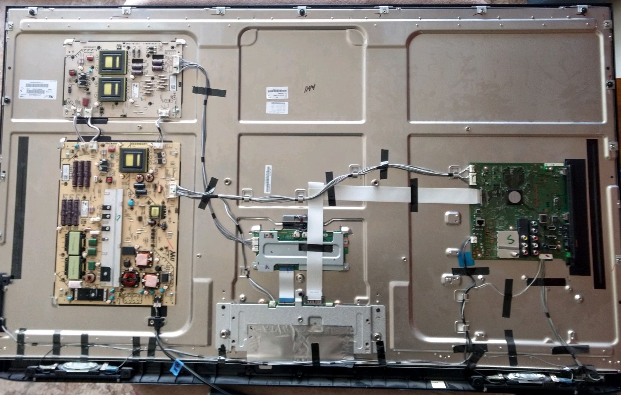

    So in an attempt to avoid further confusion this is an extension of this thread: https://www.badcaps.net/forum/showthread.php?t=73120 I made such a mess out of this one that I felt to avoid confusion and back-tracking through 8 pages of thread I thought I should just start over with what I have right now.

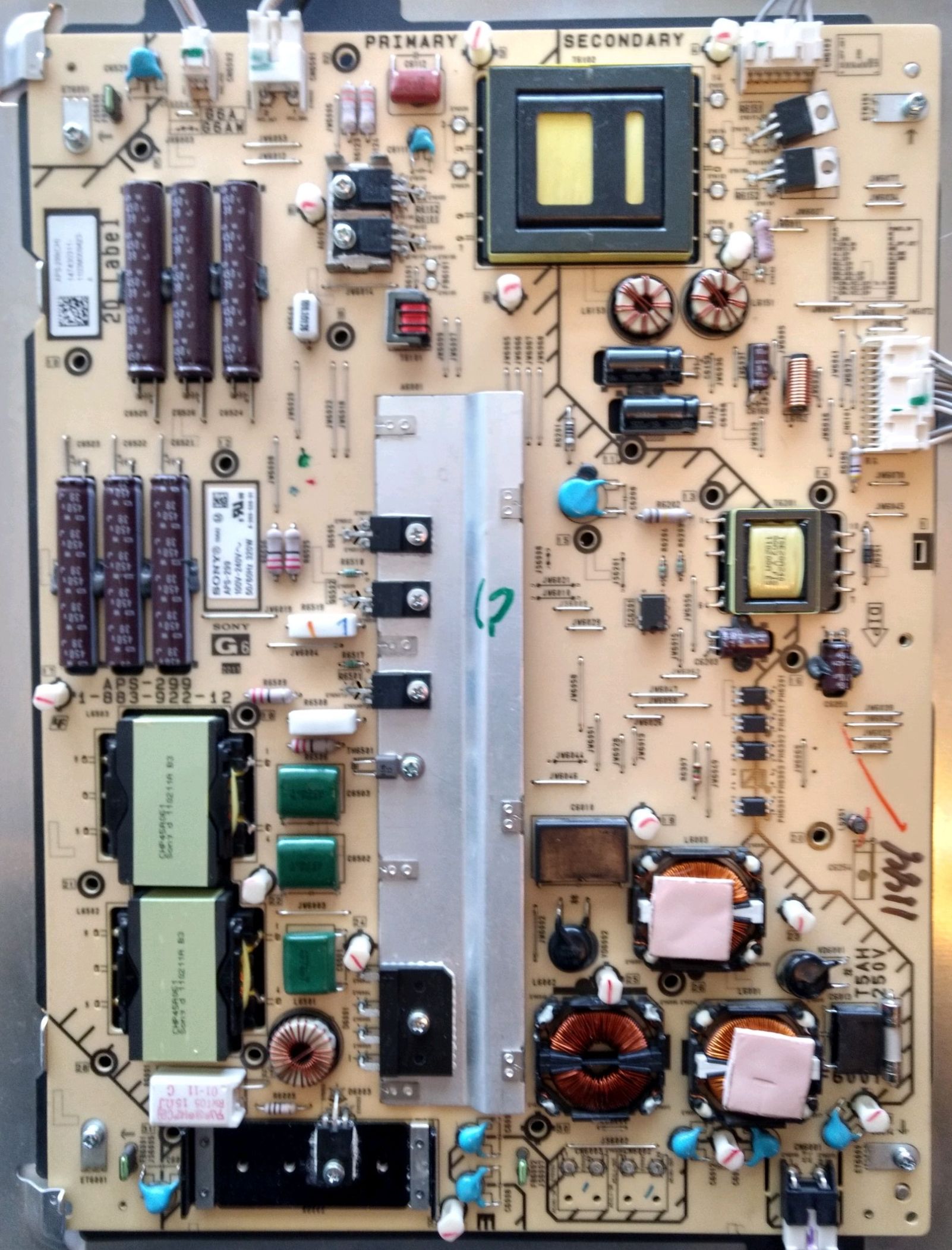

    BACKGROUND:
    This TV is the victim of a confirmed over-voltage event. I bought this Sony and a TCL TV from the same place, both appearing dead. I replaced the power supply in the TCL which fixed that TV.
    To this point, fusible resistor R6201 was replaced for being open and IC6201 was replaced due to a 170ohm short across the S and D pins. After their replacement, stand-by volts would increase from about 3.2V to 4.45V when CN6101 (to the main board) was detached. From this it was suggested IC6251 is replaced, which I just did 30min ago.
    There is still no stand-by light, however stand-by voltage of 3.25 to 3.3v is now at CN6101.

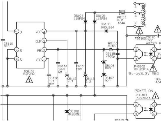

        It does appear according to the training manual, AC_OFF_DET should be 3.3 volts in standby mode with main connected
        I see that cn6102 also has the AC_OFF_DET line going to it so it could be that the main IS loading down that line
        What I might try is take a 500Ω - 1k resistor and with main connected, connectthe resistor between standby 3.3 & AC_OFF_DET and see if the standby led comes on.
        Also monitor the voltage on the AC_OFF_DET line when doing this to see if it still drops

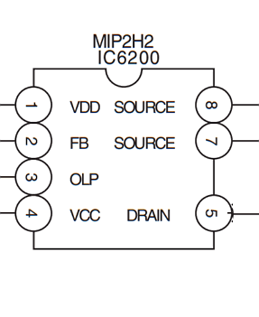

            Its likely your meter that's picking up the high voltage pulses, Check the voltage R6201
            The standby circuit is working, why are you even checking that ic?

                So its your meter that's picking up the switching pulses from the ic.
                as for the AC_OFF_DET.
                IC6501 pin 26 should be high (same as VCC pin 23 volts) with normal a/c connected. This means the same voltage will pins 1& 2 of PH6302, so the led will be OFF
                With PH6302 led off, the output 3 & 4 will be open. Q6402 will be turned off so the 3.3 volts from R6403 will appear on R6404 and also on the AC_OFF_DET line
                My guess, main board is loading the AC_OFF_DET

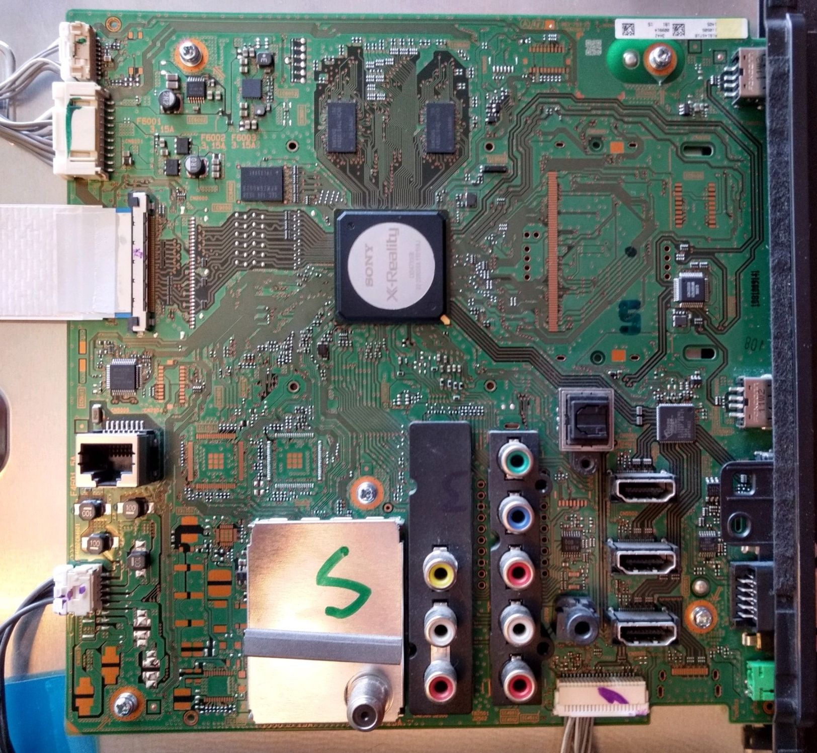

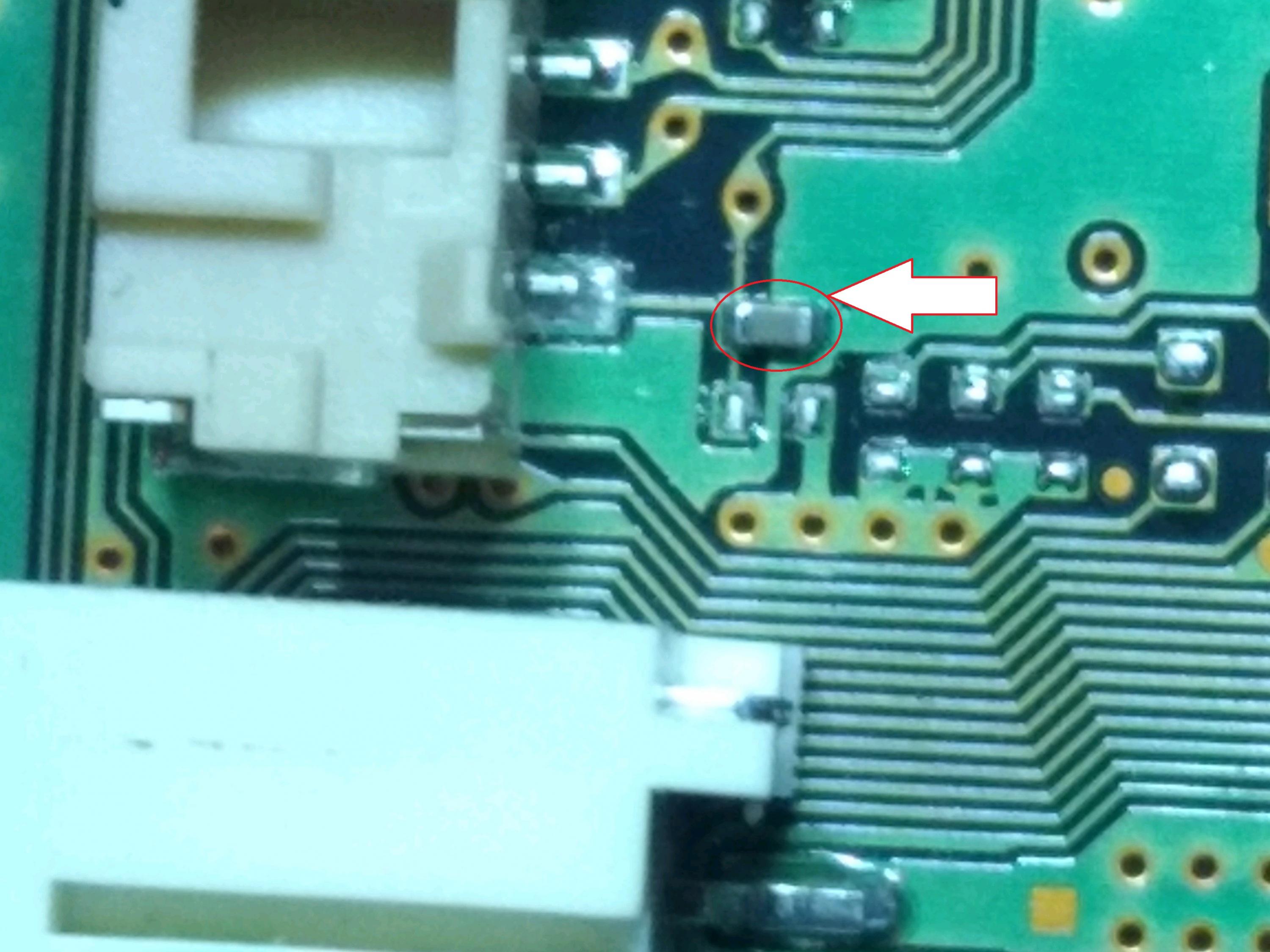

                  Yes, so I pulled the main board to see if there may be an answer.
                  The only suspect is a 14Kohm reading across the circled cap. One side of it is connected directly to the AC_OFF_DET pin of the connector next to it.
                  EDIT/ADD: I traced the whole AC_OFF_DET circuit on both sides of the board. The choices appear to be this cap, a resistor group (that appears to test good) and the X-REALITY processor.

                    Re: Sony KDL-55EX620 stand-by present, no stand-by light, AC_OFF_DET @.47V

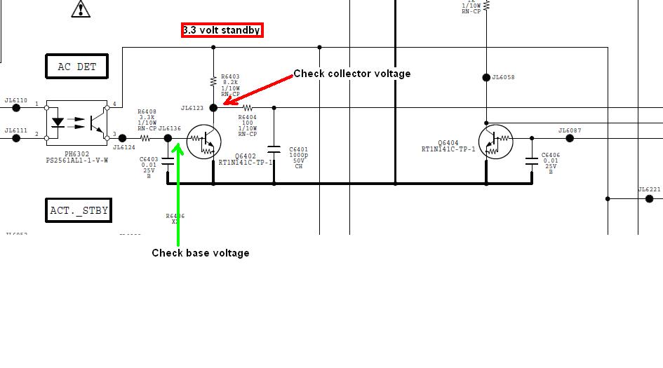

                    The cap is likely C6101, The resistor network is RB9031 (4x100Ω) Pin 8 connects to AC_MON (AC_OFF_DET), Pin 7 goes to ic9000(ae5)
                    with the main connected, check the voltage on:
                    PH6302 pin 4
                    then check the voltage on Q6402 e,b,c
                    I would'nt think 14k would load the 3.3 volts that much, check that R6403 & R6404 on the power supply are good
                        You don't need the ground screws it is ground via the cables, place something under it so it won't short to the chassis anywhere.
                        You could also measure PH6302 Pin3 from the top, that would give an indication of the q6402 base voltage
                            Is q6402 shorted e-c? I would think there should be 0 volts on the base. and 3 volts on the collector
                            PH6302 should be off ie: 0 volts across pins 1 & 2
                            try shorting the base to emitter/ground and see if you get 3 volts on the collector

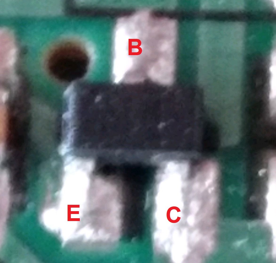

                              Before I do this I wanted to make sure of the pinout. This transistor is marked N1.
                              If viewed with the single terminal at the top of Q6402 are the pinouts E (lower left), B and C (lower right)? See pic below:
                              They call me......."threadkiller"
                                The one you mark as E is actually B.
                                The one you mark as C is actually E.
                                The one you mark as B is actually C.
                                That is the typical pin out for that form factor:
                                I.E. https://cdn.badcaps-static.com/pdfs/...8468ce7268.pdf

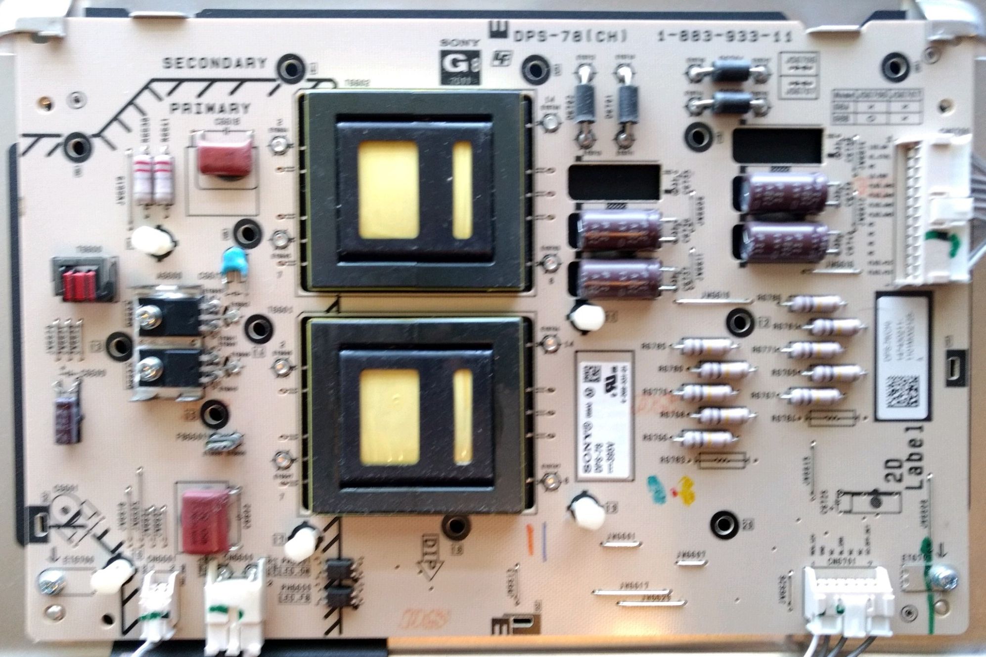

                                  Today I replaced the power board in this TV. Unfortunately the TV does not work. Looks like the main board is no good.
                                  Stand-by voltage and AC_DET voltage was present on the replacement board. Stand-by was constant but AC_DET dropped to .46v with the main board plugged in, and raised to normal voltage when unplugged.
                                  On to source a main board.
