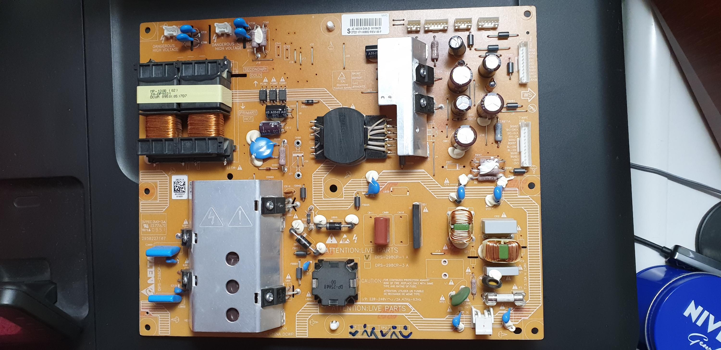

    Do you have a photo of the power supply and also, do you get weird sparking and buzzing sounds when powering your TV?
    The 4 capacitors you've replaced (C731, C709, C734 and C705), how did they originally look like? Were they burnt up and had dark brown green color? And did you replace them with the exact same type 33pF 6kV (C709, C705) and 47pF 6kV (C731, C734)?
    I actually own the 37 inch version of the same television with the same power supply and, unfortunately, with the similar issue.
    While mine doesn't have any leaking capacitor, I've discovered that the diode at D909 has gone bad. It has a high deviation in its forward Voltage compared to the manufacturer's datasheet. The type is 1N5408G and for good measure I also will be replacing D907 diode, SB2100, as well as the Q901, 2SK4101 (K4101) MOSFET. My reasoning for replacing them is because those high voltage capacitors usually don't go bad on their own and when asking around I learned that some of these diodes usually start to deviate from spec and affect other components.
    At the moment of posting I've ordered these diodes and mosfet and they will be shipped from Germany within next week, so I can prove if my theory holds any water..
    So yeah, if I were you, I would test all diodes in the power supply and see if they're functioning properly.

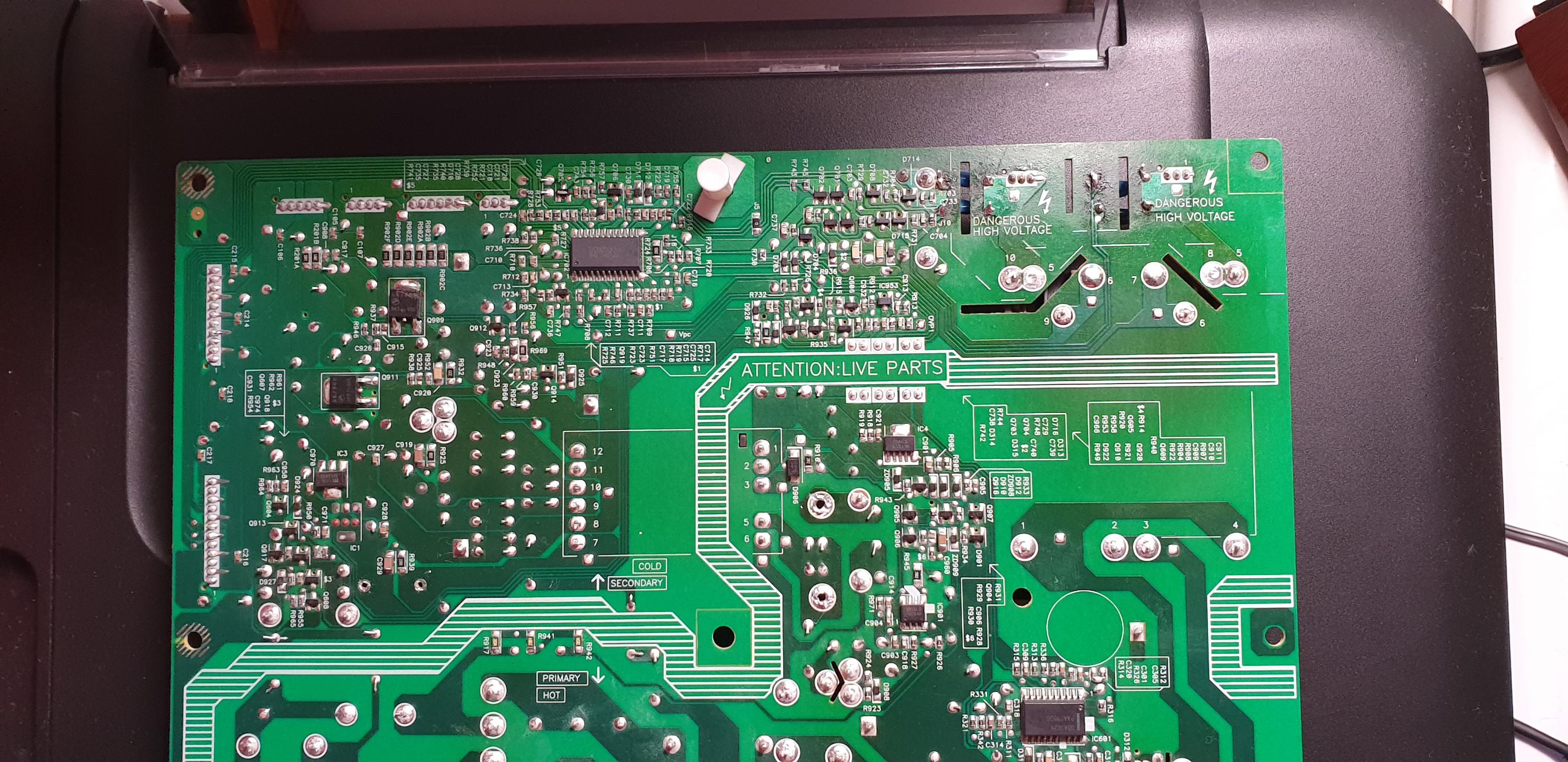

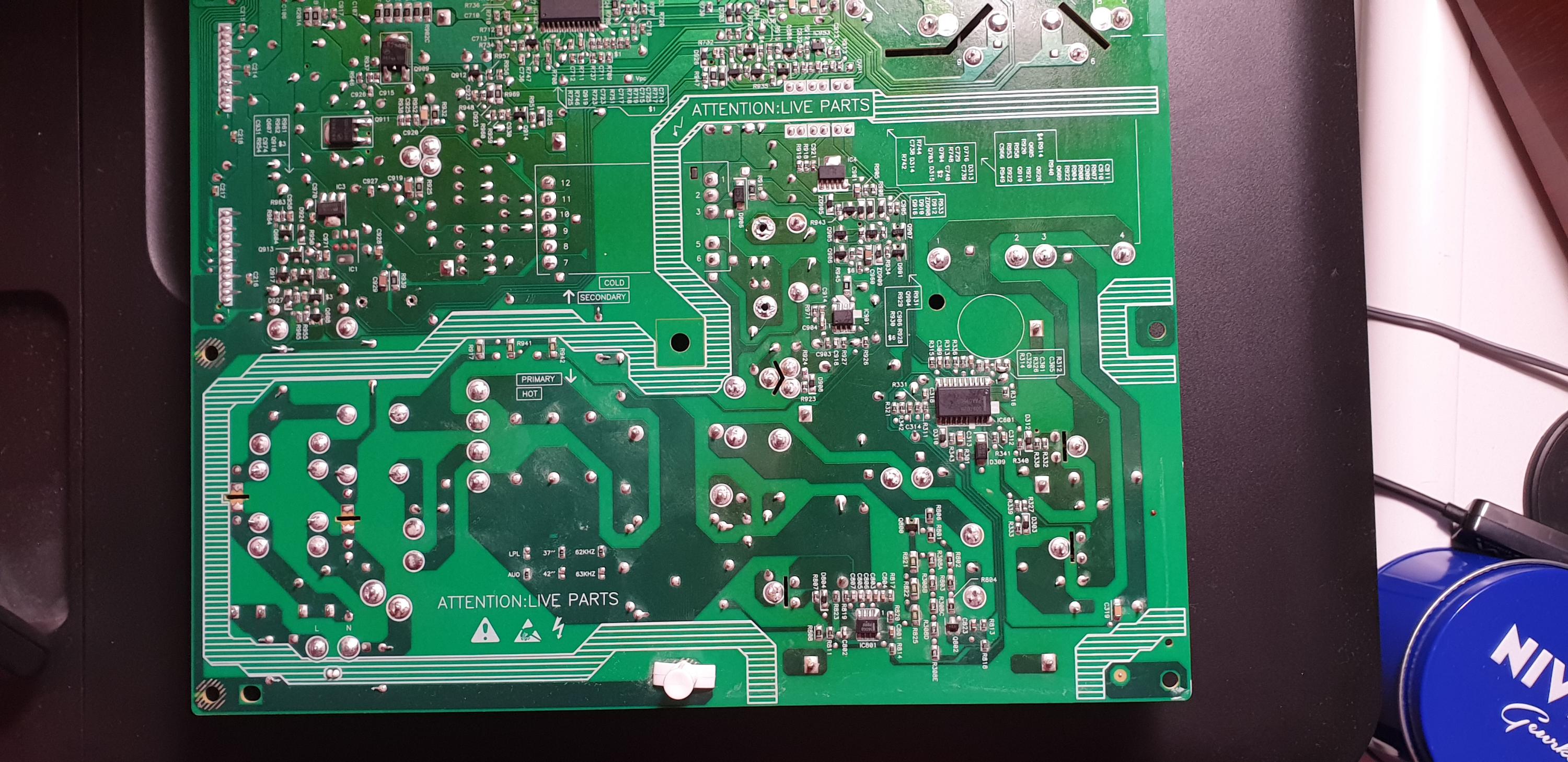

          When I was waiting for the parts to arrive I took these pictures that I included in the attachments. As you can see its the DPS-298CP-1A.
          Yesterday I replaced these components: Q901, D907 and D909.
          @otoluk, While my motherboard doesn't have a D911 it does however have a D907. The original D907, the SB2100, I measured around 175mV using diode test and compared to data sheet it should be around 330mV. Guess I replaced a part that would cause a lot of headache in the near future.
          @R_J, I guess you're right. Replacing these components I mentioned before didn't fix the backlight. It still does flick 0.3 second on before turning off. Do you have an idea how to get to the CCFL inverter? Is it sandwiched inside with the CCFL tubes inside the LCD screen or is it the rather big transformer on the top right corner just before the 4 blue filter capacitors?

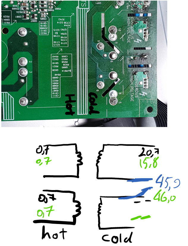

                                Put the ohm meter on its lowest scale, like 100 ohms scale as opposed to 100K ohms scale.
                                A transformer consists of 3 or more coils of wire. 2 yellow wires for example represents the leads of one coil. 2 brown wires represents the leads of another coil. You can do a quick test for each winding for an open while the transformer is still connected in a circuit. Assuming you're using a cheap inaccurate ohm meter. Look for a reading of somewhere between one and about 10 ohms. If any winding reads higher than 10 ohms you have probably found a bad transformer. Unless you didn't get a good connection to the coil leads with your test leads. Always check at least 3 times before you draw a conclusion.

                                  Allright, I did test the transformer on both the hot and cold side. I've included this picture. The numbers are in Ohms. Black number is tested while off and green when TV is turned on. I measured it according to the drawing, I hope that its clear enough to decipher.

                                  I have to add that the cold side trafo on bottom right doesn't show any resistance from its legs. Might be that the transformer has a break inside, ie open circuit. I guess I have to desolder it to verify.

                                    You don't check resistance with power on. The one secondary between 7 & 8 seems open.
                                    5 & 6 is one secondary, 7 & 8 is the other
                                    See post #6

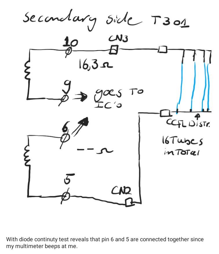

                                        Looking at T301 secondary side only 10 & 9 are connected instead of 5 & 6. For its neighbor 6 & 5 are connected instead of 7 & 8. I did measure it again, this time correctly.
                                        For post #6:
                                        About CN3 and CN2 connectors, only the pin in the middle has a wire plugged in it, the outer two are un-utilized. Looking at the distribution board it has only one wire going into them.
                                        From what I'm understanding the only connection these two distribution boards, the Left and Right one, make is between the CCFL tubes as pictured in the attachment. As what you've stated previously, only one of the two secondaries are giving me a readout.
