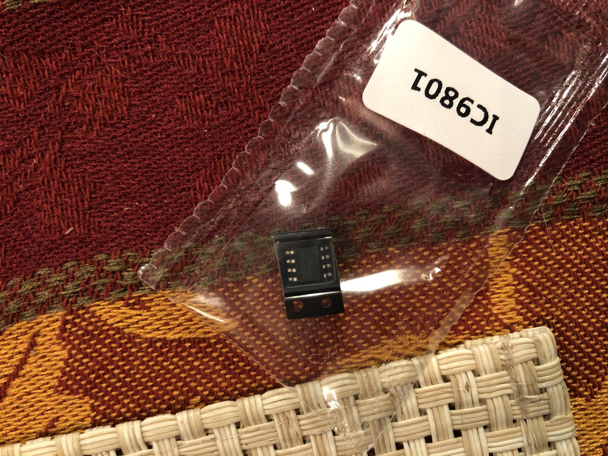

    I will post pictures of the parts in the repair kit too. They sent me like three different ICs and even SMD resistors and zener diode. For what location I have no clue because they are marked with wrong designation. C604A is marked C9307.

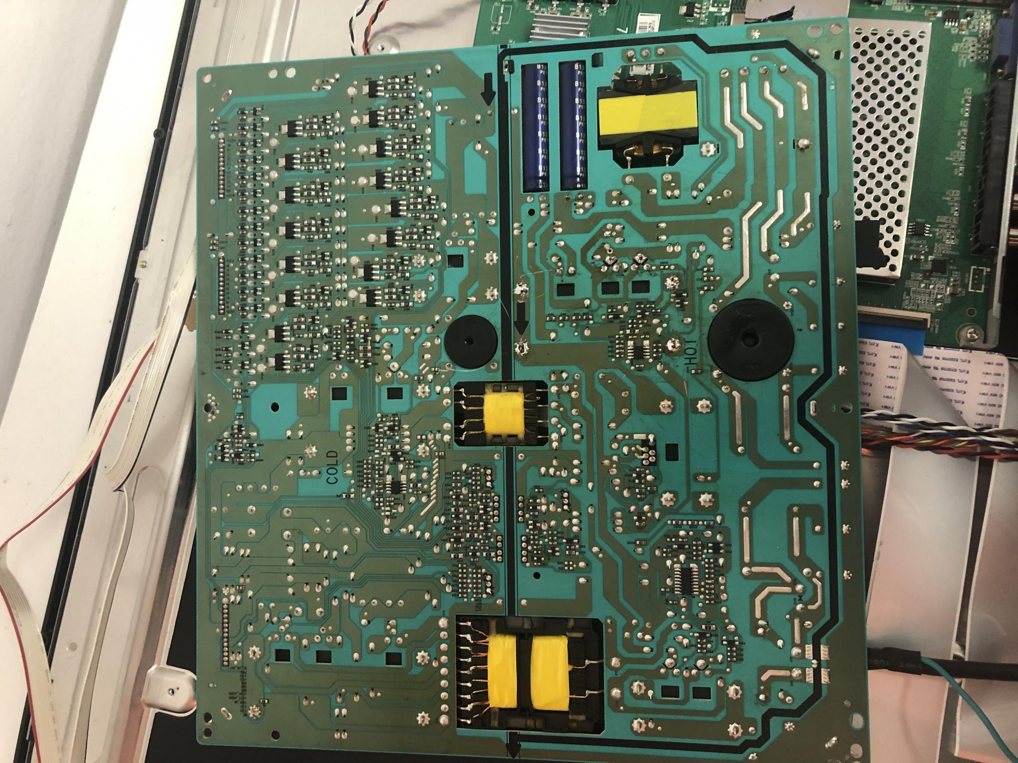

    Top of board:
    https://www.instagram.com/toppuramen...=1wuukgc7uzpp6
    Bottom:
    https://www.instagram.com/toppuramen...=1xf9nd82l1r00
    Repair kit:
    https://www.instagram.com/toppuramen...d=m72zee73q357

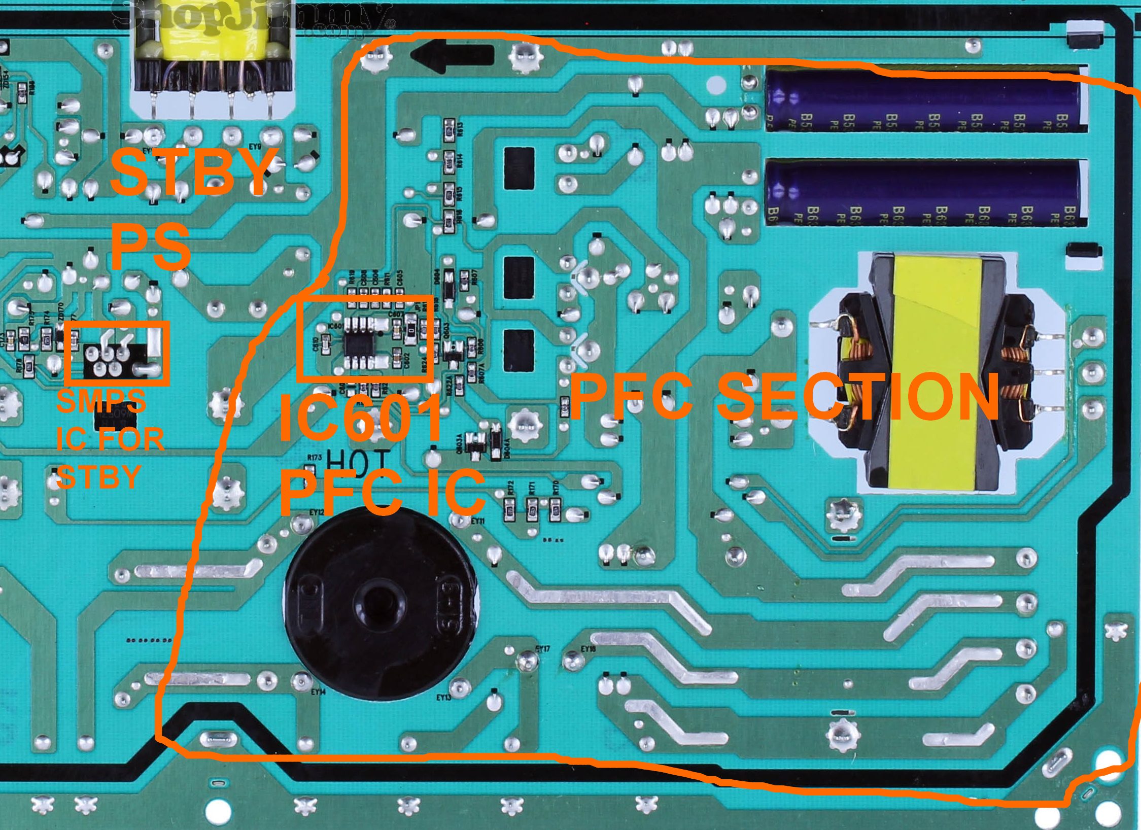

                  Is this your exact board?
                  https://www.shopjimmy.com/vizio-080g...led-board.htm#
                  SMD IC601 should be the PFC controller IC, get the P/N to get the spec sheet then check to see if it has VCC for it to run or not.

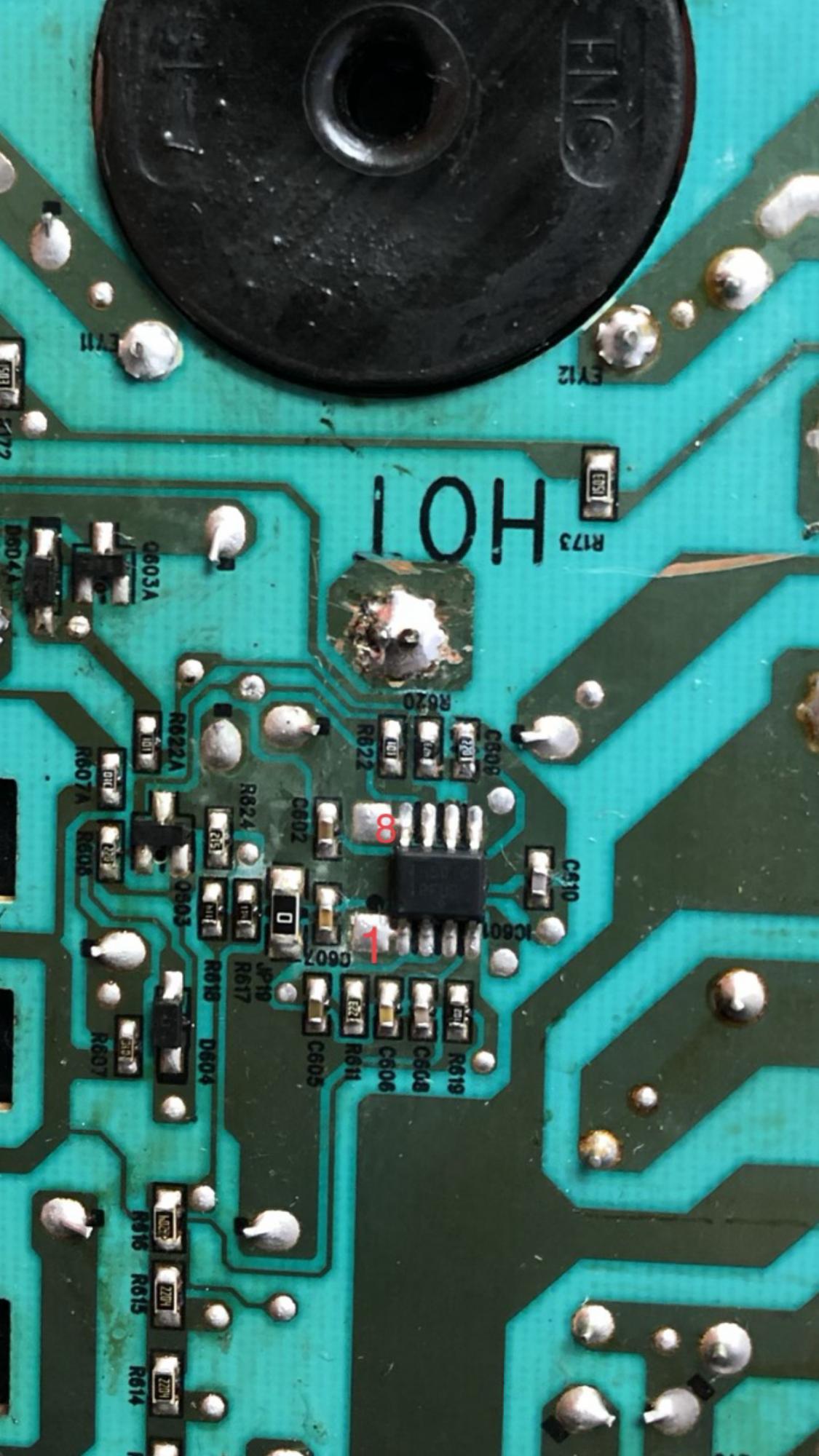

                    Yes that's my board. I ordered the board repair kit off ShopJimmy. But the designators are different I explained that in my Opening Post. This board does fit several TVs such as Insignia and LG but shouldn't the designators be the same?
                    Maybe they sent the wrong kit. But some of he components are the same like there is a PFC controller which I will probably replace. But instead of an Infineon HS01G it's a LD7591 (with designator IC9801 instead of IC601).
                    I tested the original PFC booster IC and it's got 15v at VCC.

                    These readings were taken with he TV powered on. And the backlight flickering.

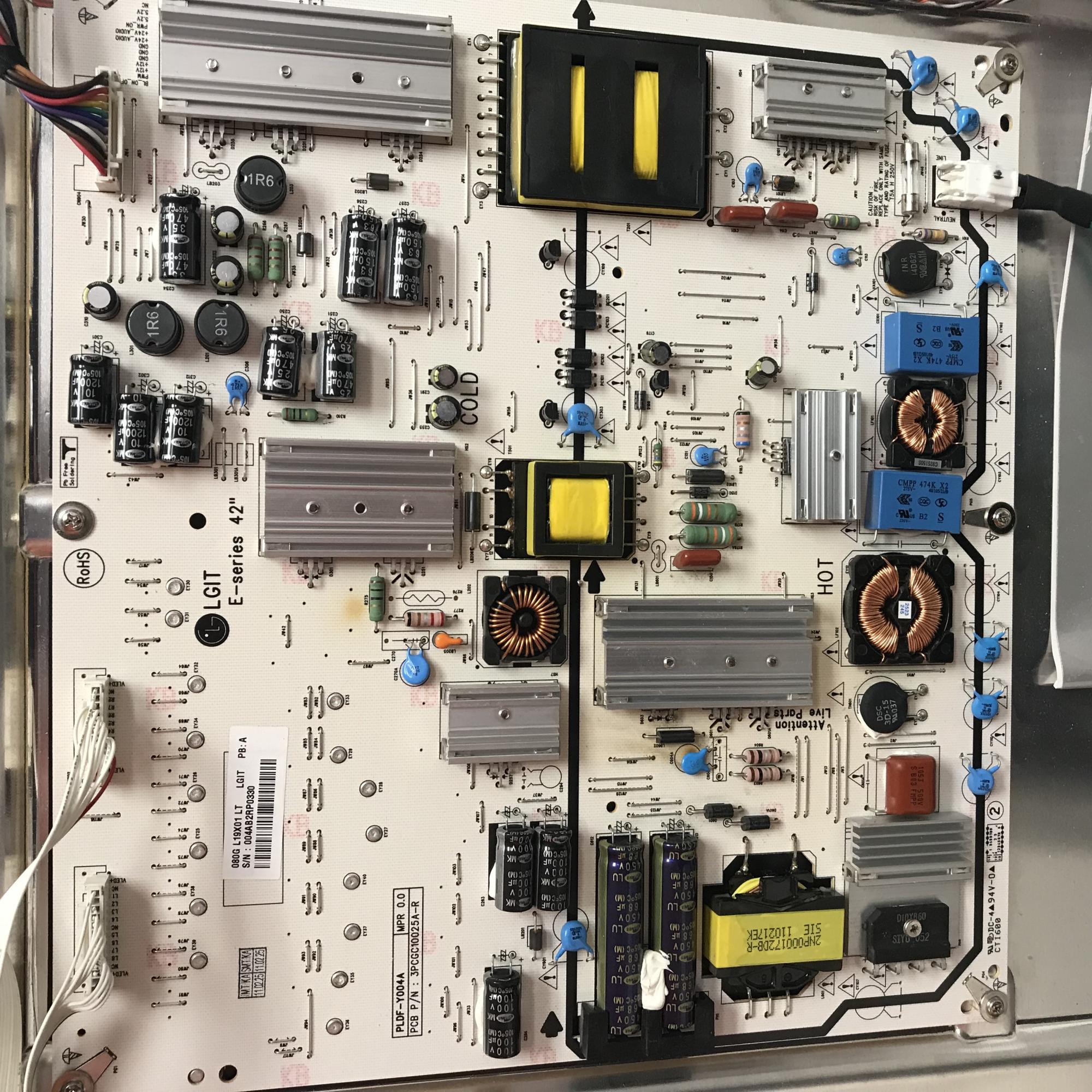

                    I'm attaching pictures of the board. And also of the IC with pin 1 marked. I hope I didn't mark it upside down? This is for reference so you know where my readings are.
                    When I removed the heatsink I scraped some of the lamination on the GND planes.
                    Should I go ahead and look at the back light circuit next? What are all these ICs in the repair kit for sim I don't even see on my board. I tried googling the designators but no luck finding any useful information.

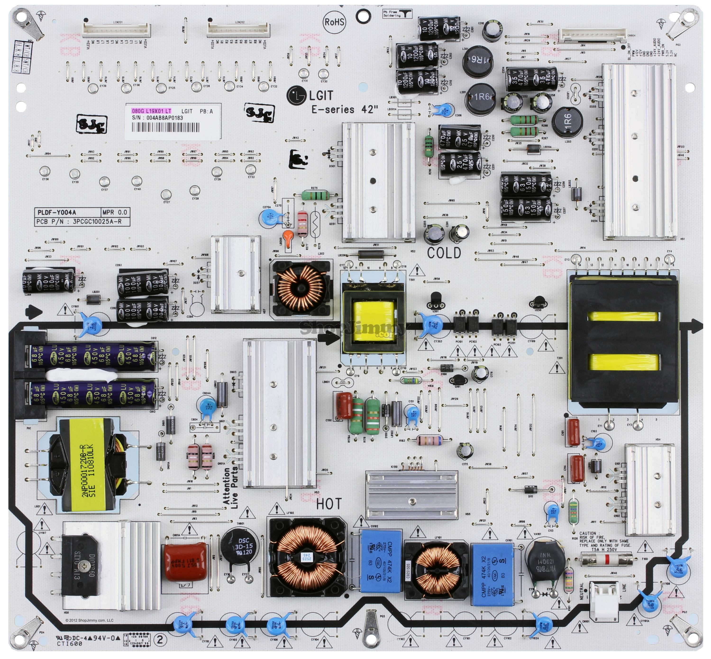

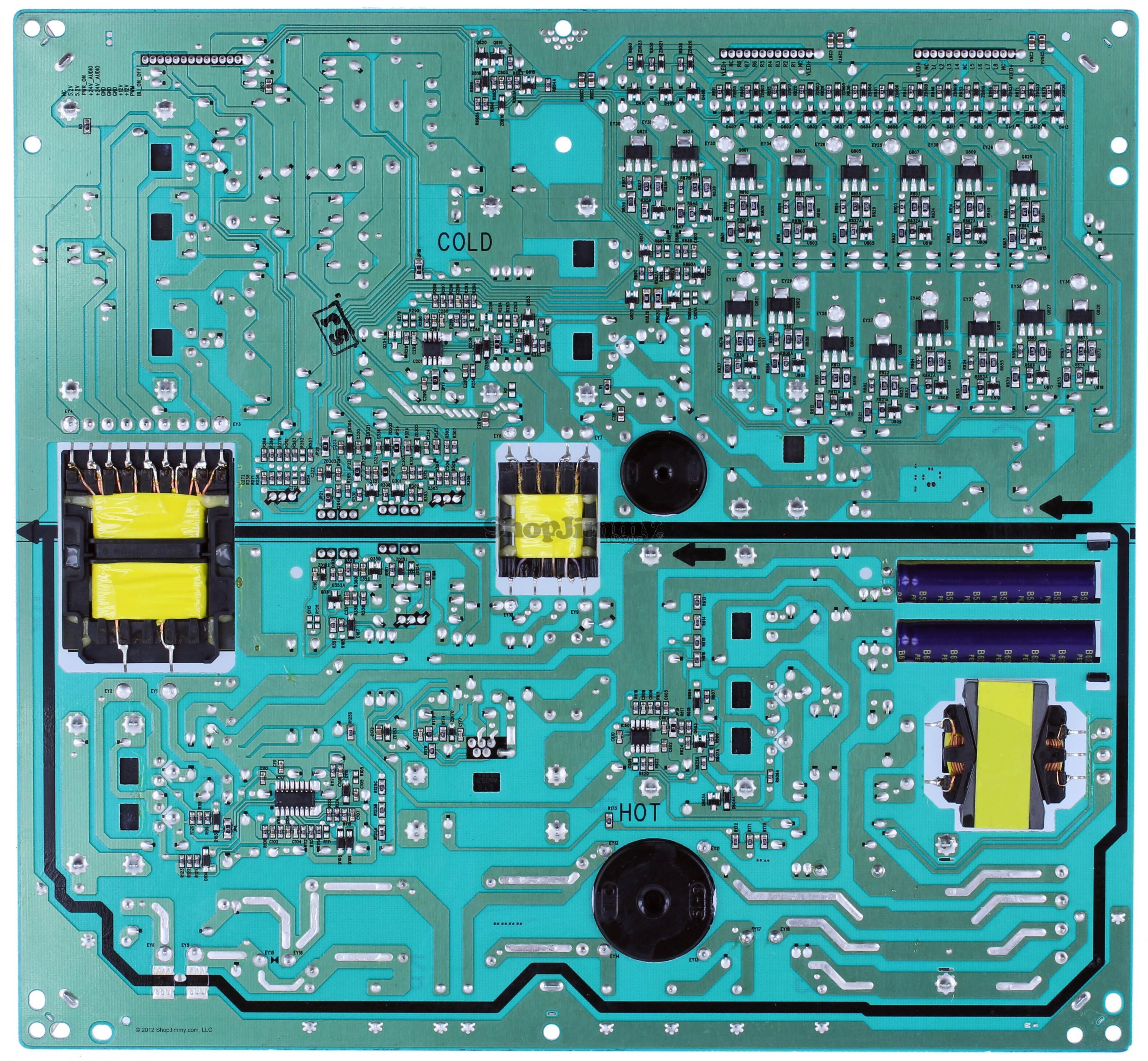

                      The kit you bought is for Vizio ADTVA2419AAY power supply board: https://www.shopjimmy.com/vizio-adtv...upply-unit.htm
                      But you indicated that your board is Vizio 080GL19X01LT
                      That is why the designators do not match, there is no repair kit, but they do have repair service for it.https://www.shopjimmy.com/vizio-080g...ir-service.htm

                                Again, IC601 is Infineon HS01G. That's is the ORIGINAL chip that was at that location. Are you saying it should not be there? It didn't look tampered with in the slightest, so that is what the board came with.
                                The kit which is wrong for this set, has no Infineon chips whatsoever. It does have an LD7571. Which is marked IC9801. You are the one thinking the chip is there when it's not. The PFC on this board is somewhere else, not at IC601.
                                Weird thing is there's not many ICs on this board, IC101 and U201 are also both SMPS chips.
                                IC150 is W6053N, another power mosfet. There is a repair kit for this TV on eBay from a San Antonio seller maybe I should email him and ask if he can confirm IC601. Can I ask why are you surprised it's not a PFC?

                                  Are these pictures below are the exact match of what you have? That is what I am going by. May be we are not looking at the same board, same board assembly.
                                  https://www.badcaps.net/forum/attach...8&d=1556430033
                                  https://www.badcaps.net/forum/attach...6&d=1556427641
                                  https://www.badcaps.net/forum/attach...7&d=1556430033
                                  Per pictures, it has have TWO SMPS IC on the hot side:
                                  IC150 (TO-220 casing attached to the heatsink) for the standby power supply.
                                  IC101 (SMD) for 12V and 24V.
                                  IC601 (SMD) IS the PFC IC, which you cannot put in SMPS IC is its place, period.
                                  So where in the world did you come up the IC150 as the MOSFET? https://cdn.badcaps-static.com/pdfs/...c988f8f0b9.pdf
                                  So the your kit https://www.shopjimmy.com/vizio-adtv...for-e420vt.htm you bought from Shopjimmy, correct?
                                  Just 4 IC's + other parts.
                                  IC9801 SMD as LD7571 (PFC IC)
                                  IC9301 through-hole for standby power supply.
                                  IC9101 SMD for 12V, 24V power supply.
                                  IC9803 ????
                                  So the bottom line is that you never remove IC601 from your board, correct? And you are the original owner of the TV.
                                  And what happen to the resistance readings of the two PFC diodes?
                                  BTW, looking at your picture, it looks like you replaced the PFC diode and the two PFC MOSFET's.
                                  The soldering does not look good.

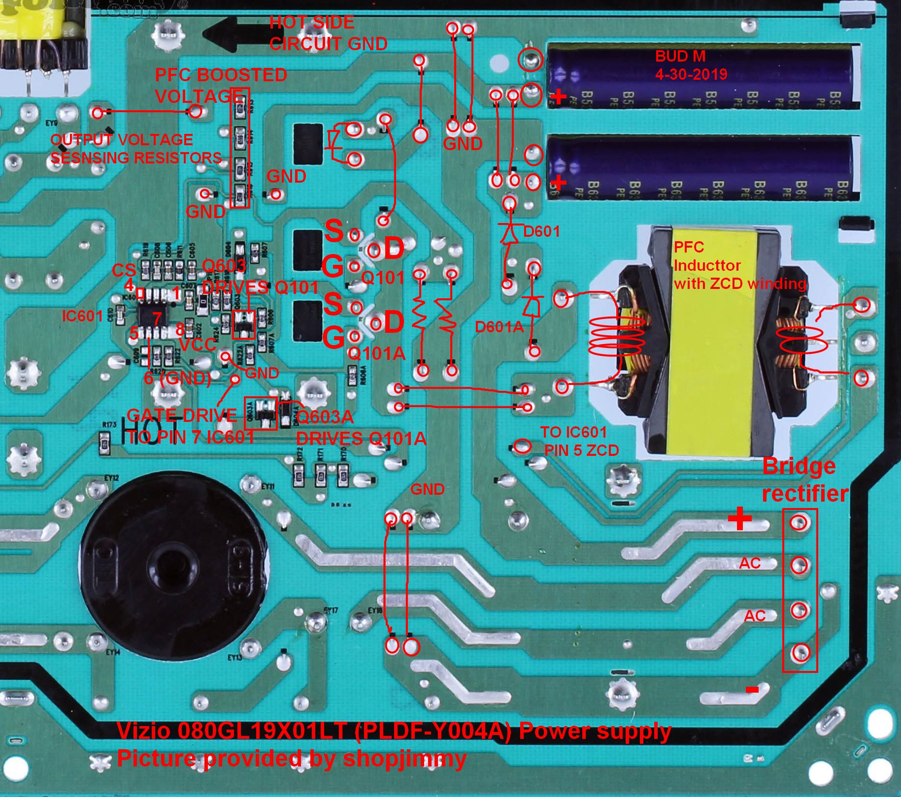

                                    Re: Vizio/LG E420VT
                                    Based on pictures from shopjimmy, this is what I see and from the look of it, it looks like the pin out matched PFC LD7591, the connections do not match ICE1HS01G-DS as far as I can see from the board layout.
                                    So based on your reading of IC601 using pin out of LD7591: It looks like it is dead based on spec sheet. But at this point you should verify with the kit seller as to what the IC601 should be your board, make sure to provide them with pictures and board P/N.
                                    1. (INV) 0.0v.
                                    2. (Comp) 5.0v
                                    3. (Ramp) 0.0v
                                    4. (CS) 1.0v
                                    5. (ZCD) 0.0v
                                    6. (GND) 0.0v
                                    7. (OUT, Gate drive) 1.0v.
                                    8. (Vcc) 15.0v
                                    BTW, you can also look at the application circuit of the LD7591, it looks pretty close to what IC601 is connected.
