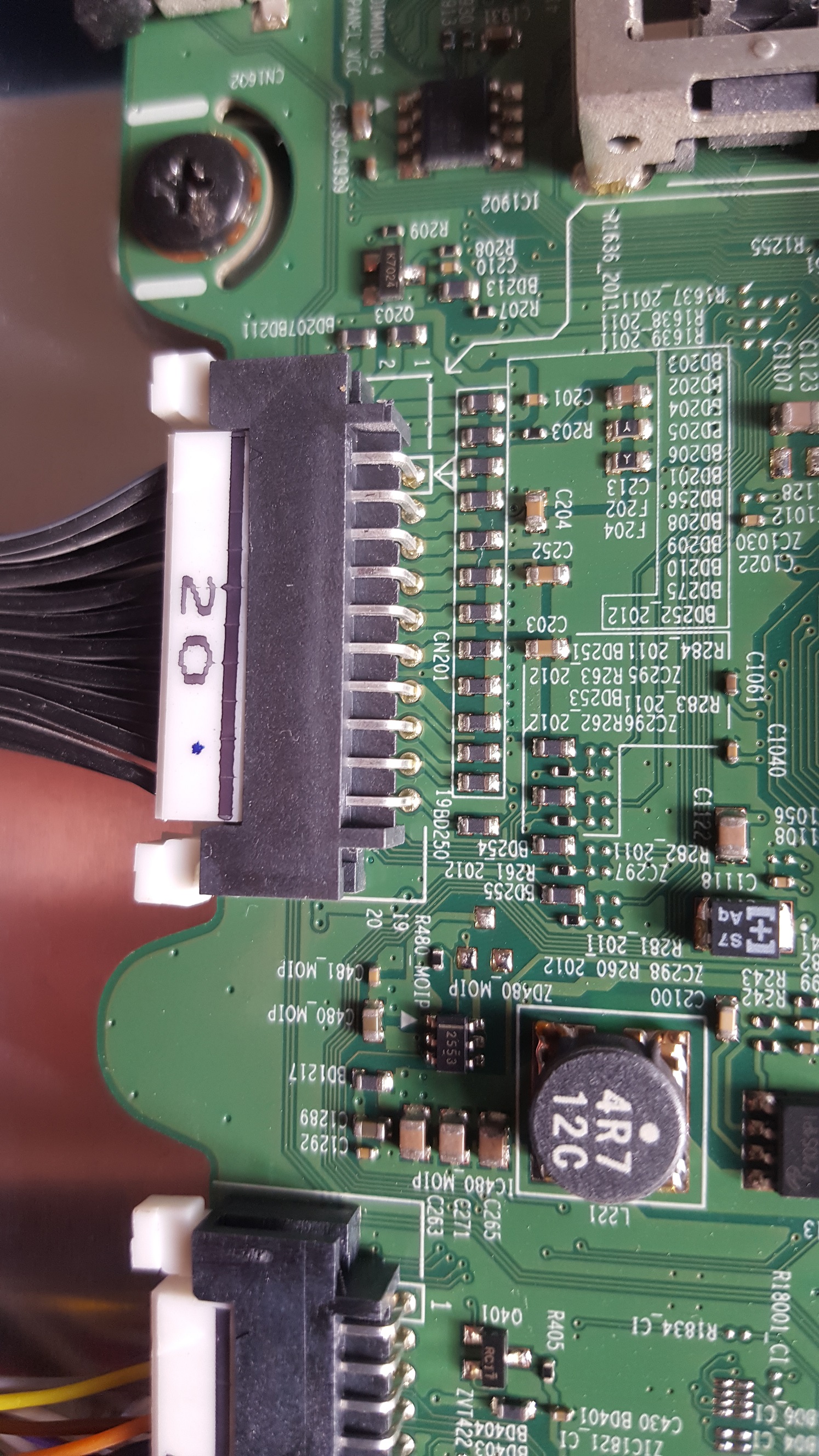

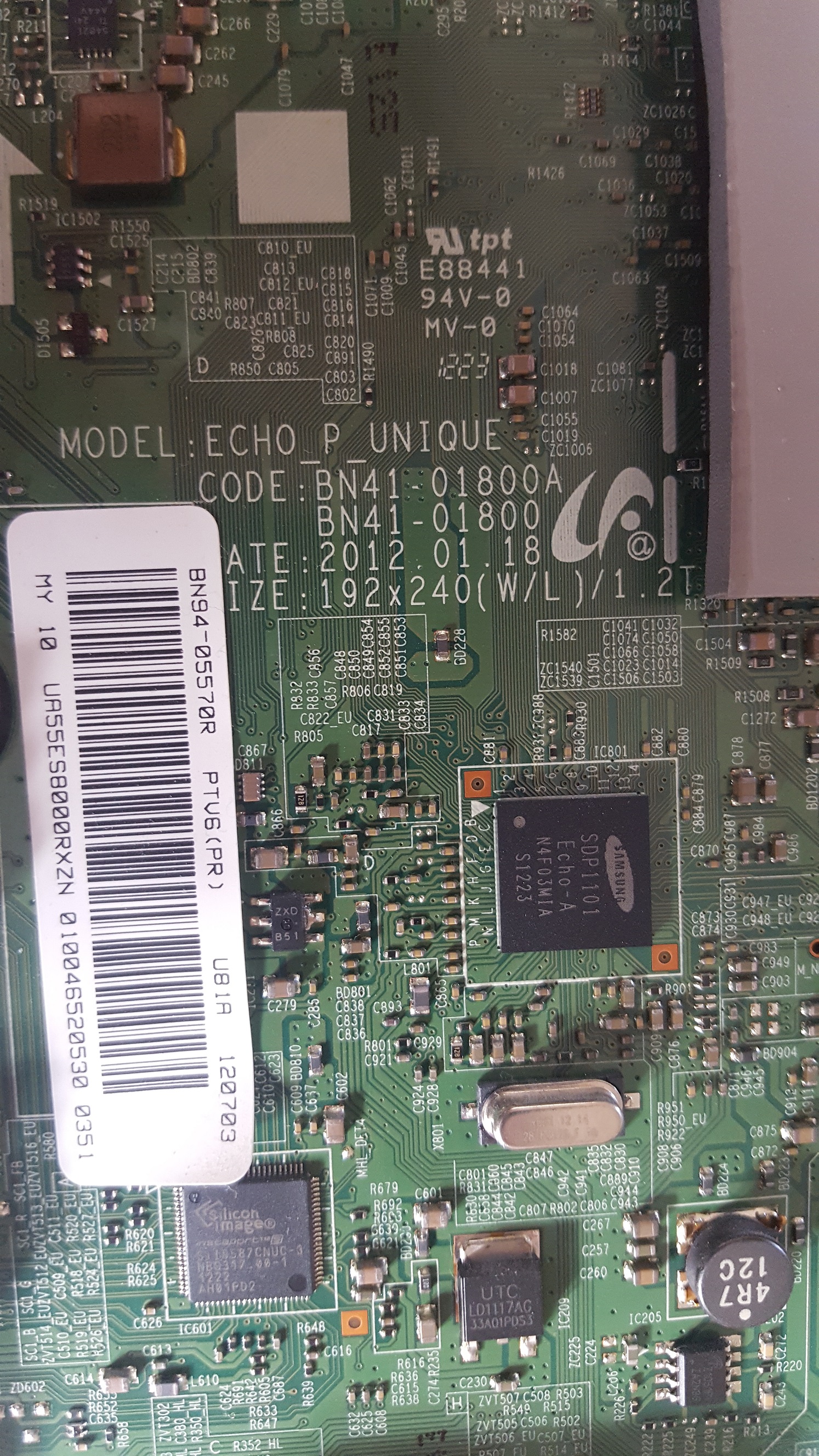

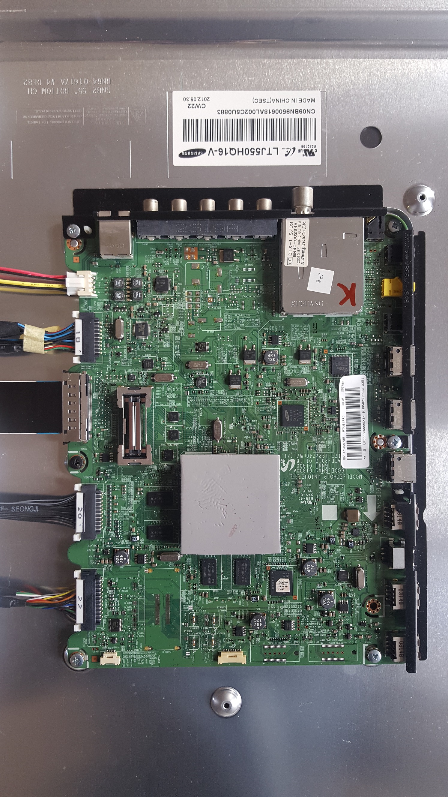

    hello.
    I have a Samsung 55" TV model UA55ES8000.
    issue:
    randomly restarts.
    Seems to stop restarting after 1-2 hour of ON time.
    I have not taken any voltage readings yet, as I don't know what to look for.
    I have attached a few pic's of the motherboard etc.
    BN94-05570R
    BN41-01800A

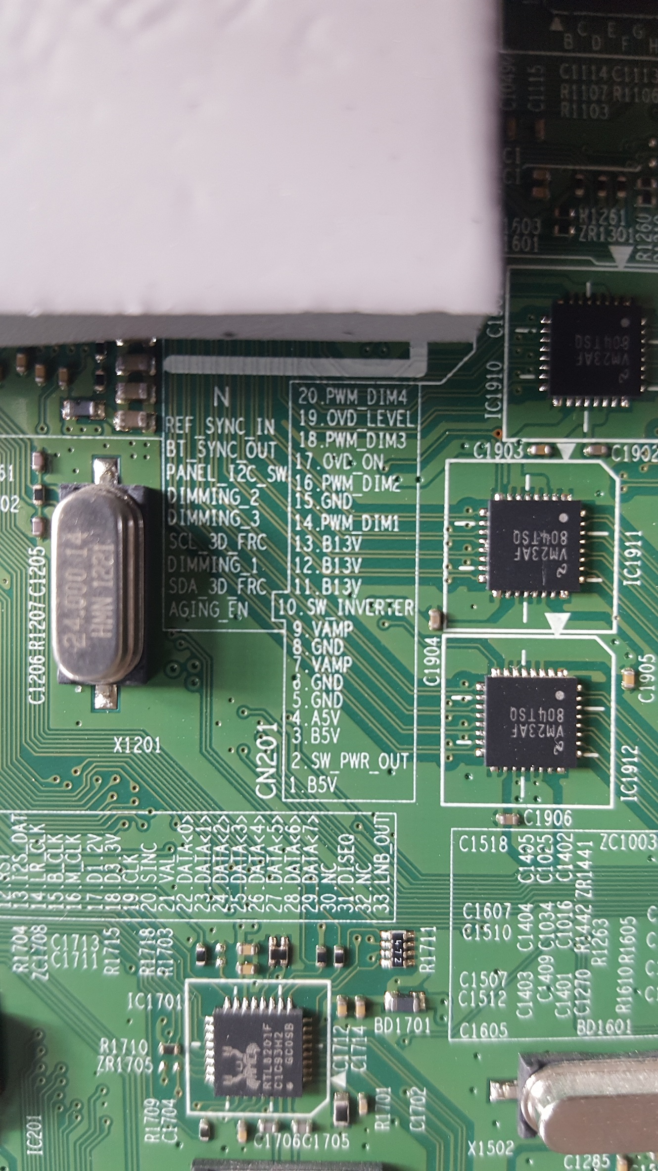

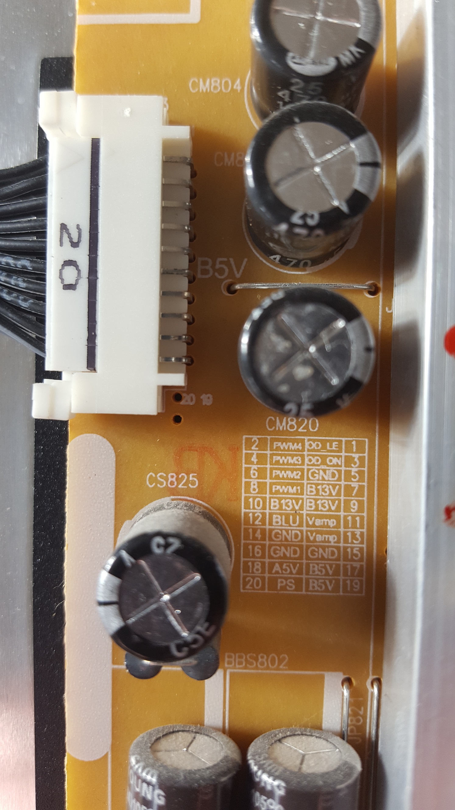

    Re: Samsung TV randomly restart, UA55ES8000

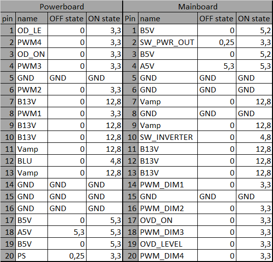

    First things first: Test connector from mainboard to powerboard on powerboard side, sholud be a little legend/map of expected voltages, test with tv plugged in but off then hit power, report both conditions here, give pin number, pin description and condition on and off, demonstration in signature below.
      ok. got the measurements.
      • nomoresonys
        • Jan 2013
        • 12269
        • U.S.
        Ok, those look pretty good, try a factory reset if you didn't already, if that don't work try a firmware update, 2 good and free things you can start with, if that don't work will have to look deeper.

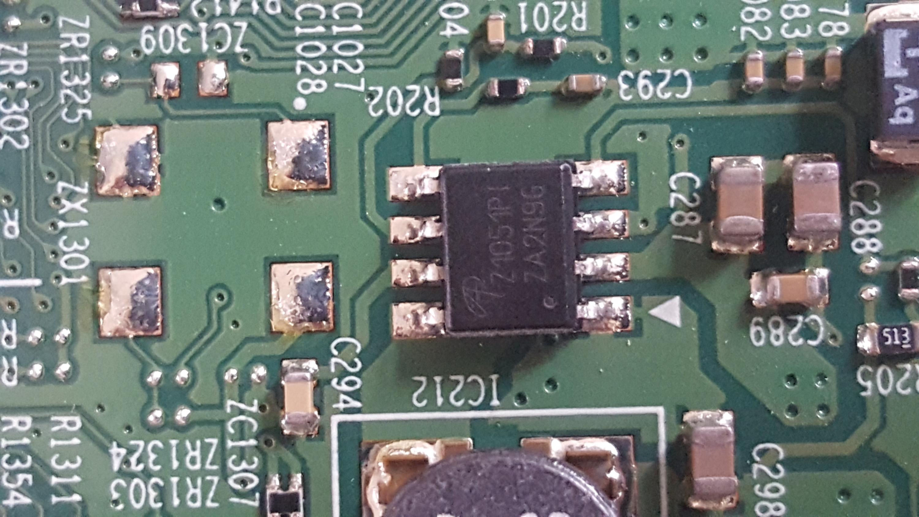

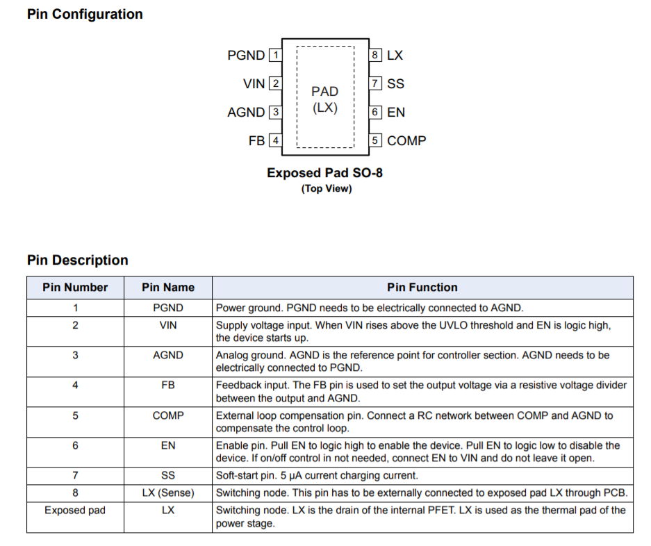

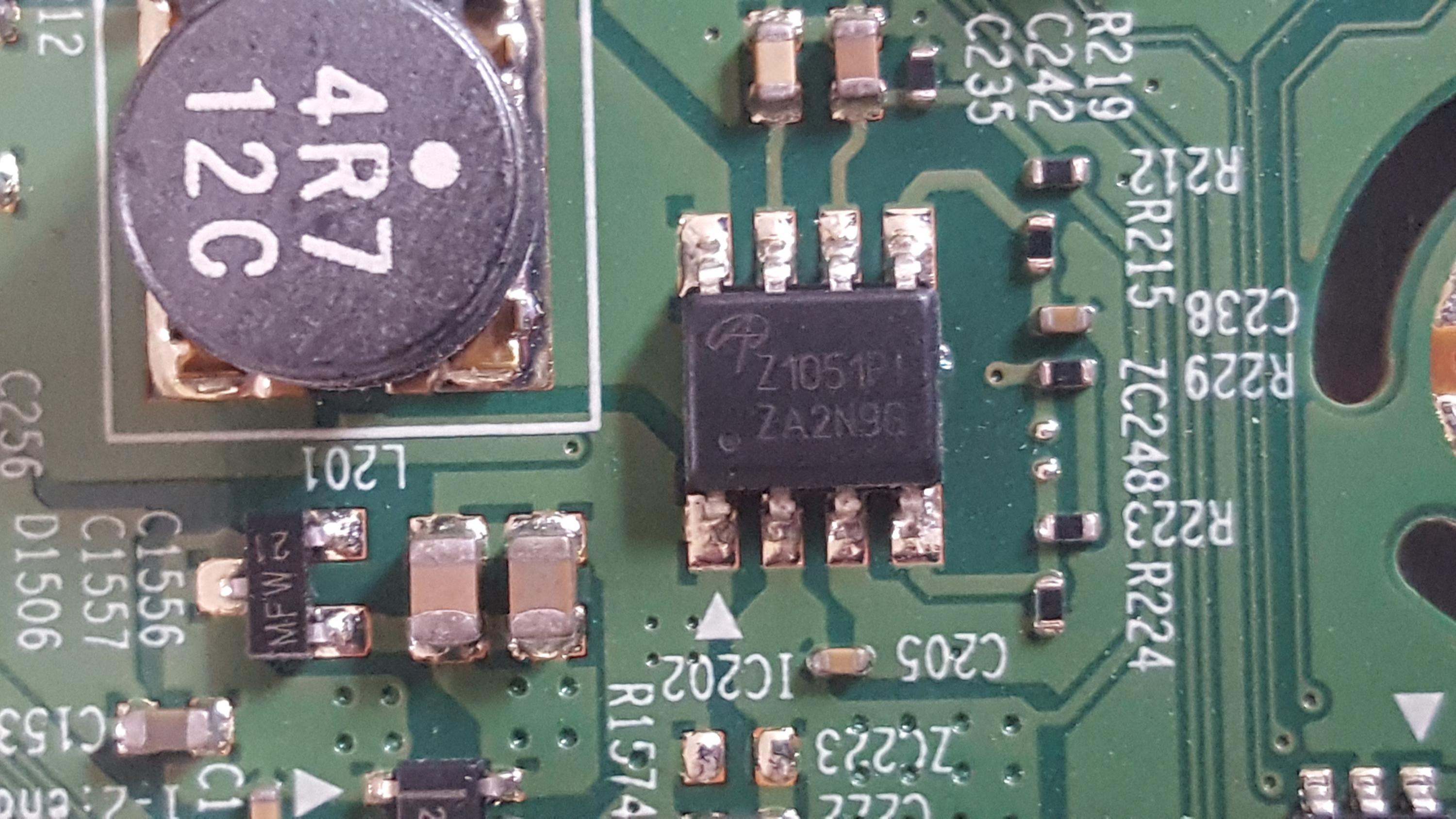

                  so something interesting came up while probing around.
                  I started by removing the power cable between powerboard and mainboard to isolate the powerboard, turned it on, nothing happend, it kept running as it should.
                  reconnected everything and started probing around the mainboard.
                  to my surprise I found a place/power-rail where I could force restart, by just touching the pin with my probe(GND from multi-meter not touching anything).
                  It turns out, everytime i would touch pin 4 on IC202 it would restart.
                  Pin 4 is a Feedback input, see attached images
                  also another similar IC, IC212 would do the same, but I could here a electric "fzzzzzz" sound when touching pin 4.
                  what you make of that ?
