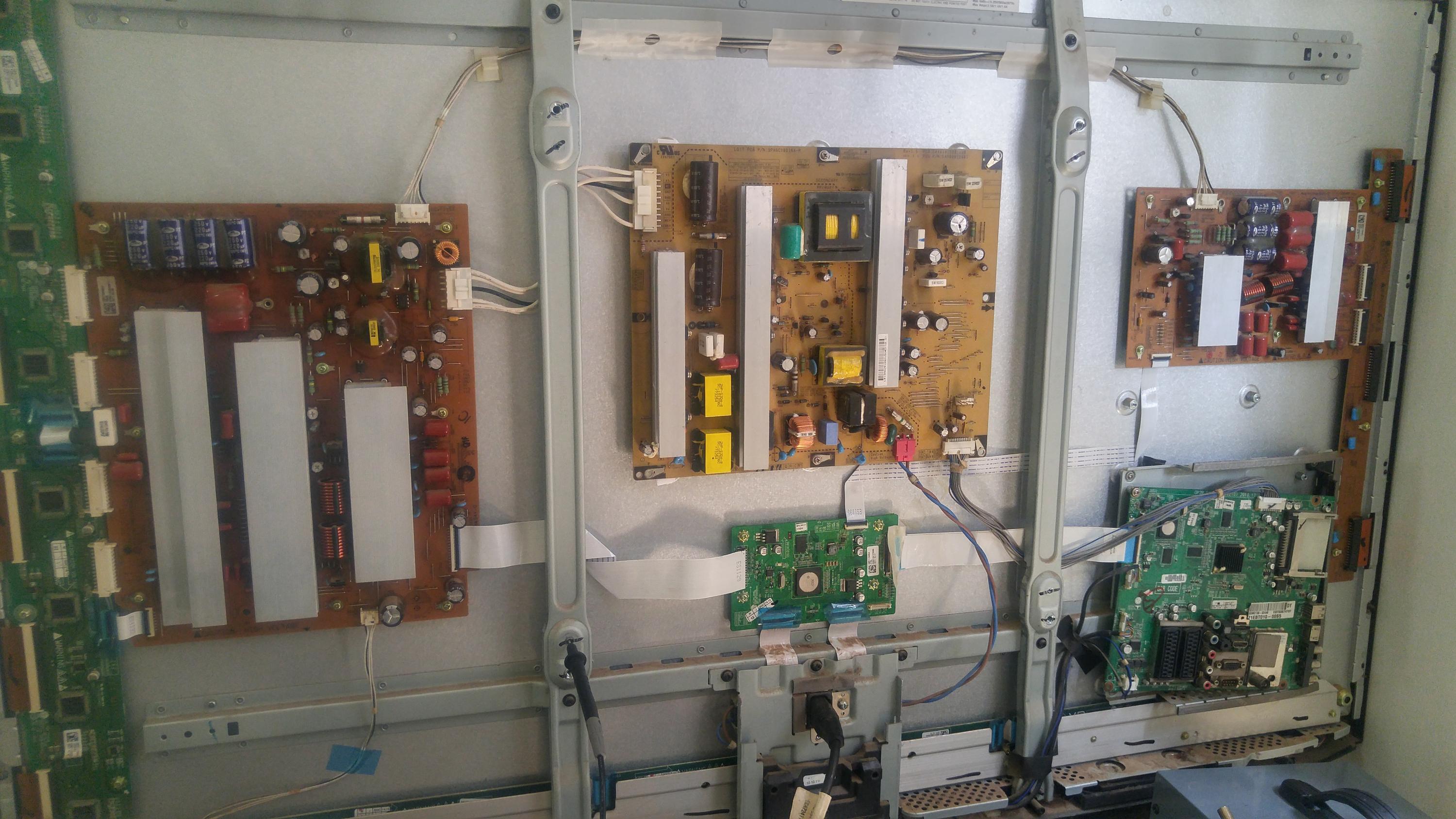

    LG 50PW451 black screen, no sound.
    Hi. I have a 50 inch LG plasma. No picture at startup, no sound. The controls go well, they are done with the remote control or on the front panel of the TV, they seem to go well. The power indicator lights up. The voltages indicated VA = 55V; Vs = 205V are present on the power supply unit and on Y-Sus. But the Control Card flashes short-short-long-short. What does this code mean?

    Re: LG 50PW451 black screen, no sound.
    Run the test patterns. Post pictures of your tv boards and we can tell you how to do it.

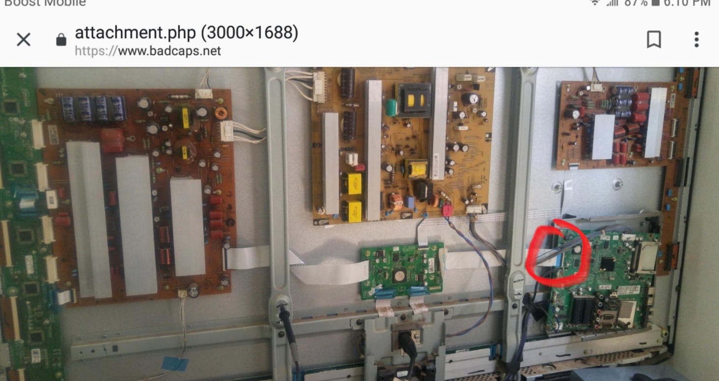

        To run the test patterns, unplug the connector circled in red. Take a piece of wire and put it in the logic board holes. Plug tv back in and look for colors on the screen.I think the holes are marked r51 and r52. Send a clear close up pic of the logic board for us to make sure.
          I can't see the connector you talk about. Can you send me a photo?
            Here you go.
