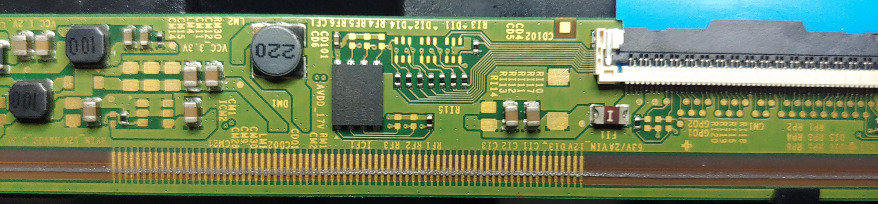

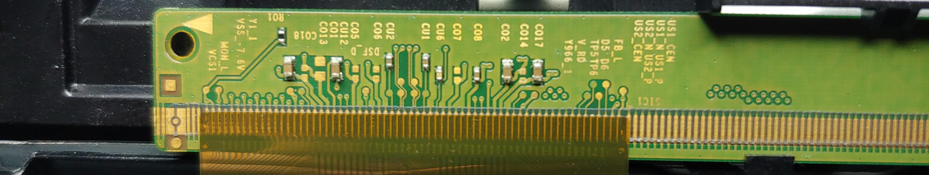

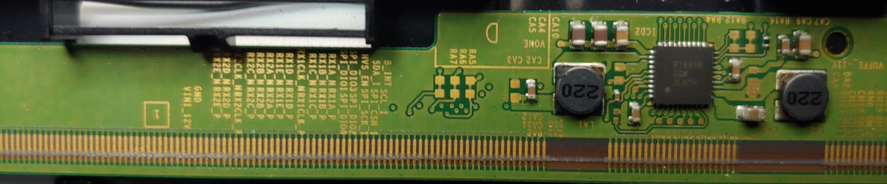

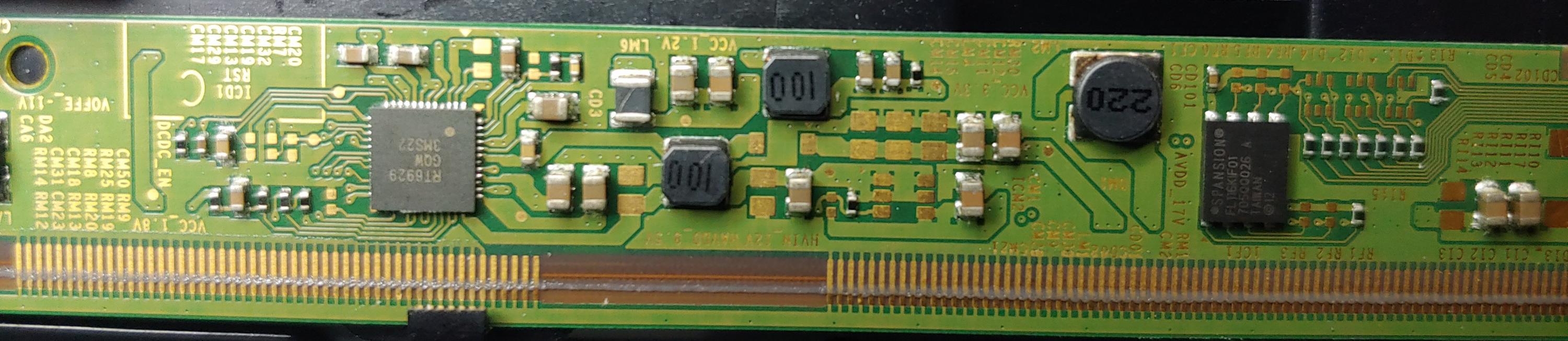

    Taken close up pictures of the tcon/long thin board connected to the screen. Will be testing voltage at test points when i can. I will try to get get voltage reading at different part locations and list those voltages.

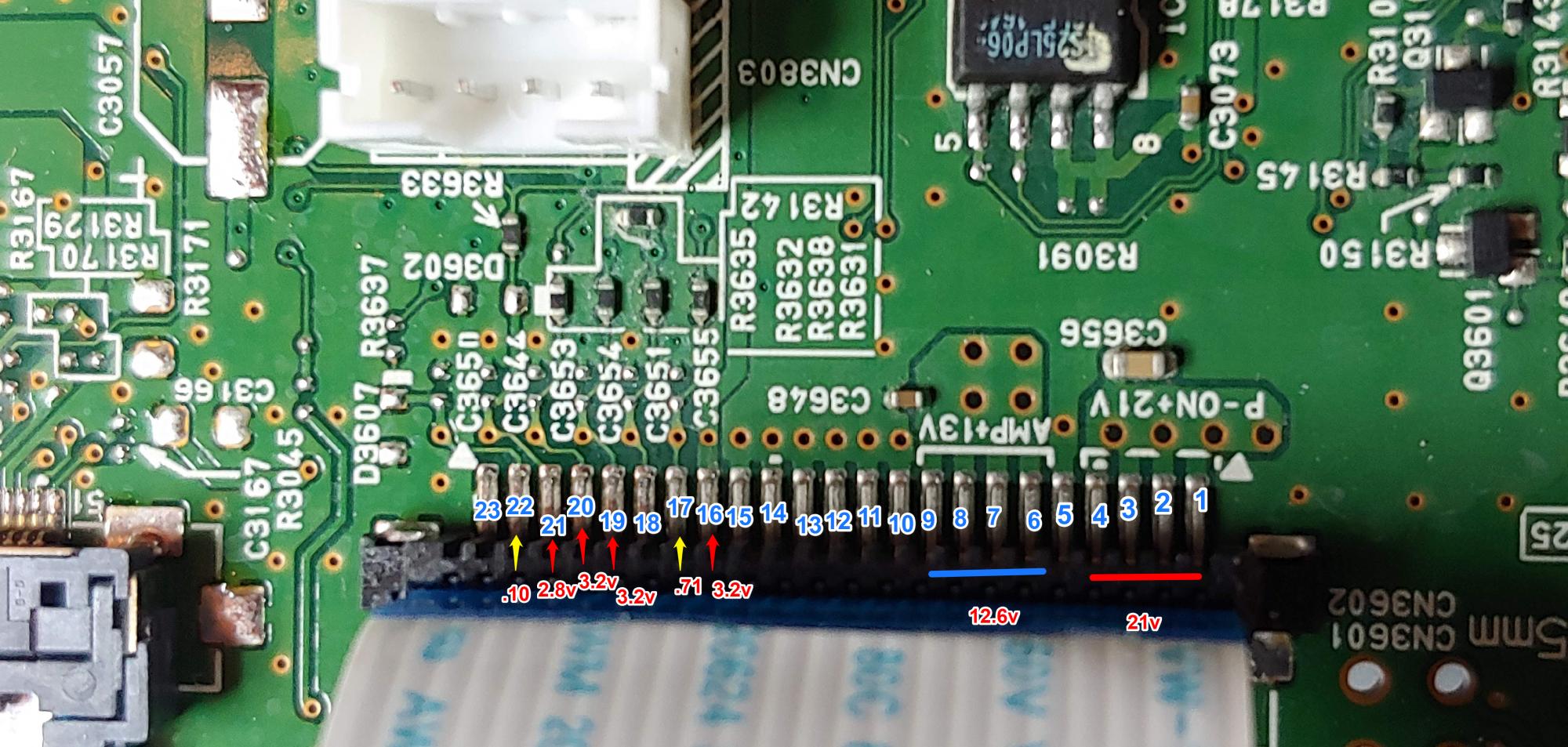

                Sorry if im not getting everything posted the way you are wanting it. Im trying to do my best. I'm trying to get my work area wired up with more lights so that i can see what im doing better and be able to take better pictures and such.
                Im posting some pictures that are marked up in skitch with the voltage reading but i will try to do my best to post them in text here.
                these are the readings that are on the main board. the connector that runs to the power board. They are really not marked on the board what they are except a few of them. The numbering i am using is mine ive also numbered them in the picture as well.

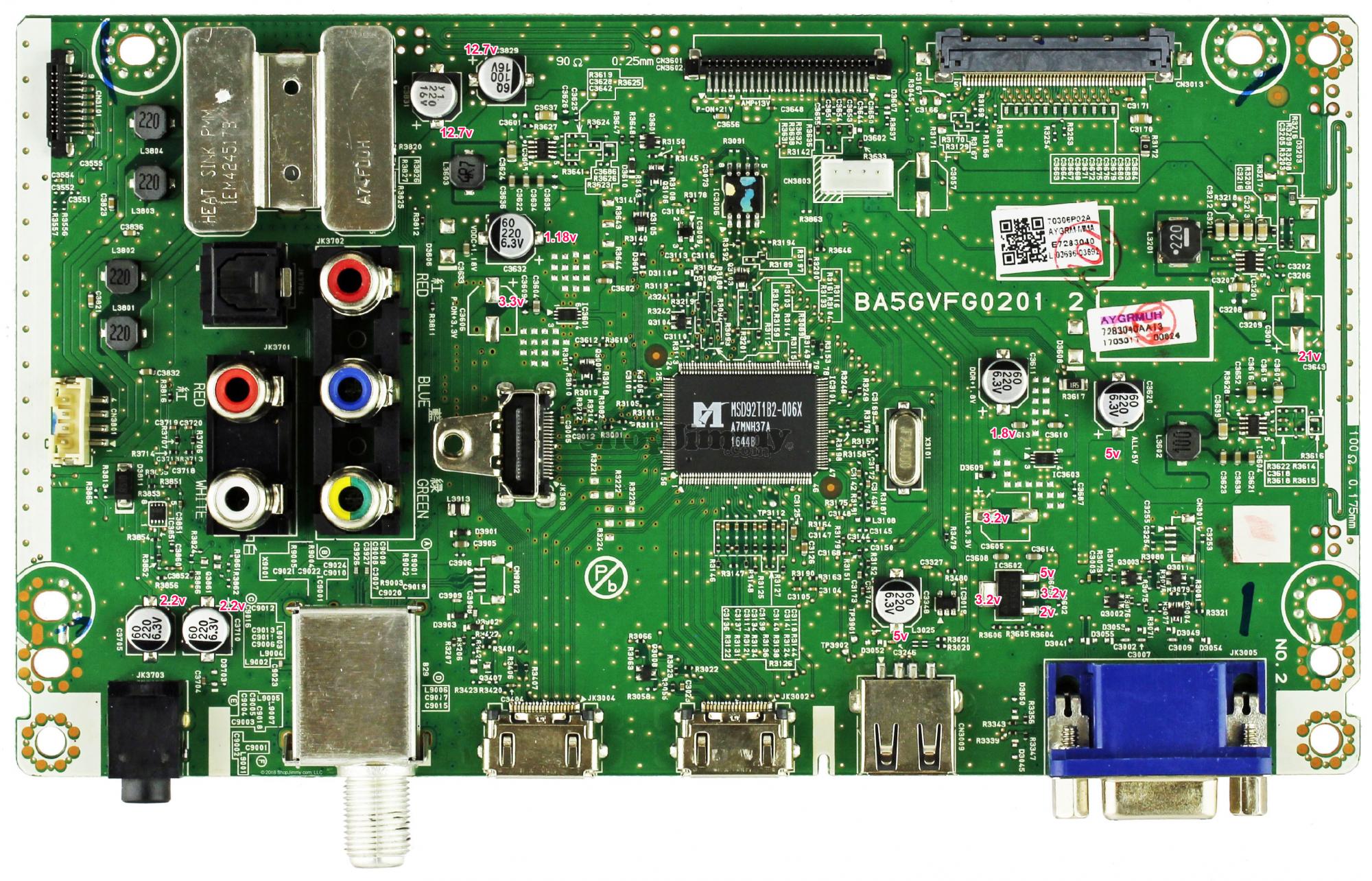

                I also took reading at the metal caps that where on the main board that had voltage readings marked on the board and a few locations that did not have voltages. I also took some readings of one of the ic on the board as well.

                I have not taken any readings form the power board connector because you can not access the ribbon form the top of the board when it is screwed down to the TV for grounding purposes. I have taken reading from the jumper wires that are near that connector that are marked with names and voltages. I am including a picture of those jumper wires and the voltages i got when testing them. some of those jumper wires do have voltage reading marked on the board as to what they should be. If i have to write them up here i will in the next post but it is probably just as easy to just look at the picture.
                • cherokee.warrior
                  • May 2017
                  • 87
                  #48
                  Re: Sanyo FW55D25F stuck in color test mode
                  1-4 are listed as p-on +21v 6-9 are listed as amp +13v.

                    seems to be quite different from the "scribble" that you posted earlier... what happen?

                      The "request" for a listing of the voltages on the connector versus label is so people can easily determine what's up at a given connector. Providing voltages internal to the board doesn't really completely convey things as voltage at the board may not have made it to the connector. You are stuck about measuring a voltage... most meters have a resistance portion for doing "CONTINUITY". You don't need the board to be powered or otherwise to determine if a point on the connector has a connection to some point / wire else where in the board.... as suggested it is a simple continuity test to determine which point is connected to the connector. Once you have determine that, you KNOW that the voltage at the point has been transferred to that connector point... ALONG with the label. :-)
                      Anyway, at first "look" at the voltages, it would appear that BL-5v isn't what you are getting... since you indicate ~3v.
                      Related to the previous comment about determining whats happening at the connector, you indicate "0" voltage.... this maybe true, but what does that mean? Why the question because "0" could mean "no connection" or it could mean ground... you need to understand which is which and label accordingly.

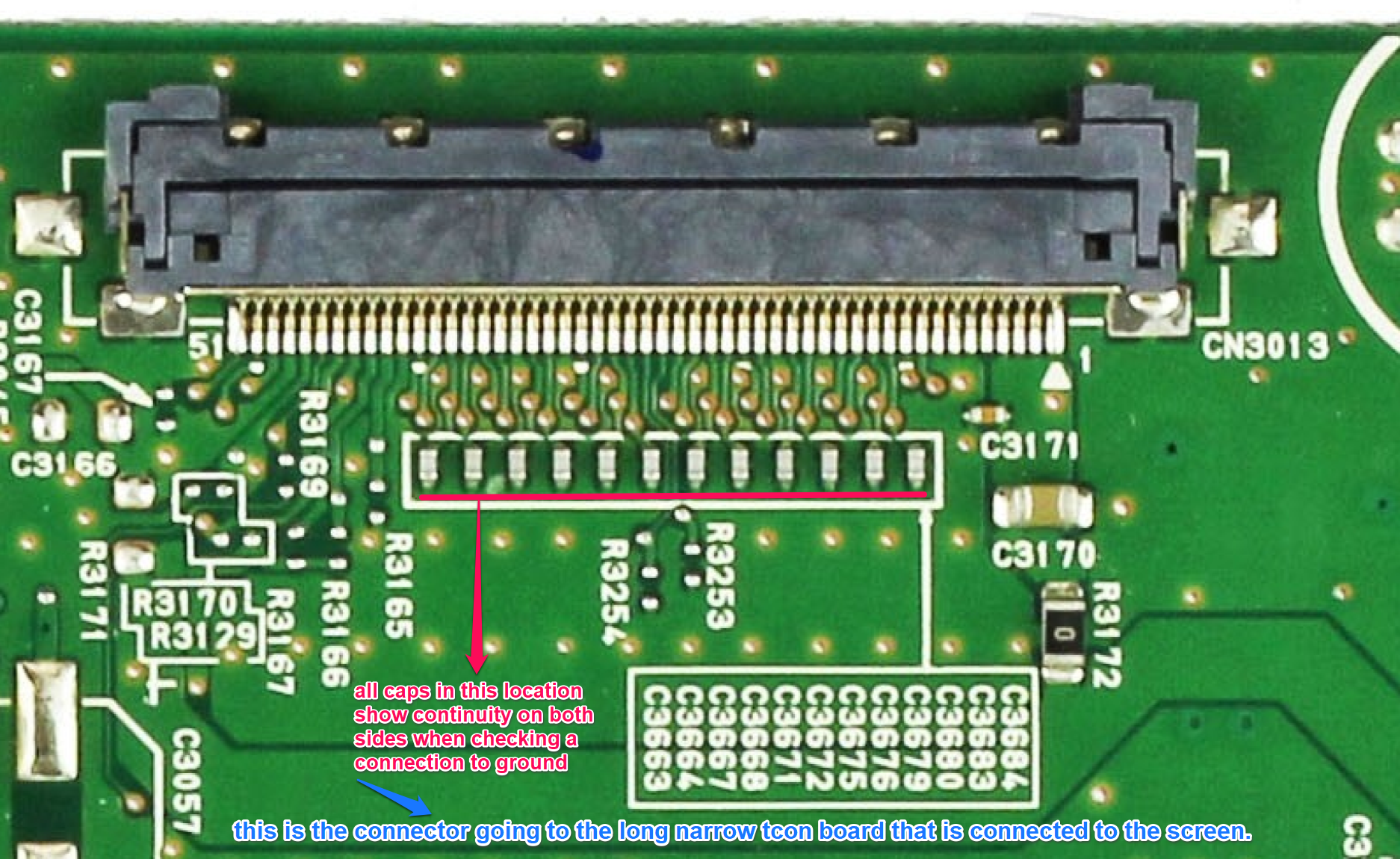

                                Update I did some continuity checks on the connector on the main board that runs to the power board. There are several pins that seem to be running to ground they are 5 10 11 12 13 14 15 23.
                                I was also doing to short to ground checks on the main board and i found some near cn3013. Are all these caps supposed to be reading continuity to ground on both sides of the cap. see one of the pictures on this post to see what im talking about. The one you said was BL-5v looks like it says BL-sw when i look at it up close.

                                  was the "caps to ground" test done with the connector plugged up or open?
                                  yes I see the "bl-sw" so that value is likely OK.
                                  How were you checking continuity to test the caps in the afore mentioned area? what exactly was the reading? It would be highly "unusual" that every cap would have failed.
                                  Note: the word "continuity" is somewhat "generic" in that it is used to mean "not an open circuit".... to determine the "type of continuity", the measured result is used... a resistor will have continuity but some resistance value, a wire will have continuity but with 0 (very very little resistance) resistance, a "continuity short". Most capacitors may have some form of continuity as the "innards" charge / "leak".... depending on value (and direction), it may indicate a possible failure.

                                    NOTE: that this list ("value" being 0) is somewhat different than your earlier list measured at the connector.... wonder why??? :-)

                                      I check from ground (the metal frame of the tv) to those numbers listed above and got continuity go they must be grounded. You didn't like the zero reading so i check to see if any where grounded. The cables where connected. I will do it again without. Im just being pulled in so many directions at the moment im not concentrating on what's being said. My wife keeps wanting to talk every time i try to read you previous post. Ahhh.

                                          I am not questioning the "ground check"... You can see from the board layout that the listed pins are connected to ground. What I tried to focus your attention on was that there was a "difference" between that you listed that are "grounded" (probably reading 0) and the ones that you show readings across the connector.... to make it more obvious what's up with pin 18... :-)
                                          You need to focus on differences or something not lining up in your tests.
                                          Seems rather strange "perhaps" that it has is 0... or it could be alright.... you will never know until you do some tracking on it.
