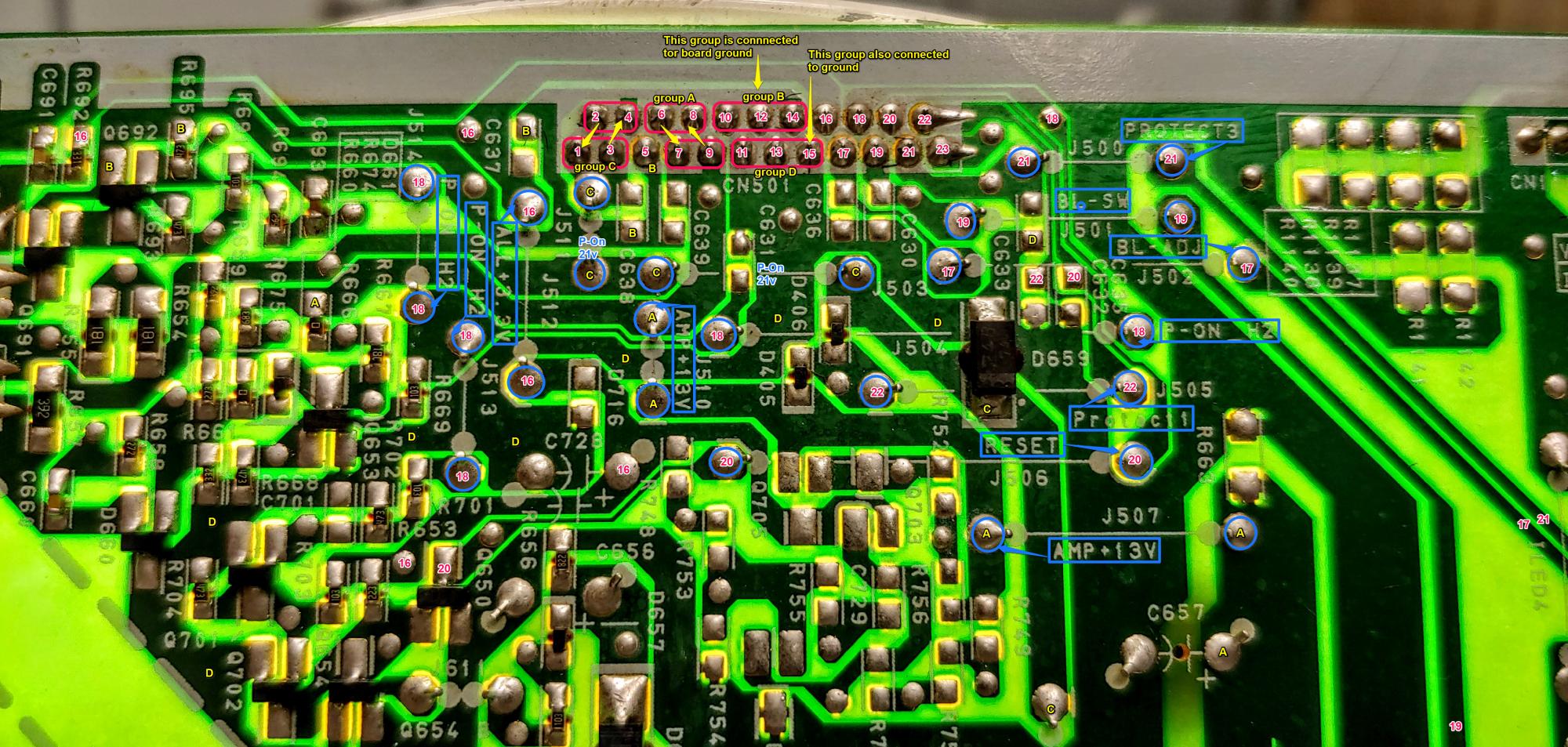

    Pin 18 i have notice that myself and am looking into it. Ive been trying to trace out the connector on the power board that runs to the main board. I need to try to figure out what is what there then see which pin they lead to on the main board. Try to see where pin 18 is coming from there. Maybe it's something that doesn't have power. Just got my florescent lights put up yesterday so now i can see what im doing. Just got to find spare time from normal work, stuff around the house and honey doos to get back to looking at it again.

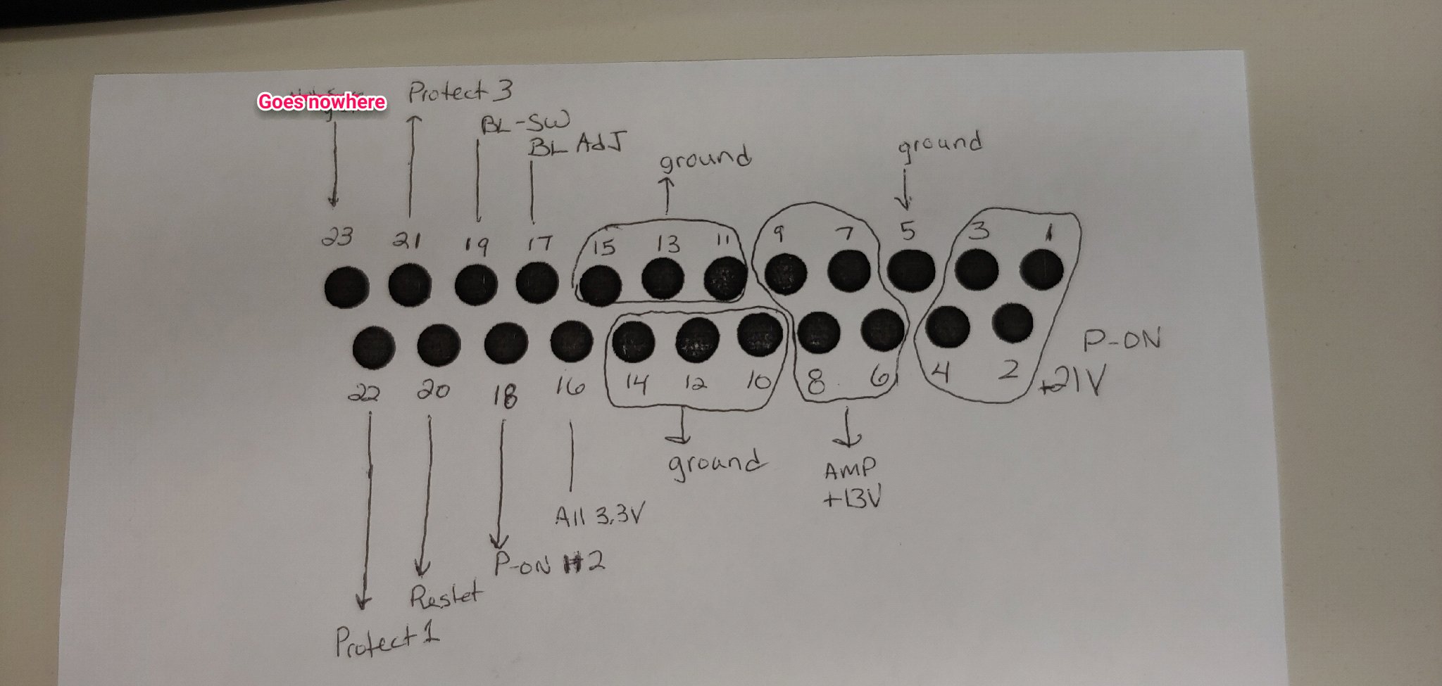

      Re: Sanyo FW55D25F stuck in color test mode
      Ok i have been working hard to find out what the pinout on the power board is so here is what i have come to.
      Pins 1 2 3 4 P-On 21v
      Pin 5 Board ground
      Pins 6 7 8 9 Amp +13v
      Pins 10 11 12 13 14 15 Board ground
      Pin 16 All 3.3v
      Pin 17 BL-ADJ
      Pin 18 P-on H2
      Pin 19 BL-SW
      Pin 20 Reset
      Pin 21 Protect 3
      Pin 22 Protect 1
      Pin 23 Does not seem to go to anything
      Its getting late so i will i will get to looking at it more at a later time. I hope what i have done so far here is redeemed me in a small way....

          #64
          Here is the pinout i intended to post for power board
