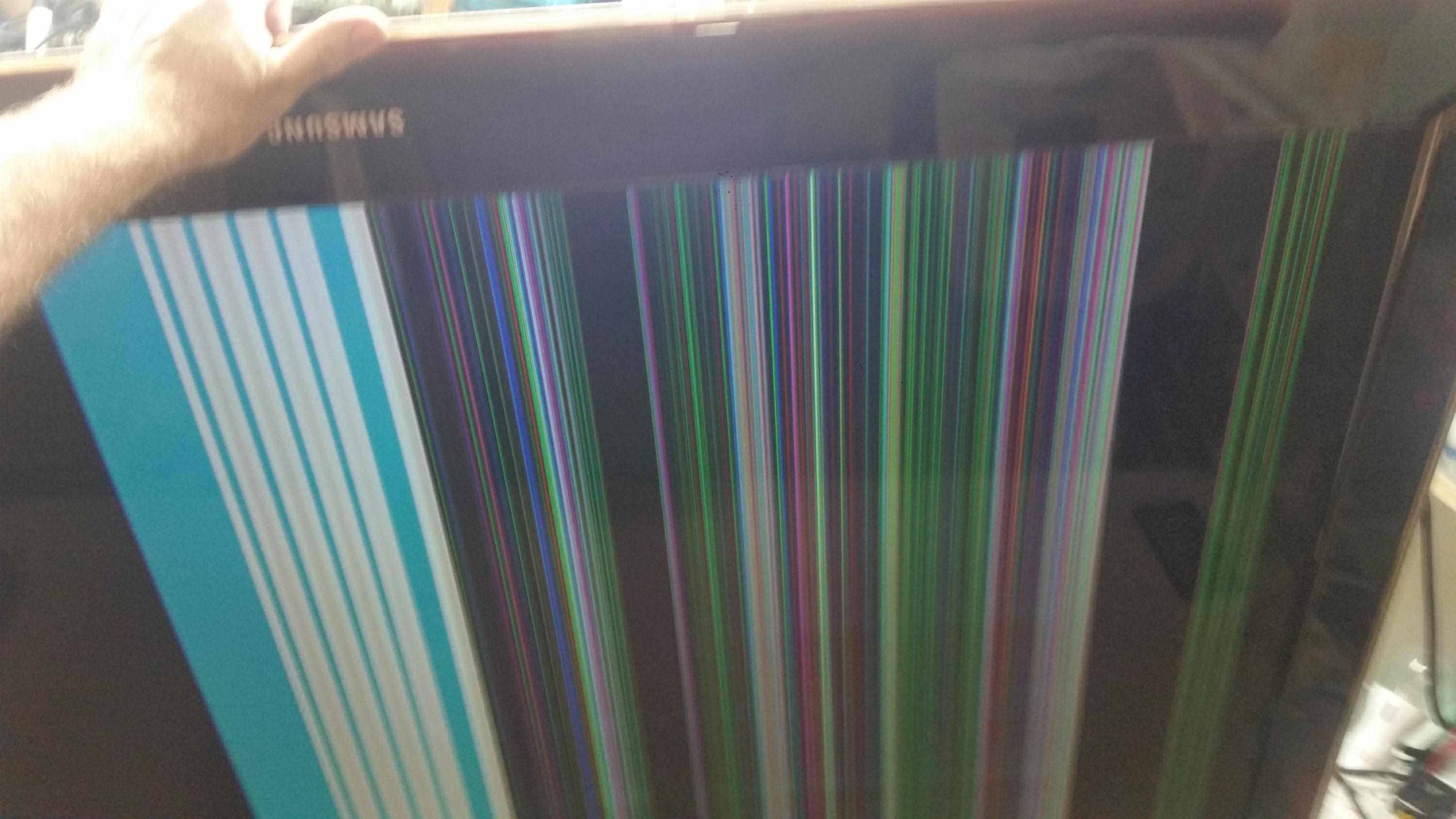

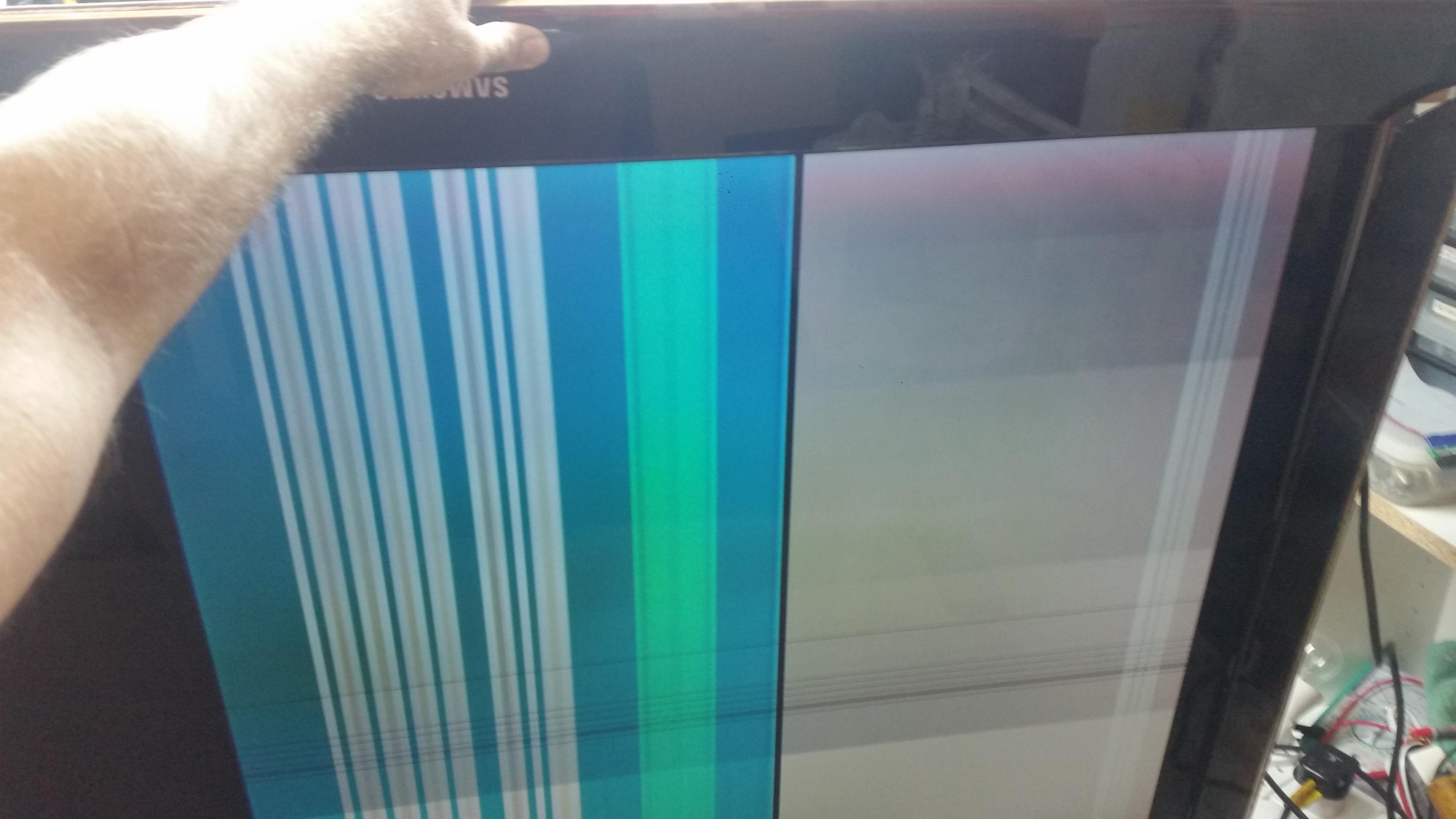

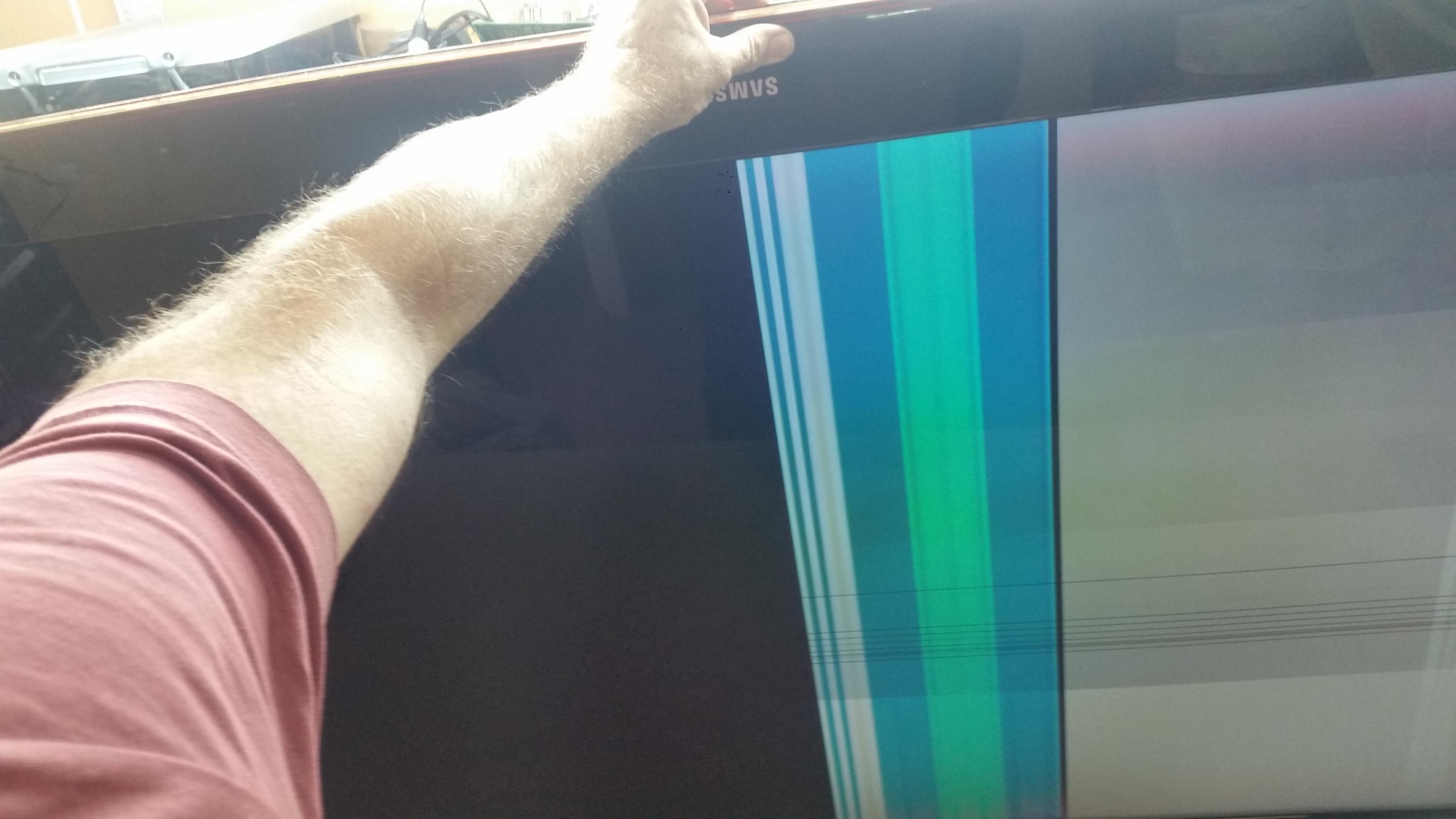

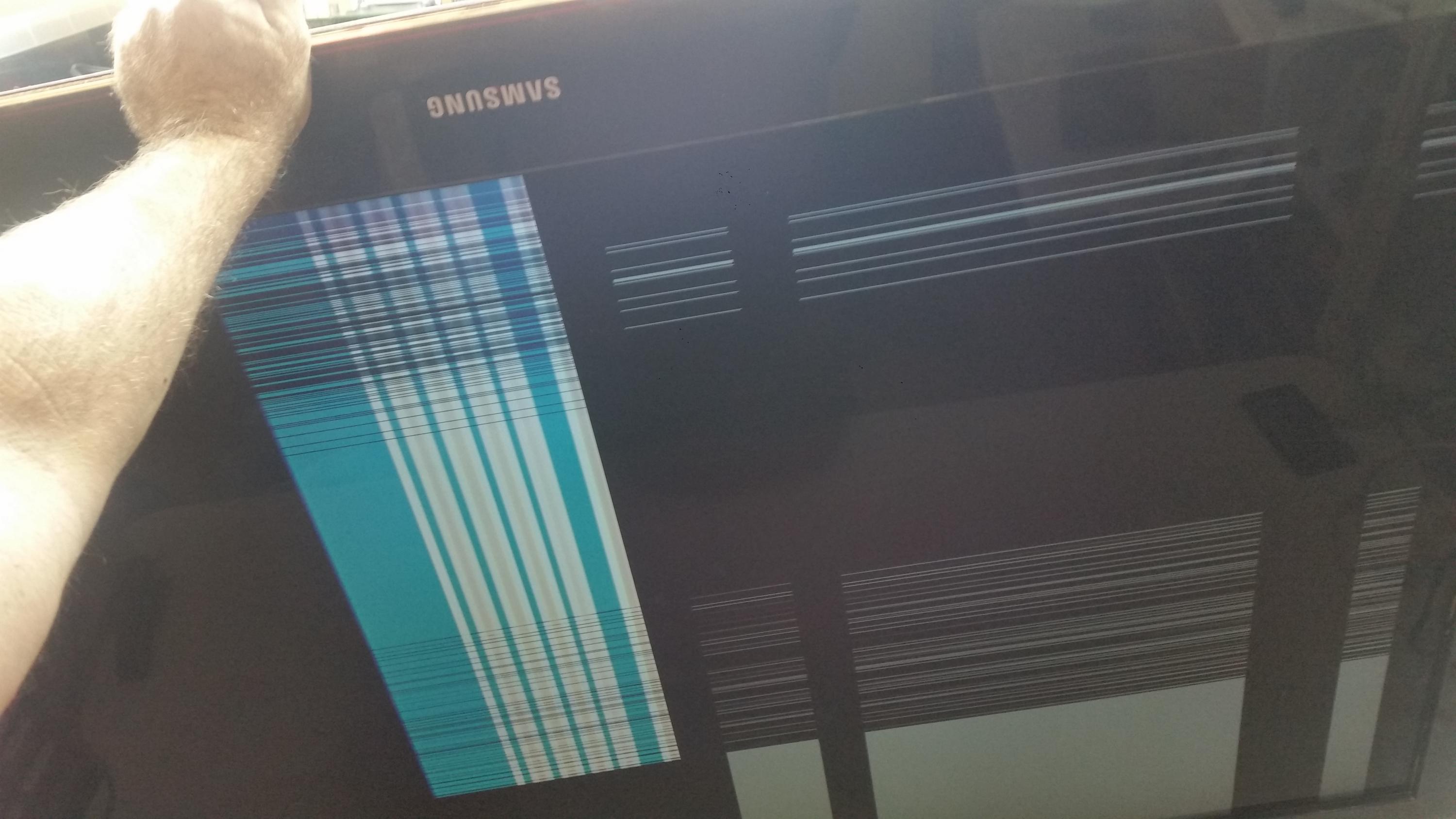

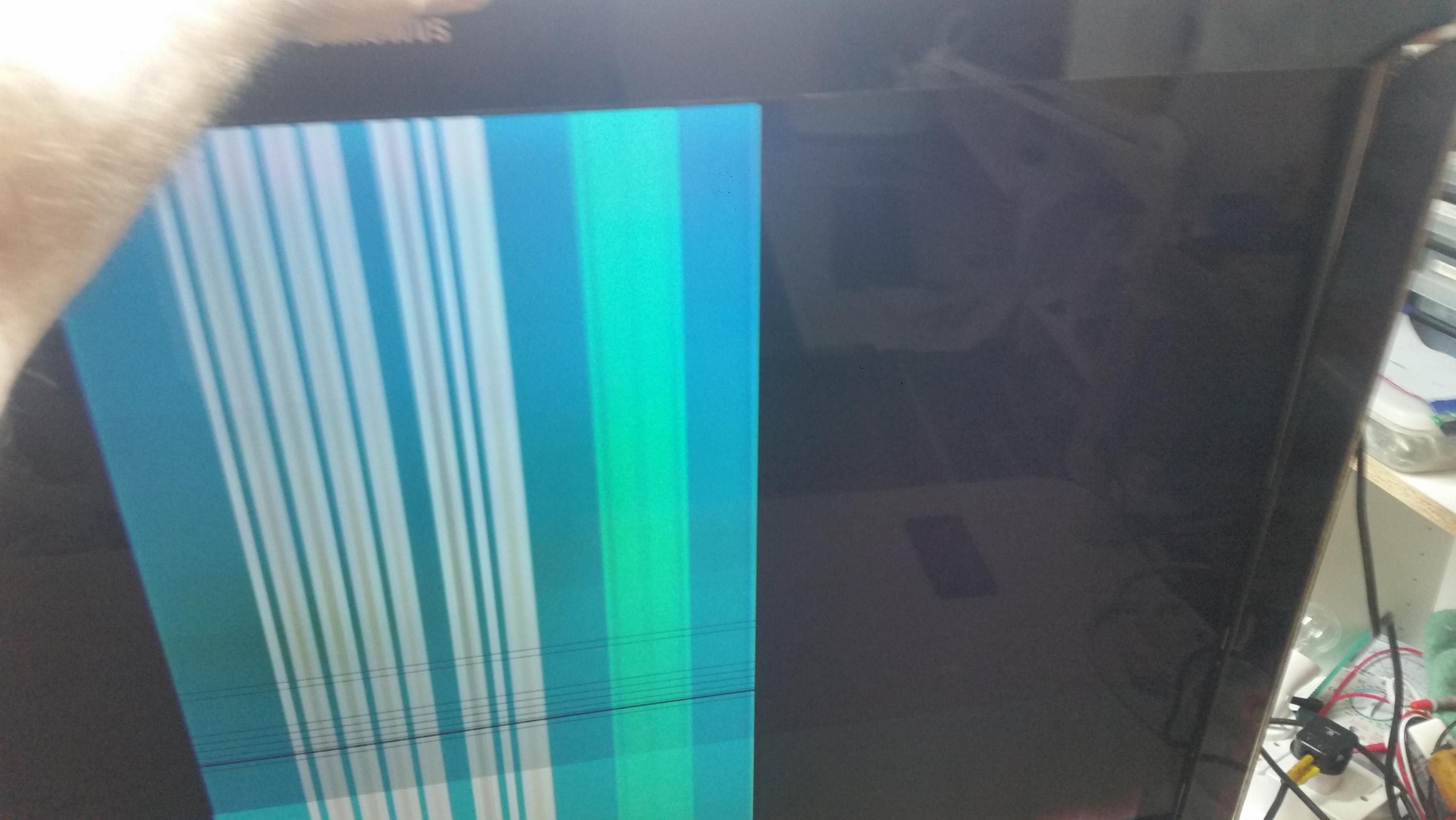

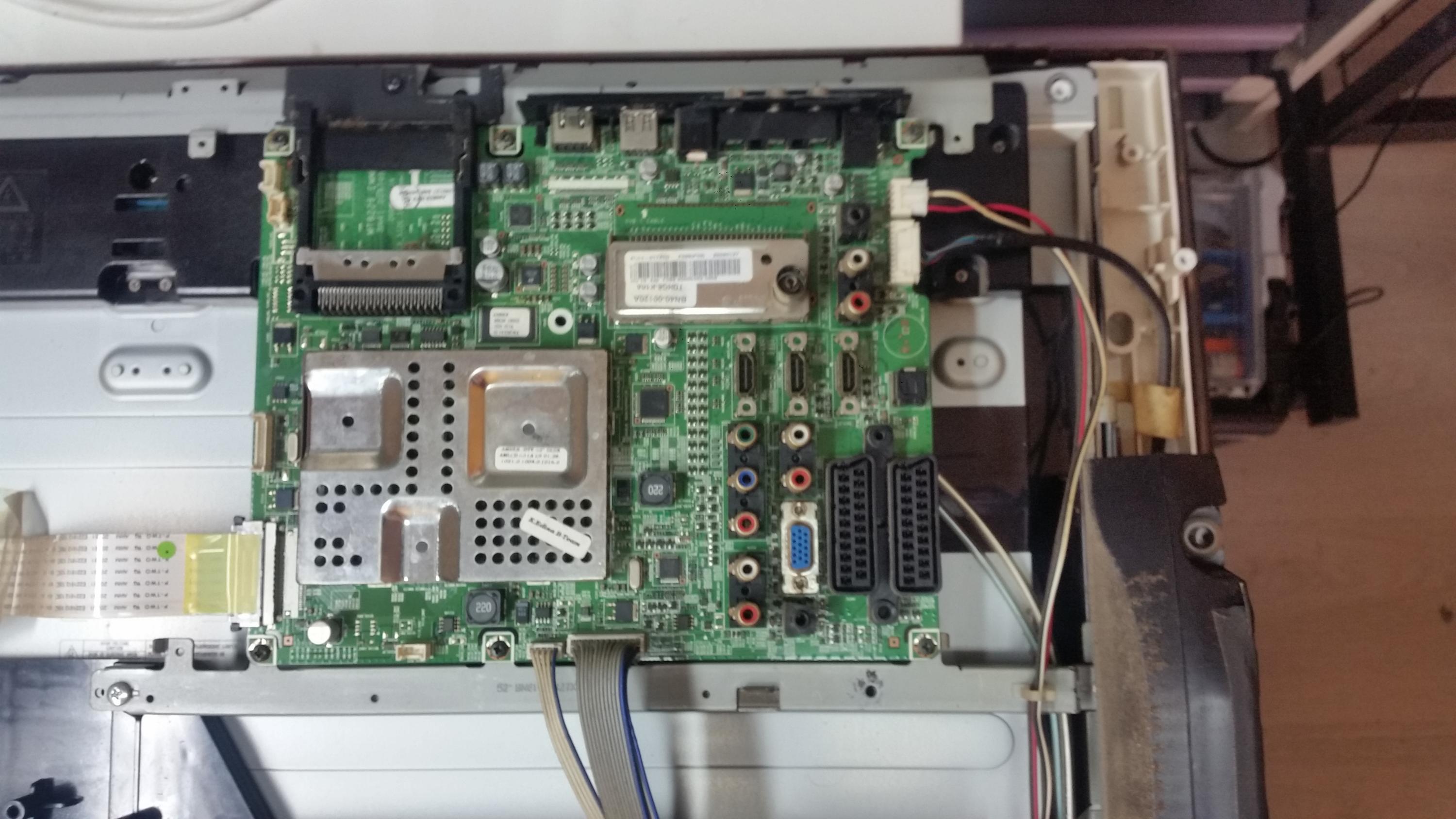

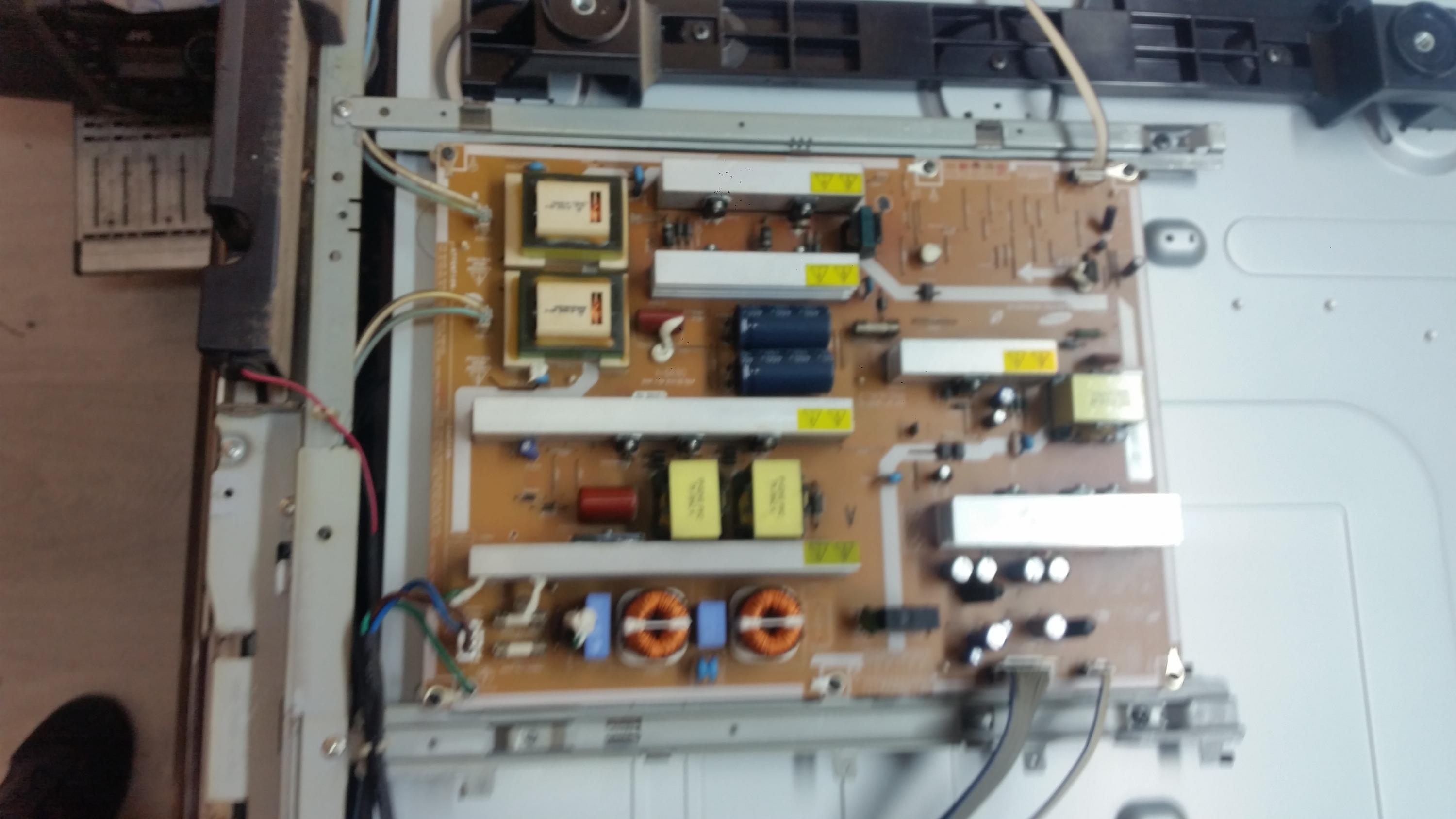

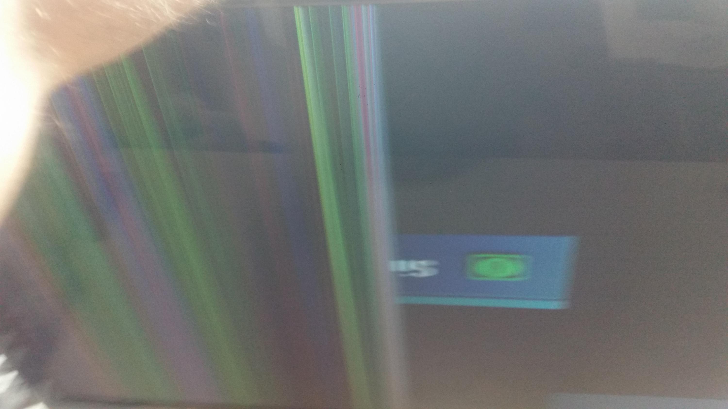

    Hi guy I got this samsung LE52A656 on the bench.
    The fault is vertical and or horizontal blocks/lines on screen
    Apparently it is intermittent and the TV sometimes works, haven't seen it myself but when I picked it up it did have a proper picture on screen with some lines/blocks in part of the screen. I have no reason to doubt the owner.

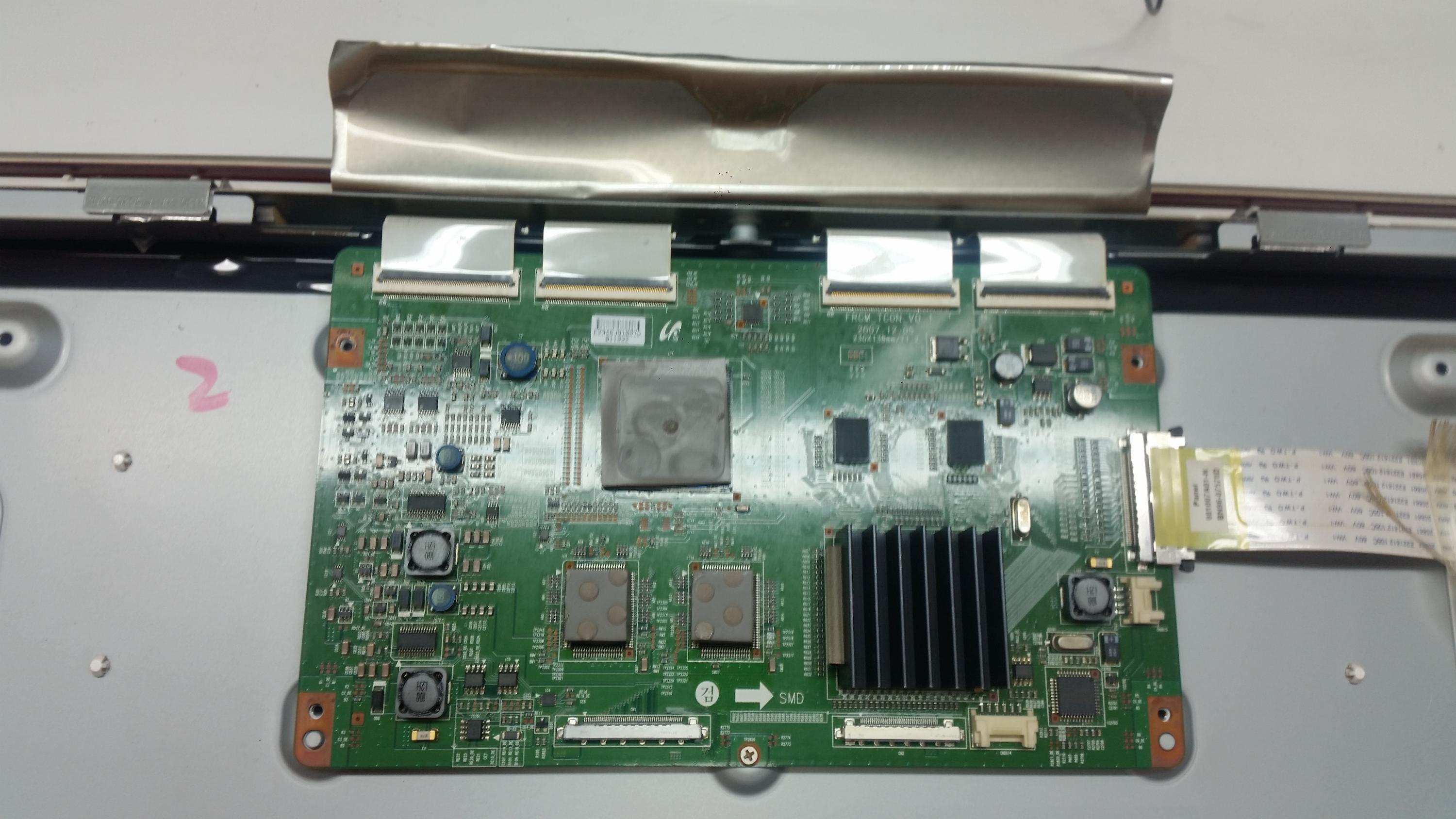

    There are 4 TCON cables I tried disconnecting them in turn but couldn't get a good picture. However disconnecting each TCON in turn does affect the screen.
    Here's some pics. Really I want to determine if this is a panel fault or not. Sorry the pics are not brilliant, I was on my own and couldn't hold the camera far enough from the screen as it is so large.

    Re: SAmsung LE52A656 - panel fault or not?
    Panel problem. If you flex the panel, does it make any difference?
      you might ask the owner who was the "window washer"... maybe... :-) probably not recoverable as it appears to be a major issue with the panel.
