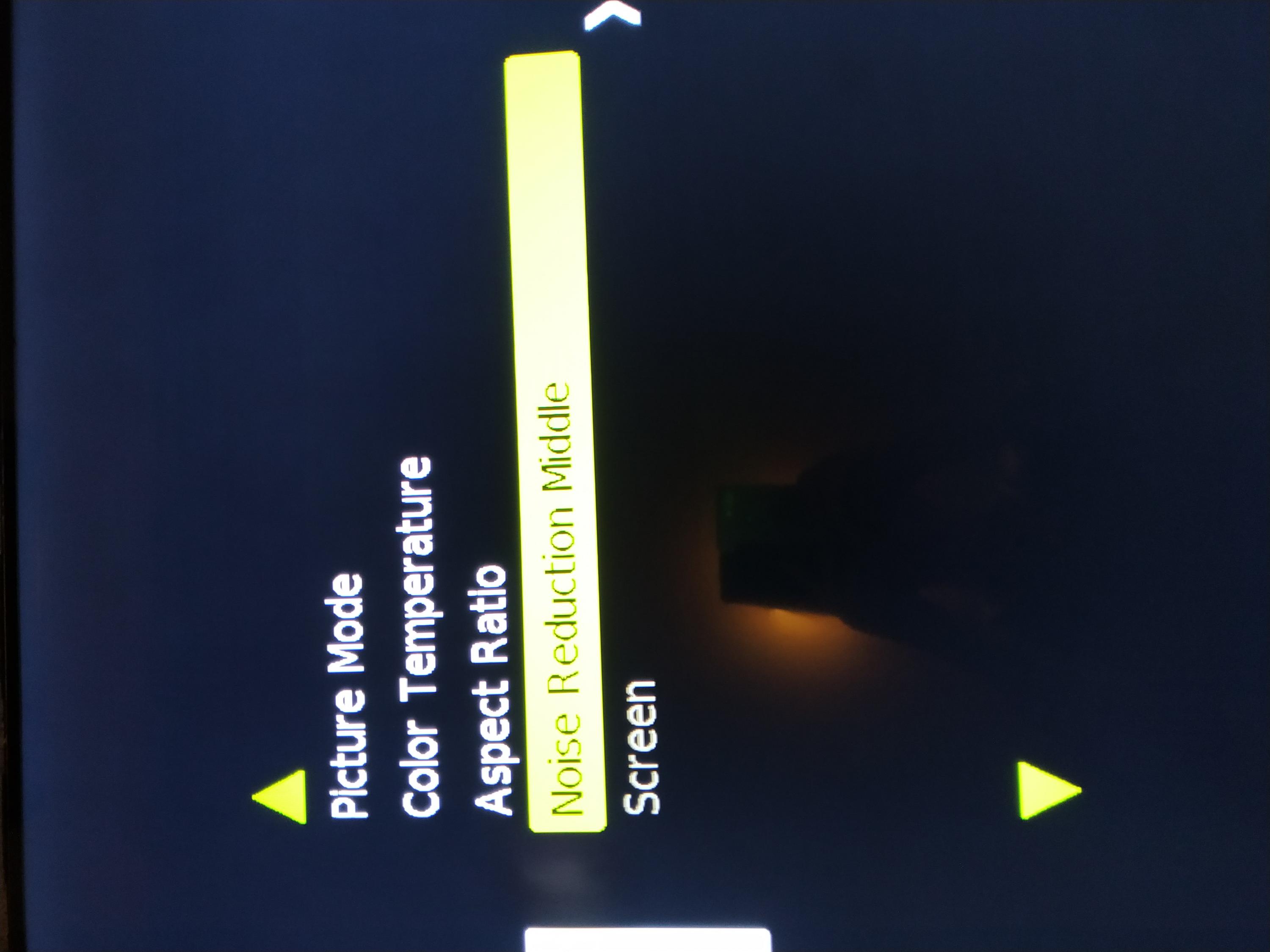

        There is no backlight level on this TV that I can see, normally I would turn it down anyway.
        There is a greyed out option called 'screen' that I cannot access, happen to know how I can?
        Parental lock is off & I have reset the TV as well.

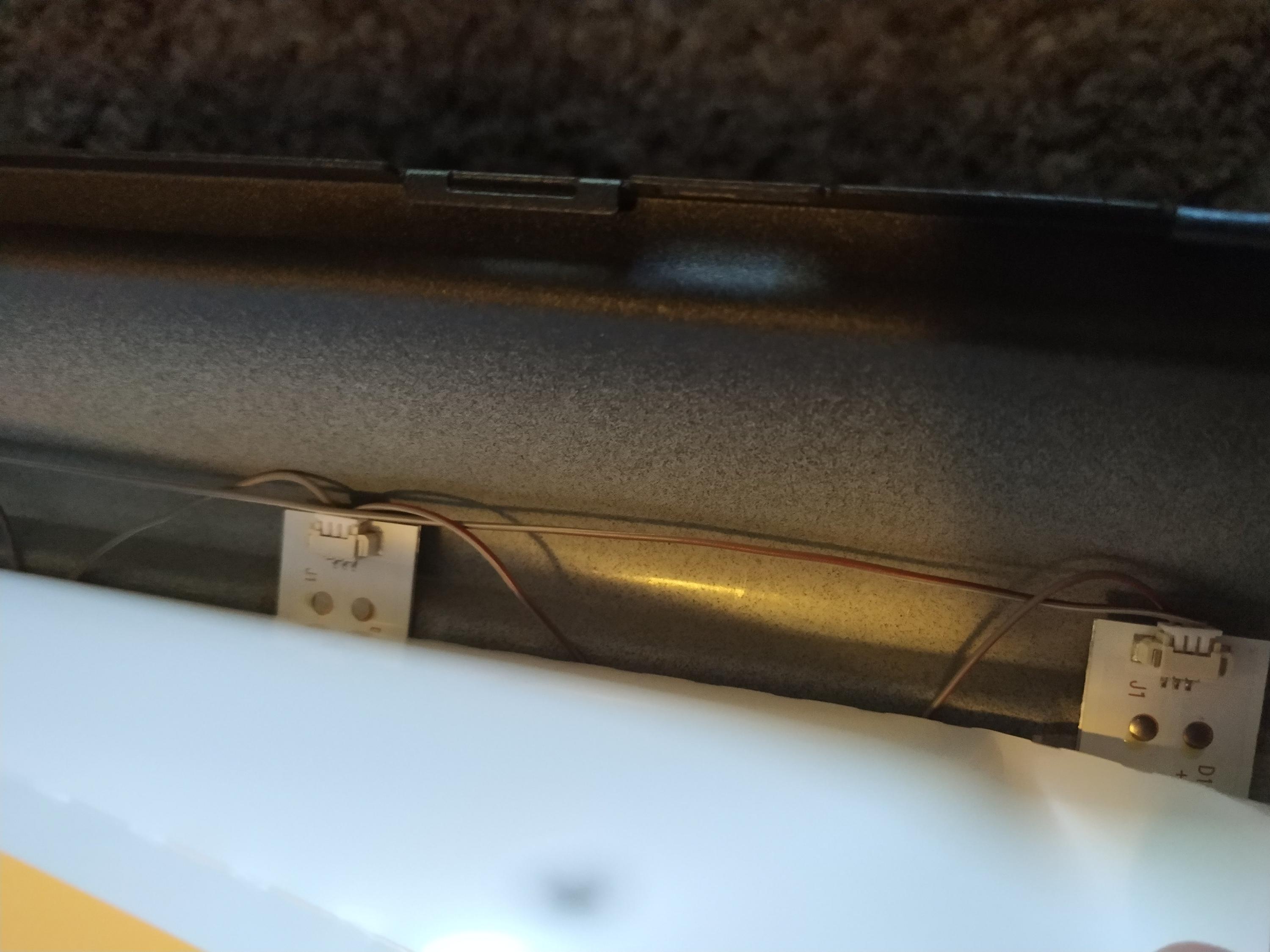

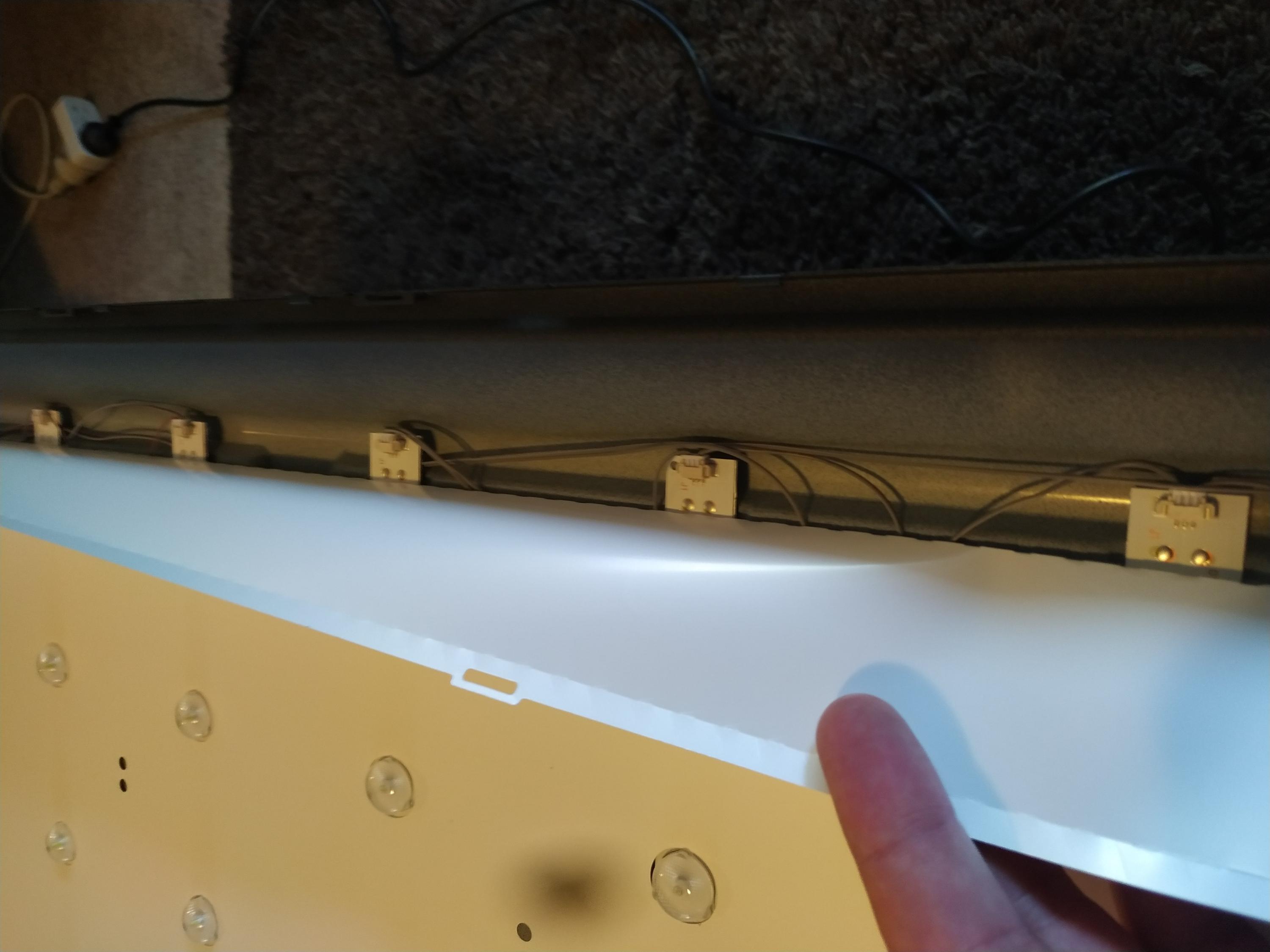

          Not sure what you mean by smd connectors, I have a attached a picture of the connectors which connect all the LED strips on each side of the TV.
          There are no middle connectors between the 2 strips in the middle of the chassis.
          Regarding the LED Tester, yes I agree & they do not fail when I use it.
          I have tested the entire array with panel removed using the power supply, it does the same thing after around 10 minutes.
            Re: Dick Smith GE6992 Flashing Backlight every 10 secs
            Those connectors on the LED strip are Surface Mounted, not through hole pins, they are very flimsy.
            Typical TV OSD will have Backlights level setting on the same page where you adjust the Video Brightness and Contrast.

              There is no Backlight option in any of the menus, only the greyed out 'video' which is unselectable.
              It is a budget TV, from memory I had another Dick Smith that had no backlight option as well.
              Do you suggest taking off the surface mount connections & hard soldering them?
