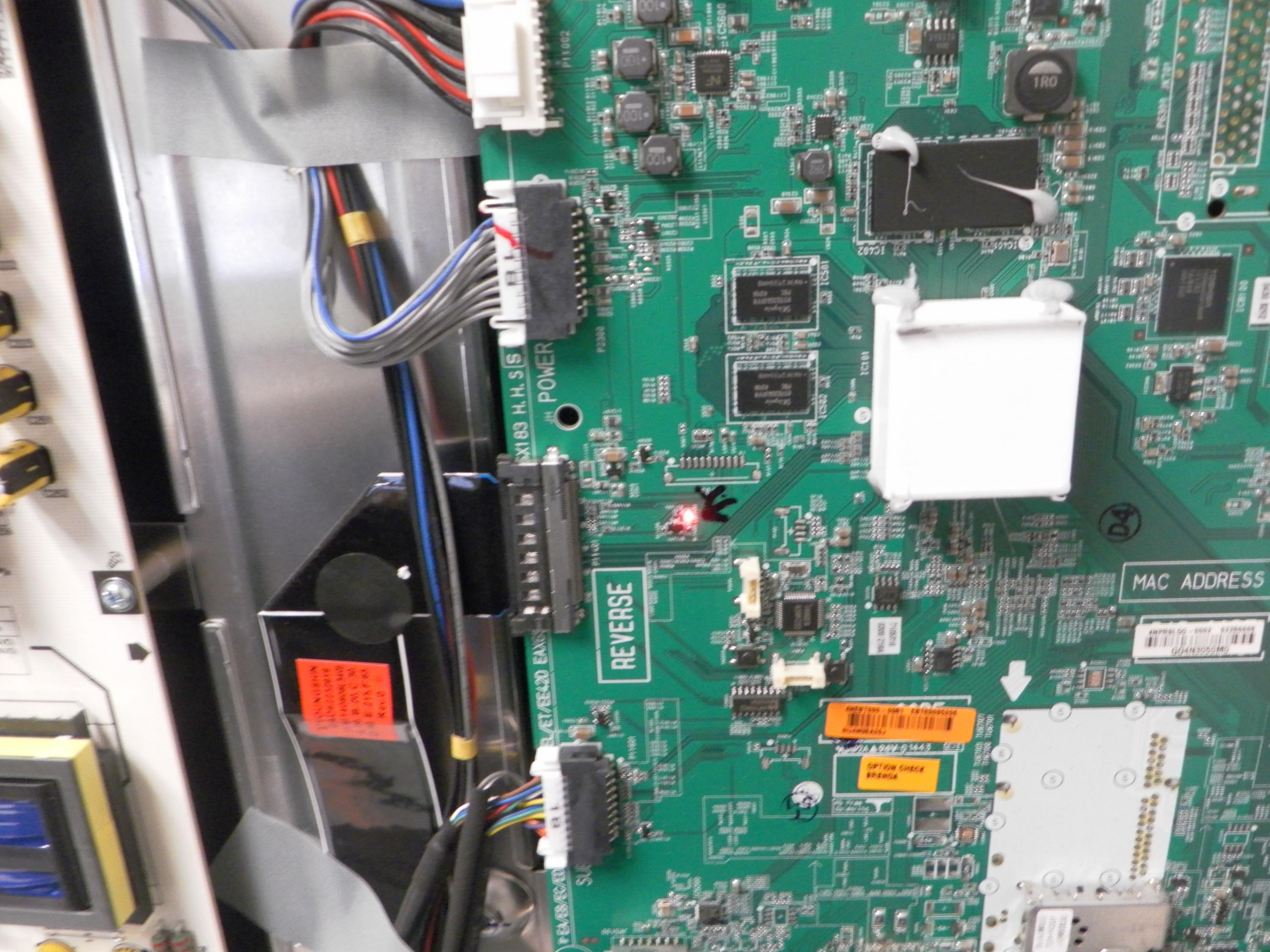

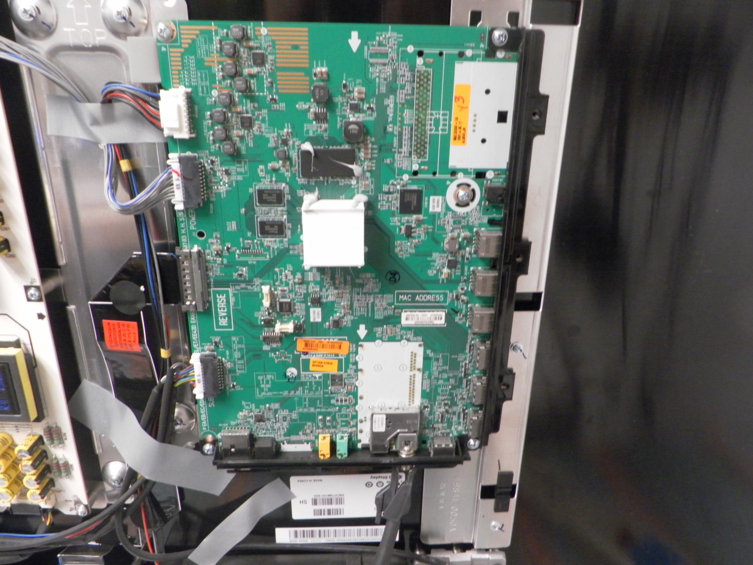

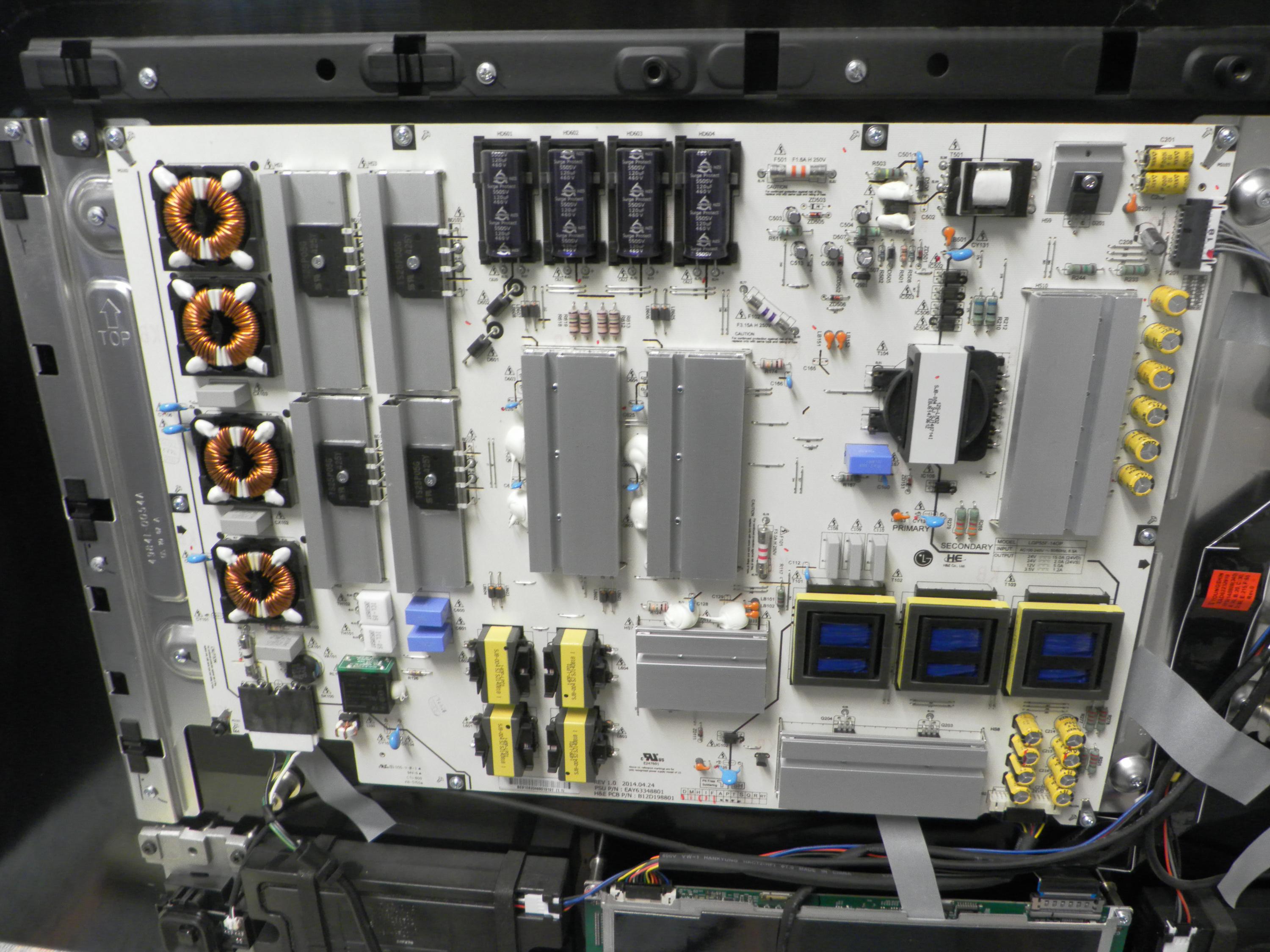

LG 55EC9300-UA turns on clicks and turns off
  • nwcs
    • Dec 2015
    • 311
    • usa
    Once again I need to ask the groups help. This TV will turn on for about two seconds with no picture and LD11401 lights up then the tv clicks and shuts off. The voltages at P201 to the main board are as follows starting with pin 1. All voltages drop to zero after briefly coming on.
    Pwr on is 2v
    3.5v is 0
    3.5v is 0
    G
    24v is 22v
    G
    12v is 10v
    12v is 10v
    G
    Drv-on is 0
    DPC is 0
    3.5v is 0
    G
    24v is 23v
    G
    12v is 12v
    24v is 23v
    G
    Any help would be appreciated as always.
