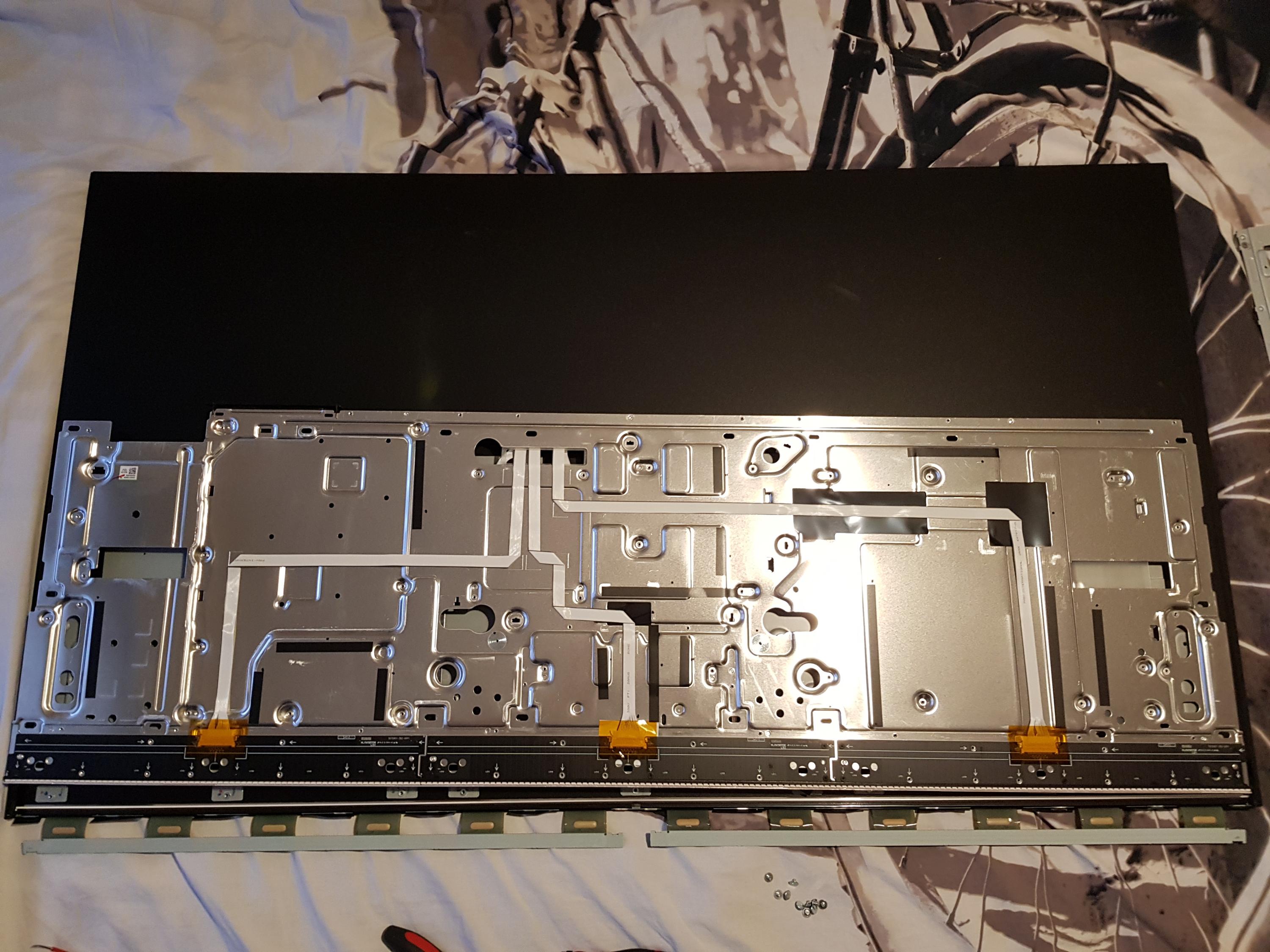

    Hi to all i have that tv sony Sony KD-55X9005C with backlight problem have anyone repair manual or can you tell me if i have to open the lcd ? Thanks and best regards

        Re: Sony KD-55X9005C repair manual
        Originally posted by Alschepmist
        Thanks for the reply but i know that led are defective because i see no backlight on 3 cm display is black
        you have Edge LED BL. not easy for you to repair if you are not familiar with electronic and soldering.. suggest you living with it as its
          I have already repaired backlight before but not on sidelight and i want to know if in this model i have to open the display or not.
              yes you need to take the LCD out and all plate until you reach the bottom and then you need to screw out the Aluminum base plate where the LED string mounted on it. no need any service manual for this
                    So i have opened the backlight i had not to open entyre lcd panel only the back i have test the led and they works perfekt could be the led driver board?

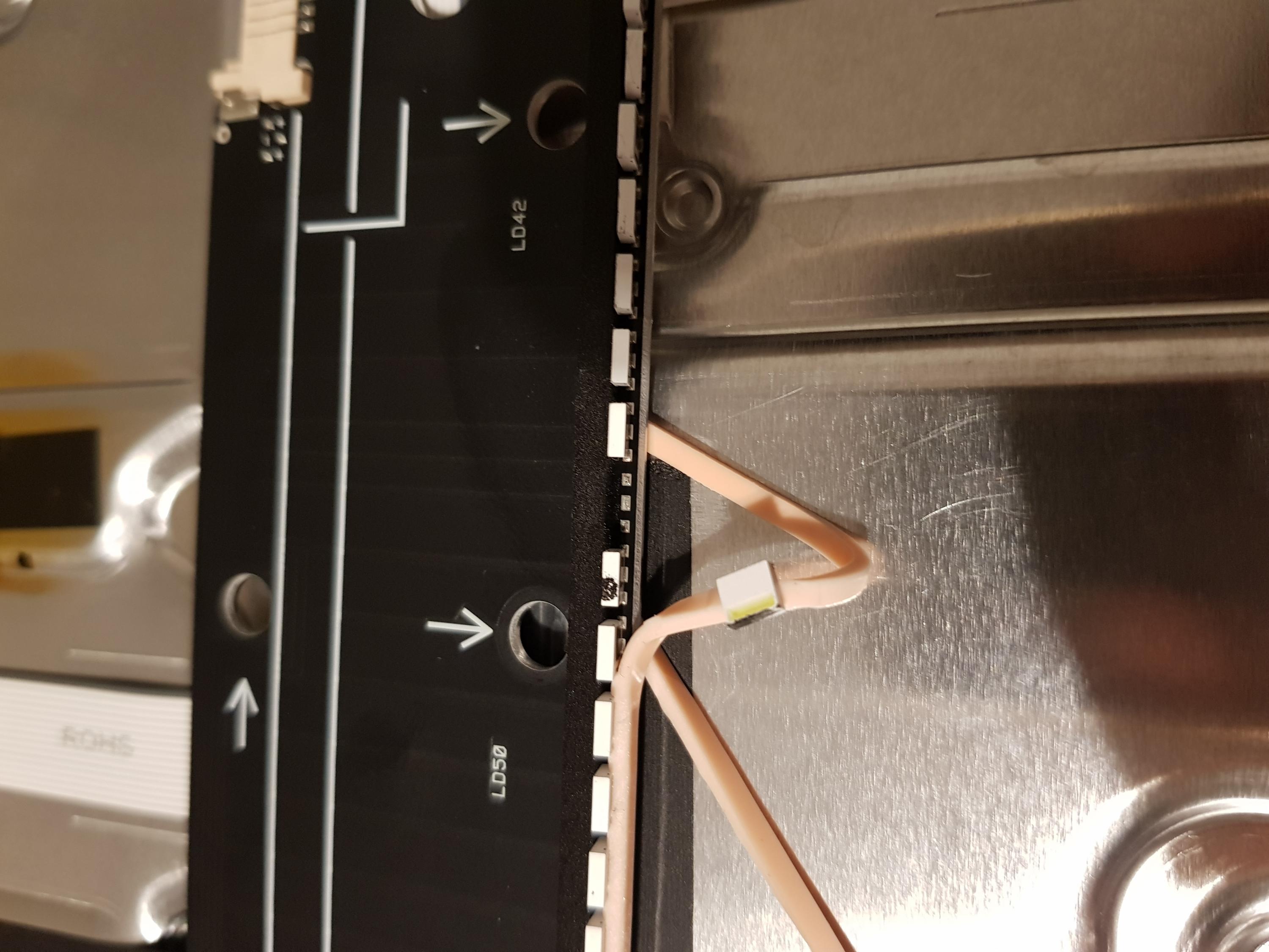

                      I think i have the problem found one led is not soldered how that could be possible ? I just gonna try tho solder that
                        Here is a picture
                          Are you certain it has not burnt and overheated and fallen off. The black spot on one of the leds next to the empty space looks a little suspect.

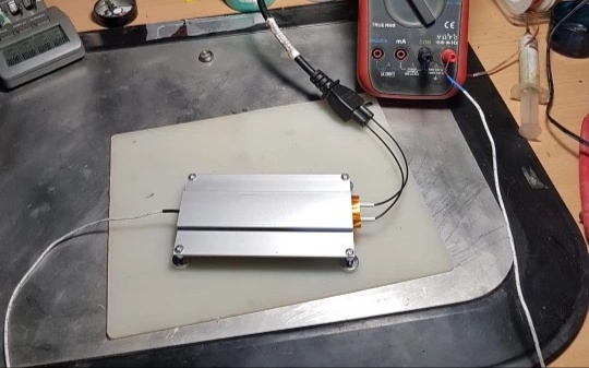

                            The black spot is from me to mark the leds and i have all the leds tested they works all i have yet only to tray to solder the led it can be a little complicate
                              You will not be able to use a standard soldering iron, you will need a hot air station or heating plate.
