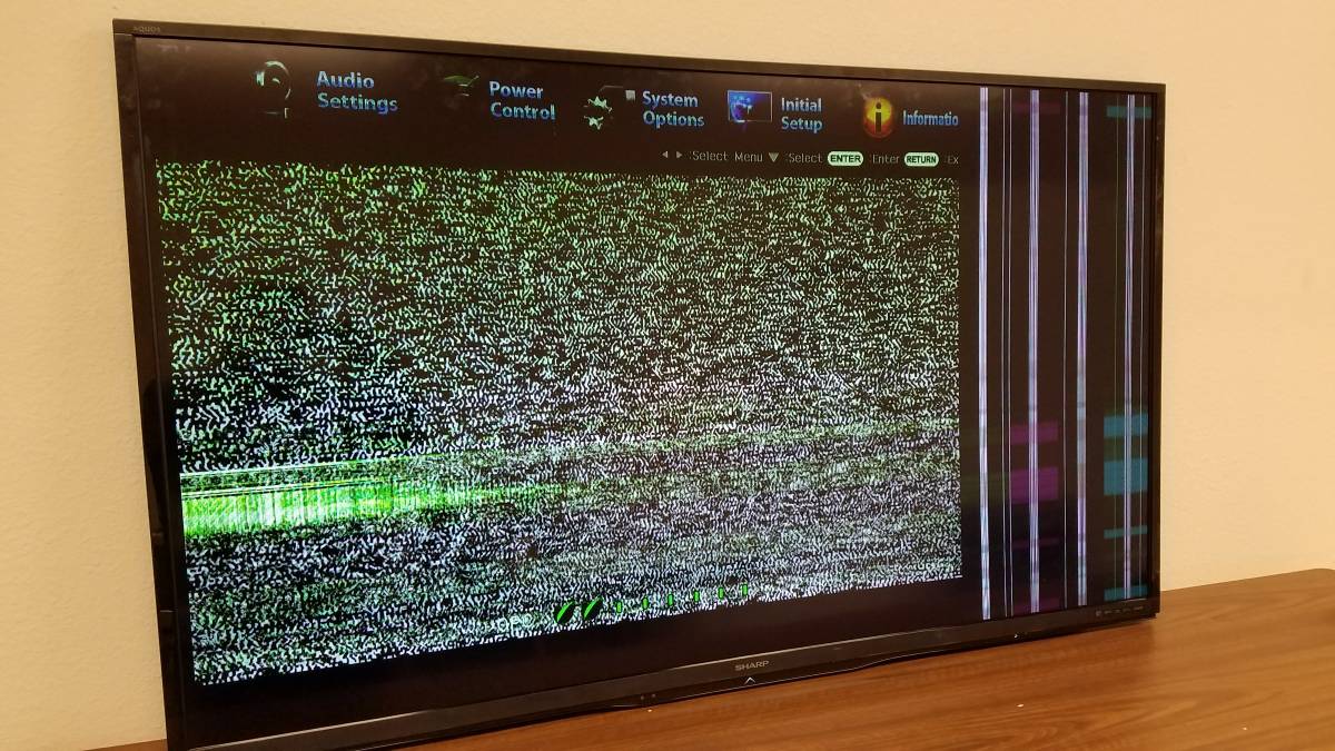

        I found another post on this site the other day which has been very helpful in troubleshooting this issue I am having with my tv. The left half of the screen is dark, and the other half is VERY slow to generate it's image - and it only generates part of its image at that.
        Based on this yt video, I have narrowed it down to an issue (short?) on the left side of the display, somewhere in the system of ribbon cables.
        when I remove the bezel and the rear cover, I can get the image to display correctly by manipulating the ribbon cables on the left side which connects the left lower display...
