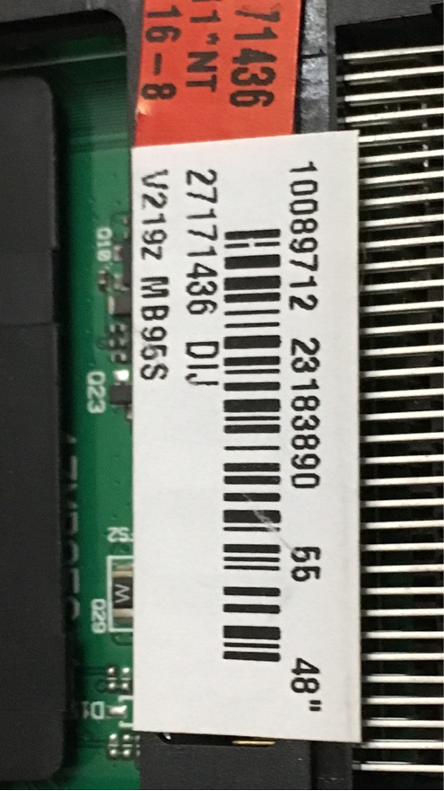

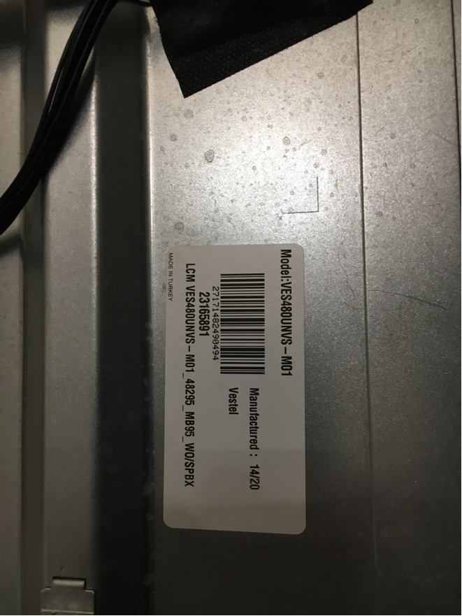

            Re: Toshiba 48L1435 Firmware Needed
            mainboard 17MB95? what lcd panel is used?
            • zomi
              • Nov 2011
              • 509
              Yes mb95
              screen ves480unvs- m01
              have attached pics too
