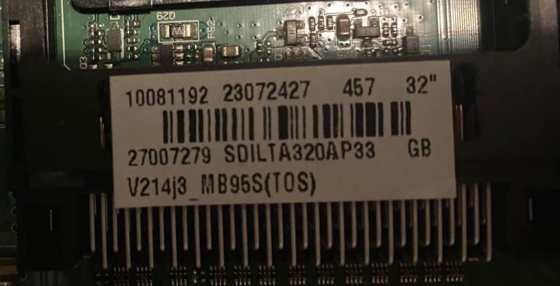

    Afternoon all I'm wondering if someone has, or could point be in the direction of the correct firmware for the above TV please?
    Mainboard:
    10081192 230724227 457 32"
    27007279 SDILTA320AP33 GB
    V214j3_MB95S(T0S)
    TV turn on/off, green LED flashes tv turn on then off. No rhyme or reason done some research after changed the backlights that its most probably the firmware on the mainboard.
    Any help would be appreciated. thanks

      Need to replace whole spi and dump onto new Ic, otherwise it will fail again. I don’t bother with mb95’s and more. Swap it for mb82

                  So am I right in saying the SPI chip is bad and the firmware is fine?
                  Ultimately I could remove SPI read and save - then write to new SPI chip?
                  Thanks RB123
                  • Diah
                    • Feb 2013
                    • 6435
                    Re: Toshiba 32D1333B &lt;Firmware needed&gt;
                    dont play with spi..... yours tv turn on and off and panel spec saved on it... just play other part of firmware with out mboot. you will be fine.. search over here i upload time ago firmware with out mboot.

                        Short update on thread, ordered the 32W model mains and everything worked fine, so I have removed SPI and sent it to be read and wrote to new IC. Will update thread when I have the part back and fitted.
                        Thanks for the help as always.
                        S.
                        • StephenU
                          • Dec 2013
                          • 230
                          • United Kingdom
                          UPDATE
                          Got the new SPI back flashed with the firmware from the old IC, but TV still has the same issues. I have put in the 32W1333D mains in for now as it works fine with this. Just need to use without DVD function.
