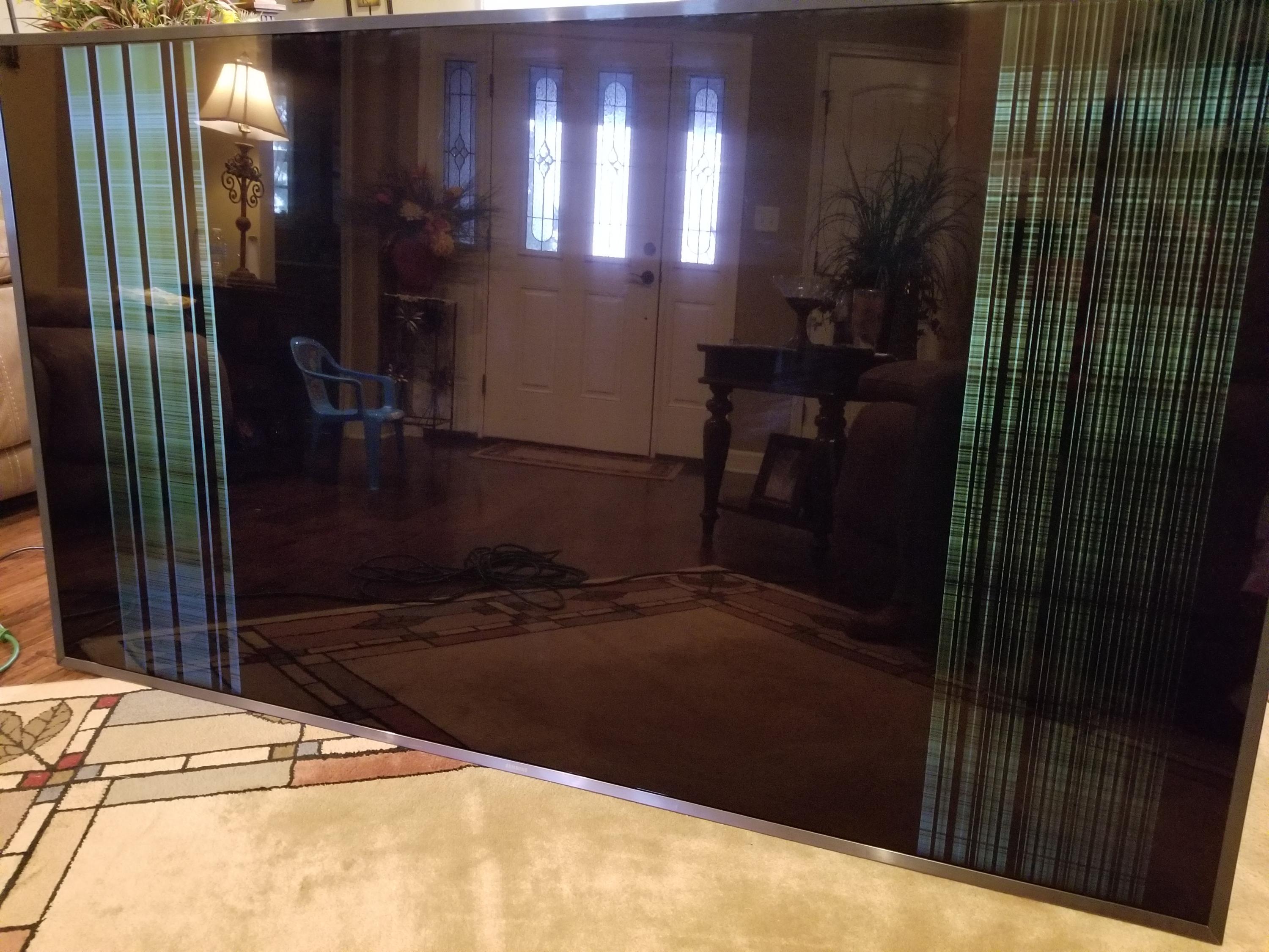

    After repairing this TV, from this thread,
    https://www.badcaps.net/forum/showthread.php?t=70191
    all looked good and worked for about a day after I put it on a wall mount.
    Now I get vertical lines on both sides of screen.
    Is this TV doomed?

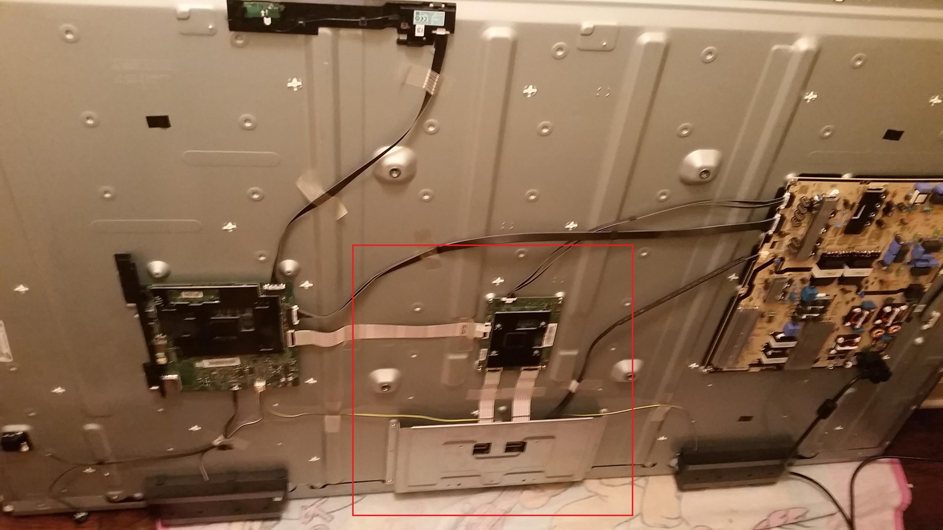

    I've swapped both boards, outlined in the red square.
    Same result after each swap.

      check the tab bonds.
      • cbearden
        • May 2015
        • 19
        Re: Samsung Vertical Lines
        Yes, this TV had an issue where half of it was very dark on some screens.
        So, I already cut off the tabs on the left side as a last-resort after trying many other fixes that didn't work. It looked and worked great for about 1 day. And then these vertical lines showed up.

          Or, were you talking about the tabs on the bottom of the screen?
          The tabs I cut off were on the left side.
