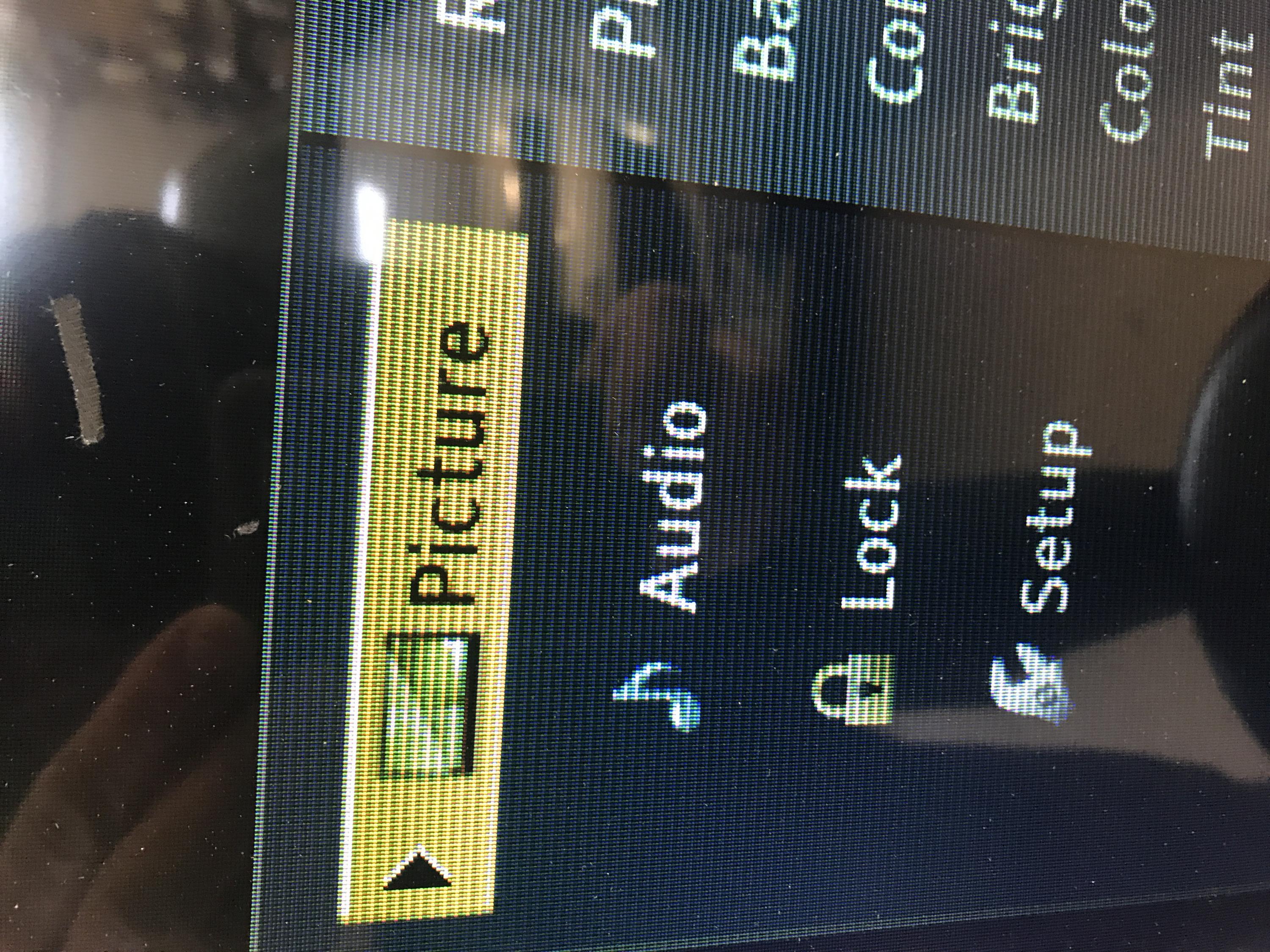

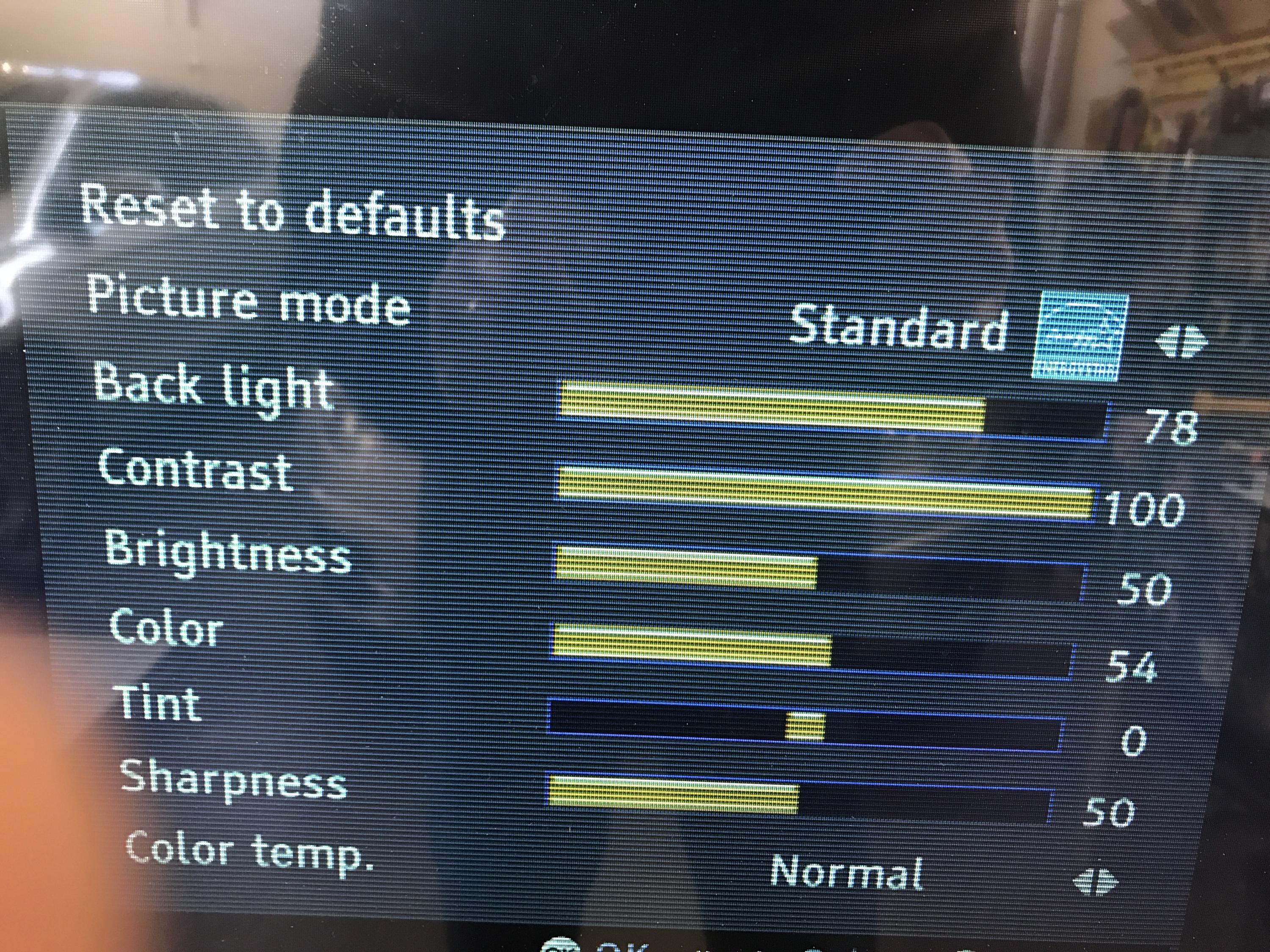

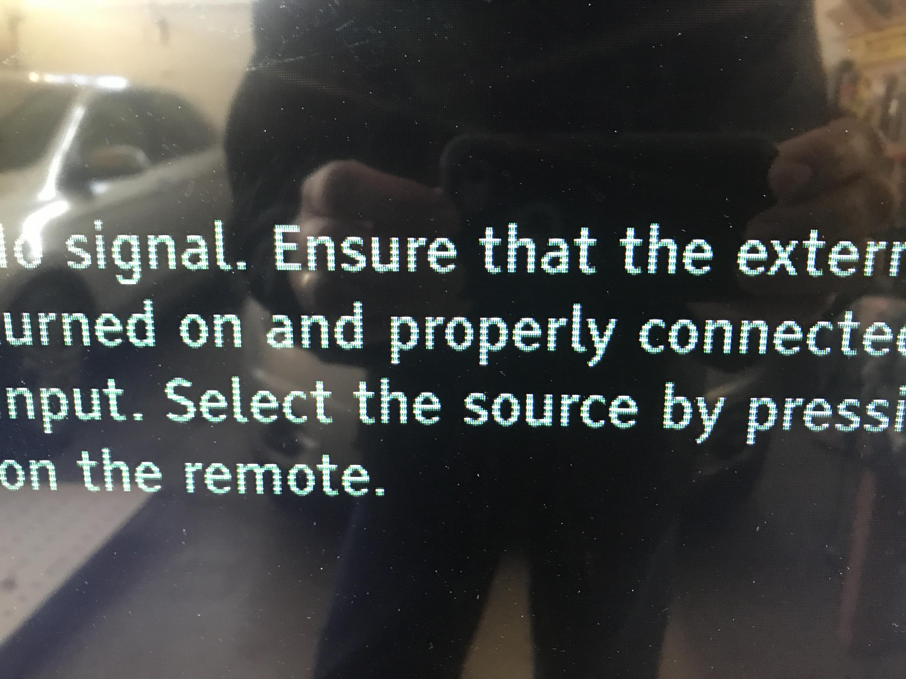

    Panasonic TC-L32B6 bad picture
    Hey guys
    I have a Panasonic TC-L32B6. Everything works on the TV, it just has bad picture. It looks as if there is a lot of vertical lines on the screen, although you can not see them. Text looks "striped" and it just has overall bad picture.
    Can you please help
    Thank you
    Henry

                    Hi Andrew, I tried cleaning the FFC's as per ypur instructions, but with no luck. The TV works perfect it's just as if its 480 or even worse. Even the Menu are striped. I also replaced the T-Con. Can it be the Mainboard, I'm just thinking maybe it doesn't switch to 1080 or 720. Just thinking out loud.

                      Re: Panasonic TC-L32B6 bad picture
                      If it is the Mobo you would get missing VERTICAL lines, it most likely is a bad Panel. Sorry.
                          Hi Andrew, speaking of lost vertical lines, isn't that what I'm seeing.
                          Please look at pictures again, or isn't that what you mean by Lost vertical Lines
                            Vertical lines run from top to bottom ||, horizontal lines run from side to side _ _. A lot of times horizontal lines mean panel problem.
                              That looks to me like lost horizontal lines from the photos
