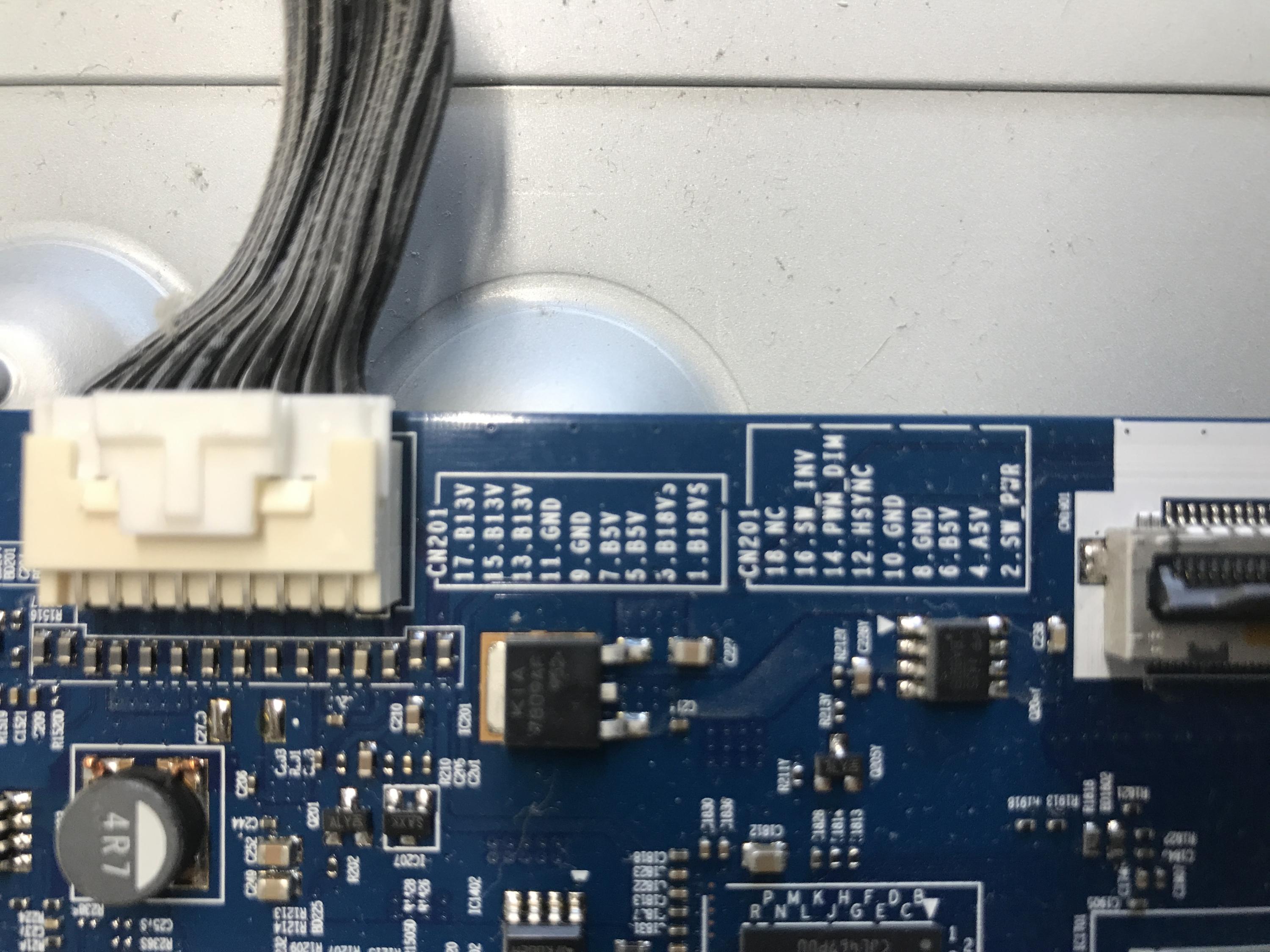

    We need the Voltage readings of all the pin of CN802, you need to put down the pin name and follow by the Voltage readings for each pin except the GND pin.
    "Voltages going to Main board same voltages as per diagram" So the control Voltage are all correct?

          You are missing an entire row of signals and the pin name (should be a legend silkscreened). Thats why you should include pics of the board. You should get a PS_ON and BL_ON signal from the main board when you push the power buttton. If these signals are missing and the main board has power, the main board is likely fau!ty.
            Re: Samsung LN46C630K1F
            Also no pin names provided as requested: "you need to put down the pin name and follow by the Voltage readings for each pin except the GND pin."
            BTW, the exposed pins you see on the top side of the boards are the ODD number pin, the EEVEN number pin you will have to probe from the bottom side of the board or from the back side of the connector.

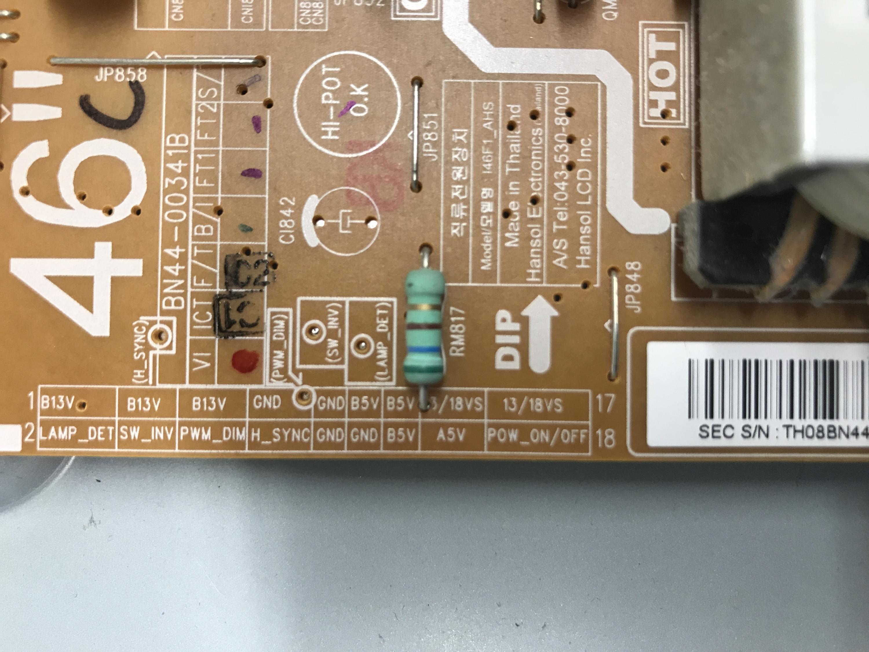

              I'm sorry about the missing information. I'm a beginner, and really appreciate your help.
              Pin 1=13.12V / Pin 2=0.0V
              Pin 3=13.12V / Pin 4=0.0V
              Pin 5=13.12V / Pin 6=3.33V
              Pin 7 to Pin 10 = 0.0V
              Pin 11= 5.1V
              Pin 12 = 0.0V
              Pin 13 and Pin 14 = 5.141V
              Pin 15 = 13.12V
              Pin 16 = 5.141V
              Pin 17 = 5.141V
              Pin 18 = 13.12V
              Thank you
                I'm thinking that pin 17 should read the same as pin 15. You may have pins 17 and 18 mixed up?
                • henryvrensburg
                  • Oct 2018
                  • 104
                  You are right. Pin 17 is 13.13 V. Pin 18 is 13V as well.

                          The TV's Standby Light is on, when switched on it flashes for some time and then stays dead. If you press a button on the Remote, it flashes again. On the new Mainboard voltages for CN802 are as follows:
                          Pin 1 = 13.1V
                          Pin 3 = 13.1
                          Pin 5 = 13.1
                          Pin 7 = 0
                          Pin 9 = 0
                          Pin 11 = 5.06
                          Pin 13 = 5.06
                          Pin 15 = 13.1. (on Silk Screen diagram 13/18V - I Think)
                          Pin 17 = 13.1 (on Silk Screen diagram 13/18V - I Think)
                          Pin 2 = 5.06
                          Pin 4 = 5.06
                          Pin 6 = 5.06
                          Pin 8,10,12,14,16,18 = 0V
                          Same as before, if I remove the Cable from the Mainboard to the Power Supply and plug it in, the backlights come on and stays on.
