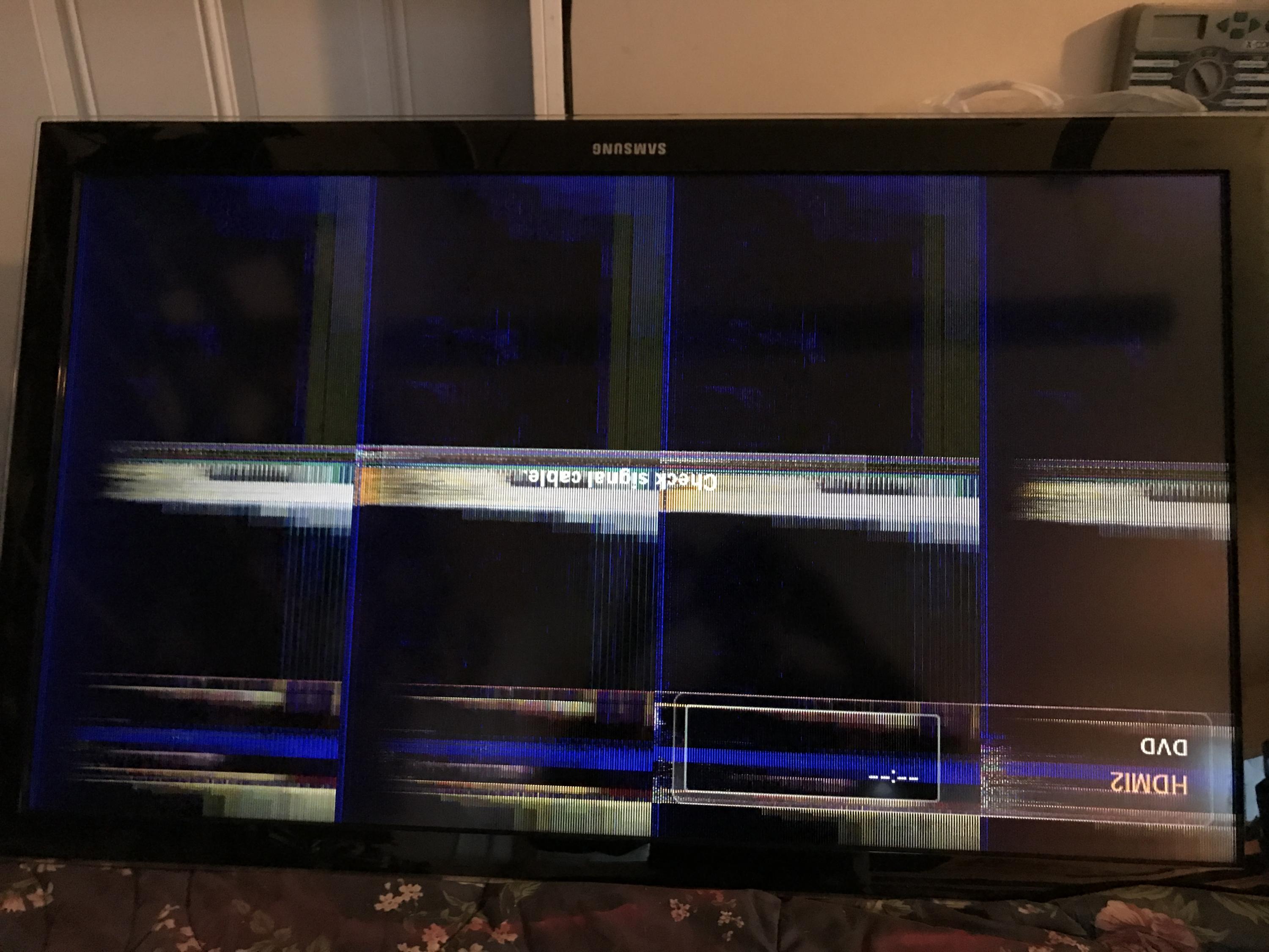

            Hi guys
            I got a new Mainboard. It differs in the following
            Original BN94-02701G
            New one BN94-02701J
            According to SJ and some other sites the two boards are compatible.
            It now does switch on, but it's got very bad picture. This is a TV that worked fine before this. I must say, when I took out the LVDS Cable between the T-CON and the Mainboard, a piece of the cable broke off and was left in the T-CON. I however could remove it afterwards. I ordered a new LVDS cable so that shouldn't be a problem.
            AM I looking at a new T-CON. I did clean the FFC cables with IPA

              Hard to tell, the new lvds cable might fix it.

                This is with the new LVDS cable.
                  Re: Samsung LN46C630K1F
                  From the picture it looks like a panel or tcon issue.

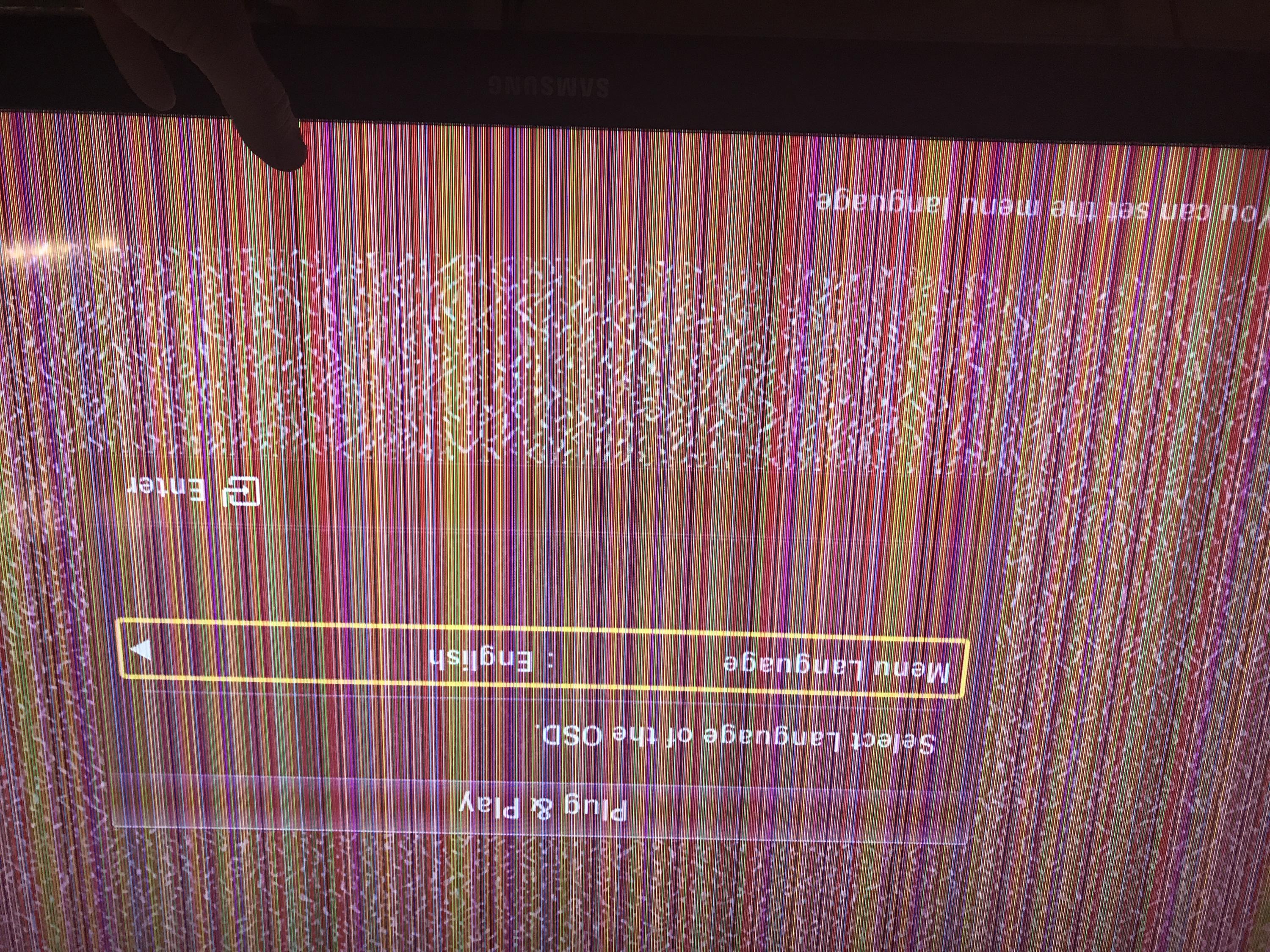

                          Hi guys
                          So I put in a new T-CON, new LVDS cable, and the picture looks like the attached photo. At this stage I'm thinking this TV doesn't want to work again.
                          Do you think it can be the different Mainboard? I also followed TeeEeeKay's advise and checked the settings in the Service Menu, (the settings were correct)
                          The last picture looks like T-CON, but it looks the same with the old T-CON
                          Any more ideas. Thanks everyone

                            Did you try a factory reset with this new setup? if that doesn't help try a firmware update/reapply if possible.
                              #34
                              I tried a factory reset with the same result. I also updated the firmware to the newest firmware available. Still same.

                                  Maybe check those little capacitors on tcon for shorts, diode mode, probe on each side, tv unplugged.

                                    Hi guys
                                    Just to give some feedback. I ordered a LDV cable from another reputable TV Parts supplier. The cable arrived, I installed it and it is now working perfectly. It seems as if there is a lot of defective parts on the NET.
                                    Thank you for every one reading this, and for the advise and help. Much appreciated

                                      So do you think one of the wires in the first replacement lvds cable is broken?

                                        I think so, yes. I put the old/new cable back after I got it working and it did the same. SO it must be the cable.
