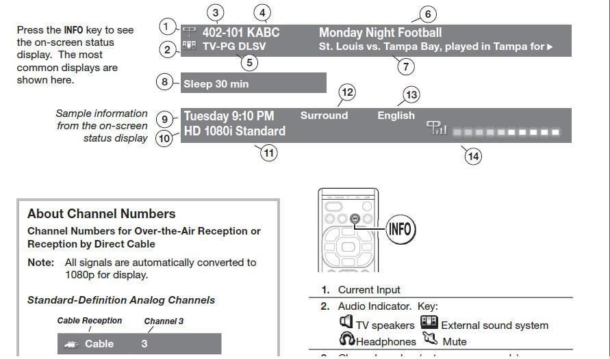

          It does seem to have a digital audio output and a digital audio input (going by the manual) and looking at the block diagram it would be the easiest way to narrow down the problem.
          If you press the info button what does the display indicate (location 2)
              I was thinking optical but yes that is the back panel and it is rca dig out...I don’t have anything for that I don’t think, but I did plug it into the Bose input and got nothing...of course I don’t have a converter
              2 shows surround sound
