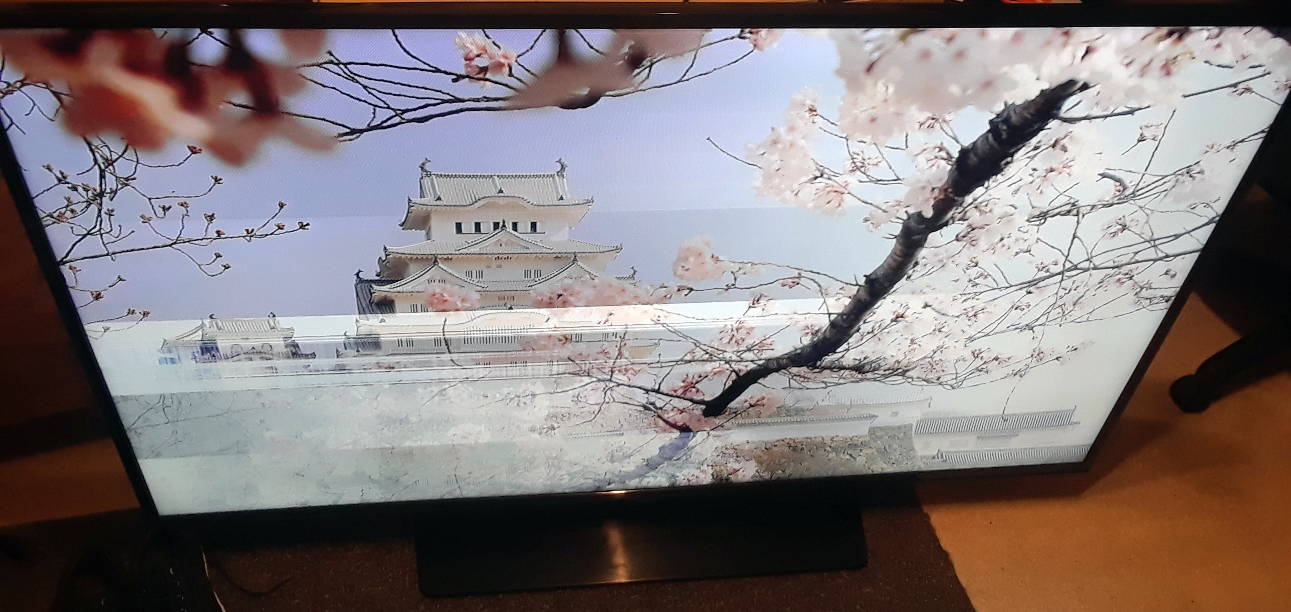

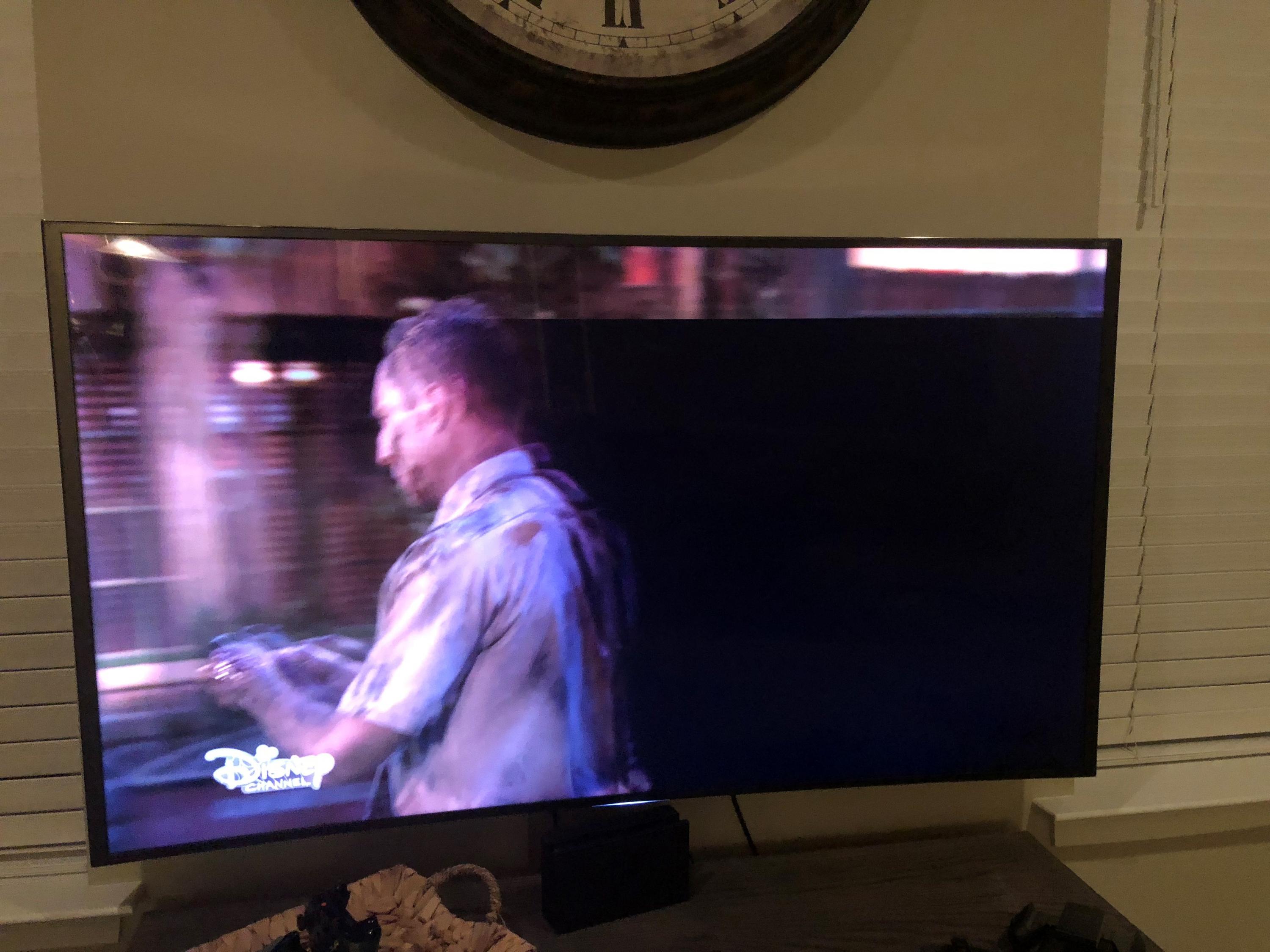

    I have a 2015 model Samsung UN55FS9000 55" Curved UHD-TV. I am the original owner. About two months ago it suddenly developed an issue where the right side of the screen went dark. I could still see the images behind the dark but they were ghosted and laggy. I power-cycled it a few times and the issue remained. I took it down and let it sit for a few days. I researched the symptoms and purchased a replacement T-Con board for it. I installed the new board but the issue remained immediately after I powered the TV back up. The next day, the TV worked fine, no issues at all. It worked fine for a few weeks until the issue came back, same problem statement. Only this time, it cleared after 20 mins. It worked fine for a few days but then the issue came back. I ordered and replaced the main board based on advice I got elsewhere but the issue was still there on power up. I took it back down, let it site for a week and it worked fine when I turned it back on. The next day, the issue was back. Any ideas? I will try to figure out how to post pics. Thanks for any help.
    edit: The black on the right side now goes to the top of the screen, not cut on a straight line like the pics show.
  • budwich
    • Jul 2015
    • 3097
    Re: Samsung UN55FS9000 Half-Screen Dark/Ghosting Issue
    it appears that you have the "standard" tab failure / panel issue.... :-(
    It might be salvageable depending on the design of the tabs at the side / bottom. Search the forum and read about these types of failures and how to "work around" is done... BUT don't go to fast... as the "workaround" is a "final outcome" that can't be reversed.

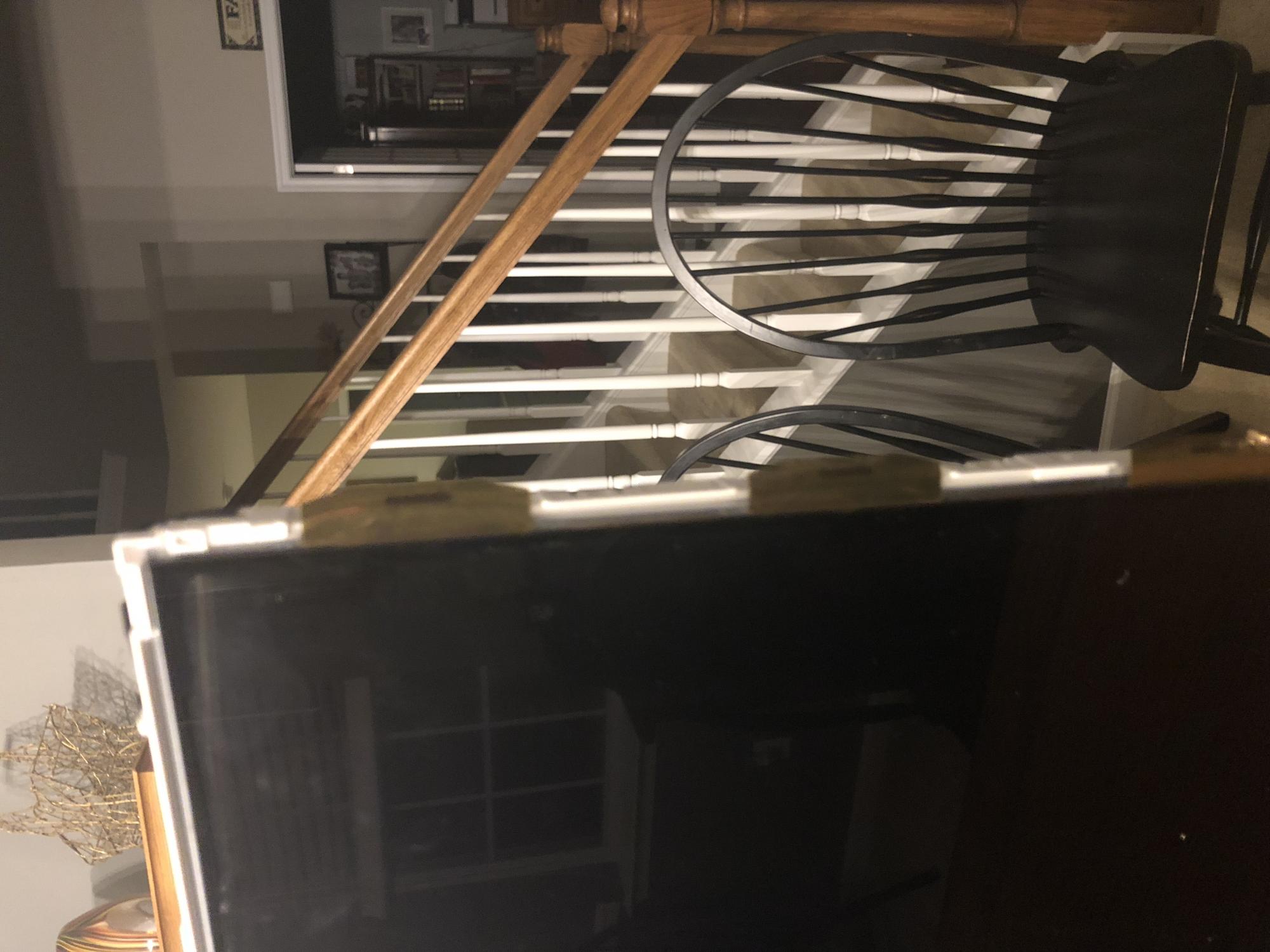

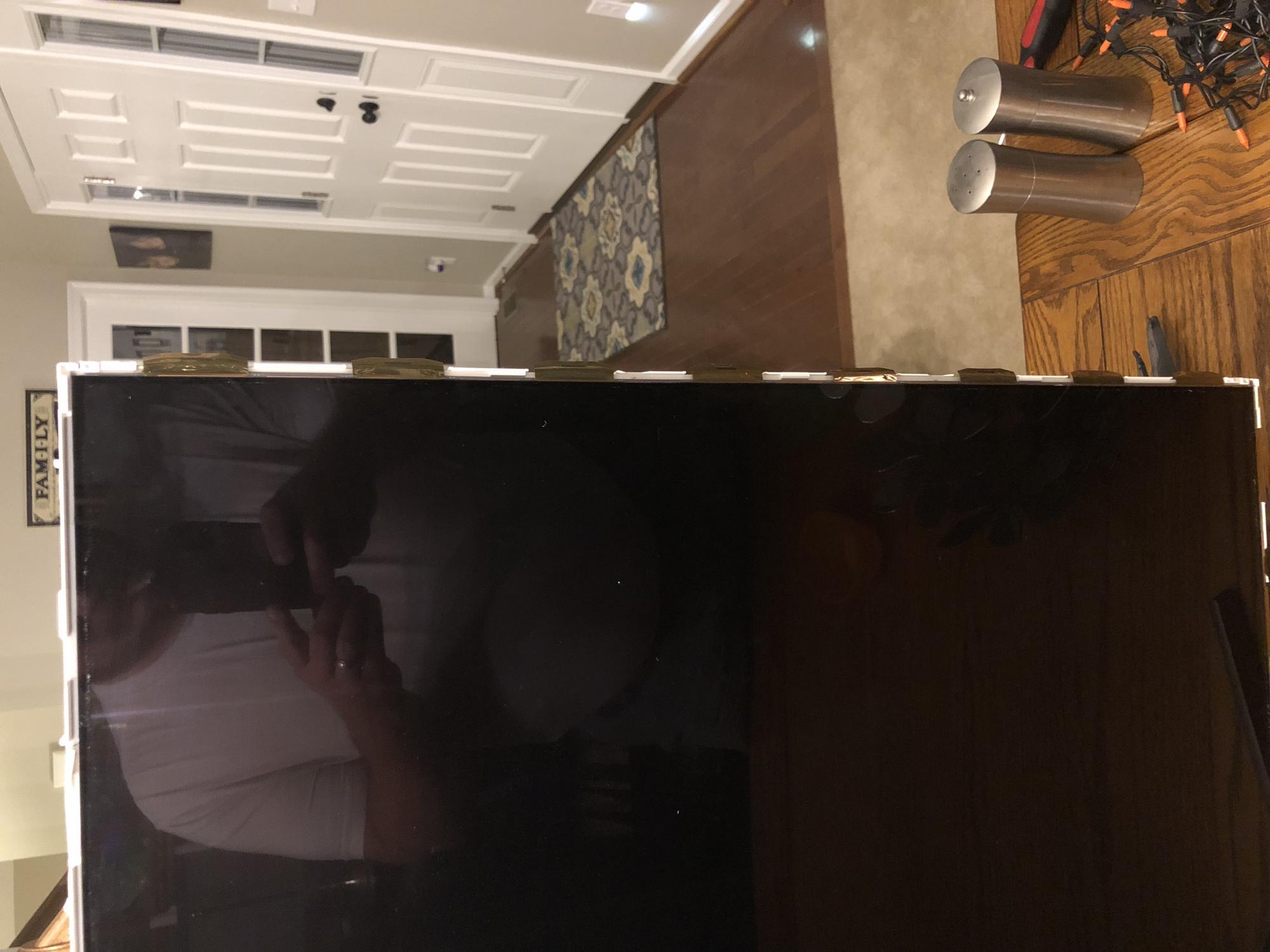

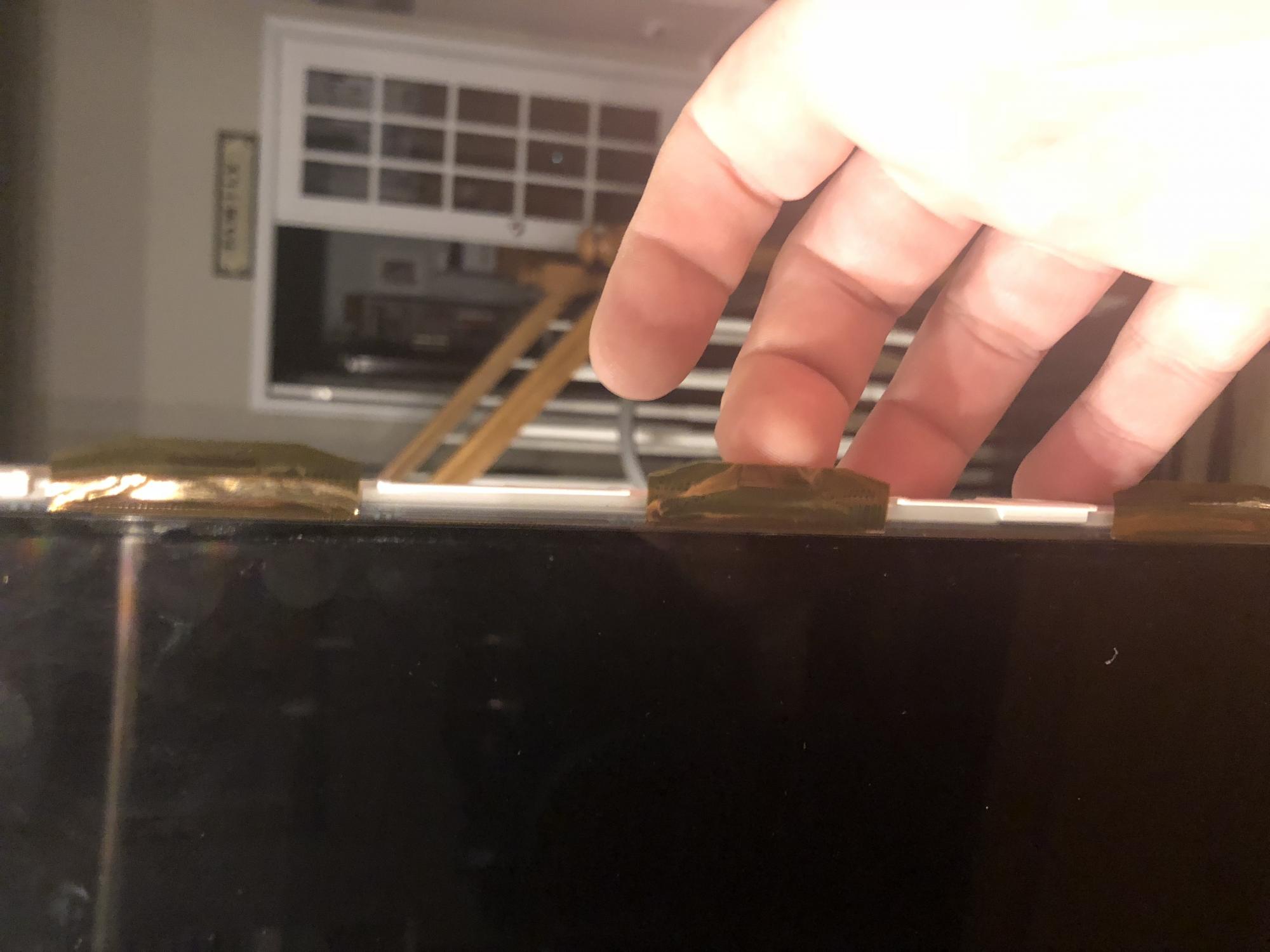

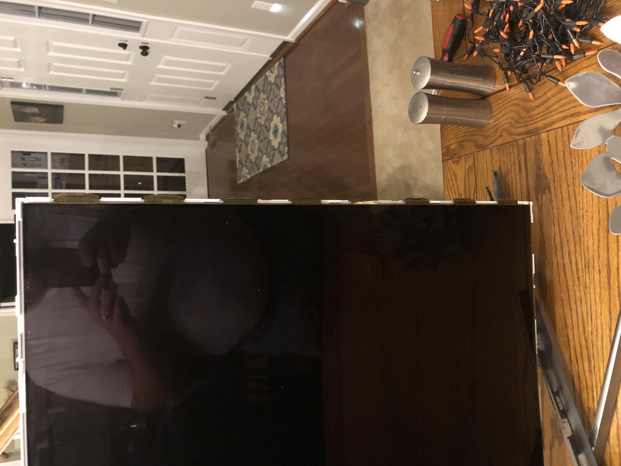

        Here are pics of the panel disassembled, showing the tabs. My understanding is if I cut these tabs off, all of them, the issue should be resolved? Is that correct?
          sorry but I can't make out the tabs. The ones in question are on the side NOT the bottom or top of the panel.

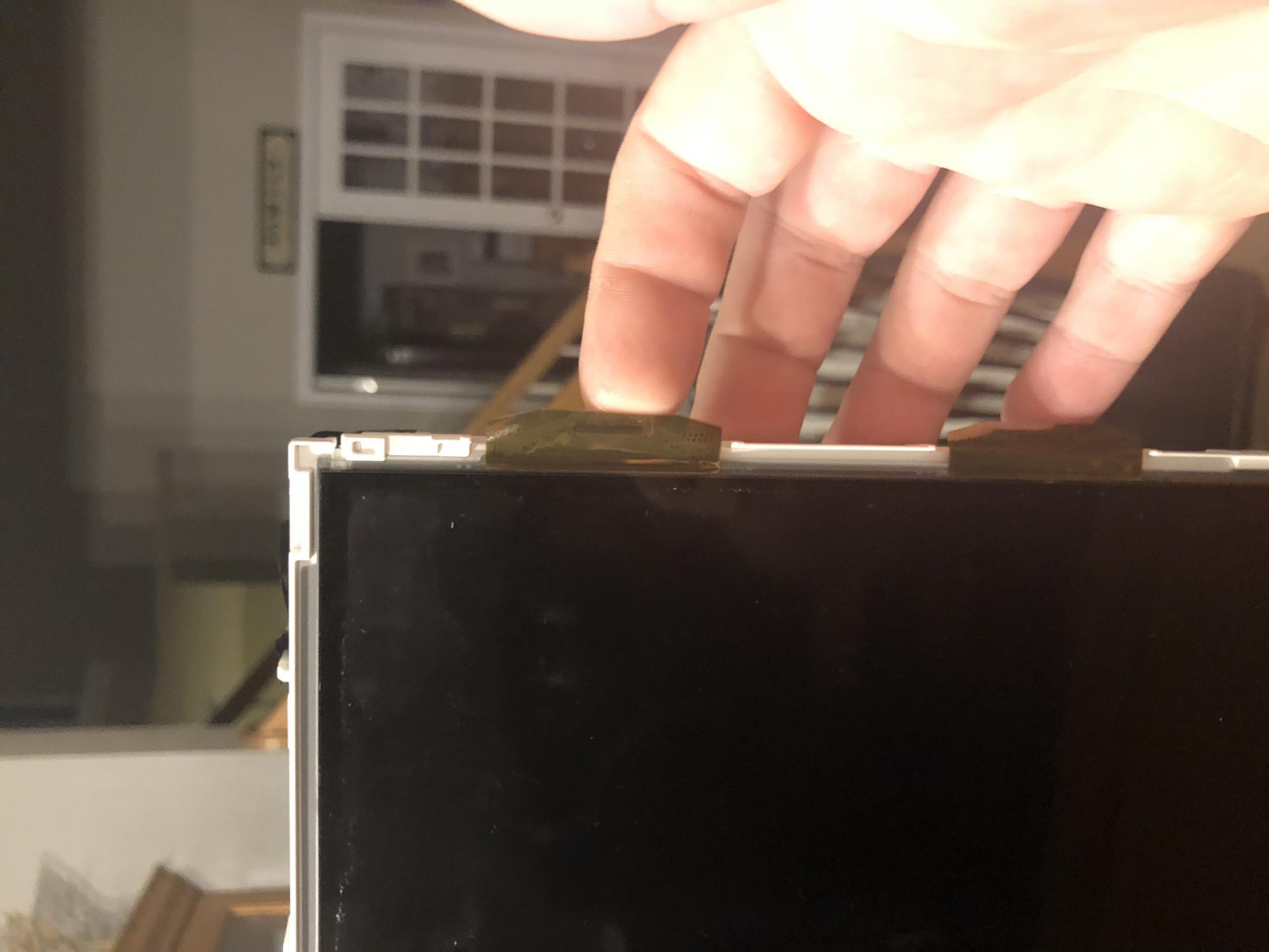

            Closer pics: Edit: these are on the right hand side. I don’t know why the pictures are rotating.
              OK, I understand now. Look closely at those tabs along that side and see if you notice anything different about one of them especially in the region where the horizontal "discontinuity" shows in the display. Either way, as you found, it is likely that the side tabs are an issue and need to be removed to save the set. The tabs are like removing tape and can be easily / gently pulled away / up from the contact points of the panel. Cutting them may leave behind material that is compromising the panel contacts if that is the underlying problem.

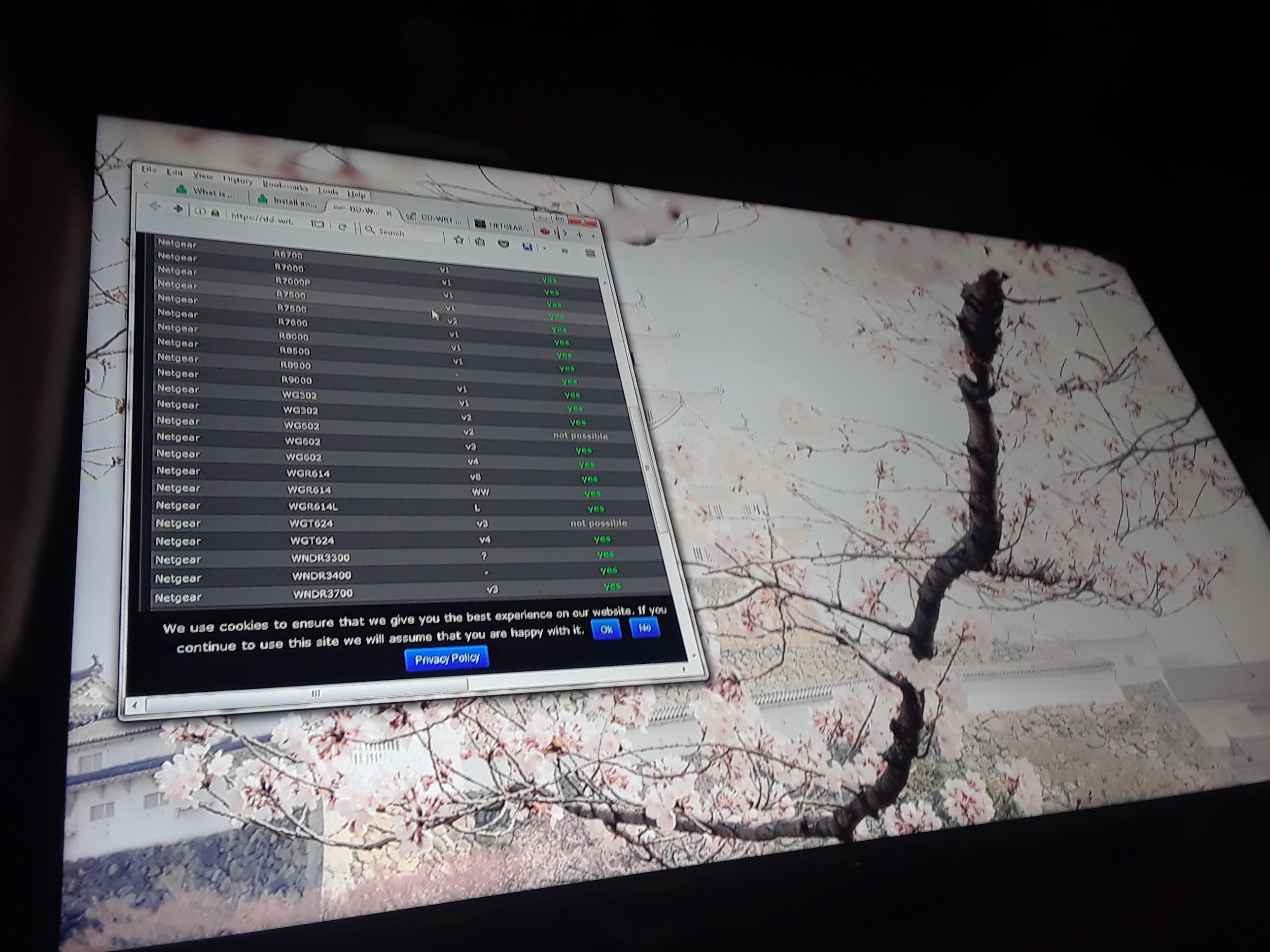

                Ok, so good news/bad news. I pulled the tabs off the right side and I got the whole picture back, so that's good. But now the right side of the panel is dimmer than the left. Slightly so, but noticeable to me. Is there anything I can do about that? Thanks.
                • budwich
                  • Jul 2015
                  • 3097
                  well... you have to "lose" something by removing something... just the "law of the universe"... :-) The "save" is not "perfect" so if you have "golden eyes", you will be disappointed.... maybe even more so with a curved screen. A 46in sony that I "saved" has a noticeable difference across the screen but it is useable.... and do notice it more when watched "off center". Not sure that I noticed as big a "gradient" on a sharp 70 that I saved but that was an "early success" and was more interested in the result of a working set as opposed to a getting back a "fully operational / spec'ed" set again. The owner of that set still likes it better than the samsung replacement that he tried and returned when we got his set back to "working".
                  Anyway, you might try adjusting some of the setting to try to reduce the differences.

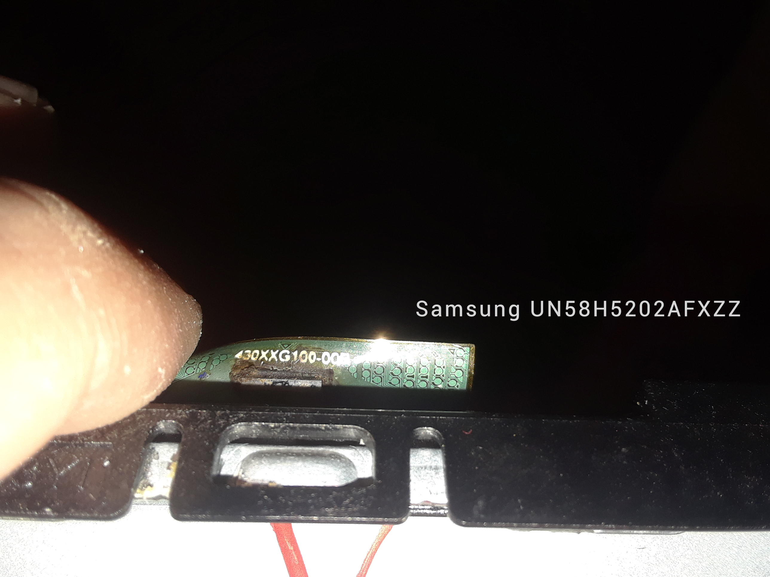

                            I just wanted to confirm, I just attempted this fix on my Samsung 15 minutes ago and it was an amazing success. I pulled off all the tabs on the left side which had a fried tab/shorted tab. I started with the bad tab,pulled it off, turned the tv on. No difference. Then I did all the tabs on that side. Instantly solved!!
                            Model number: Samsung model un58h5202afxza
                            Problem: Glitchy horizontal lines/flickering/highly abnormal picture on one side. Really hot in one spot (the bad tab)
                            Cause: Apparent water got in shorting a side tab on the left side
                            Solution: Pulled off all tabs like I was recommended.
                            ^ Just to summarize in-case someone else stumbles upon this thread on a google search. Seems to be a common problem?
                            It seems to have fixed it with no noticeable difference in picture quality..? Not sure how it looked before I fixed it, i've only seen a broken model So for this model I can confirm it as a great solution if you have a bad tab.
                            Much thanks to Budwich and Andrew F. Ali
