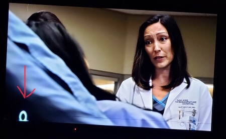

    Got a 65” P65ST50 plasma TV with a faulty buffer board, with the SC jig I can confirm SU or SD board failed, planning to buy replacement SD board for reasonable price, located one what guaranteed by the seller but with conditions. The seller claim that if the board will turn the unit on but will fail again shortly (hours/days) the display have fault in it and will voide warranty.
    So after discussing this options with the owner of the unit he send me this picture what was taken just 2 days before it's stopped working.
    The lover left corner have a weird glowing circle! Is this a bad plasma display or just a indication of the faulty buffer board? Should I spend time and $$ or just recycle it ?
    Ty

    A buffer board will not cause that round defect, Thats a panel fault, the thin black line may be caused by a bad lower buffer or is a result of the panel defect but may have also damaged the lower buffer.

      So you think it's not repairable!
