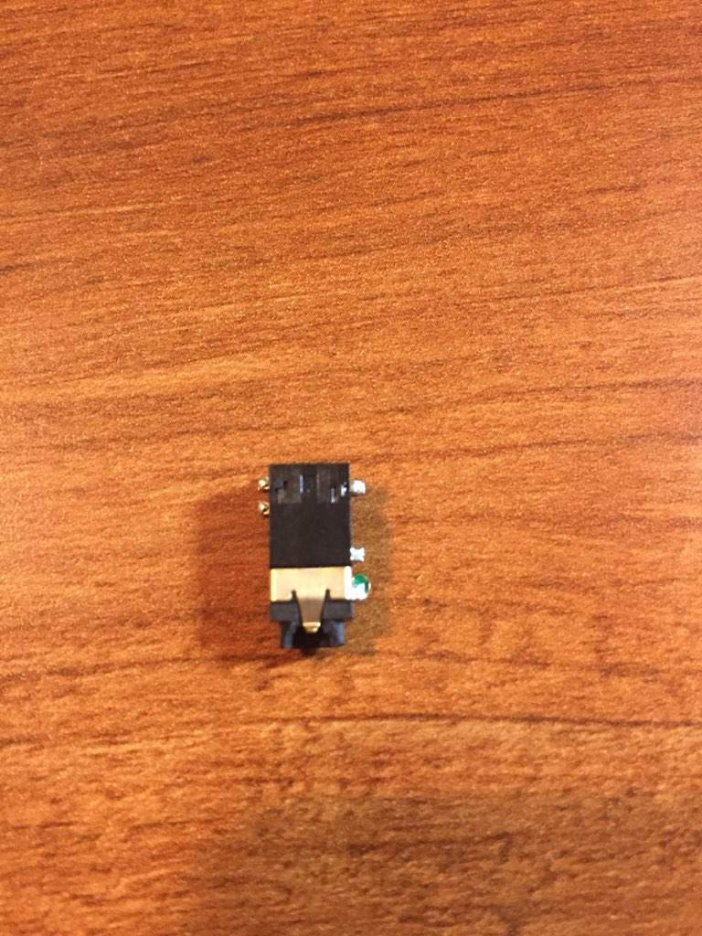

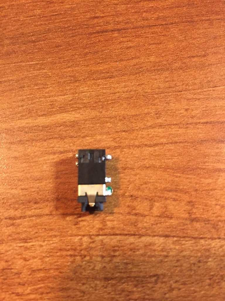

      I managed to find it inside the chassis. Here are pictures of it...
      thanks for your help...looks like ground wrap went to one post and also looks like other side may be broke off

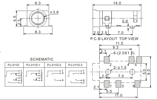

              It looks like a PJ-311D, this might help. I will ask again.... Whats the MODEL NUMBER?
              Or resolder the jack back in

                Look at the supplied diagram and of course, check / confirm that your jack is similar (ie. use a meter). Notice in the diagram, the jack when just sitting there makes NO connection with any portion of the circuit.... ie. its not a "break / make" type connection, just a "make" connection. That means that if there is no jack currently in the tv, it is just like having "no headphones". so your problem is not likely a missing jack, it is more. Something in the circuit going from the wiring of the jack toward the board / tv is shorted.
                Its hard to tell from the board photo what connections are in the "little box".

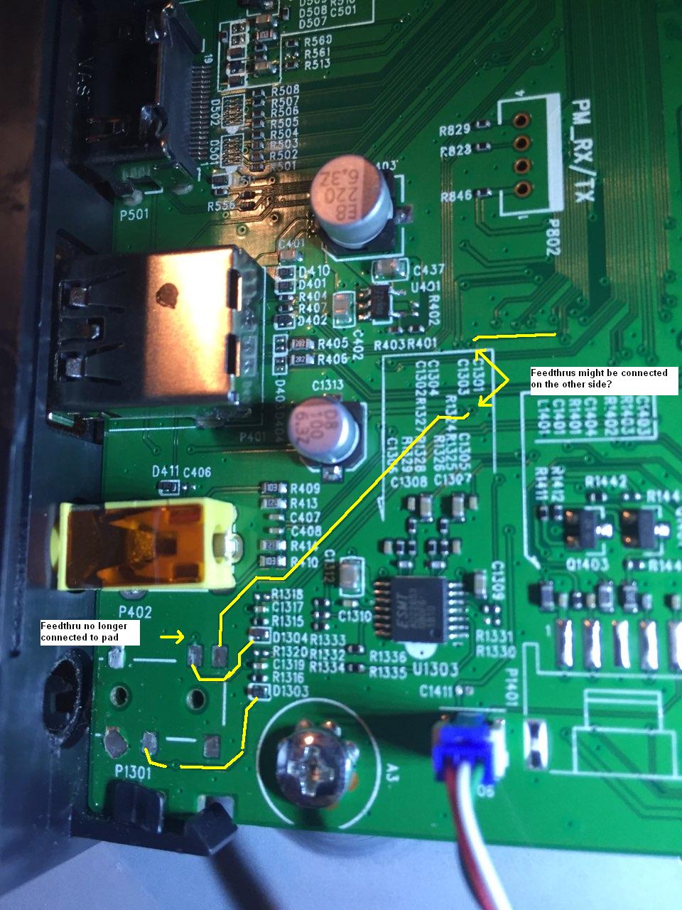

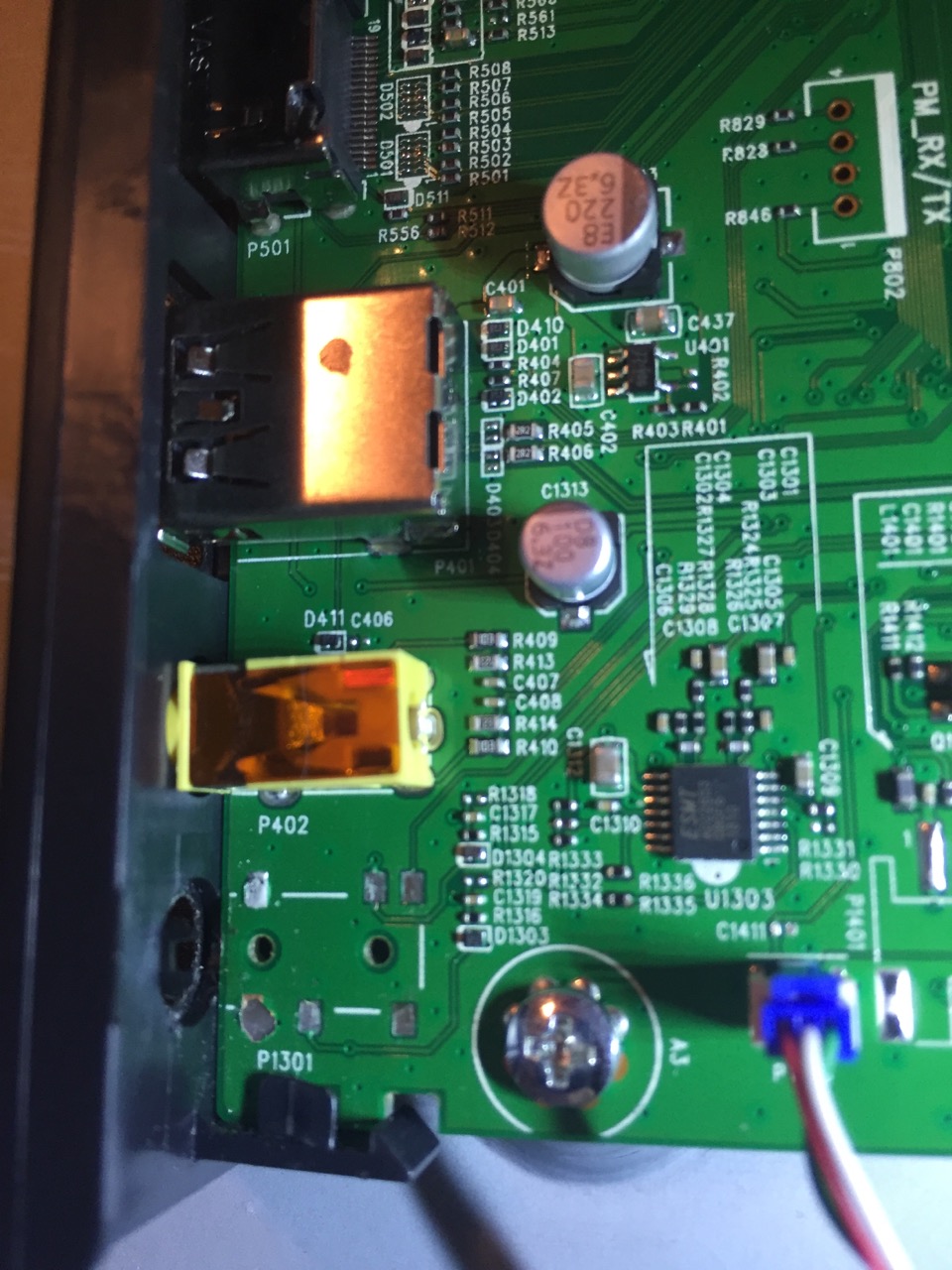

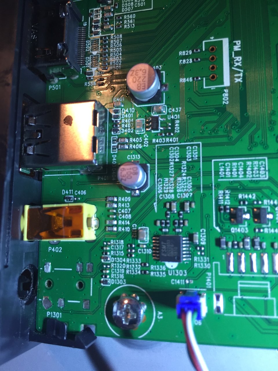

                    So I verified that the jack is indeed the PC-311D. The problem I have is that the jack was somehow ripped from the main board, taking the solder pads with it. So I am not sure how to jumper the two rear pads or even replace the jack with a new one. Am I out of luck and need a new main board or is there a way to jumper those connections? I have soldering skills but these new boards seem to be a challenge for a problem like this..

                      relooking at the schematic and confirming your plug is as posted, your plug IS a "break/make" type setup. Look at the first two schematics "blocks" in the post. You just need to solder a wire from pin 5 to 4 which are the two closest pads at the "top/ back" portion of the board and are still there.

                        You would need to connect thin wires to the closest component. Pin 3 seems to go to D1303, Pin 4 seems to go to D1304 BUT there is also a feedthru at pin 4 pad, that feedthru also needs to be traced to where it goes. Pin 5 goes on a longer trip but could also be traced but seems to go to a feedthru to the other side then likely comes back up to this side and goes out of picture
                        It is hard to do but can be done.

                            Jump 4 & 5 (switch) for the Tip connection (Left channel), when phone plug is inserted, pin 4 & 5 go open circuit.
                            Jump 3 & 6 (switch) for the Ring connection (Right channel), when phone plug is inserted, pin 3 & 6 go open circuit.
                            Pin 1 (Sleeve, GND) & 2 is closed circuit when phone plug is inserted, pin 2 is basically grounded when phone plug is inserted.

                                  Pin 6 of the jack may not be used, audio signal is on pins 3 & 4, HP detect pin is likely pin 5, connecting pins 4 to 5 should (maybe?) restore audio
                                  It is likley the audio to the main speakers is switched in an ic and not run through the jack itself. that way only one switch is required to detect if a plug is in the jack
