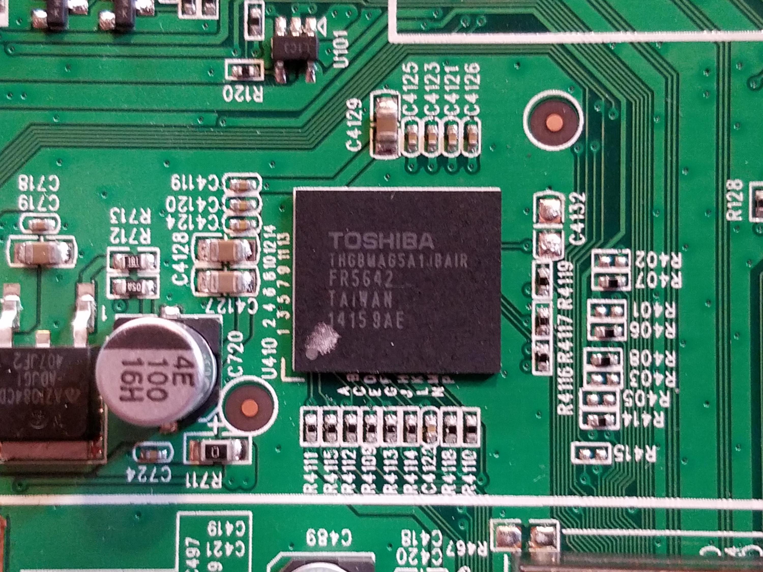

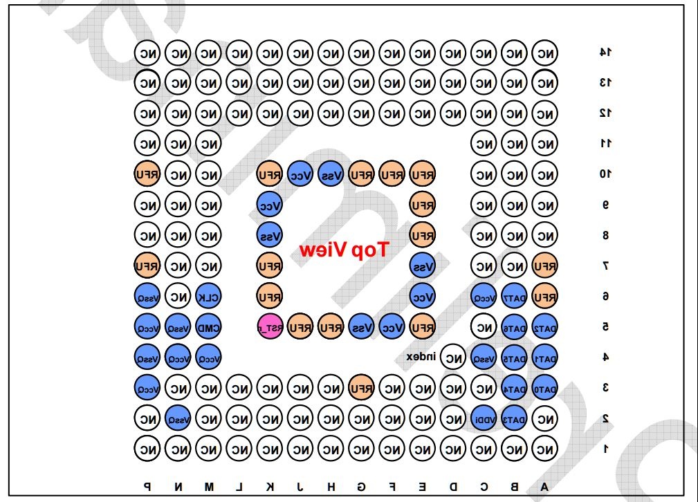

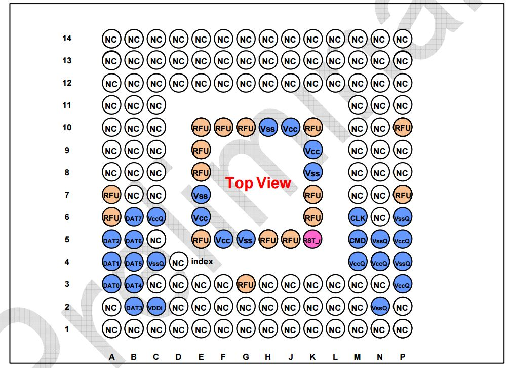

    I got this from a friend and he said it had been unplugged during an update and when plugged back in it was stuck in this boot loop. It gets to the V logo, then the panel cuts off and it starts over. During this, the backlights and secondary voltages always stay up, panel voltage does cycle and indicator goes out. Checked all regulators, all output correct voltages. Main board (XECB02K0170004) has a Toshiba EMMC. Nobody seems to have preprogrammed ones. Anyone know of reset methods for these?

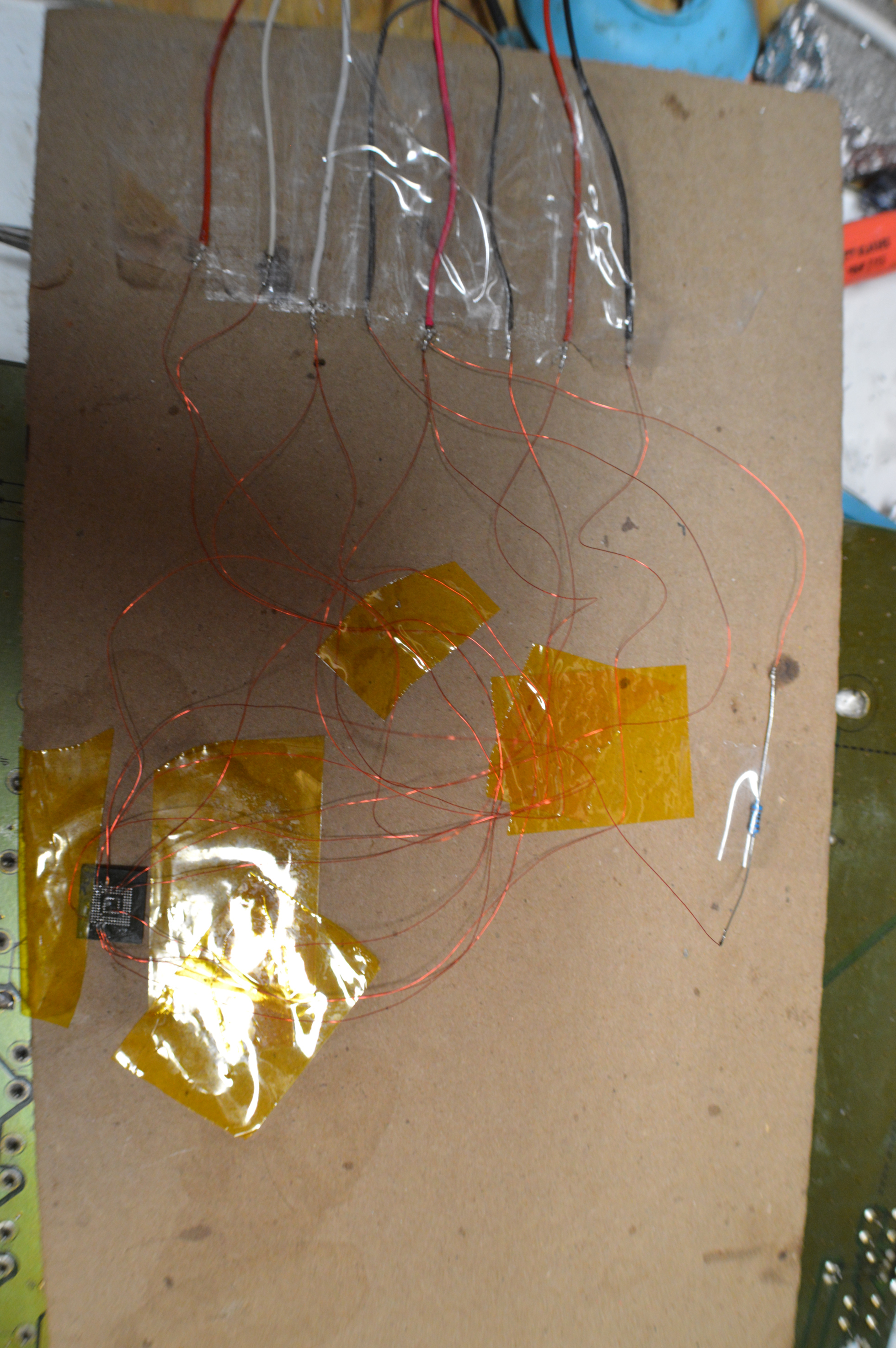

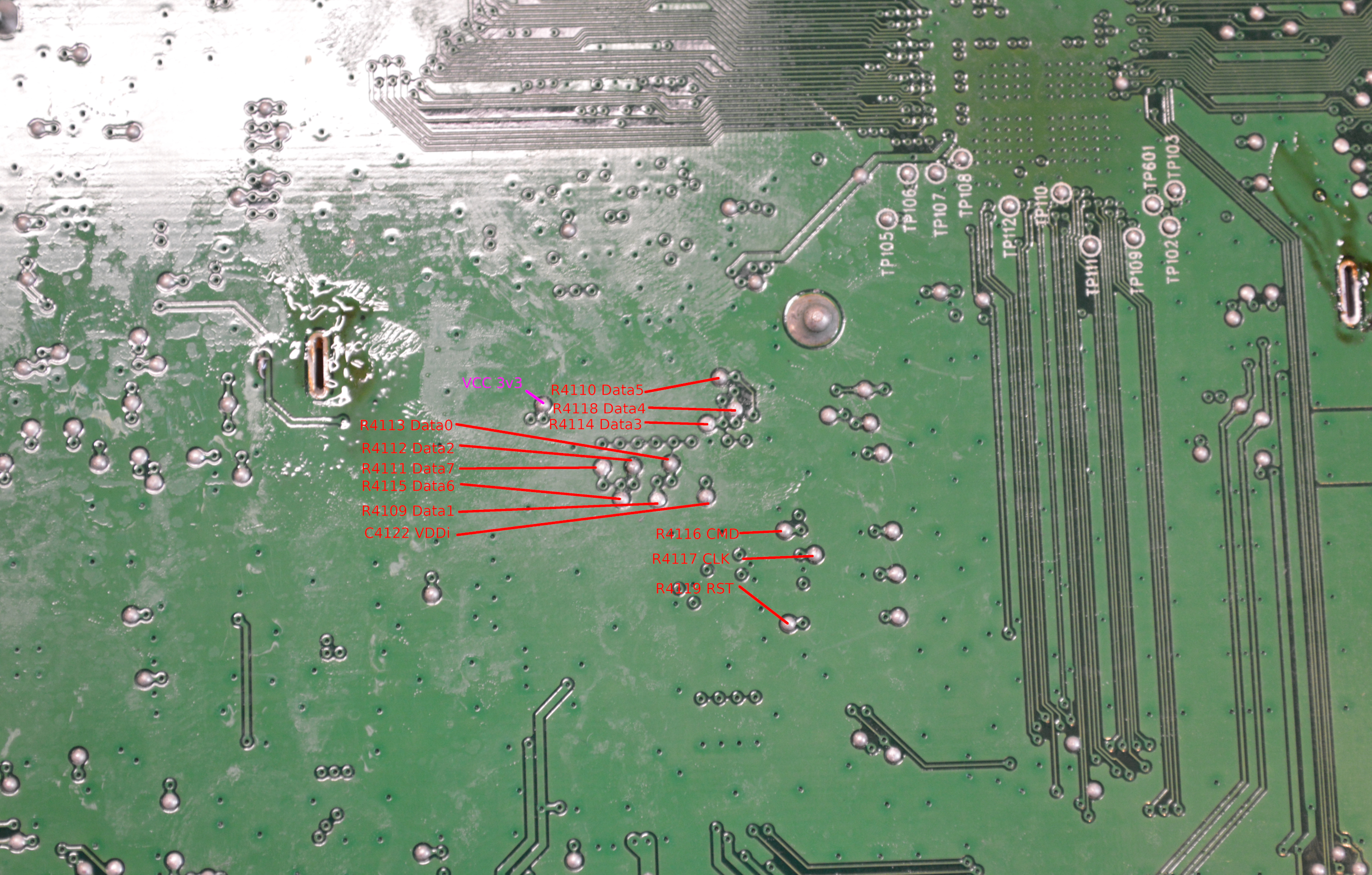

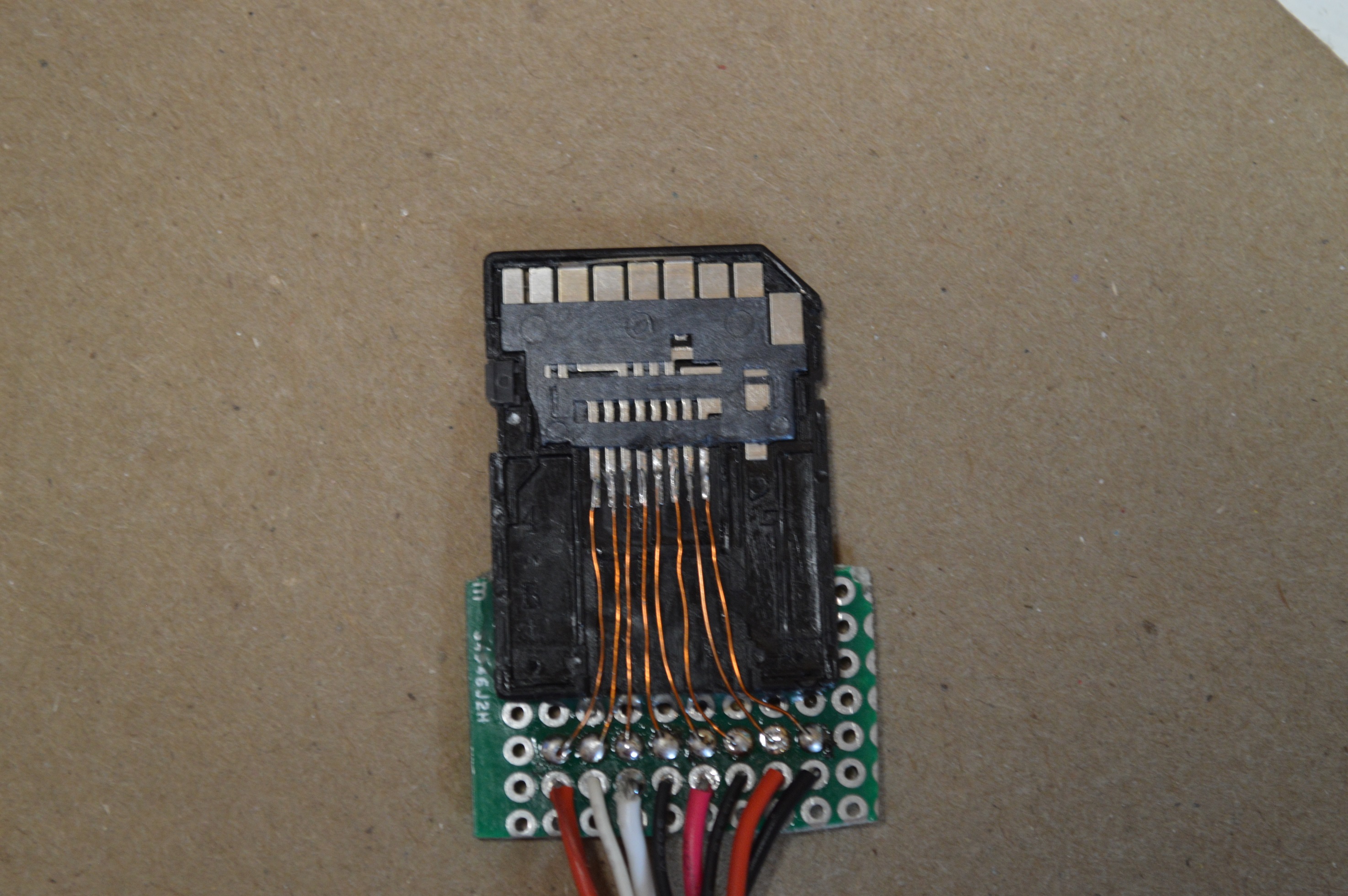

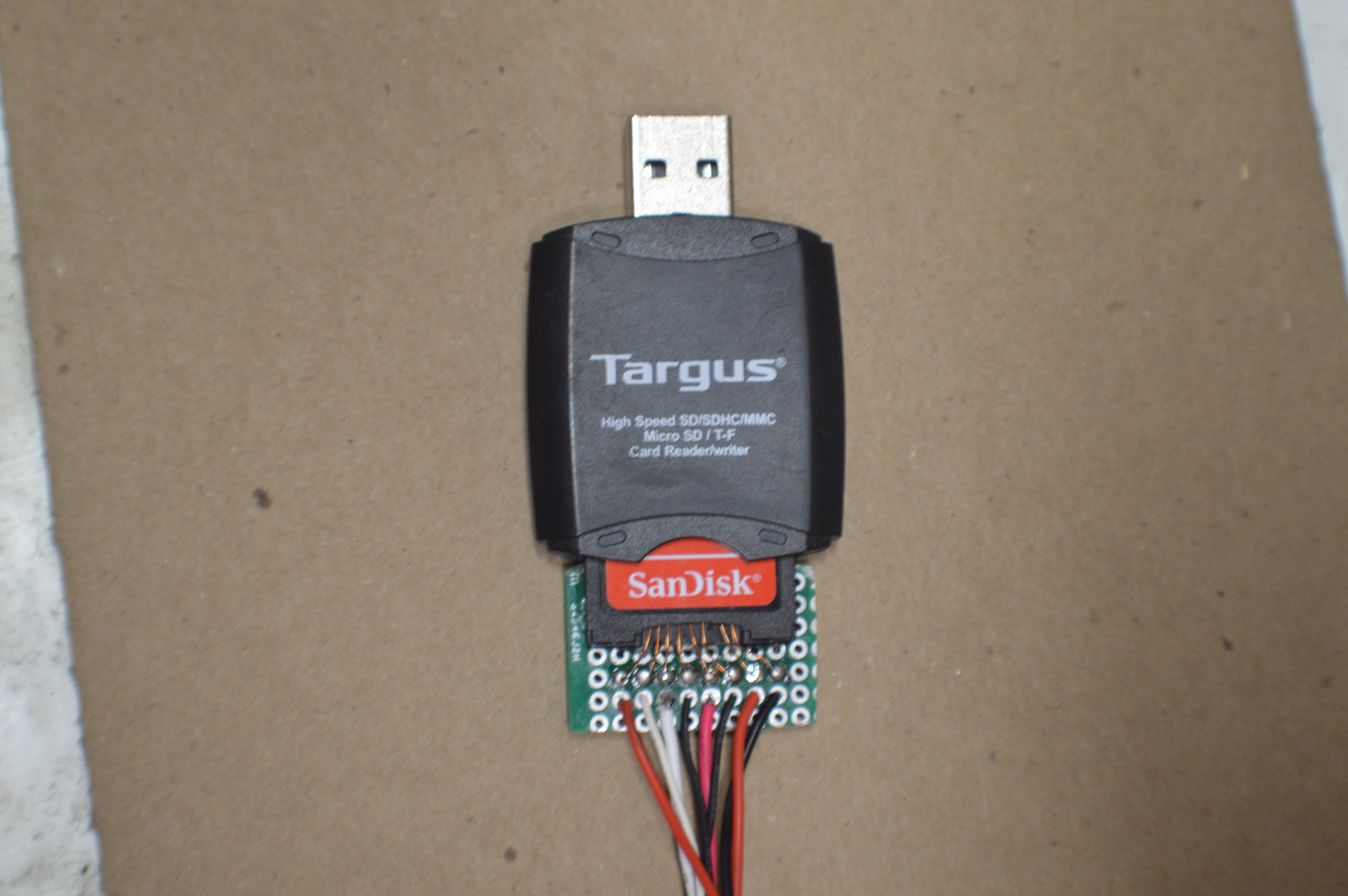

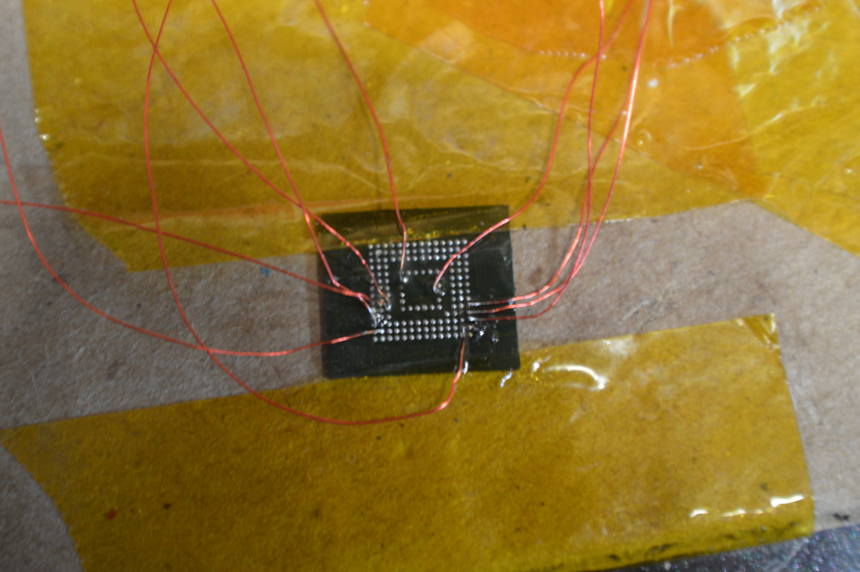

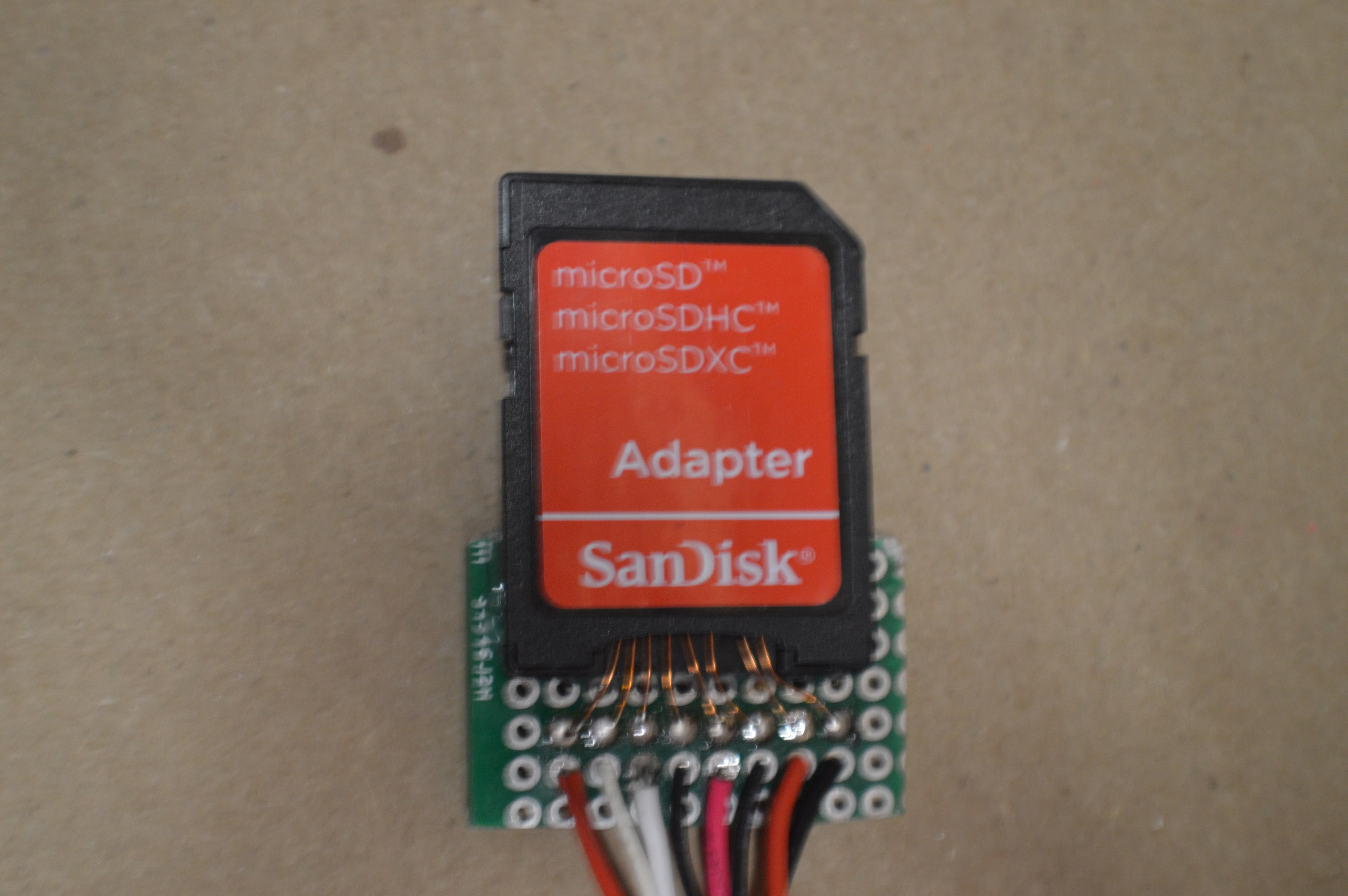

          Well, at this point I'm pretty much convinced the eMMC has failed. After a lot of research, I attempted to reverse engineer the pinout and see if I could extract the firmware image. I was able to correctly identify CMD and CLK based on their location and by viewing the waveforms on my scope. I mistook reset for VCC, because it was 3.3v and in close proximity to where VCC is on the chip. Looking back on it, I should have known because it was going through a 4.7k resistor and the trace was too small. I couldn't get the data lines right either, but that's because my card reader wouldn't work in single bit mode. Trying to guess the correct 4 data lines, and in the correct order, is nearly impossible.I picked up a Transcend RDF5 USB 3.0 SD card reader from eBay that will work in single bit mode, so next time it will be easier. Anyway, I decided to pull the eMMC and dead bug it. I got it all wired up, but can't get anything off of it. Windows 7 recognizes it as an MMC, but crashes as soon as I try to access it. I tried EaseUs data recovery and it said it found a JPEG, but then Windows decided to crash before it could complete the scan. I figured Linux would work better, but no such luck. I tried CloneZilla, but really couldn't figure out how to use it. Tried dd, and just got I/O errors. It was recognized as an MMC, and I had mmcblk0, mmcblkoboot0, and mmcblk0boot1 in dev, but nothing could access them and they wouldn't mount. I tried the Transend card reader which does work in single bit mode, but I had the same results with that. Test points are all on the back of the board, and I've identified them in one of the pictures. VCCQ and VSSQ are tied to VCC and VSS, so no test points for them. I have a new eMMC coming from China. I'll have to buy a board to dump the firmware from. Hopefully that will go better. Thinking about it, why would someone unplug a TV during an update unless it had froze up. I'm thinking it died during the update, but, I was getting the V logo, so at least one of the boot partitions was readable in the TV. Not sure why I can't get anything off it. The only connection I didn't make was to VDDi. I'm not sure if I needed that, maybe I'll try that tomorrow if I can find a 1uf cap.
