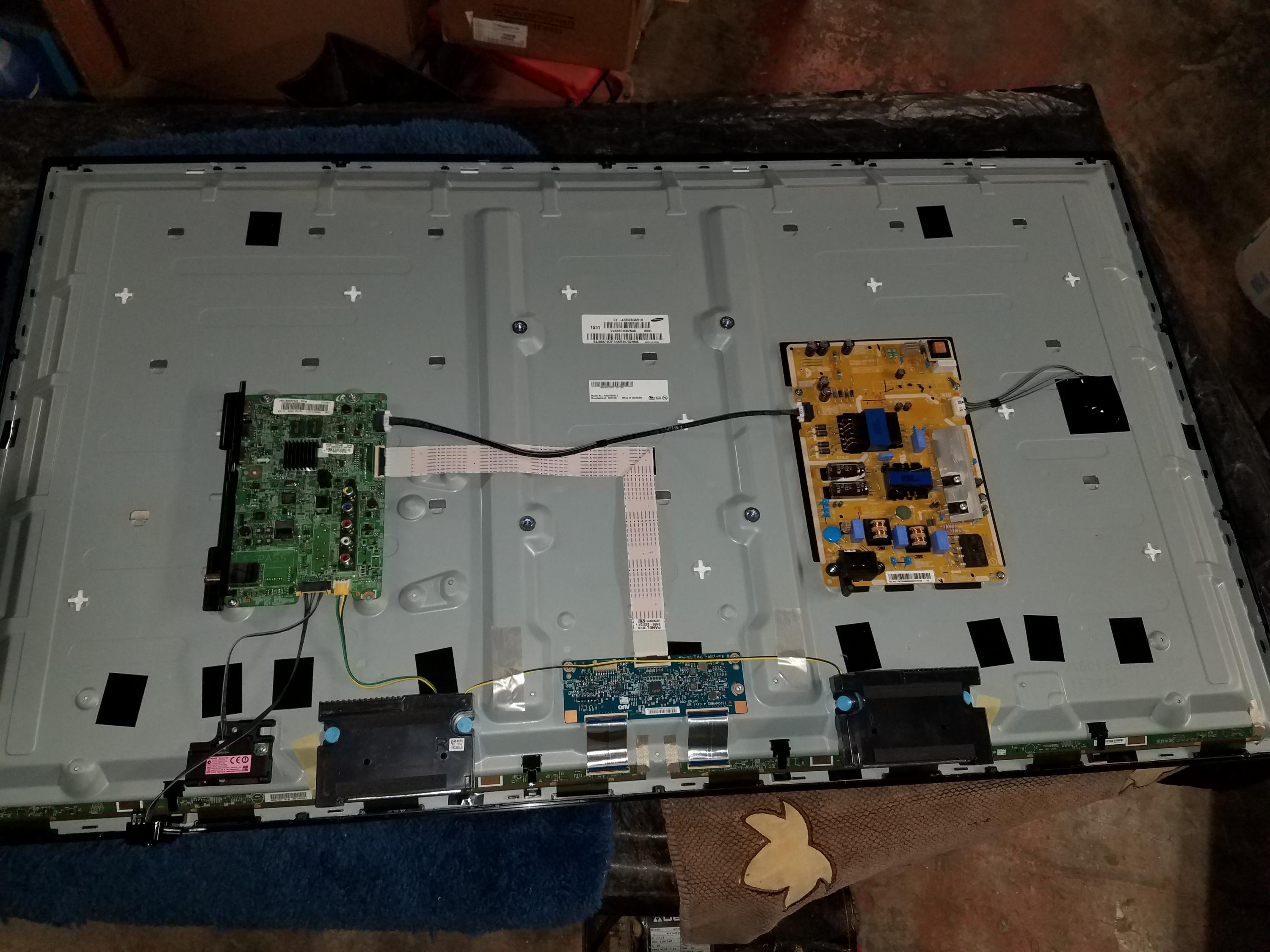

    We need to see the pictures of the whole backside of the TV showing all the boards.

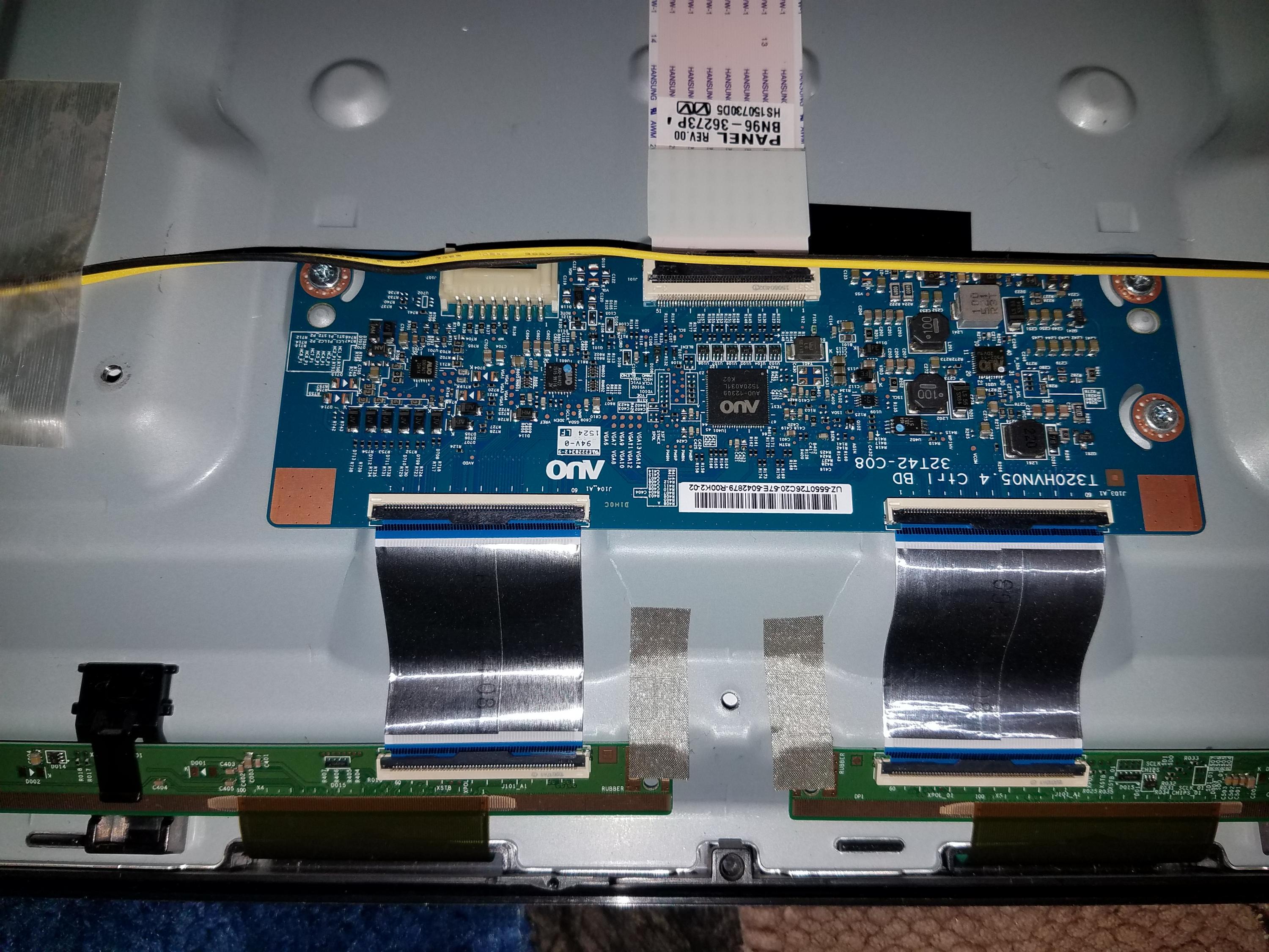

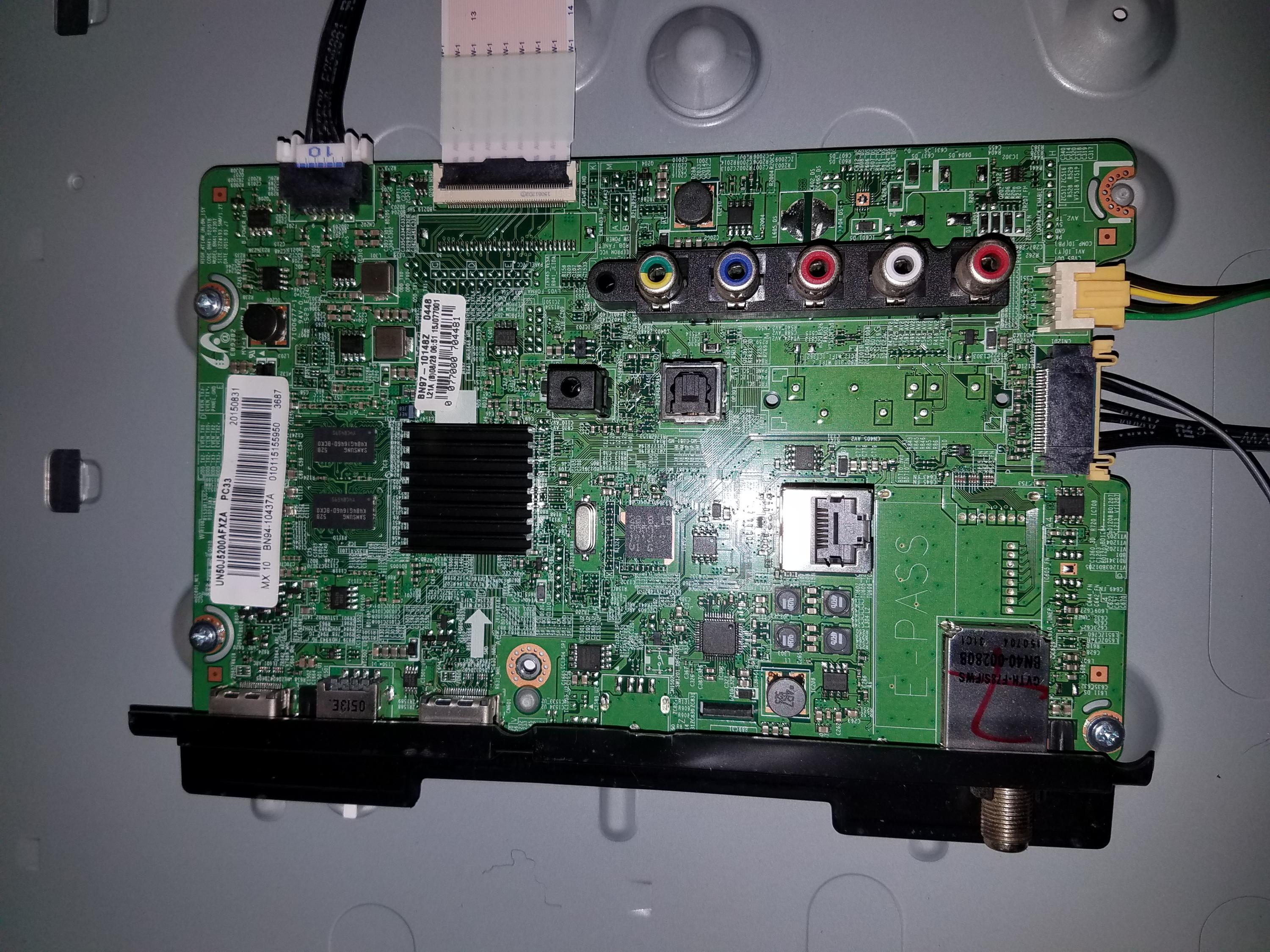

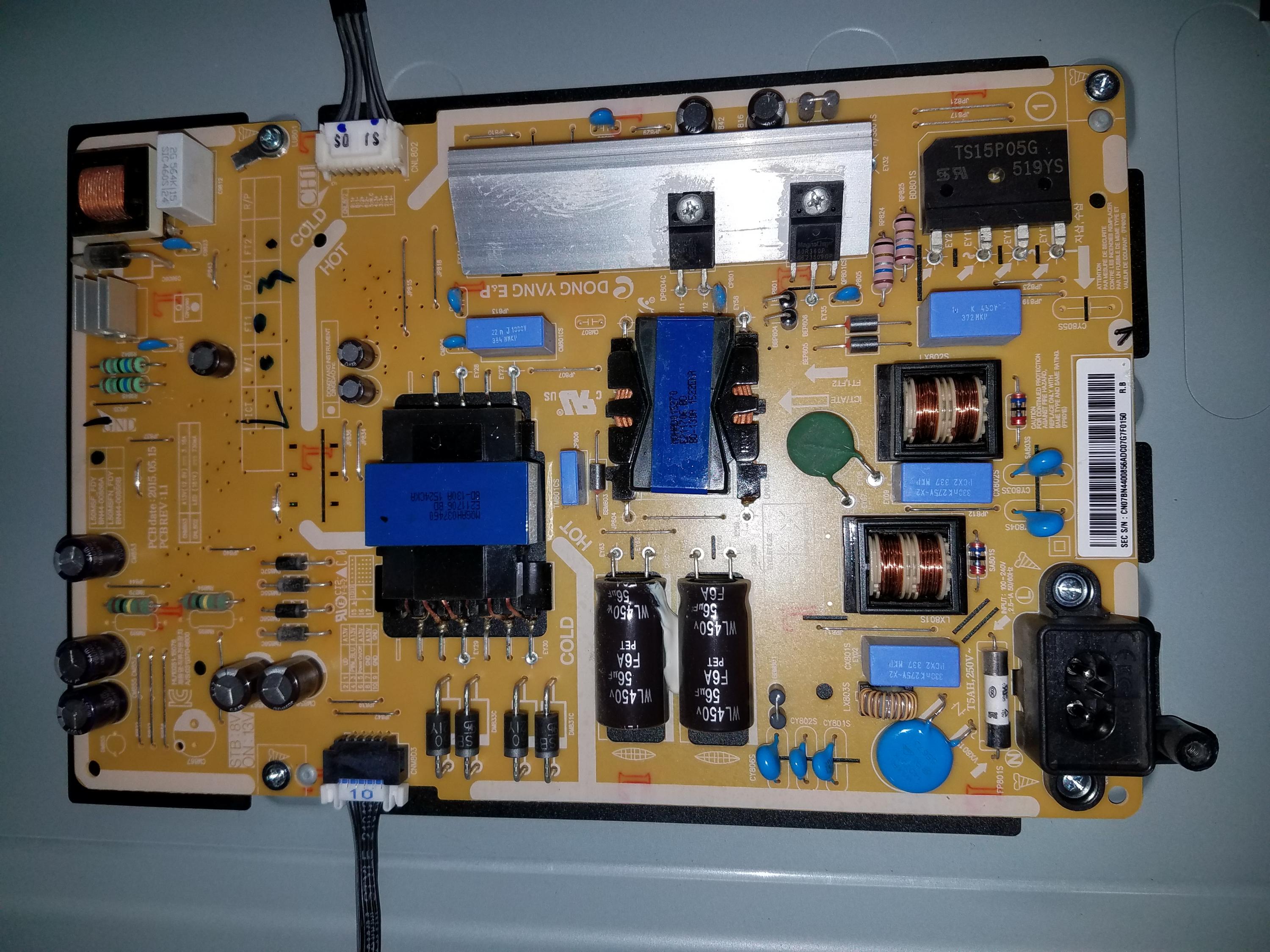

        Thanks very much for the response. Please see attached photos:
        1- Entire rear panel
        2- Power supply board
        3- Main logic board
        4- T-CON board
        5- Panel bond board (left side from rear of TV)

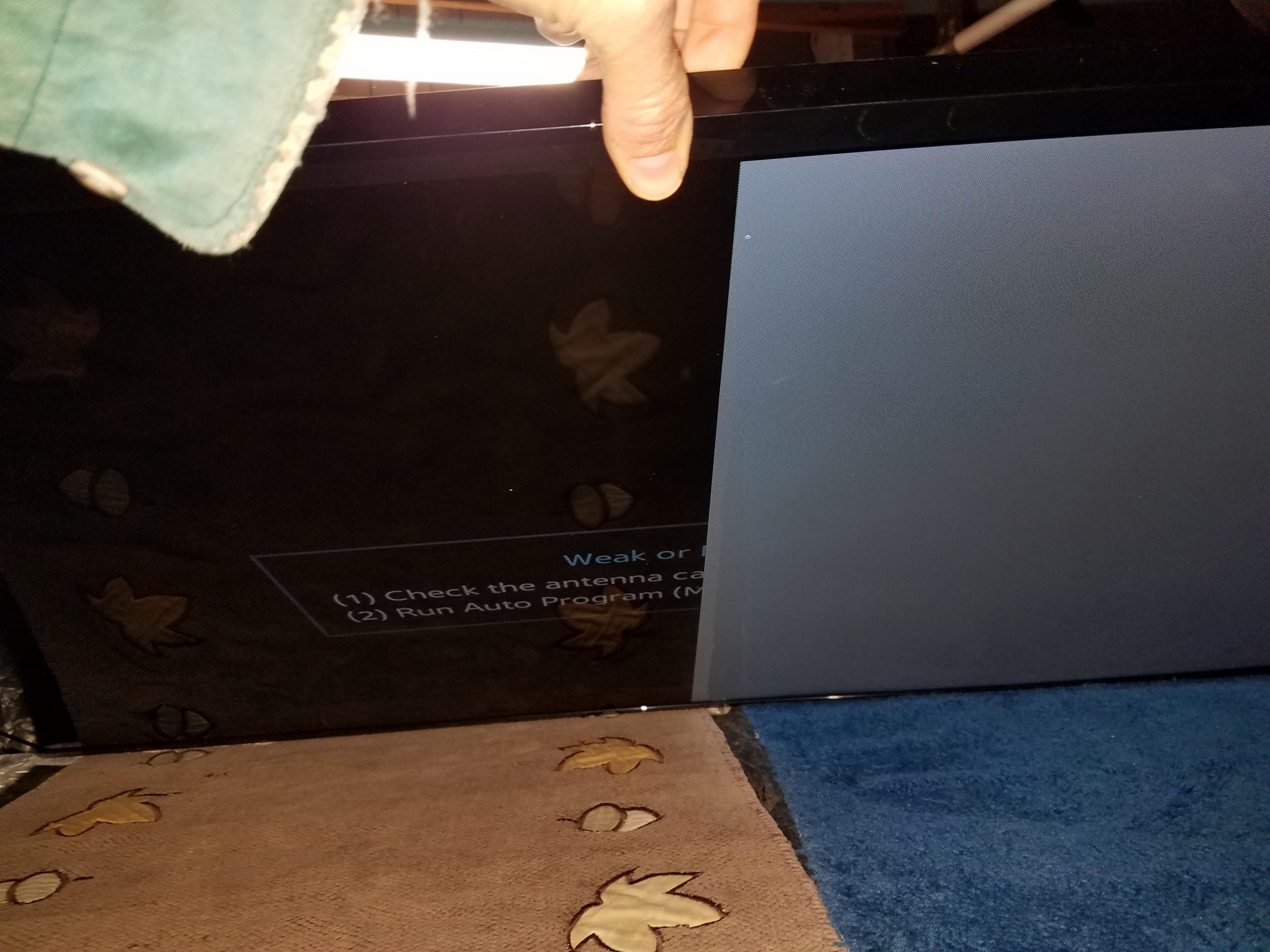

        6- Display with left (from rear) panel bond board disconnected from T-CON board
        When I removed the LEFT (from rear) panel bond board connection, the opposite side (LEFT from front) of the TV display appeared to work normally - this is the first time I've seen any image on the screen at all.
        When I reconnected the LEFT (from rear) side and disconnected the RIGHT (from rear) panel bond board, I got nothing on the screen at all, not even the disappearing horizontal grey bar across the top that happens when both are plugged in.
        I am hoping this points clearly toward a solution but I have no idea if it's the T-CON board (which would be great!) or the panel bond board (which would likely be bad since they don't look easily replaceable).

          You have bad LCD panel.
          This LCD panel has tab bonding board on the bottom edge of the board and they usually get damaged by the cleaning liquid when people do the screen cleaning.
          The problem can also be caused by the shorted caps on the tab bonding board, you will have to take the metal frame off the LCD panel to inspect and check the tab bonding board.

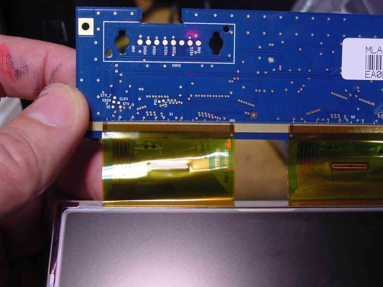

              No.

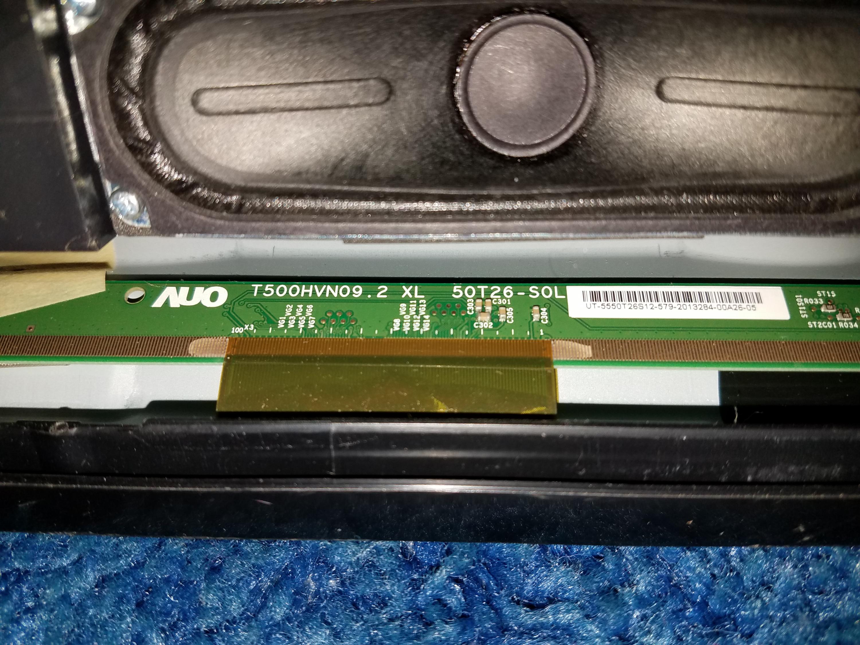

              See picture of the tab bonding board.
              • Redwood
                • Jul 2011
                • 9
                Re: Samsung UN50J5200AFXZA - Screen goes blank
                Not really clear what I'm looking at here. Is it just that the tab where it's bonded to the panel is sandwiched between parts so you can't get at it?
                Soooo...TV's junk then?
                  You need to remove the metal frame around the LCD panel assembly to see the boards, otherwise there is nothing you can do, and if lets say you did find shorted SMD cap, you have tools to do SMD repair, right?
                  https://www.badcaps.net/forum/attach...6&d=1401307181
                      So you already took the frame out and get to the caps on the tab bonding board of the side that does not get pictures? None of the caps on that side of the board show <700 Ohms compared to the good side?
                      No sign of any corrosion from liquid either?
                      https://www.badcaps.net/forum/attach...0&d=1539189835
                      It looks like you can almost get to all the caps on the tab bonding boards without taking the frame off.

                        Well I have to admit this vocabulary is new to me here but I am assuming the tab bonding boards are those long narrow boards which are connected directly to the T-CON board, is that not correct?
                        If so, then yes, they are pretty much completely exposed along the bottom edge of the rear of the unit without pulling the frame. They have ribbon cables that do a 180° bend up under the frame and from there I can't see what's going on but I've been assuming those are fastened to directly to the panel.
                          Yes, they are the long skinny boards, the speakers are blocking part of the board too.
                          If you are lucky then it may be just bad caps with low resistance readings, if not it can be the embedded IC (small rectangular piece you can see in post 7) on the flexible board between the LCD glass panel and the tab bonding board.
