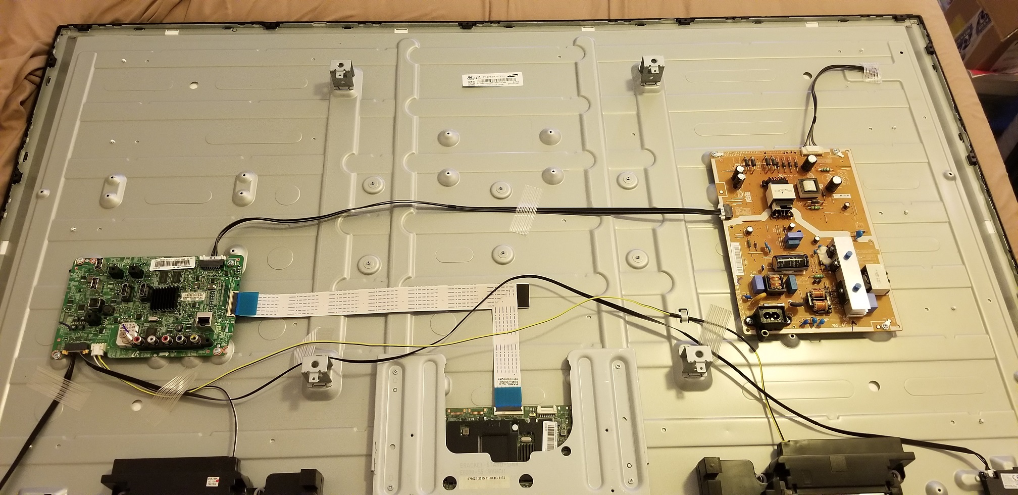

        We also need the pictures of the whole backside of the TV showing all the boards.
        What is the power supply board P/N? BN44-00774A???
        If it is then the LED strings are connected in series so if one LED goes open circuit there will be no backlights. To verify that you will have to test Voltages on the LED connector pins against GND.

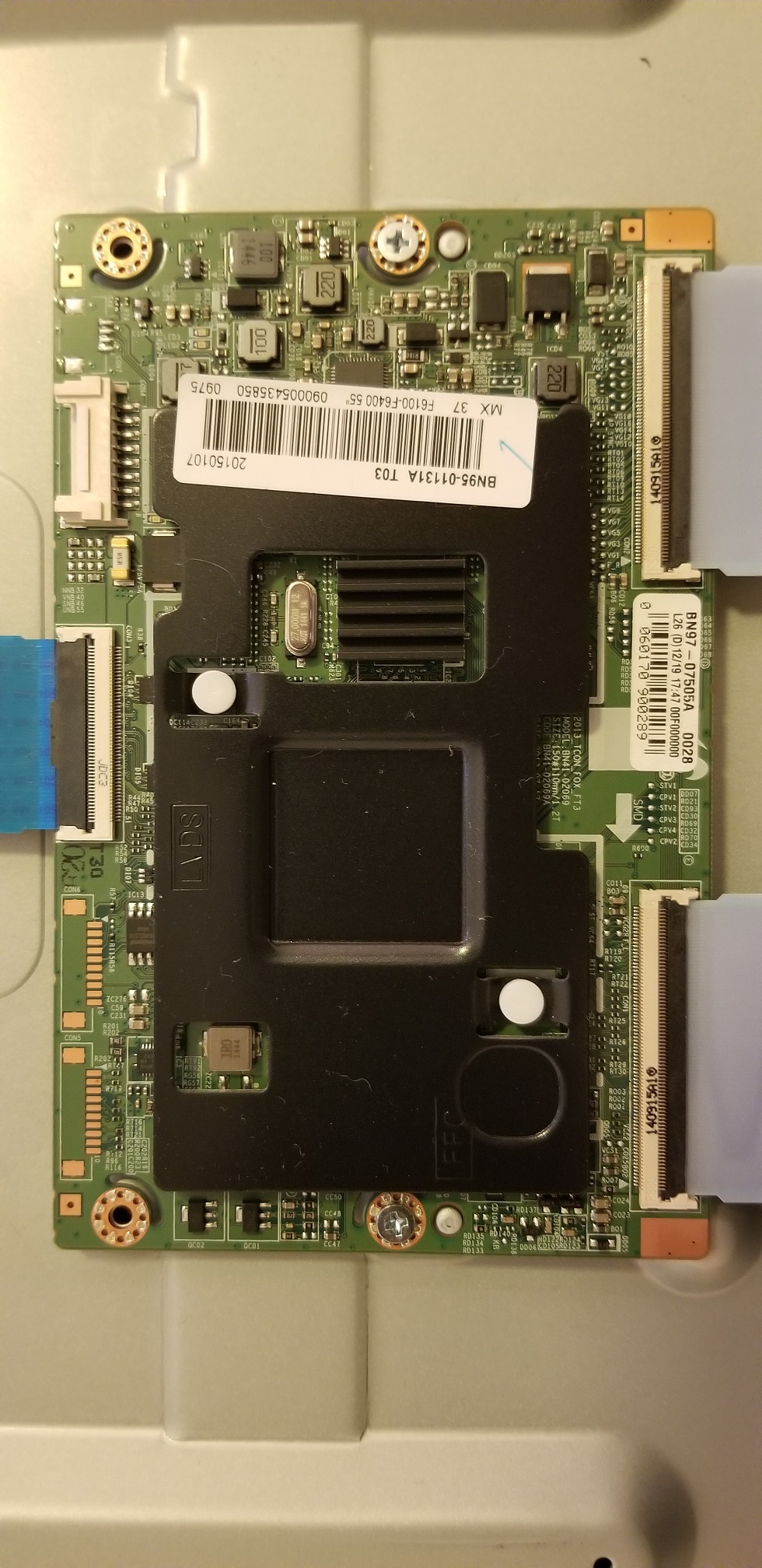

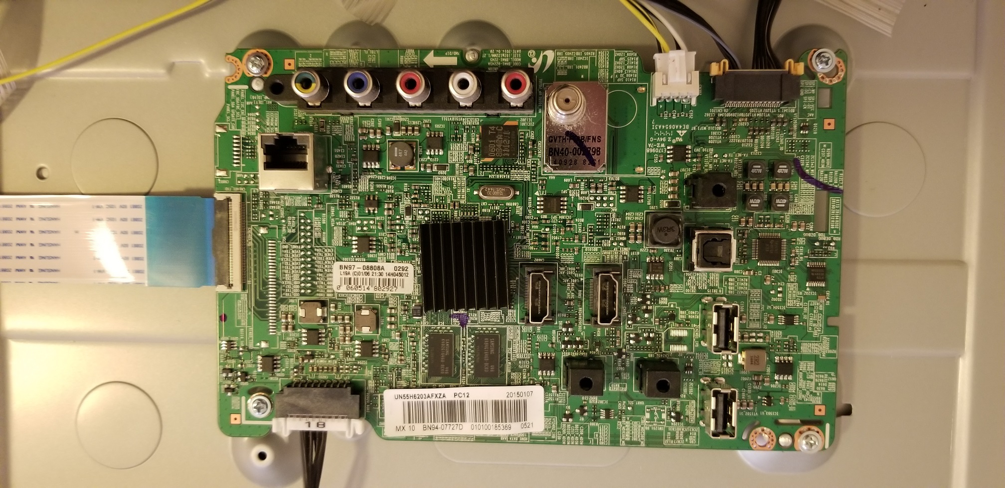

            OK, here we go.
            Images of the Back of the TV. Top of the TV at Top, Power Board on Right, Main Board on Left, T-Con still under the metal housing.
            Then Individual images of each board.
