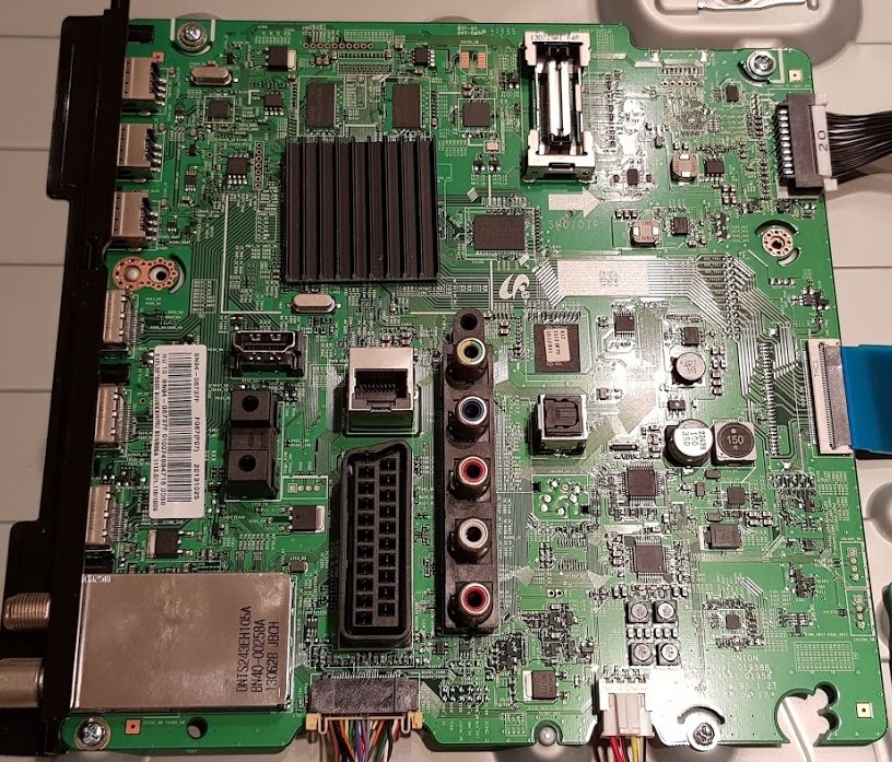

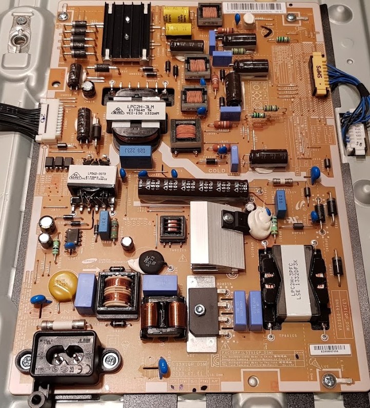

    I have a Samsung UE32F6800SB LED TV that is refusing to power up. The standby light is flashing. The first test I did was to disconnect the main board from the power board, then when power was connected, the backlight came on so I would assume the main board is at fault. However the backlight is flickering quite badly so maybe the power board is where I should start? Any thoughts?
    Looking at the voltages (with main board connected), it appears to be constantly power cycling see below:

    With the Main Bd. disconnected and plugging into the ac, if the Backlights come on but is flashing then you have a backlights problem, too.

        That power supply/LED driver board has 4 boost converter for four sets of LED string.
        What is the board P/N? BN44-????? I cannot read it from your pictures.
        You need to inspect the solder joints on all the legs of the transformers, especially on those rivet feed-through joints.

          Thanks budm I will check that later. Power board number is BN44-00620A. Main board is BN94-06737F

            Ok all the transformer legs look fine and have continuity with PCB traces. The backlight LED's all seem fine. I can illuminate them one by one with my meter in diode mode. I have checked all the diodes on the board and they are working as they should.
            I think I'm going to look for a replacement board but which one should I replace? Power?

              Quick update. Replacing the power board fixed this tv.
