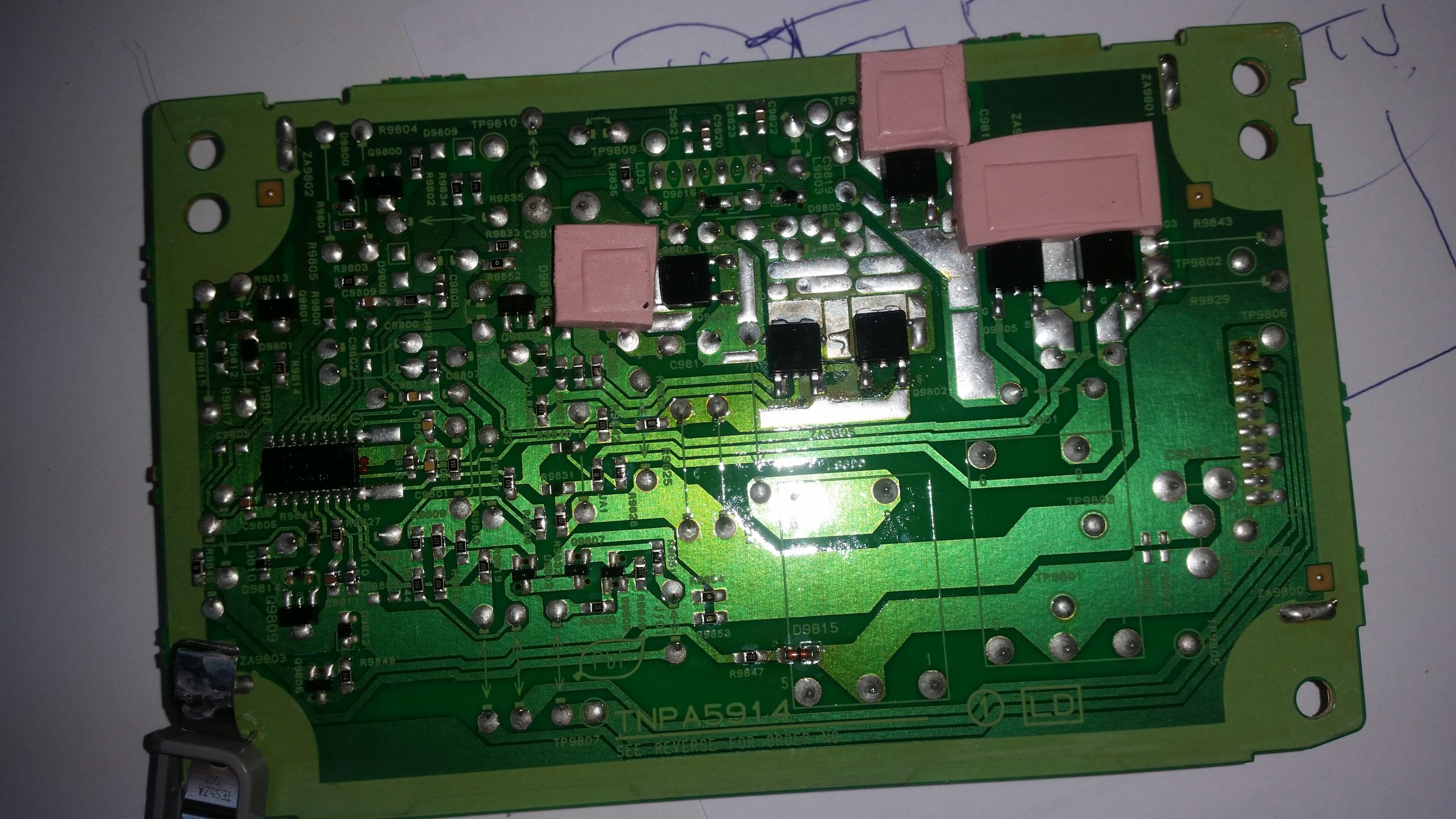

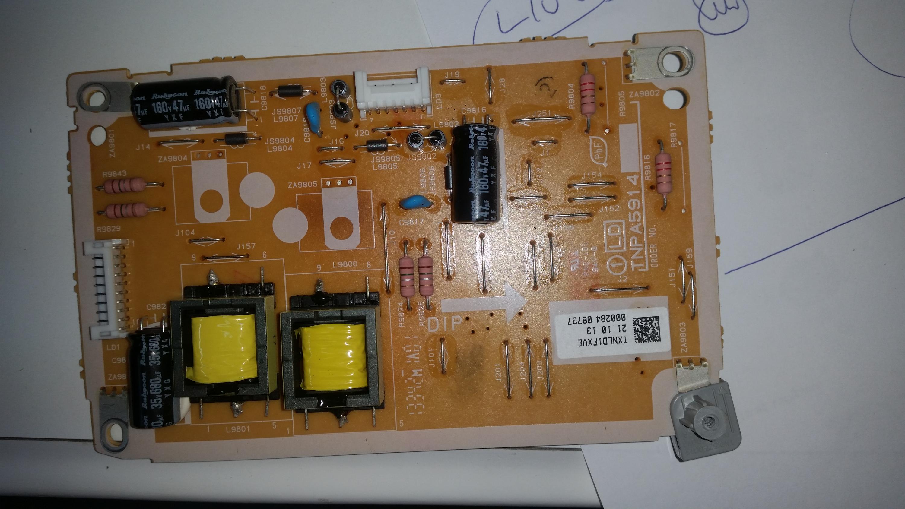

    Hi guys I got this Panasonic TX-L50BL6E Smart TV here. I was given this, it has been left outside an apartment in the garden for several months as it had developed a power supply fault
    Anyway it doesn't seem to be particularly worse for the exposure to the elements, it only rained once here since march.
    The fault is a short circuit on the LED driver board TNPS5914.
    Interestingly someone has tried to repair this before as two legs of one of the power FETs (Q9804) had been unsoldered from the PCB and were floating in mid air but the short is actually on the parallel connected FET Q9802 which is s/c source-drain. It seems odd (to me) if someone could diagnose the fault that far, then why couldn't they figure the short was on the parallel connected FET?
    The problem I have is correctly identifying the power FET it is ST brand and marked
    17NF
    641BT336
    Part number 17NF seems to be a partial part number for an N-MOSFET
    Does someone have a schematic or know the correct part number for Q9802?
    Pics attached

    in the service manual page 39
    https://www.manualslib.com/manual/12...=39&term=Q9802
    the part is a B1CFRM000028
    https://encompass.com/item/9586854/P.../B1CFRM000028/

      When I google 'B1CFRM000028 datasheet' one of the first results is '17NF25 MOSFET'

        on ebay theirs a few listings for, STMicroelectronics STD17NF25 N-channel MOSFET 17 A 250 V but i notice some are 20 amp versions to i did see this on another site too
        Make : ST
        Package : DPAK | TO252
        Marking : 17NF25
        PI Part No : B1CFRM000028
        Part No : STD17NF25
        Part Name : Mosfet Transistor | N-channel 250 V 0.14 Ω typ. Power MOSFET in DPAK

          The B1CFRM000028 is a panasonic internal part number. Could be STD17N25 mosfet? However, the datasheet for the STD17N25 shows that the marking on the mosfet should show 17NF25.
