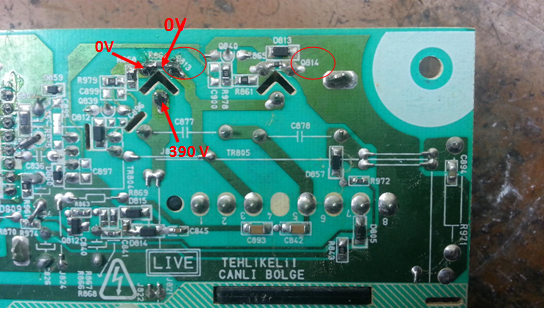

                                Sir all capaitors are 0V
                                Q813 just 390 in pin 02 . 1 and 3 =0v
                                Q814 0 v
                                like picteur

                                  There are two blue square capacitors between the heatsink and transformer, check if they are bulged, they might be open. The sides should be flat and smooth, I suspect one is bad
                                  They should be 15nF 650v (replace them with 15nF 1000V)
                                  They are C877 and C878 on the schematic
                                  This schematic might be closer
