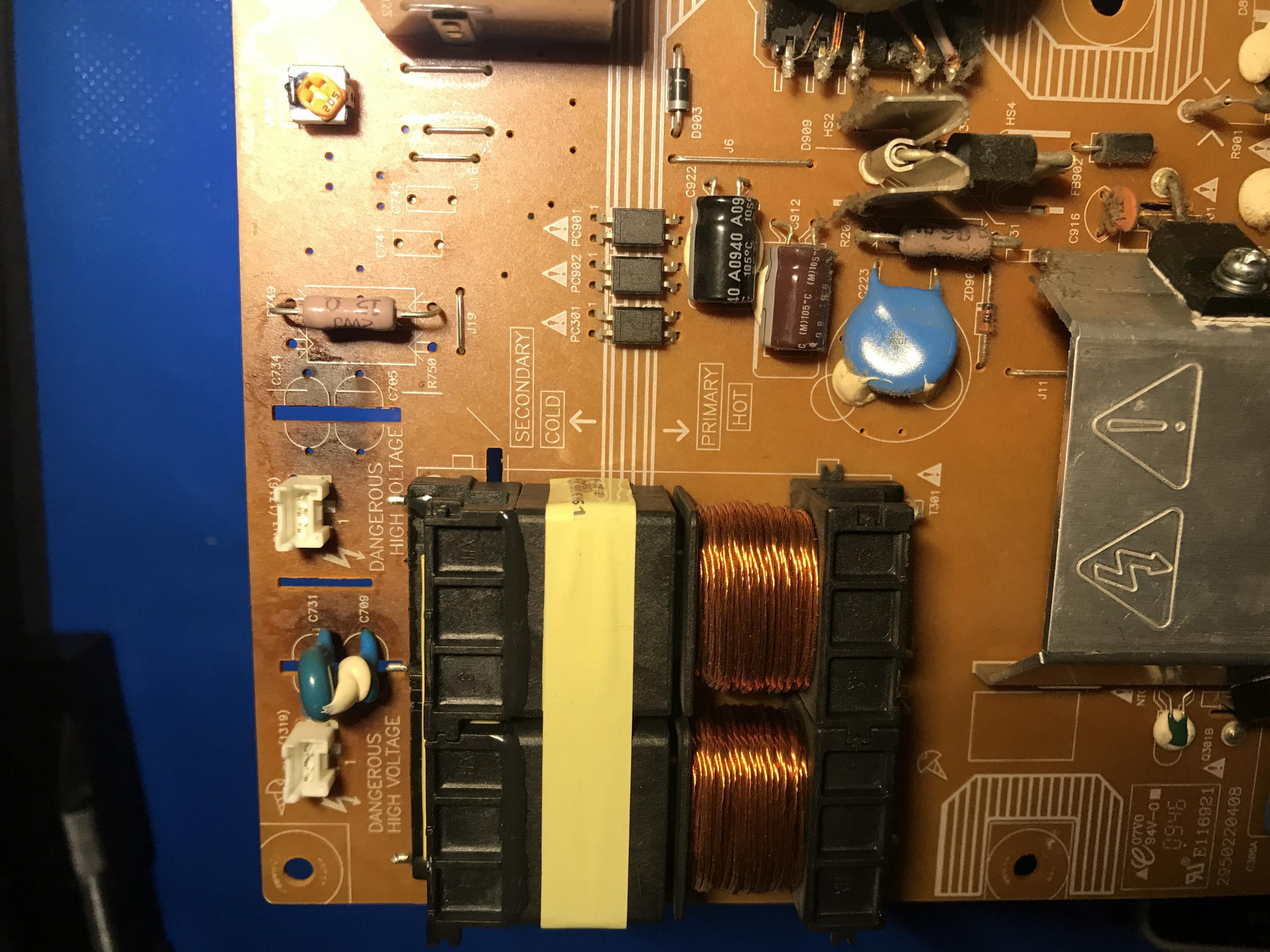

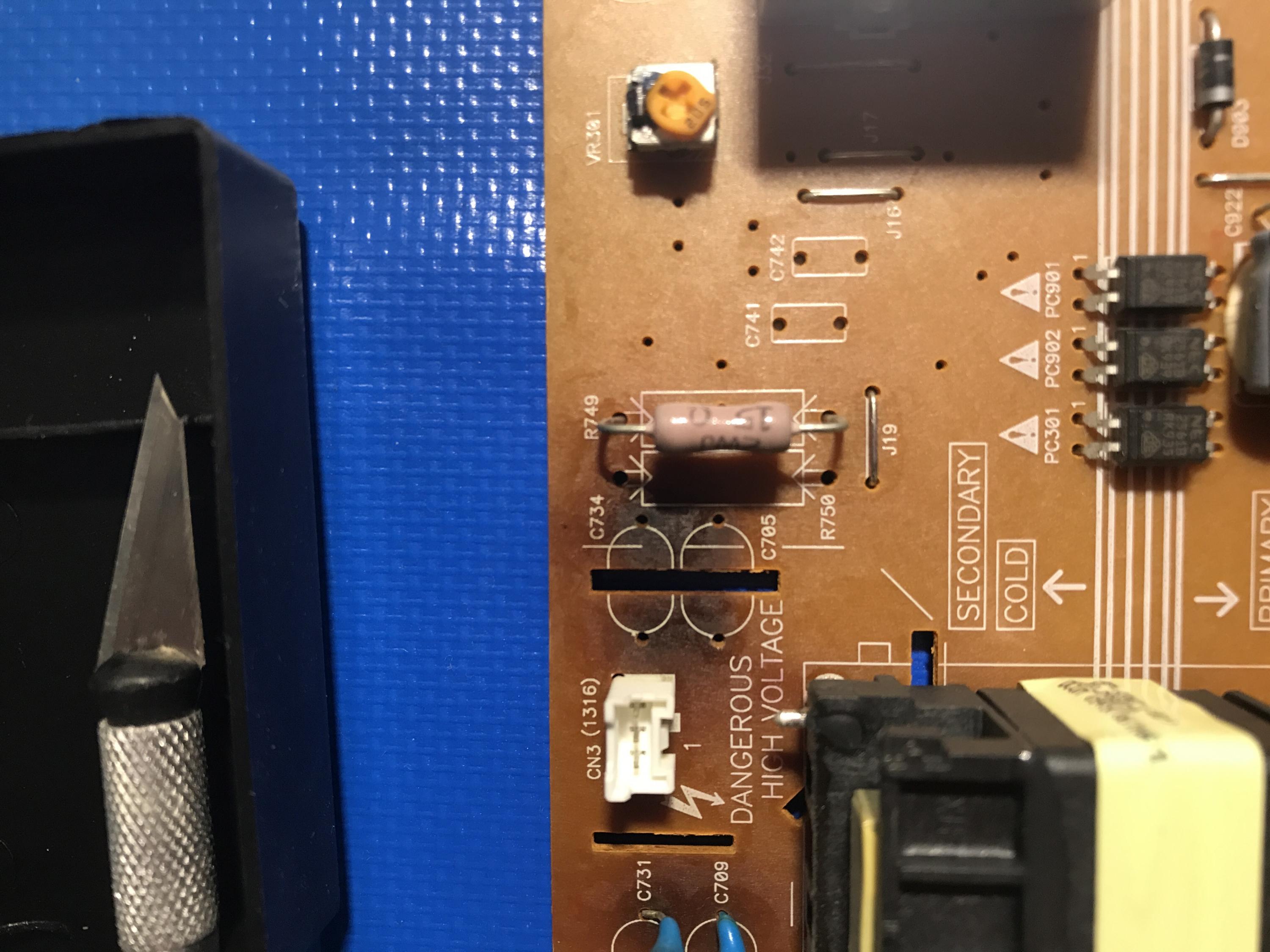

    I have a small problem. I found that 2 blue disc ceramic capacitor are burned.
    I cant read the value from them. On PSU are marked with C705 and C734.
    PSU is from philips TV. PSU code is DPS-298CP A. Can anyone please tell me caracteristic of this two capacitors?
    Thanks for the help.

    possibly the same as the lower pair, show a bigger picture.

      Re: Phillips PSU bad capacitor
        • 31182
        yea, looks like 2 identical circuits.
        so all 4 are the same.
        a good time to point out that they rarely fail without help - either the soldering was poor, or the tubes are very worn.
          Thank you! What are those numbers writen on PSU like C705? I know C is for capacitor but what are numbers for?
            • 31182
            those numbers are just to reference the position against a diagram or parts list in a service manual.
            what's printed on the caps??
                Originally posted by OobabeloO
                this is likely 47uF and 33uF (DPS-298CP-A).
                They can not be in uF range. Most likely 22nF/3KV or similar.
                OP should tell us what he reads on the lower pair.
                Edit: stj is right. You should check the bulbs and also the transformer. Those caps rarely fail.
