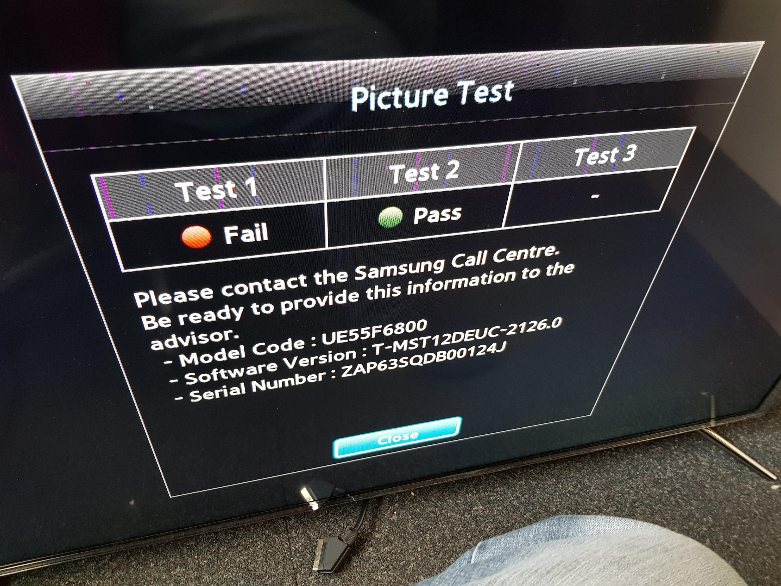

    I have just contacted them and the chap on the phone was asking me to carry out tests instructed from a tech on the shop floor.
    I have sent them a couple of pictures with each ribbon disconnected from LCD and the picture showing the lines. Just waiting for there feed back.

      Here are the pictures i sent them, as you can see with each ribbon disconnected you cannot see any lines see what you think ?

            in your pictures if you have just the black no signal screen on with both ribbon cables connected what does that full screen look like?

                Here are a couple of photo's of the screen with both ribbons connected hard to take pictures with out reflection images.
                But if you look at the box around the no signal message you can see where the lines are ?
                It really is pointing to a faulty replacement T-Con board.
                And if you look at the half screen shots there are no lines on the white sides.
                I am not saying the LCD is perfect but i really think it is T-Con and not LCD panel or main board.

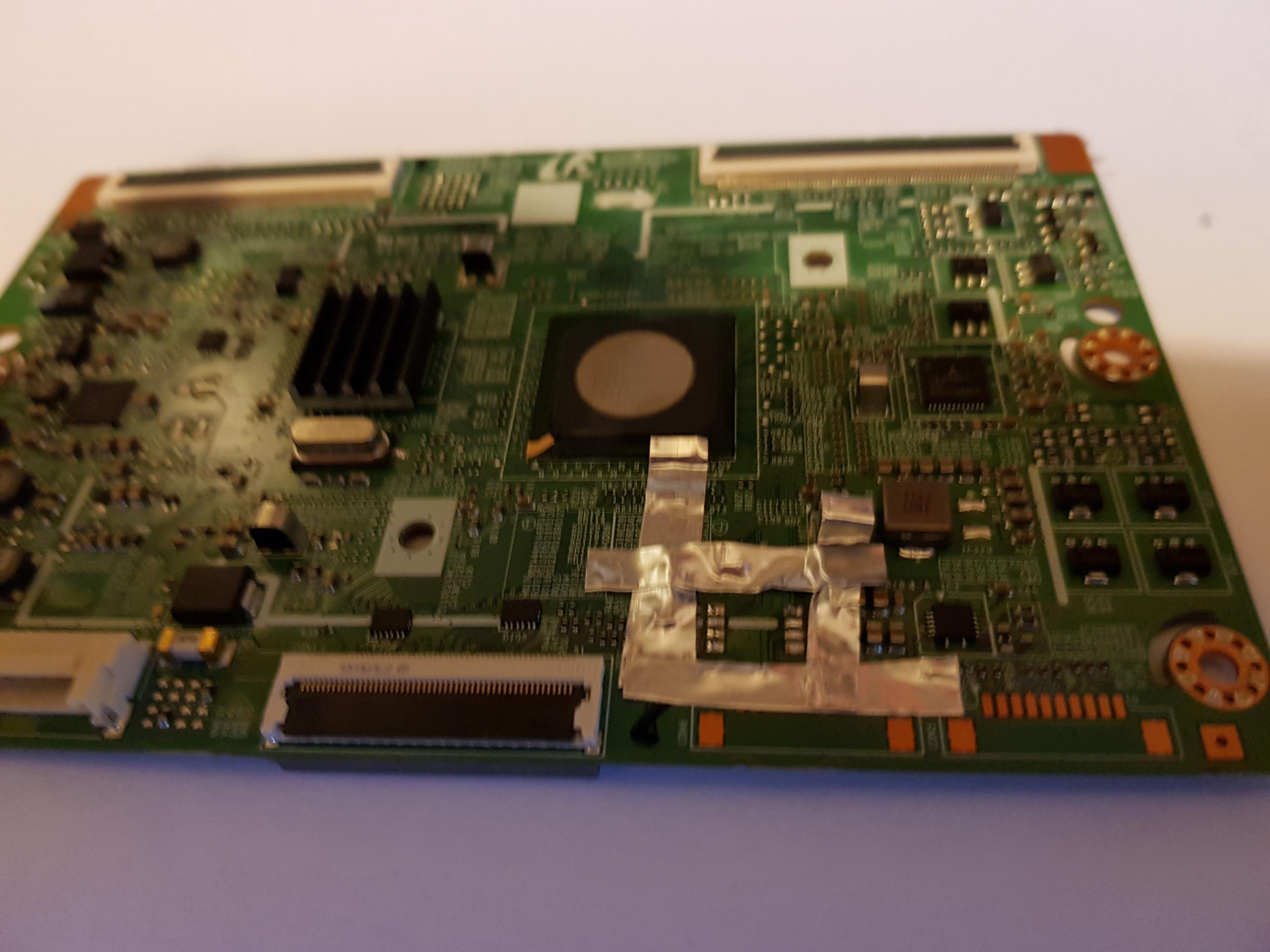

                              NO, but you have a simple fix you can try...!
                              1. No doubt the T-CON is faulty!
                              2. You're unable to find a working, exact match, T-CON replacement (at least within you're time frame).
                              3. You have 2 T-CON boards partially working, and the original one faulty.
                              4. The only difference between them is the firmware!
                              5. Exchange the SPI Flash IC » IC13 (winbond 25x40clnig) [see attached picture]
                              Hopefully, from the what we have seen, you will end up with a fully functioning T-CON.
                              Furthermore, if not, because you're being refunded, you've nothing to loose.
                              Note:
                              I won't go into discussion if "they reckon the software on the T-Con board is corrupt", but imo that's hardly the case.
                              Neither this exchange will address that issue, although it might seem to do.
                              Rather this exchange will the address the wrong firmware version due to wrong Samsung P/N for your panel as pointed out by @budm

                                Do you mean removing ic13 from faulty BN95-01134A 55" T-Con board and installing it on the BN95-01130A 46" T-Con board to make this compatible for my TV?
                                Or are you saying to install ic 13 from my faulty T-Con to the one in the TV now that has the lines in the picture ?
                                If this is what you mean then if this did not work spares2repair would not refund due to repair work on the T-Con.
                                But to install ic13 from my faulty 55" T-Con to the 46" T-Con would not be a problem as i could still get my refund from them.
                                But having said that i still am tempted to forfeit the refund just to see if this would cure the issue if it is to swap from my faulty BN95-01134A T-Con to the replacement BN95-01134A T-Con that has the vertical lines that EMOS say has a corrupt software.

                                      try the ic13 (55) on the 46 board
                                      As boards are same except for firmware
                                      the other board you bought is junk so send back
                                      no point in doing anything with it

                                        Looking at what megaraider was explaining i thought what have i got to loose and also thank you to zomi for clearing up which board i should install the ic13 from my original T-Con faulty board. I am including a picture of my faulty T-Con board showing how i isolated the close vicinity components while i used my hot air station to remove the ic13. And then did the same on the 46" T-Con board to remove it's original ic13 then cleaned all contacts on the 46"board and soldered on the removed ic13 from faulty T-Con.
                                        I then removed the replacement T-Con from the TV and installed the now repaired T-Con in it's place and proceeded to test the TV to see what my results were.
                                        If i have sorted out these pictures correctly the first should show my Faulty T-Con with the ic13 removed then the second picture should show the screen with the replacement T-Con from (Spares2repairs) which is being returned as faulty. The third picture should show BBC screen with dark back ground as in second picture but third picture not showing any lines like second picture. Then four 'five and six showing TV programs .
                                        I am now really pleased with these results let me know what you think !! I have also removed the labels from my faulty T-Con and stuck them on the newly repaired 46" T-Con board so it is now labelled as a BN95-01134A.
                                        I would like to thank all for their patience with me and all their advice in helping me to get this TV back up and working.
