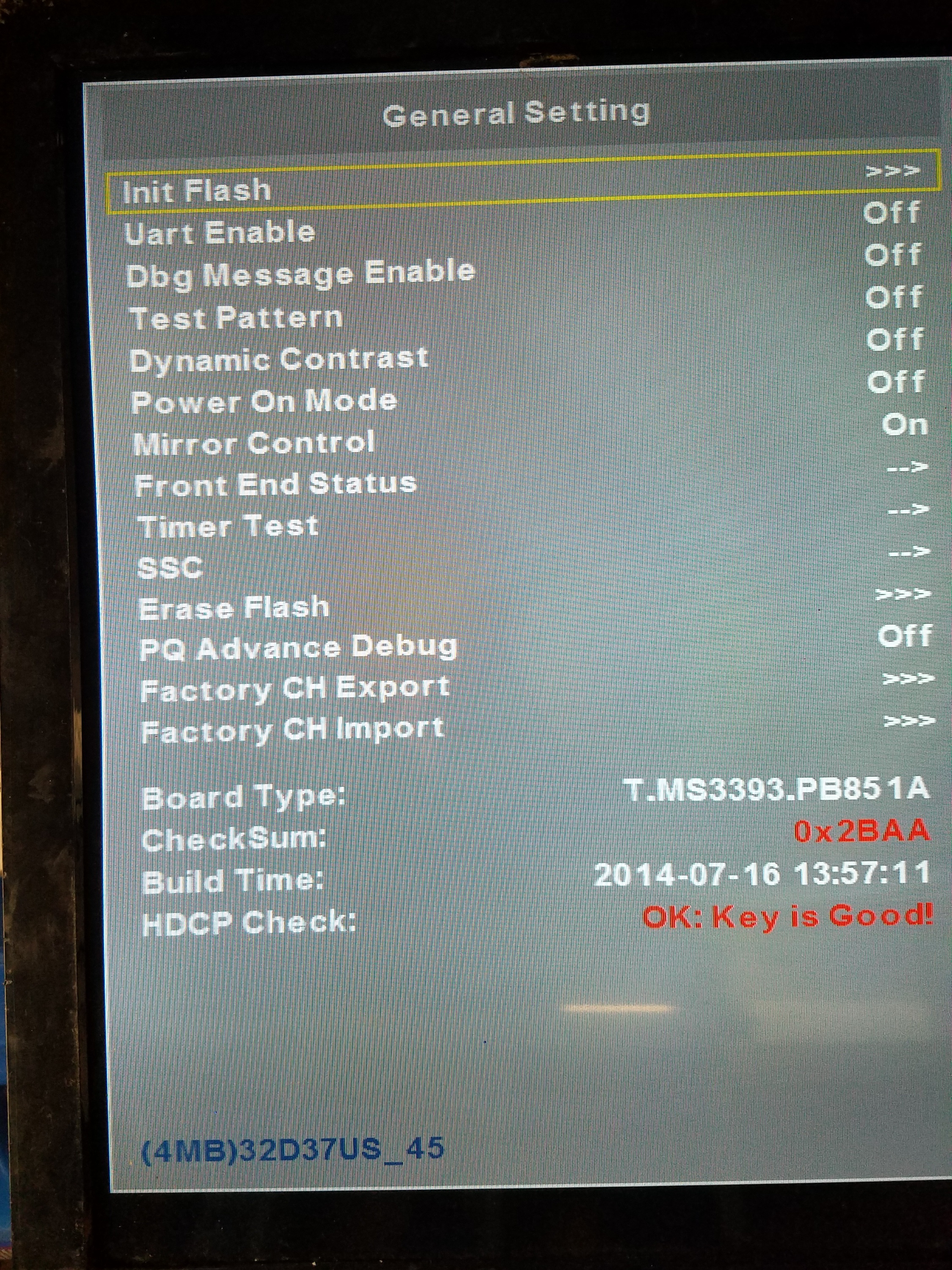

      Well, I figured out how to enable UART. It's in the service menu. I haven't tried it yet. I've spent days trying to get Avast's decompiler installed on Kali Linux, and still no luck. I get past one issue, and then it's another, and another. Ubuntu just randomly crashed last week and wouldn't boot. I had realized the day after installing it that Kali was the new Backtrack and more suited to what I am trying to do, so I decided not to waste time trying to fix it. I've got some other work to do now, but I'm anxious to see what I can learn from the UART debugging. I might be able to get to it tomorrow.
