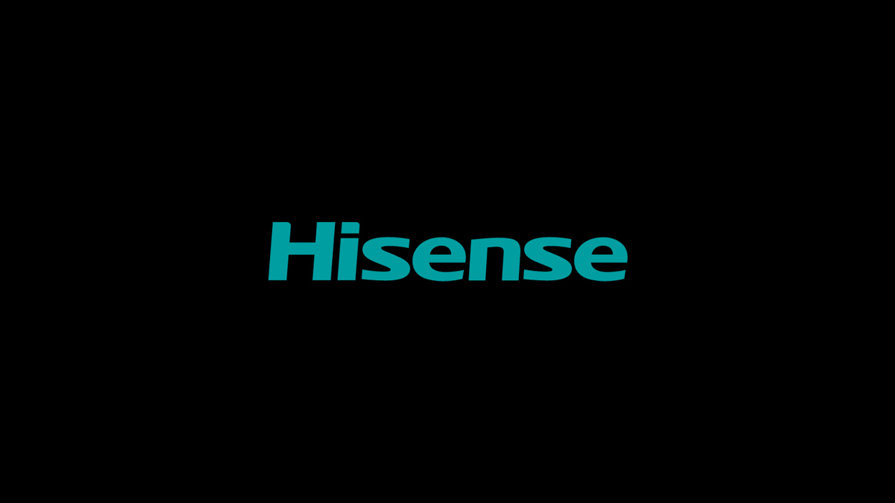

                                        #39
                                        Re: Emulating a main board CPU.
                                        I think I just figured something out. Run strings on this image. I started doing math, trying to figure out areas in the binary I could exclude, thinking I could narrow it down some. It didn't add up right. All that copyright stuff comes after the jpg, but adding the size of the jpg and the offset equals the size of the binary. I don't know if they've embed code into the jpg, or if the extraction just doesn't stop at the end of the image. I tried binwalk --exclude 'jpeg' file.bin, but that just skips over it. I'm going to try changing the signature so it won't recognize it and see if it then finds something else.
                                        ------------signature starts here------------
                                          #40
                                          Well, I wasn't exactly right. It's not embedded. I just didn't specify a limit when I extracted it. The image file is actually only 41kb. That means I have another 1.9mb to look through.
