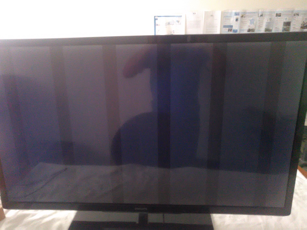

    Hello everyone ,
    Holder of a TV Philips 42PFL4307H / 12, I find myself overnight with a TV that no longer displays the images, and against the sound (checked with a laptop connected to HDMI on the TV)
    I specify that the backlight works because I see the screen that lights up and I discern on the screen vertical stripes of gray colors in degraded mode of gray, interspersed with black stripes.
    In addition, but may be the fruit of my imagination but I have the impression that the bands are not necessarily always in the same places.
    Which track should I follow?
    Thank you
    Best regards
    JM

    Audio or no audio ? I would suspect main board if no audio.

      Re: Philips 42PFL4307H/12 : No Screen , vertical gray stripes
      Hello
      Thank you for your answer
      Of memory, because almost 1 year ago that I did the test, the sound was present when I plugged a portable PC on the source HDMI
      This means that the motherboard is hs?
      Thank you for your help
      Cordially
      Jérôme
        Audio? Yes? I would suspect T-CON Bd.
          Hello
          Audio is Ok with Pc connect on HDMI
            Hello
            I re-open this subject. As you advised me, I changed the card tcon TV and always the same vertical gray bars on the screen .... like the photo ...
            Another search track? Slab or motherboard?
            thank you and have a good weekend
            Jerome
