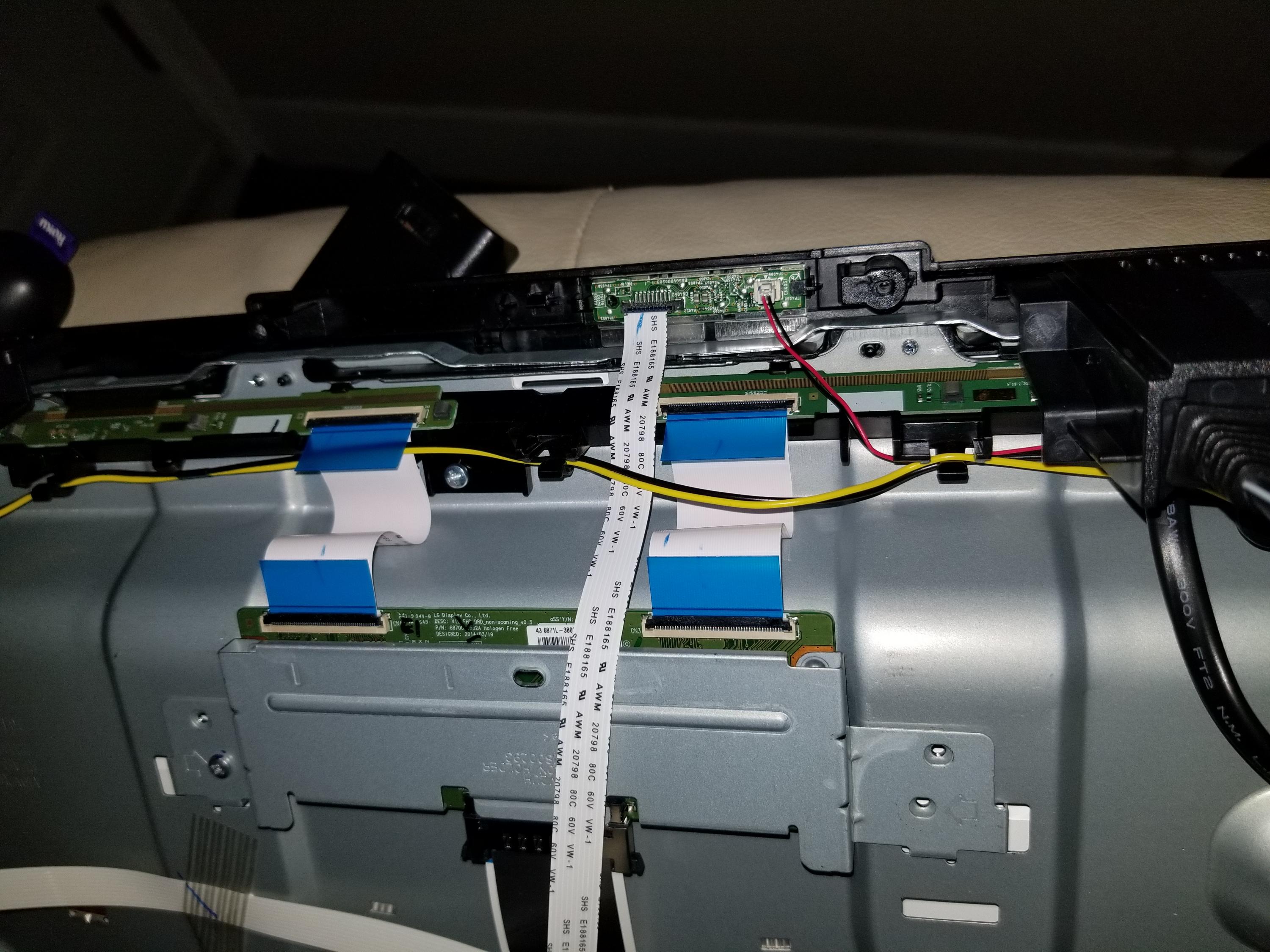

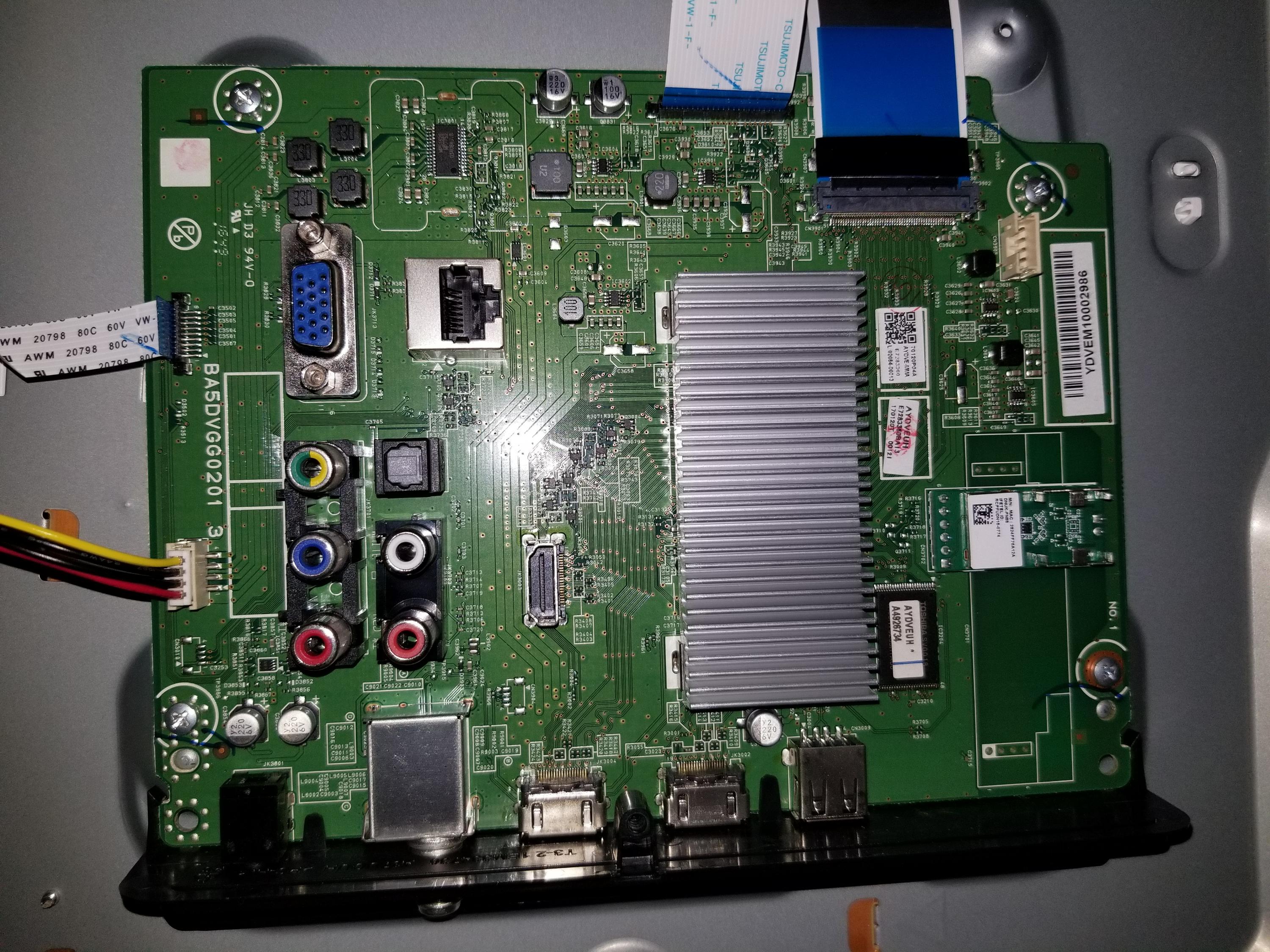

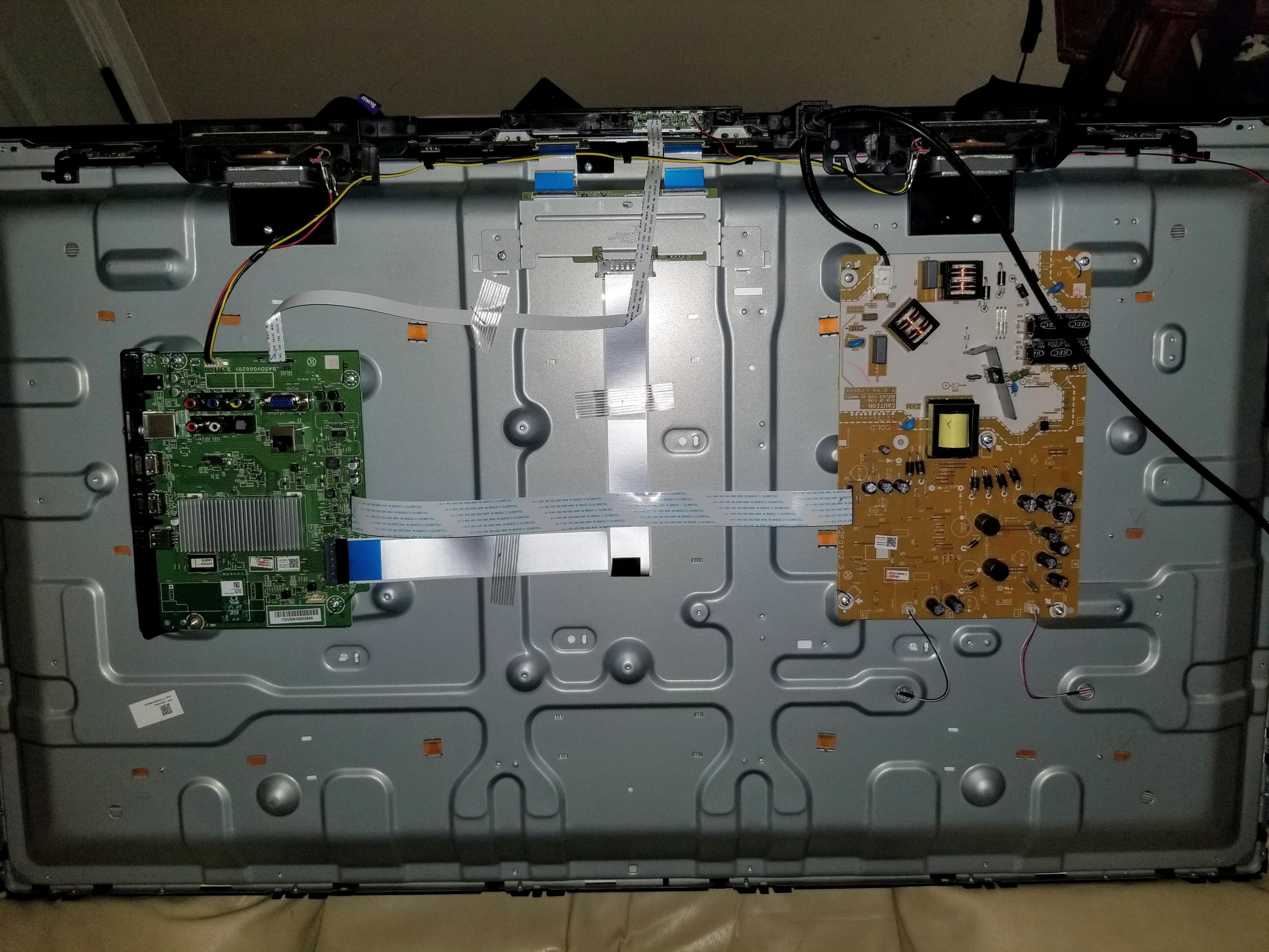

    Hello!
    Looking for ideas on where to start with this tv.
    Smart tv, when I plug it in, four blinks and sanyo logo comes up. Loads into HDMI 2 source and displays fine. Remote and buttons on TV are basically unresponsive during this process. After 30-45 seconds, it restarts.
    Any thoughts? Tried the following:
    -disconnected the ir receiver and buttons no change
    -disconnected the t con board cable(from main board), no change
    -disconnected the mainsboard, no startup

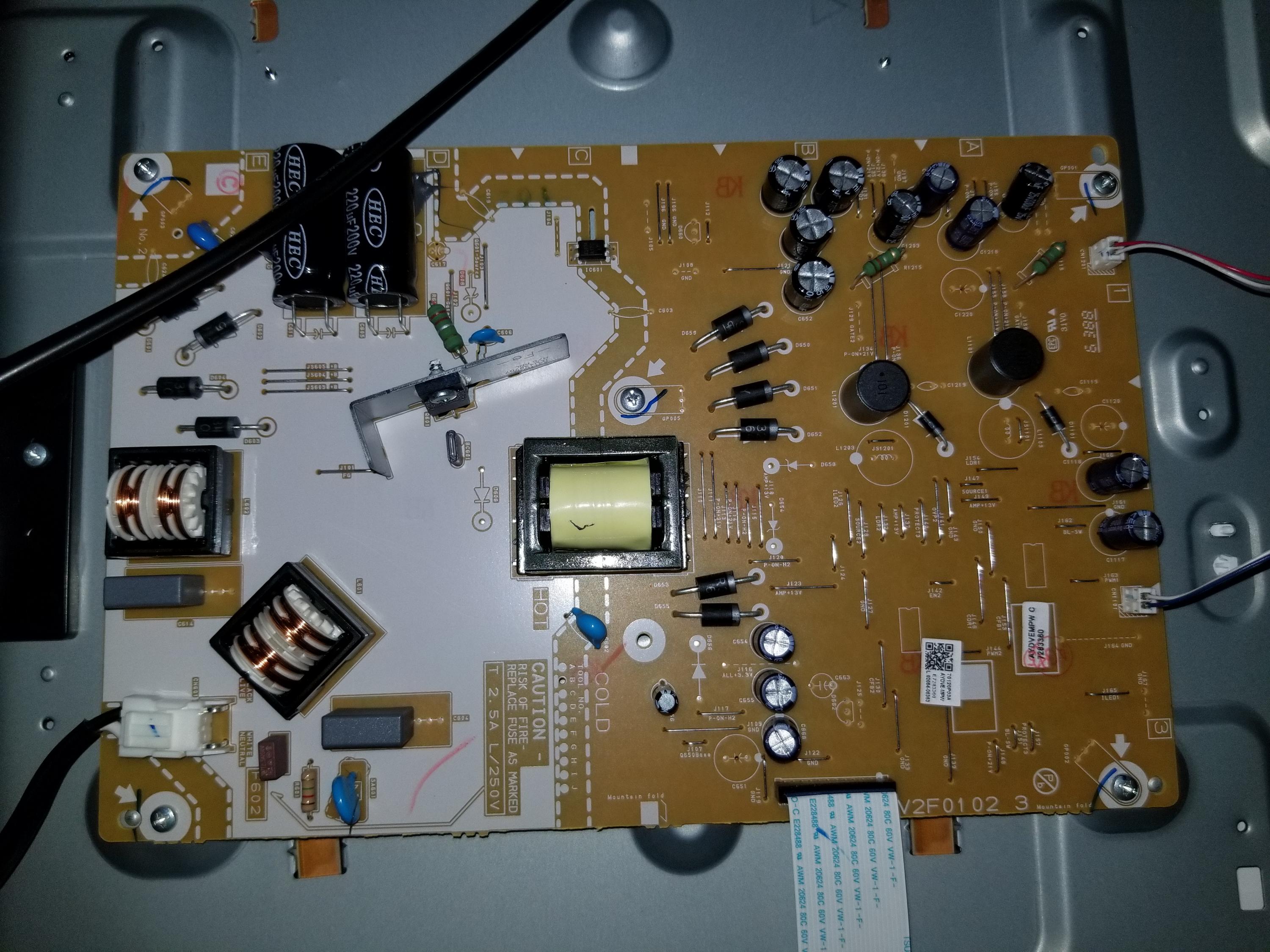

    Ideas? Thinking the main board given the lack of responsiveness. Will test the LEDs probably too...

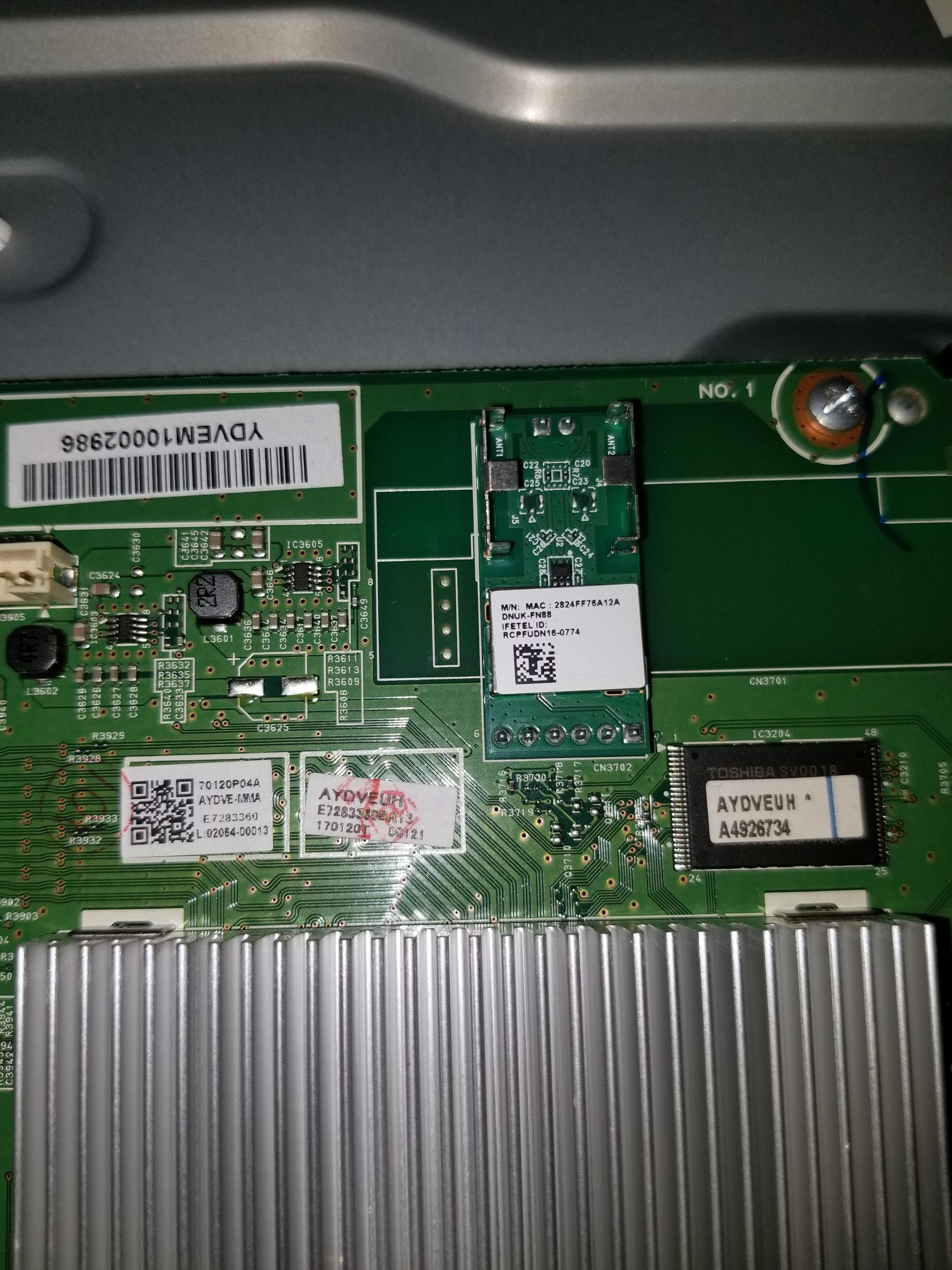

    I guess this a firmware related problem. Looking at the pics this set does not have a eeprom. So I think that the chip with the sticker on top is faulty, (AYDVEUH). Ill email you the firmware for this tv, if it dosen't work then you have to find a replacement mainboard.
