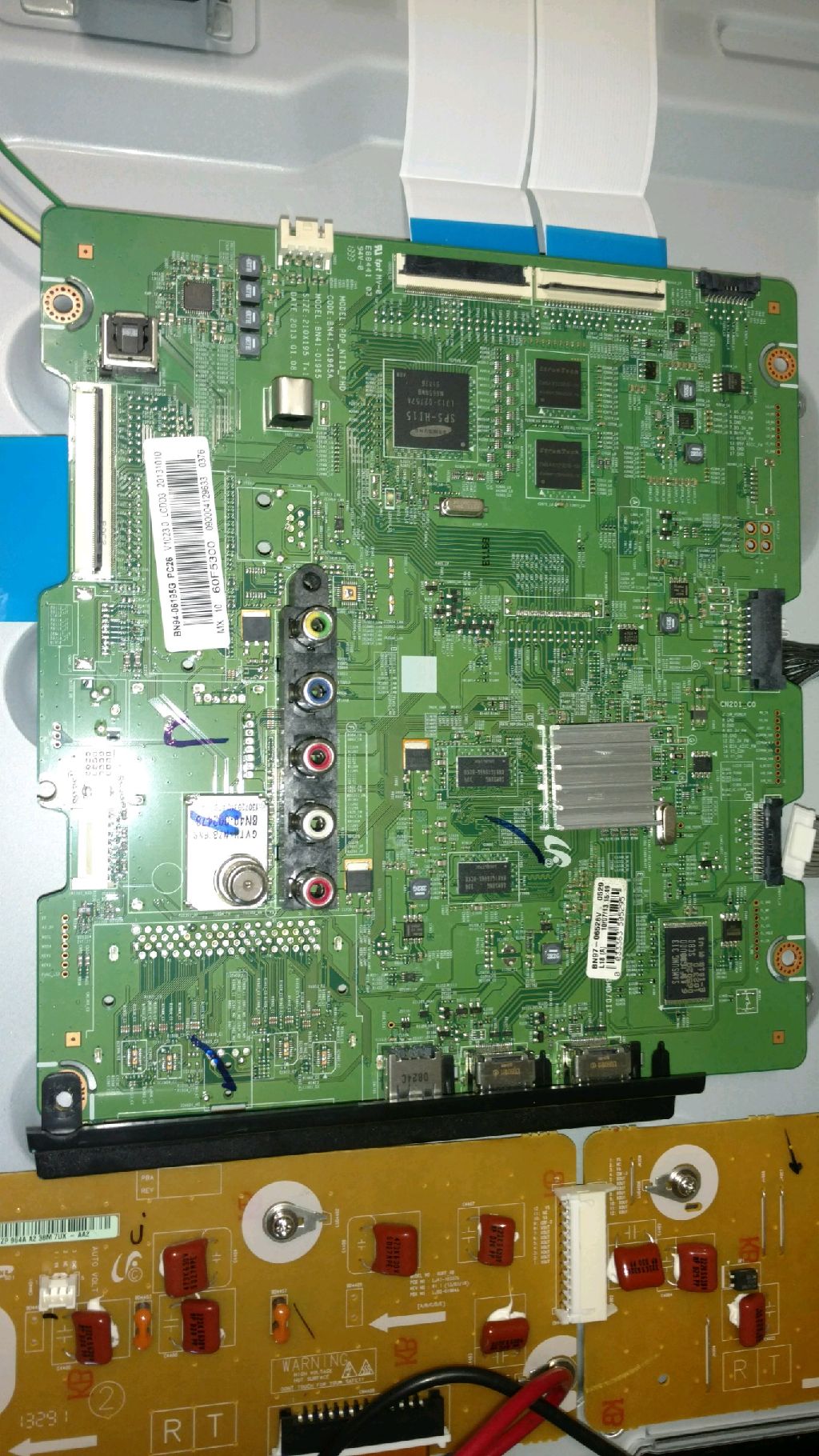

    Samsung Plasma PN60F5300AFXZA
    I picked up a 60" Plasma seller said stopped working after storm.... Nothing visible on any of the boards. Does not power on. I do have 5v standby voltage at thee input to the Main Board. I have read where one of the EPROM's on the main board is a known issue??

    Re: Samsung Plasma PN60F5300AFXZA
    Is there a way to force the set on to isolate to the main?
      These units do not have the "EEPROM" issue that affected 2008/2009 Samsung sets.
      Since your set has an integrated control board (built onto the main board) there is not a great deal you can do to test this.
      If you have established 5V stby but no activity from main board, e.g. not toggling the PS ON line to the power board, you will have to replace the main board first. I am assuming you do not know about diagnosing a main board as it is not a task for a beginner.

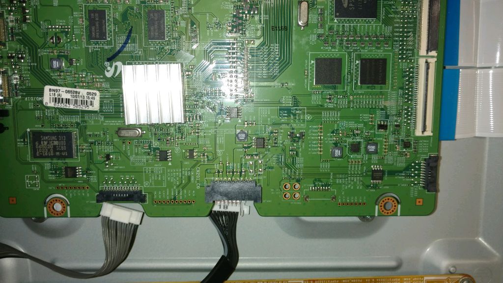

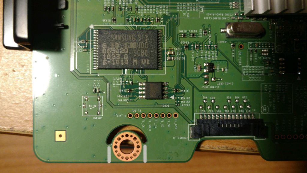

          A few places advertise a replacement IC EEPROM for IC801 as a fix for these boards. Any way to test or jumper the IC801 to check to see if it is the issue? Or is this bad info?
            not an EEPROM. It's SPI NOR Flash.
            But no way to "jumper" it. Just need to replace it if it's the issue.
            Nothing else you can do to test it without detailed knowledge of how these work unfortunately.
              Thanks, I ordered one lets see what happens.

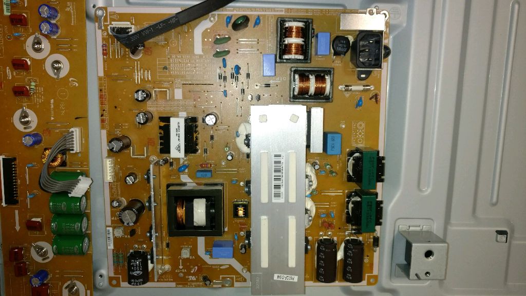

                    do you have any voltage on the PS-ON pin on the power supply, monitor the pin then press the power button to see if there is a change.
                    If you are getting a change on pS-ON, disconnect CN802 and moitor the VS pin, does it have any voltage? It won't sty up due to OVP, to test it you need two 60watt incandescent lamps connected in series across VS & ground to act as a load.
                    To test part of the power supply (not the VS supply), disconect CN801 from the main board and check the voltage on PS-ON (pin1) if there is 0 volts, connect a 1k resistor between 5v stby and PS-ON, If there IS 5 volts on PS-ON, then ground PS-ON. see if you get D15v or D5.3
                      Voltage on PS-ON 2.8V No Change when power pressed. Pulled CN801 4.2 volts on PS-ON Grounded PS-ON and got 15v on D15

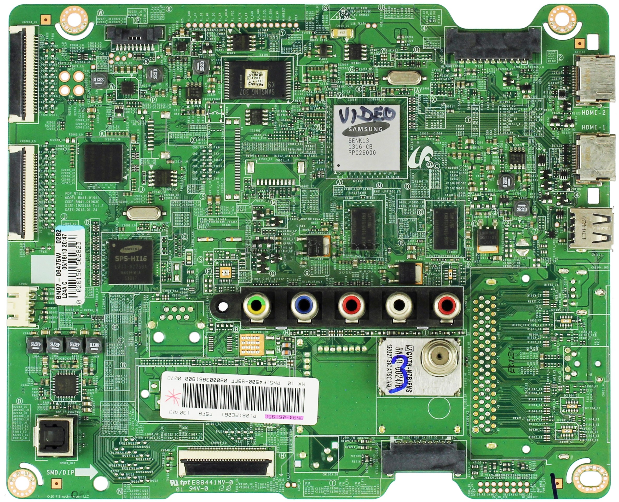

                          That other spi ic IC2001 is for a different version of the board

                              where did you get your flash ic? maybe you have the one for ic2001 and not ic801, is that possible?
                              on this board ic2001 is above the crystal
                                I order it from shop Jimmy verified it is the IC801
