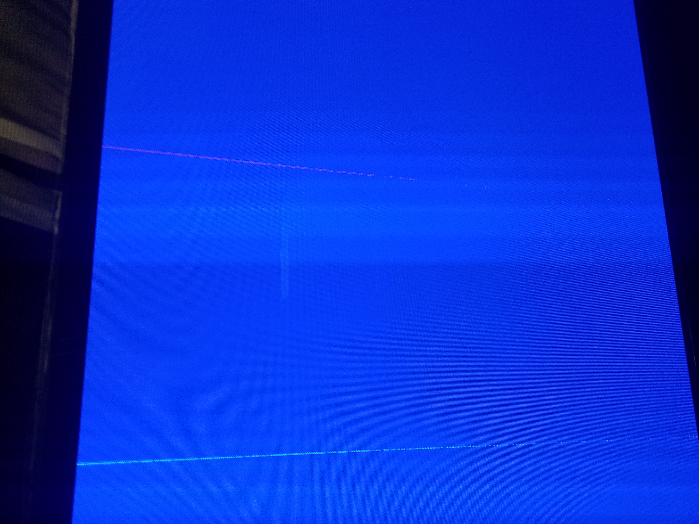

    I have a Samsung 51 inch Plasma model number PN51D450A2D and it has 3 horizontal lines running through it. I have about 40 of these TV's and 2 that where working fine but the panels where broken during transportation. I gutted the 2 broken ones so I have parts. I have attached a pic. The lines are their even when I go into the Service Menu as well as on all sources. Any and all help would be appreciated. Thanks

    Panel failure. The ribbons have a burnt trace on them. Unrepairable.
      Re: Samsung Plasma PN51D450A2D
      Agreed, it's dead.
        they are vertical ...
          It doesn't matter, both single vertical and horizontal lines are caused by panel failures.
            Thanks for the help!! Guess I have a ton of parts for sale!!!
